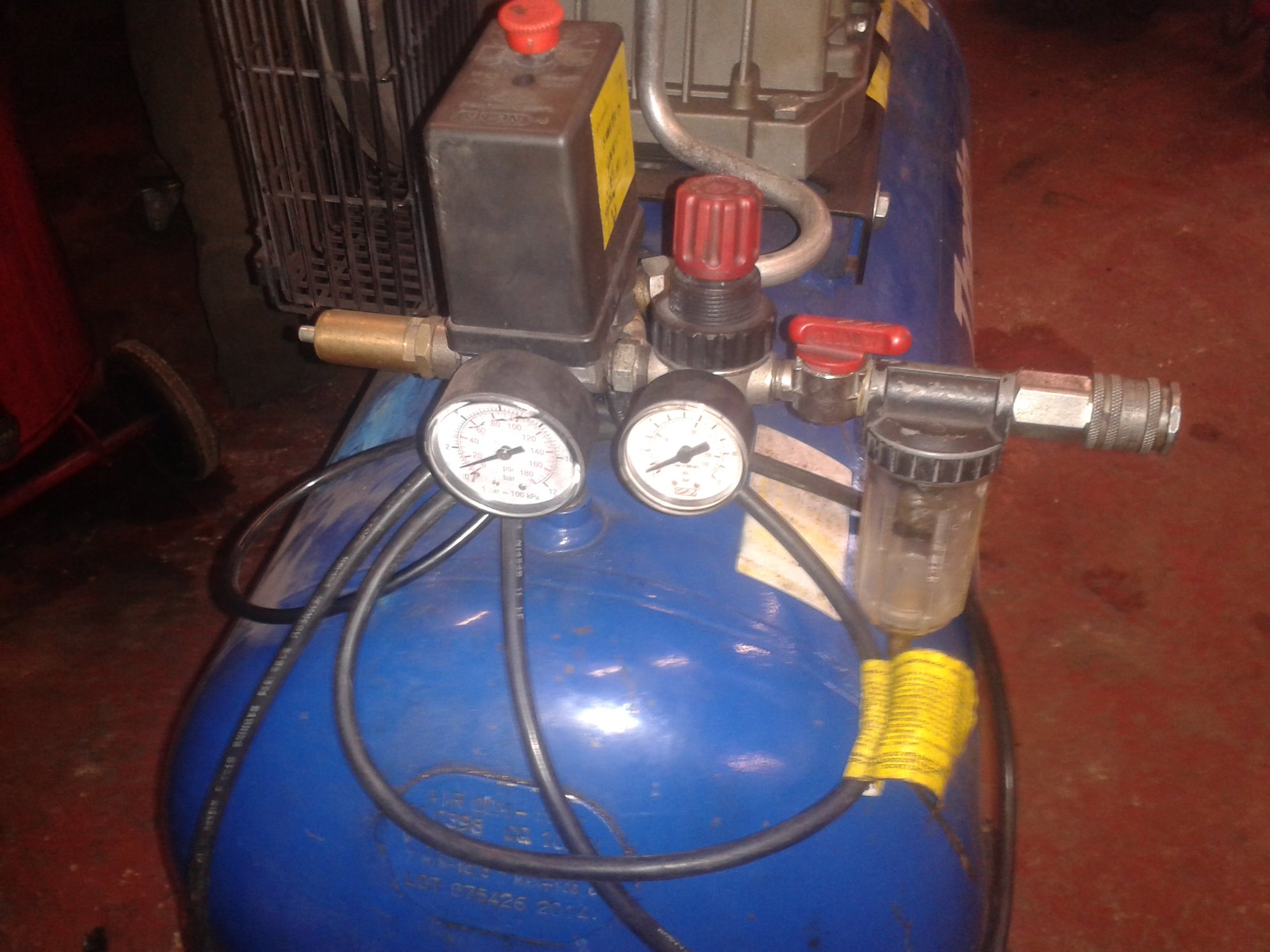

When you get a water trap Sandra, you want one with a pressure regulator on it, otherwise you will need a separate one. Get yourself some PCL quick release air line couplings as well to make life easy for yourself, if you look in the Screwfix catalogue on line, or Machine Mart, they are in there & some hose to 1/4 BSP to connect the hose the couplings. Have a look, it's fairly straight forward. If you need any help as to which ones, just ask us.
