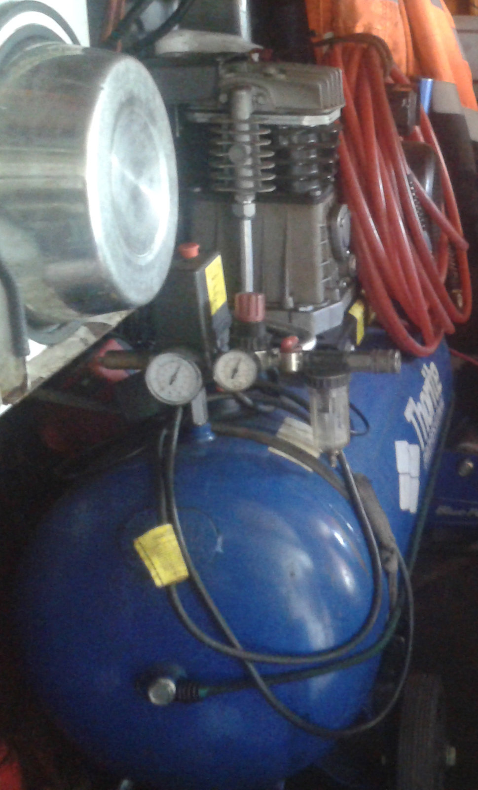

alot of people don't when they are going into air compressors
query here what are you spraying ?
as ive seen the 90s and 100 litre air compressors able o spray a car or underbody Shultz with no problems at all
with your air bleeder one on the compressor is fine all depends on the run of tubing that you have after that to long its best to use another air/water bleeded before the gun and another length of air hose
the compressor can run I believe it to be without much problems 5/10 metre air hose without the need for another water air spliter in its line
