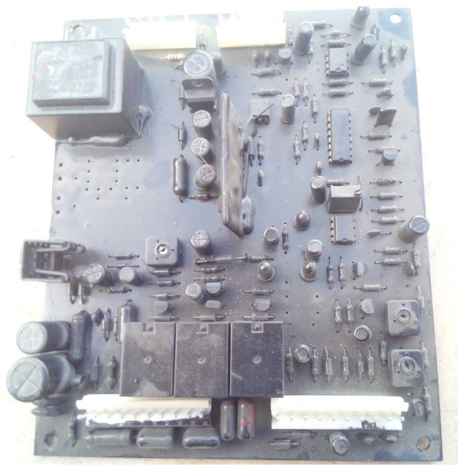

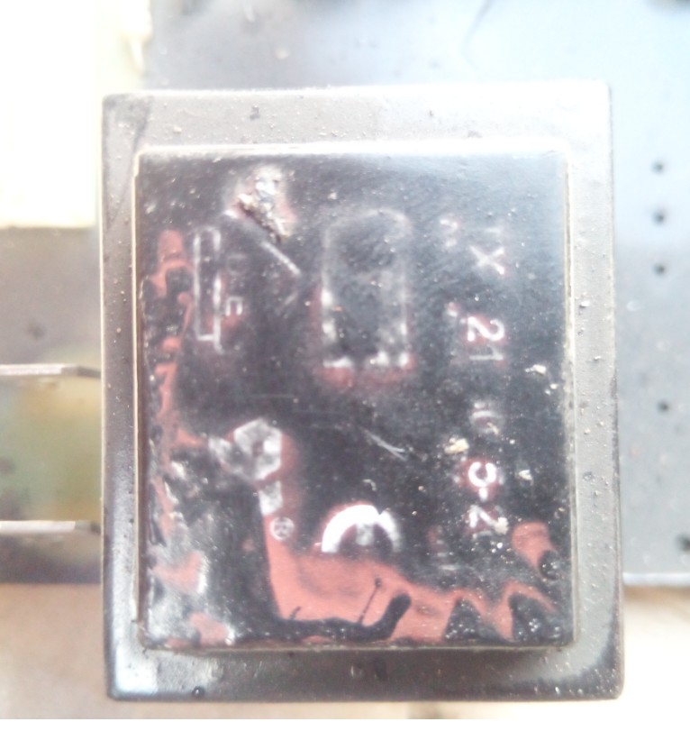

Also the component on the PCB is indeed a transformer.

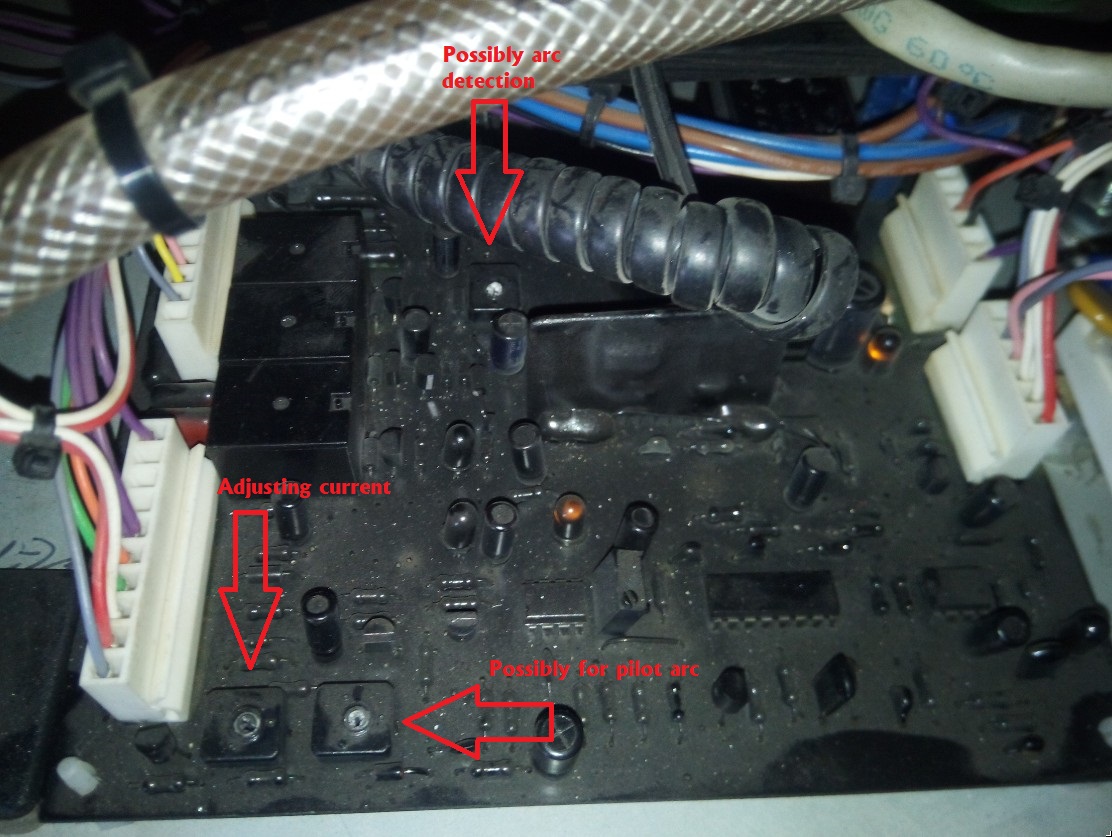

Full image of the PCB, as can be seen there are 3 variable resistors so if I decide to adjust to get a higher current I will have to find out which is which, I am guessing the one nearest the centre will be it as it looks like it has been adjusted after the conformal coating has been applied and thus likely when doing the final adjusting/testing.
