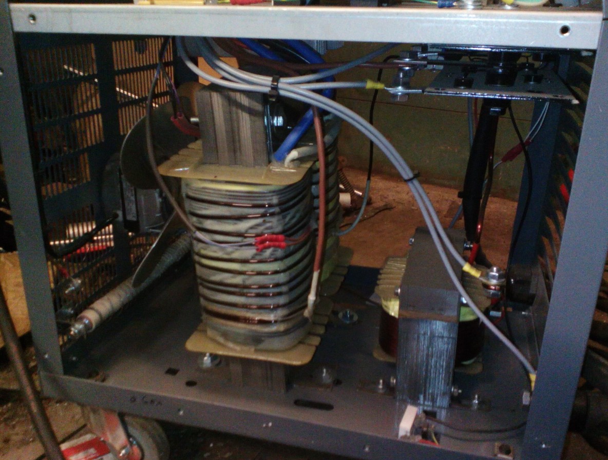

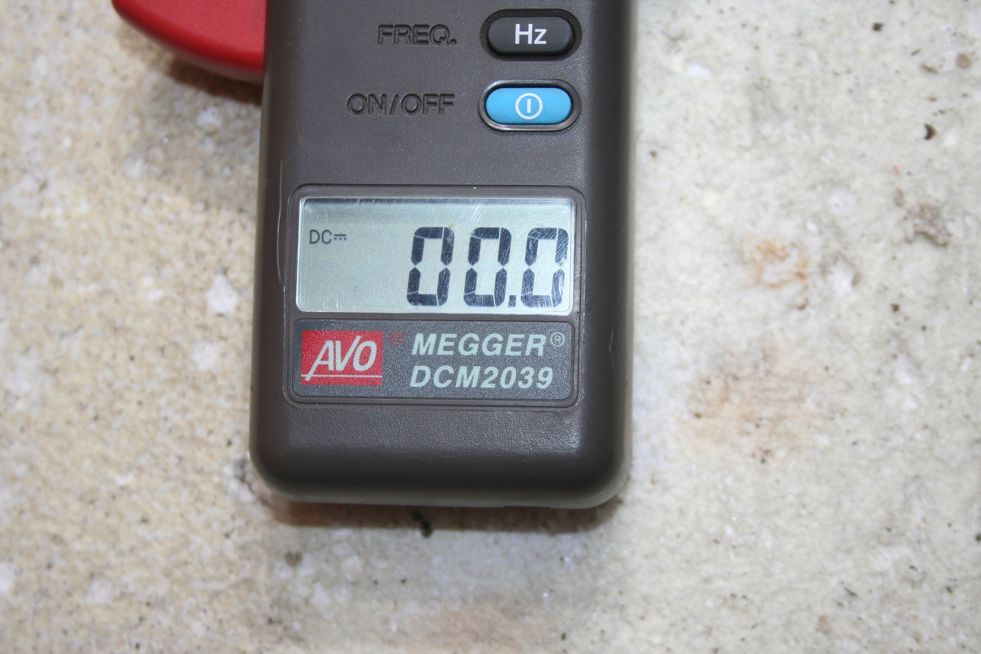

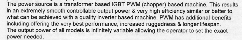

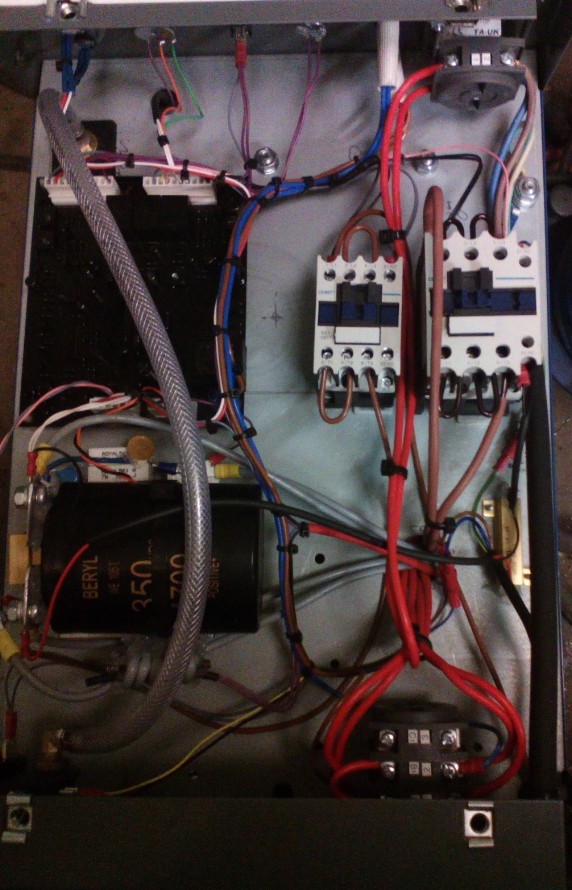

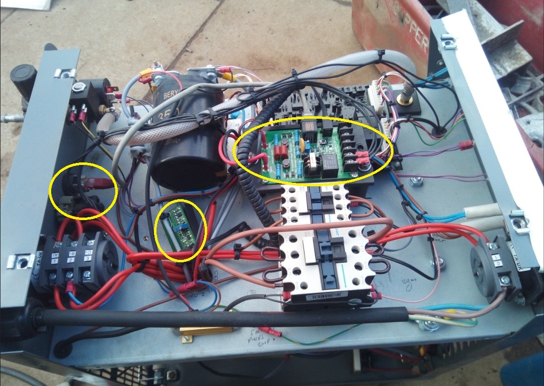

Is your Plasma cutter inverter or transformer based?If anyone has a plasma and a DC clamp meter I would appreciate if they could check to see if the current the meter reads is what the plasma is supposed to be outputting.
Reason I am wondering is my plasma is 65 Amps and when I use a clamp meter it only reads 40Amps.
I am wondering if it is due to the way the plasma makes the DC with it being chopped (or whatever the technical term is ).
The guy who started the debate between me and @Munkul said that his cut 50 wasn't working properly because of 2 damaged MOSFETs
If is transformer based could be the rectifier
