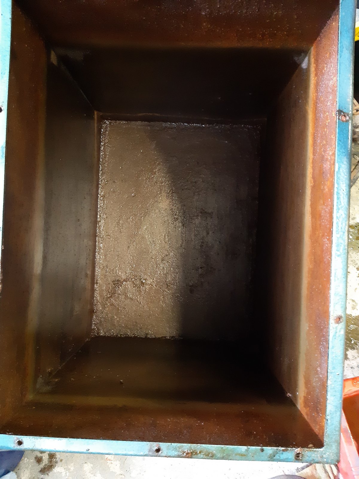

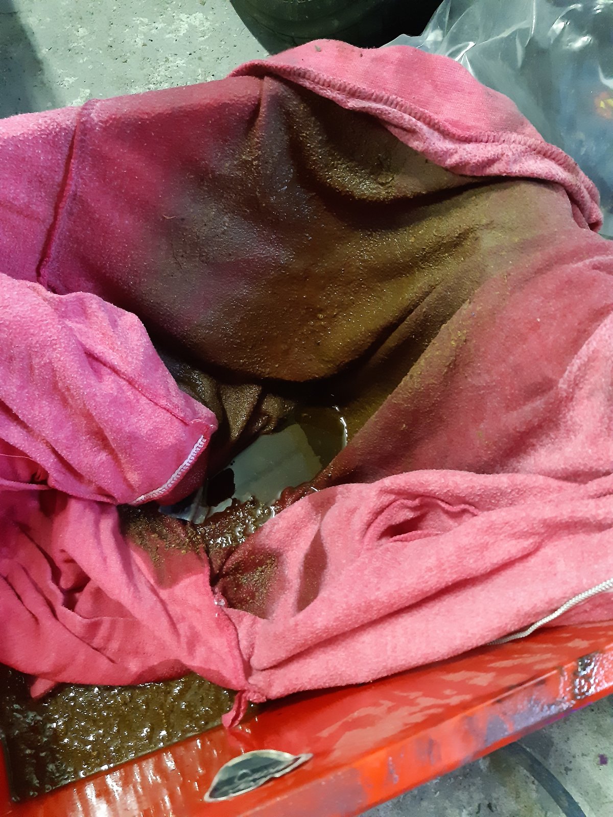

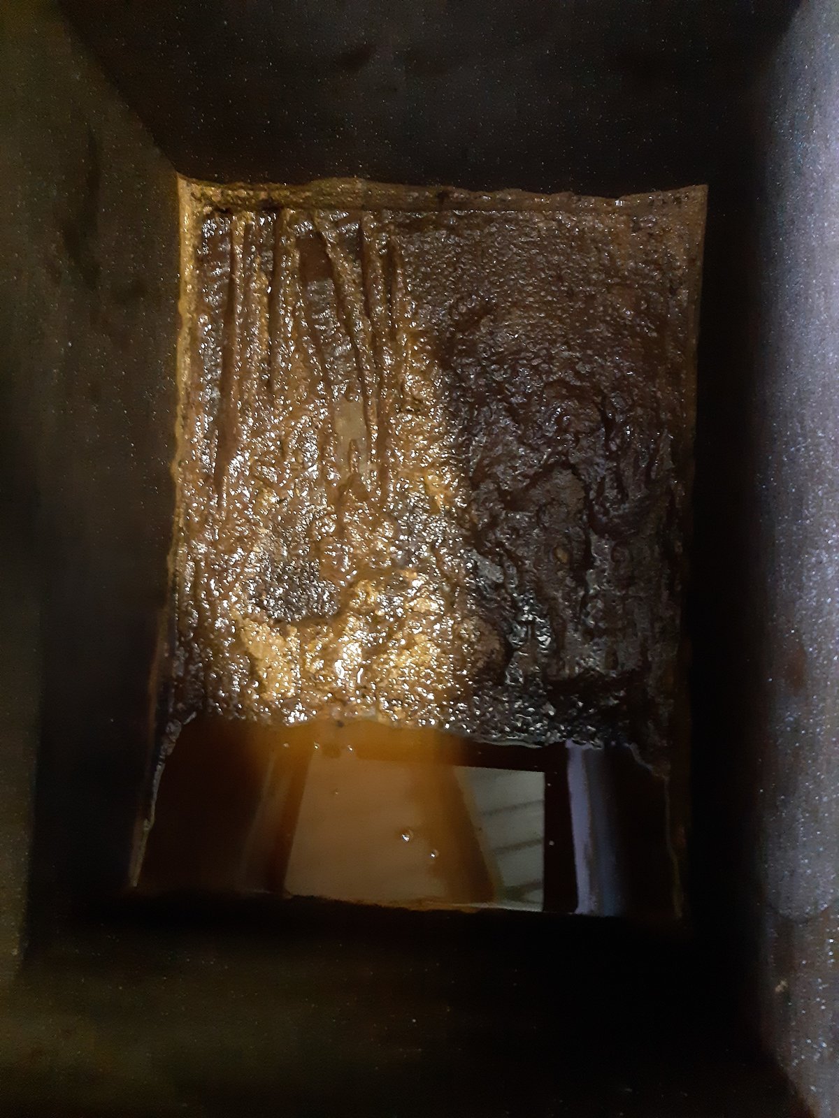

Yes!!Will try it and see. Obviously I have to drop the top back in??
That looks good, certainly won’t do any harm - though I wouldn’t be sure it was the issue, but maybe it’ll cure itAll cleaned out.

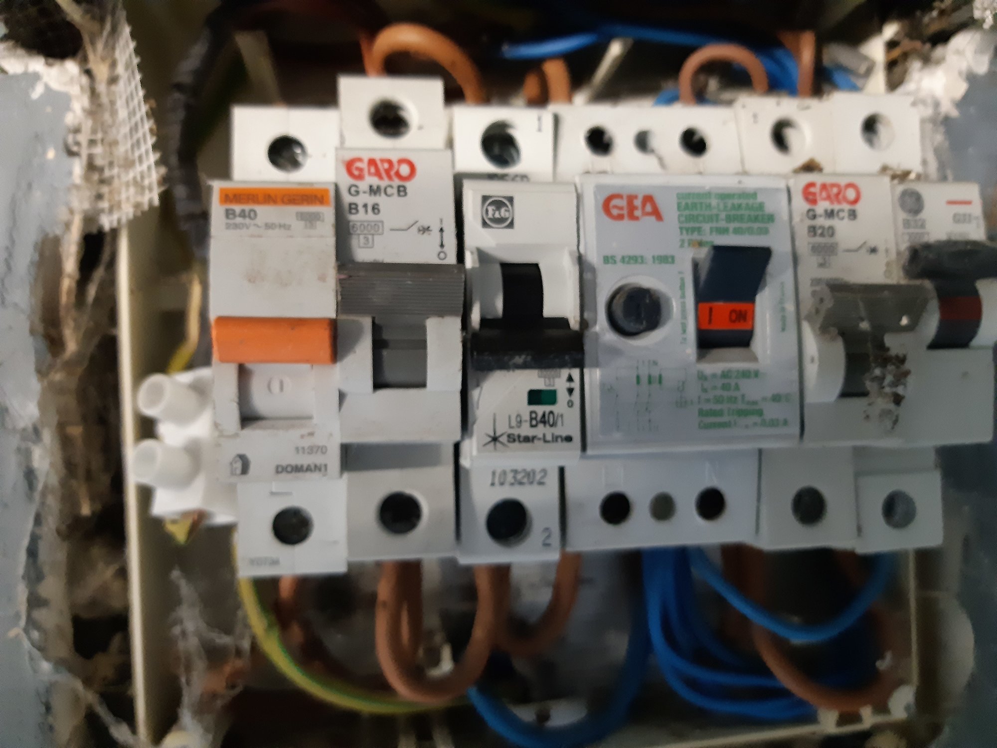

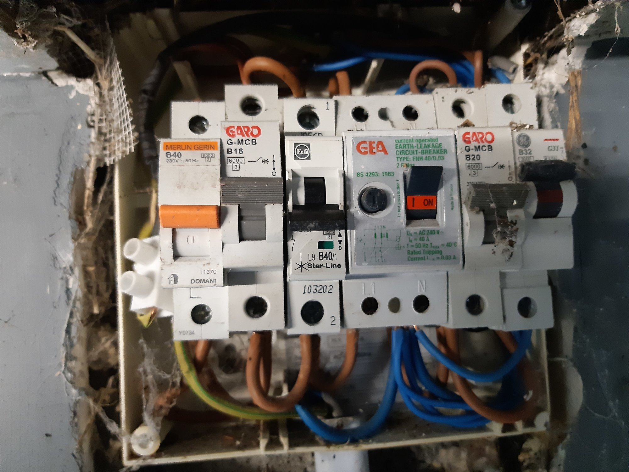

Could be the insulation breaking down under voltage - do you know anyone with a megger/insulation tester? A multimeter gives an indication but doesn’t generate any voltage - an insulation tester gives up to 1000v out and can show up faults that don’t show on a multimeter.
