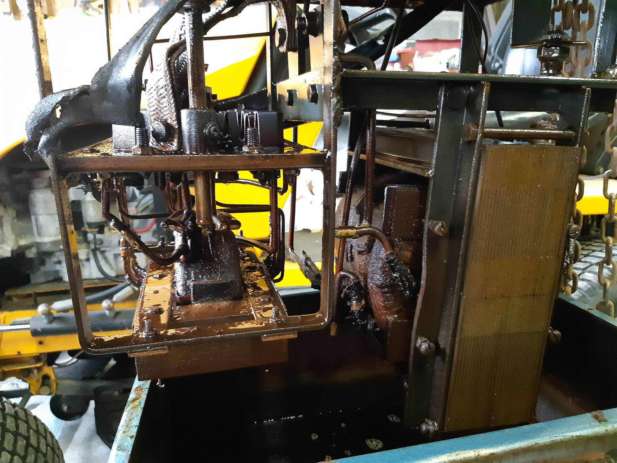

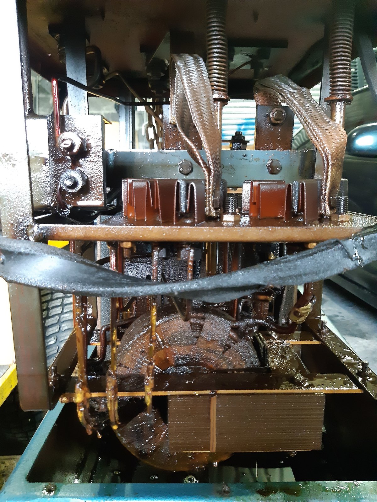

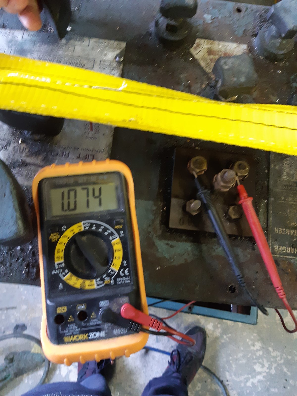

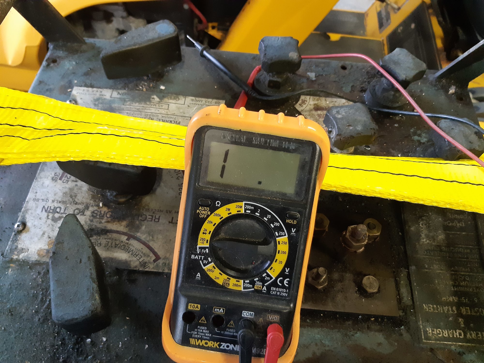

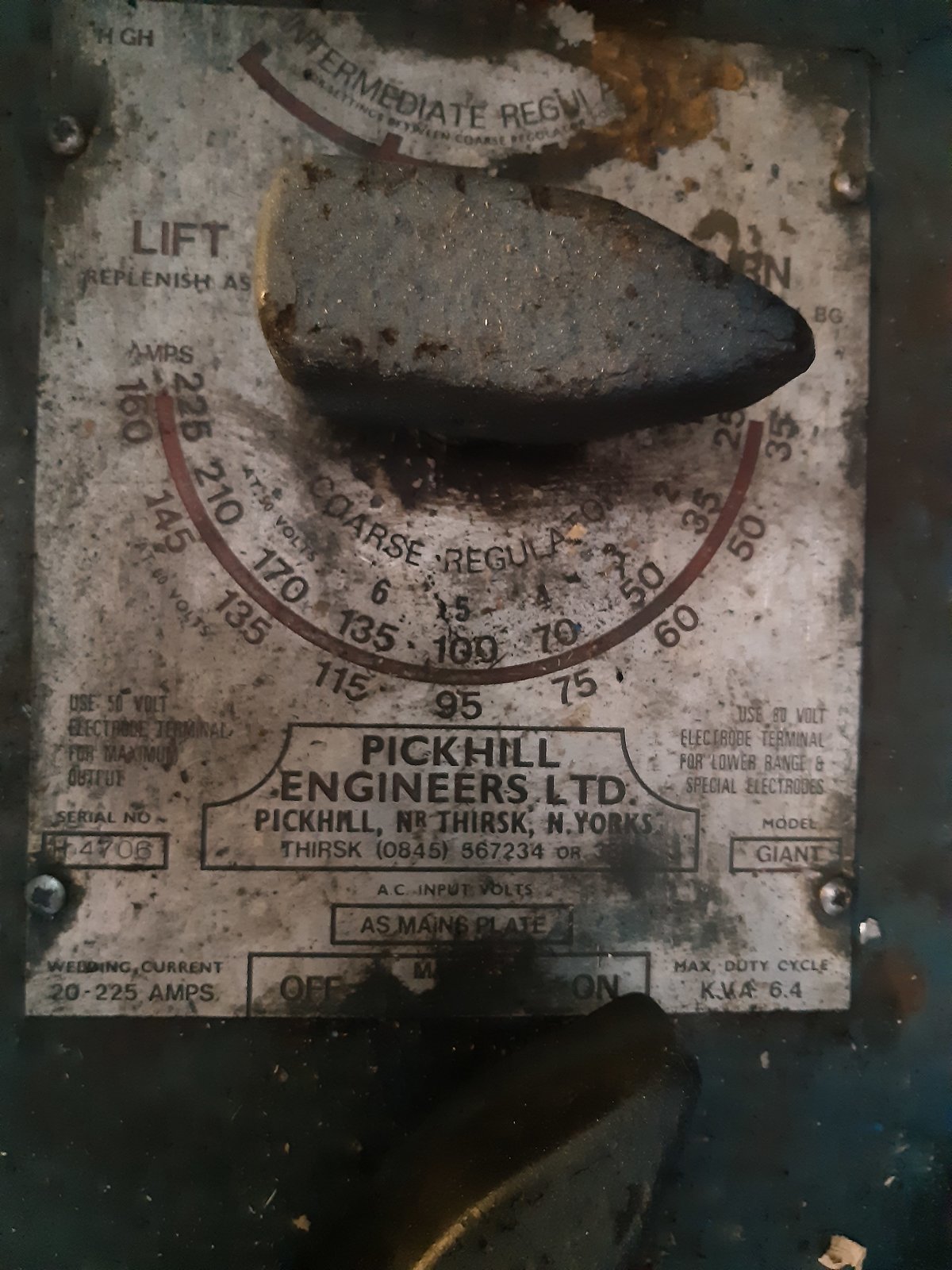

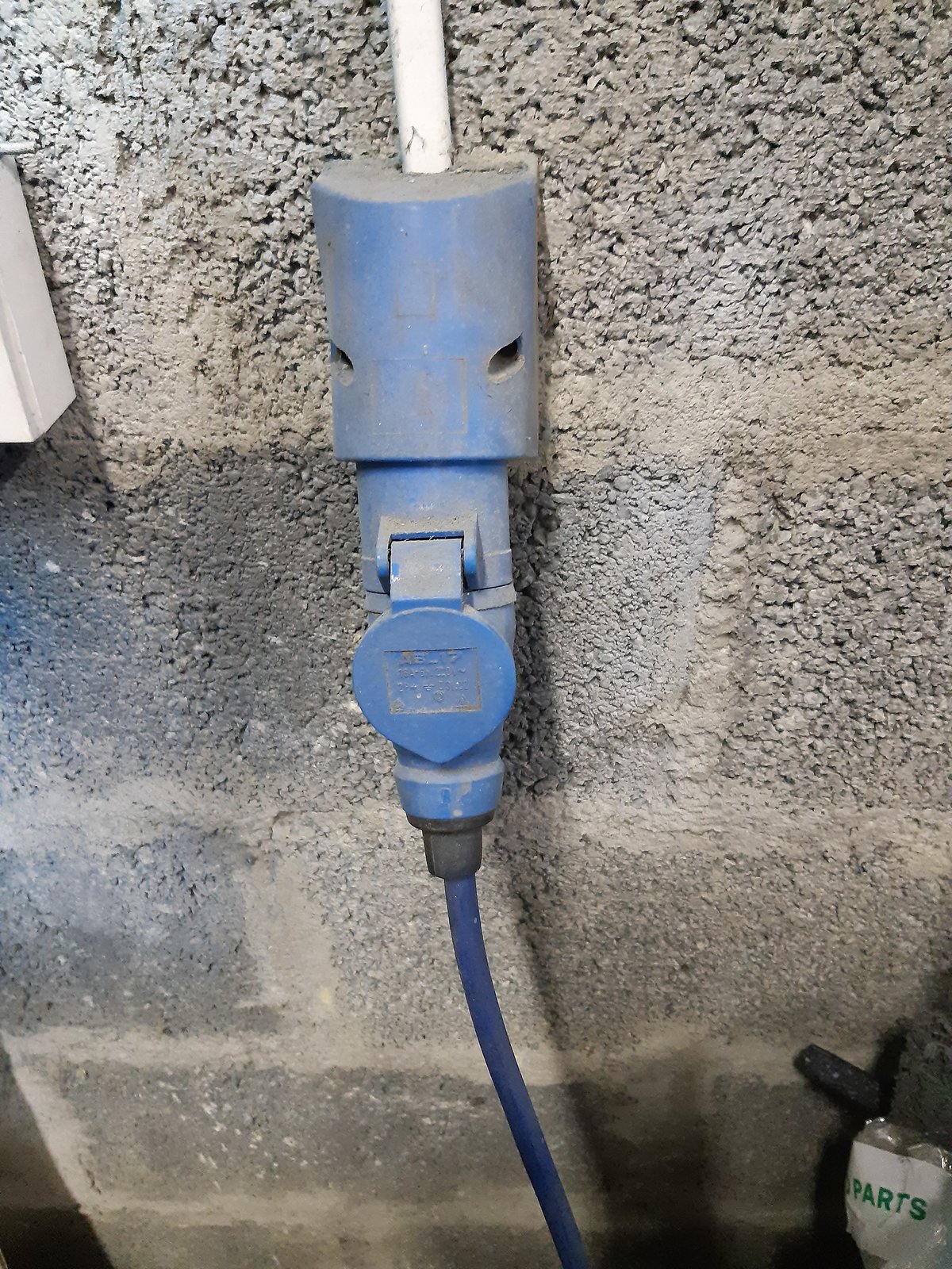

I'm new here......I have a pickhill oil cooled which is tripping the mcb in the shed. It was working ok for years, tripped mcb but once pushed back up it ran fine.
I have change the mcb to a c32 but this has still not solved it.
Is the welder toast?
Ok so a few months back I was welding everything grand. Went to move the welder and switch it back in then tripped. I thought it may be the b type mcb changed that for a c type and still the same
