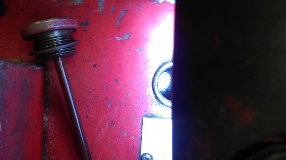

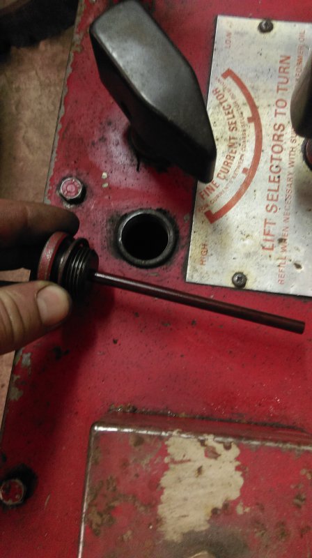

Unless it's leaked out or been spilt it unlikely to have got out any other way, mine was less than half full when I lifted the transformer out to check.Has anyone got a good source for transformer oil preferably new stuff for my Oxford , it's a bit low on oil but I thought it,s perhaps due a change.
Also I know all about the PCP's and all that jaz with handling it
