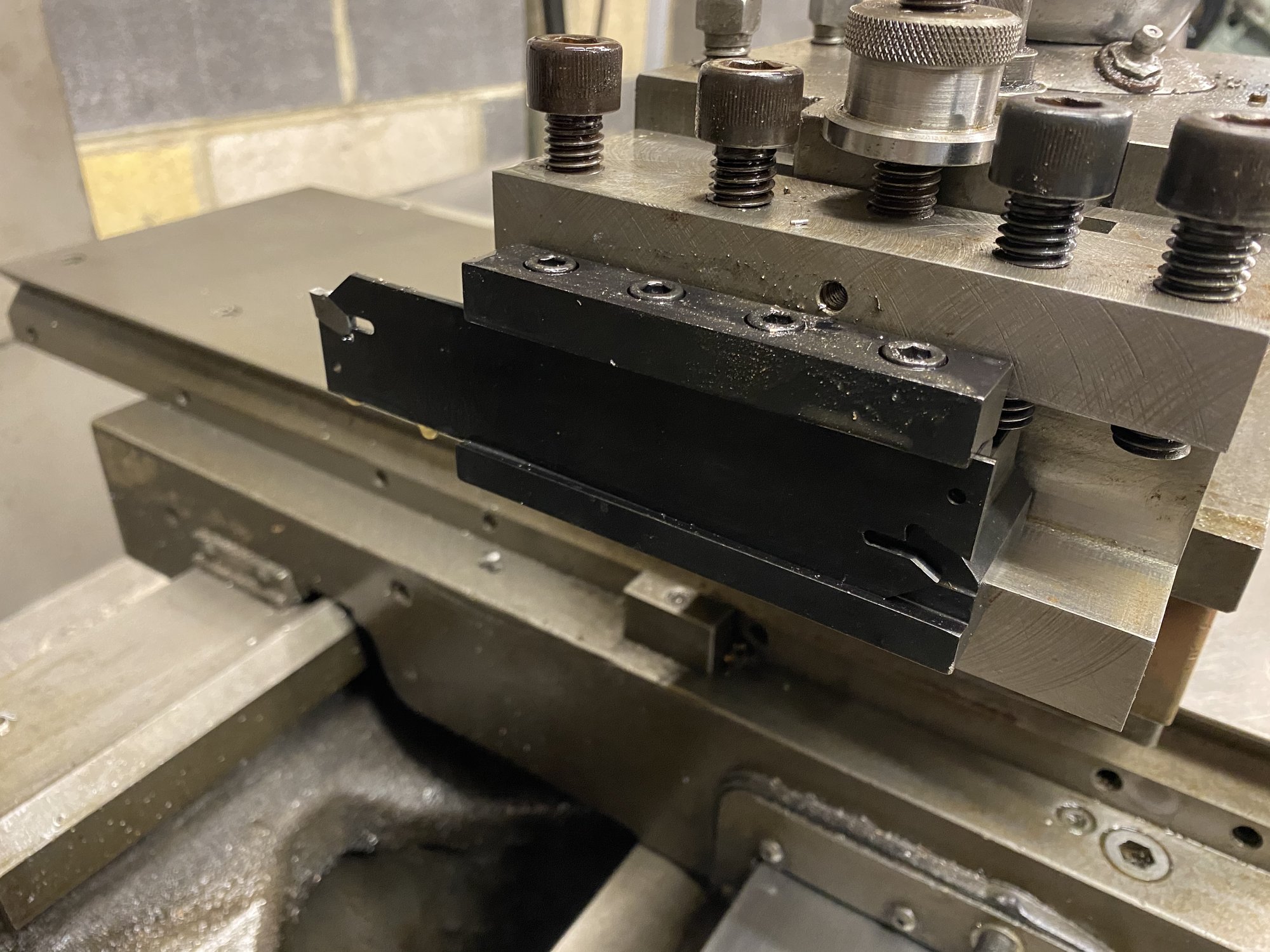

That’s a tangential type insert. Great strength and good finish.So I ended up buying a 3 x 32mm tool and holder new from eBay it came with some Seco inserts and after a few trial cuts it seems to perform better than the last tool. firstly because it’s more rigid and the Seco inserts seem to form the chip better than the Chinese ones.

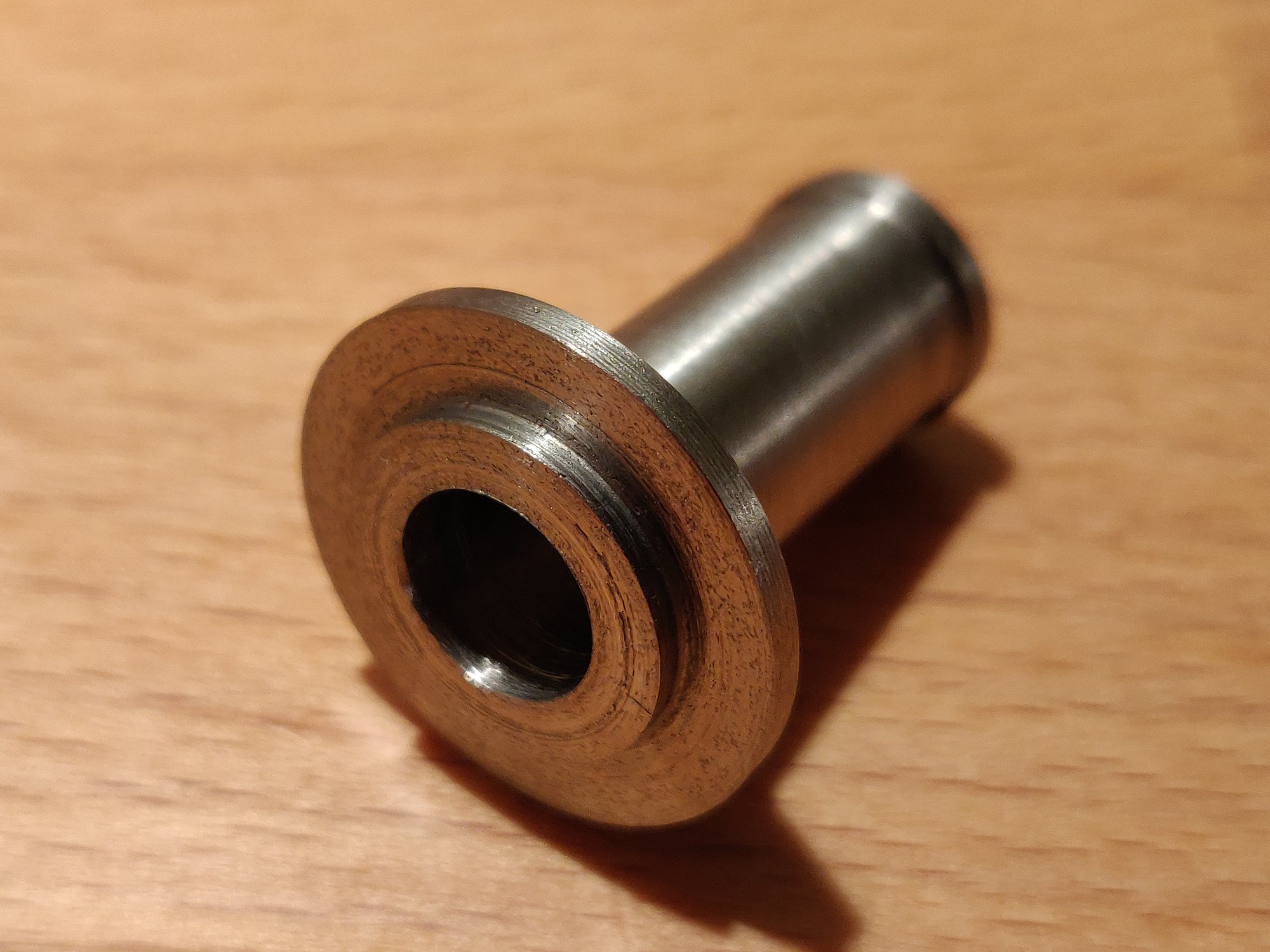

Iscar tangential. £83 for a kit from MSC. The finish you get is mirror

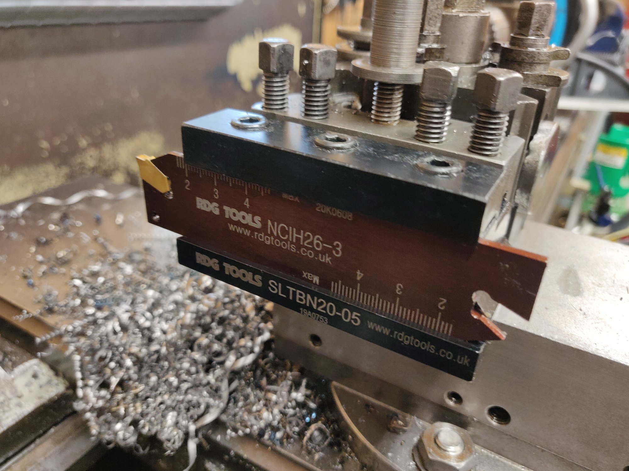

Model Engineering and engineering tools online from RDG Tools Ltd Home Page (Engineering Tools) Tel 01422 885069 /884605Worth the extra just for the etched graduations, I may have to get one. Had a quick look they dont show on their site or ebay.
