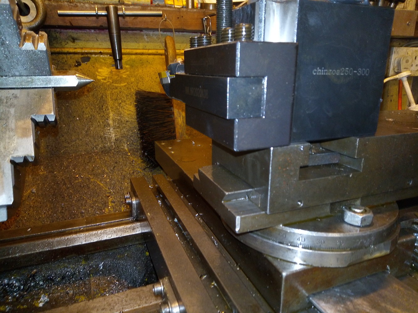

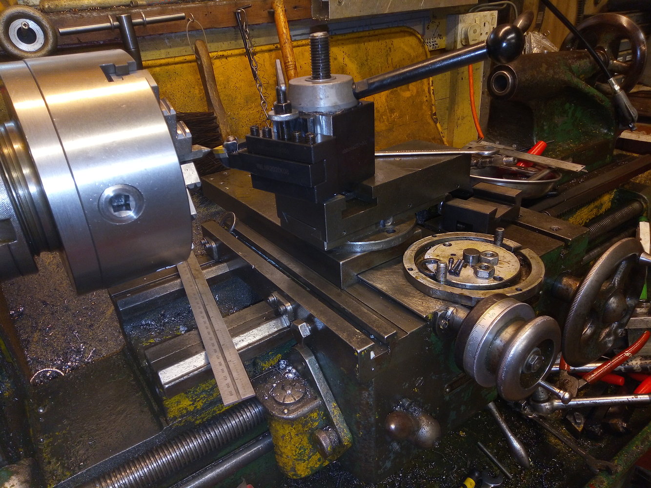

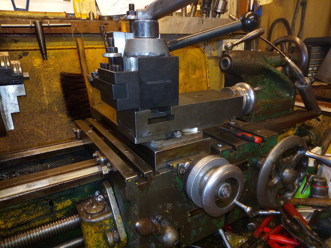

Problem discovered to be ..due to the cross slide having a mole hill where someone used a standard high tensile steel anchor bolt to secure the tool post to the compound slide ....... it rocked around the clock .
Once I'd filed & scraped the molehill off and turned up a decent base nut for the slide anchor stud I move over to a QCTP and triangular parting blades which have an inbuilt clearance on both sides .
