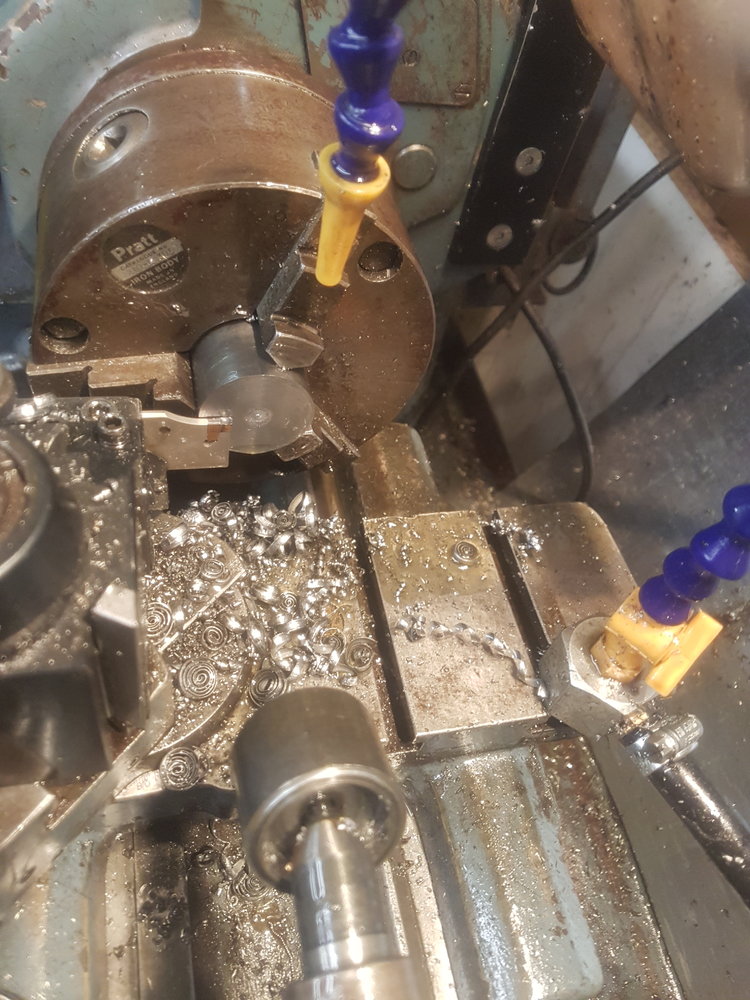

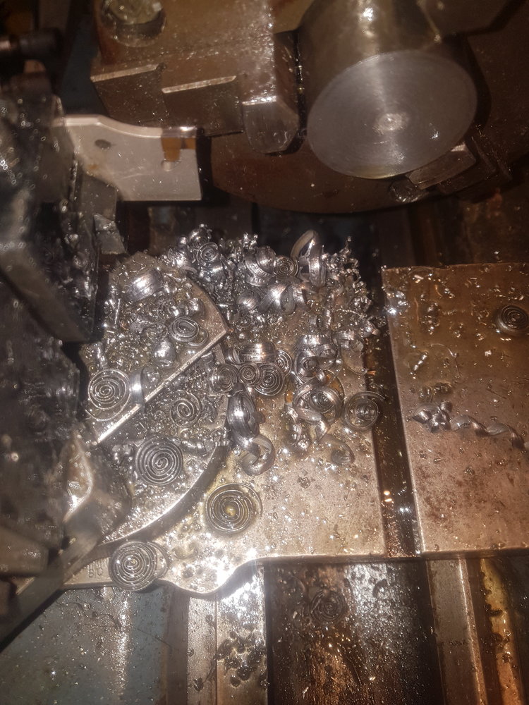

Have you tried incressing the speed and force ie are you running the speed fast enough and driving the blade in, mine seems to love speed and force. I know it goes agains everything i have read about parting, but it works for me, with an old Colchester MasterView attachment 320828I wanted to get some decent quality inserts and went with the shop-apt uni-tip branded GTN2's, as Id had good results with there other stuff.

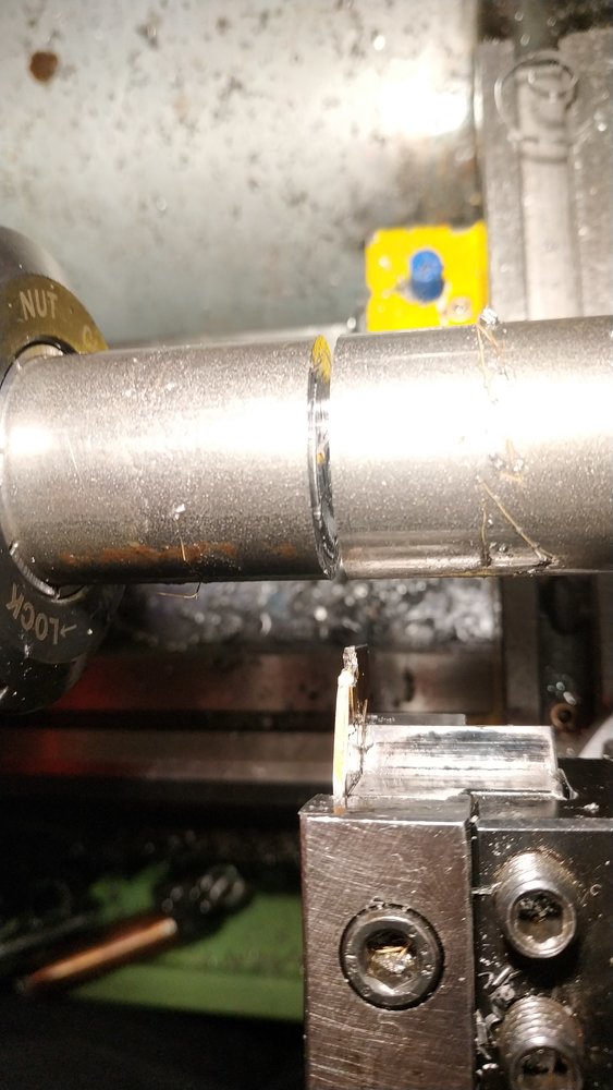

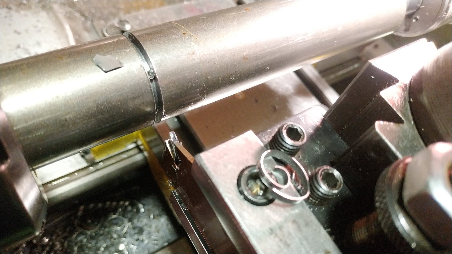

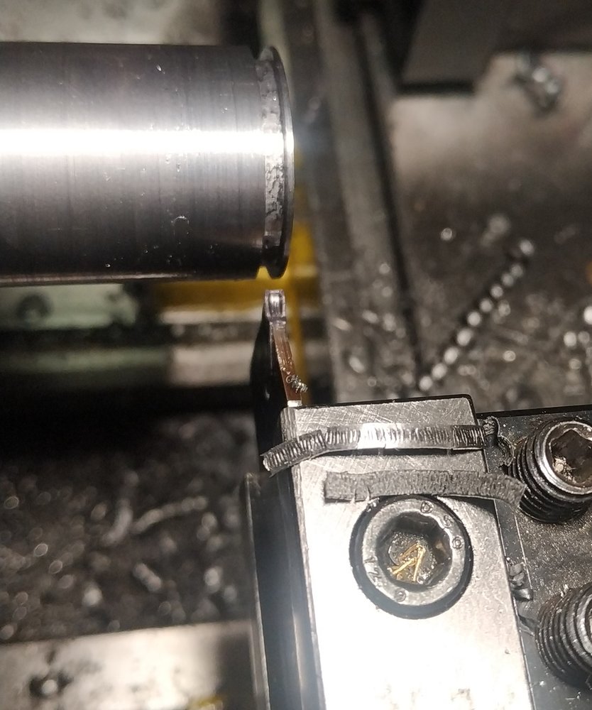

Cant get them to cut. Its on centre, Ive tried plus and minus. Does the swarf in pic tell anything?
I still have my last useable chinese gtn2 in other end of the blade, its chipped, but it cuts ok with decent swarf wheels coming off. This bar is just mild steel. These apt inserts have much less top rake than the fragile chinese ones.
I had problems earlier in the year, the Iscar blade and inserts were just as stubborn, lots of chatter and wouldnt cut properly, until I learnt to wind them in harder... Trird that.

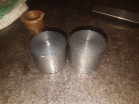

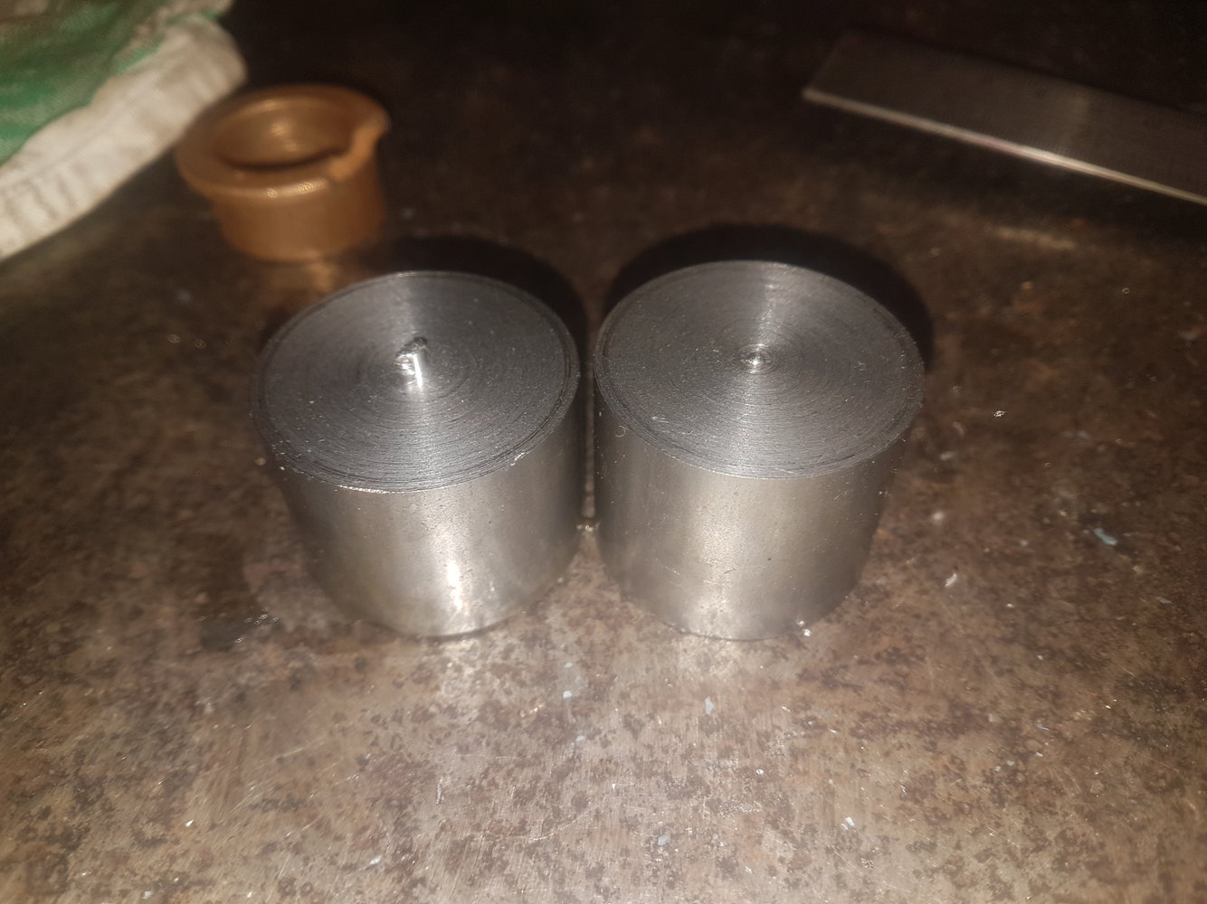

That little tit on the face tells you that you are not quite on dead centre . . follow it closely to see if it is above or below the cutting tip and make micro adjustments till it is gone .Very happy with the tool and it's set up now.

I shall put the tit bit back in the chuck and see if the tool tip is below or above the tit to start.
Hood ,It may be on centre, when parting the metal tends to shear off when it is nearly through and usually the extra is on the parted bit but it will also leave a mark on the part in the chuck, sometimes slightly recessed.
