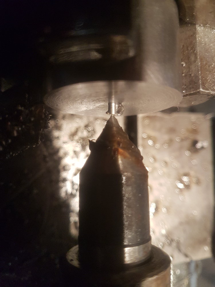

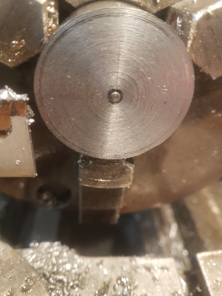

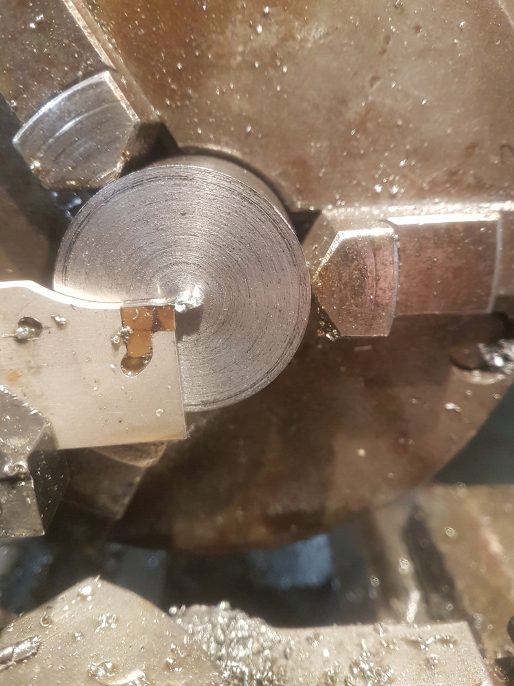

it was exactly that hence having to face it of, It was probably the dead center being wound up tight that made it snap offIt may be on centre, when parting the metal tends to shear off when it is nearly through and usually the extra is on the parted bit but it will also leave a mark on the part in the chuck, sometimes slightly recessed.
