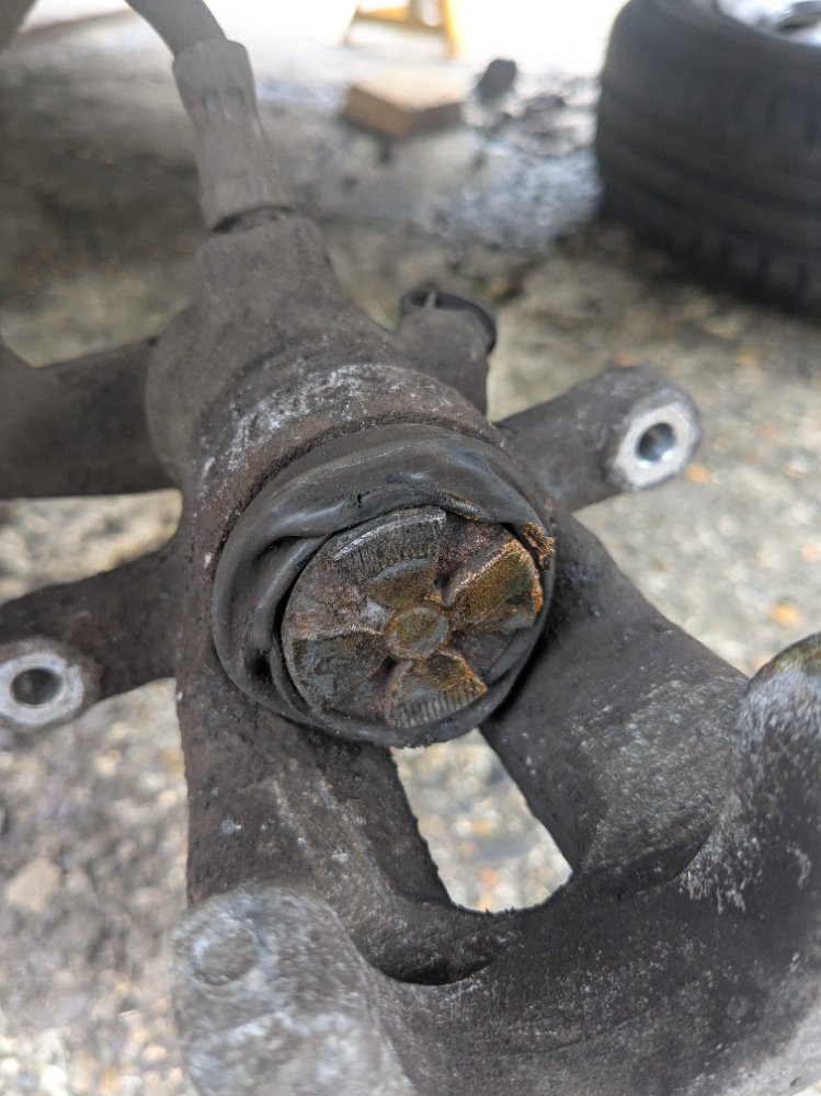

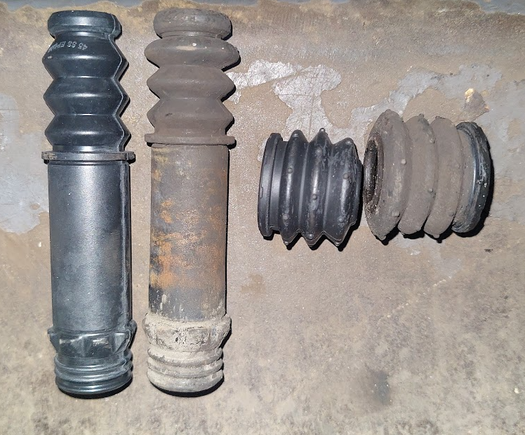

Jap stuff I've never worked on, I'm surprised really - I'd have thought they'd be more advanced than that but the Leaf has been around for 15 years so maybe they used whatever they had in the parts bin at the time, the Volvo brakes shown are the same design as used on old Mondeo's, which had a requirement for lubrication in the same location. I note the BMW instructions are 18 years old, so yes, 'in the past', there was a requirement for lubrication (not a slathering in copperslip though).
also guilty, new bake pads had nt arrived in time forr mot , so rumaged around and found a set of half worn, cleaned the backing plates, de glazed the friction , wipe on Wipe Off lithium on back plates (this is just rust preventative) , cleaned and greased sliders(lithium) and of to the mot , discs are now perfect shiny and it flew through with no advisories,happy days.We will get back to the - should we be fitting discs and pads at the same time debate.
