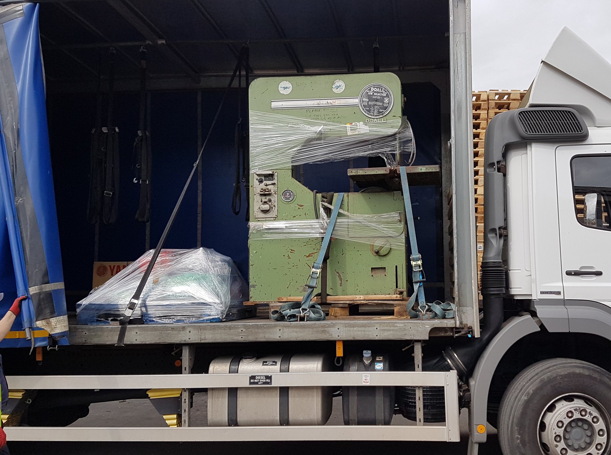

If anyone is sending a big bit of machinery don't be afraid to ask the driver to strap it. You could also put a huge sign on it saying - STRAP THIS!
I did cringe when he put a strap over the table - but he didn't do it too tight.
Delivered ok thank goodness. View attachment 118101
wow small world! I've got a bandsaw just like that one!
