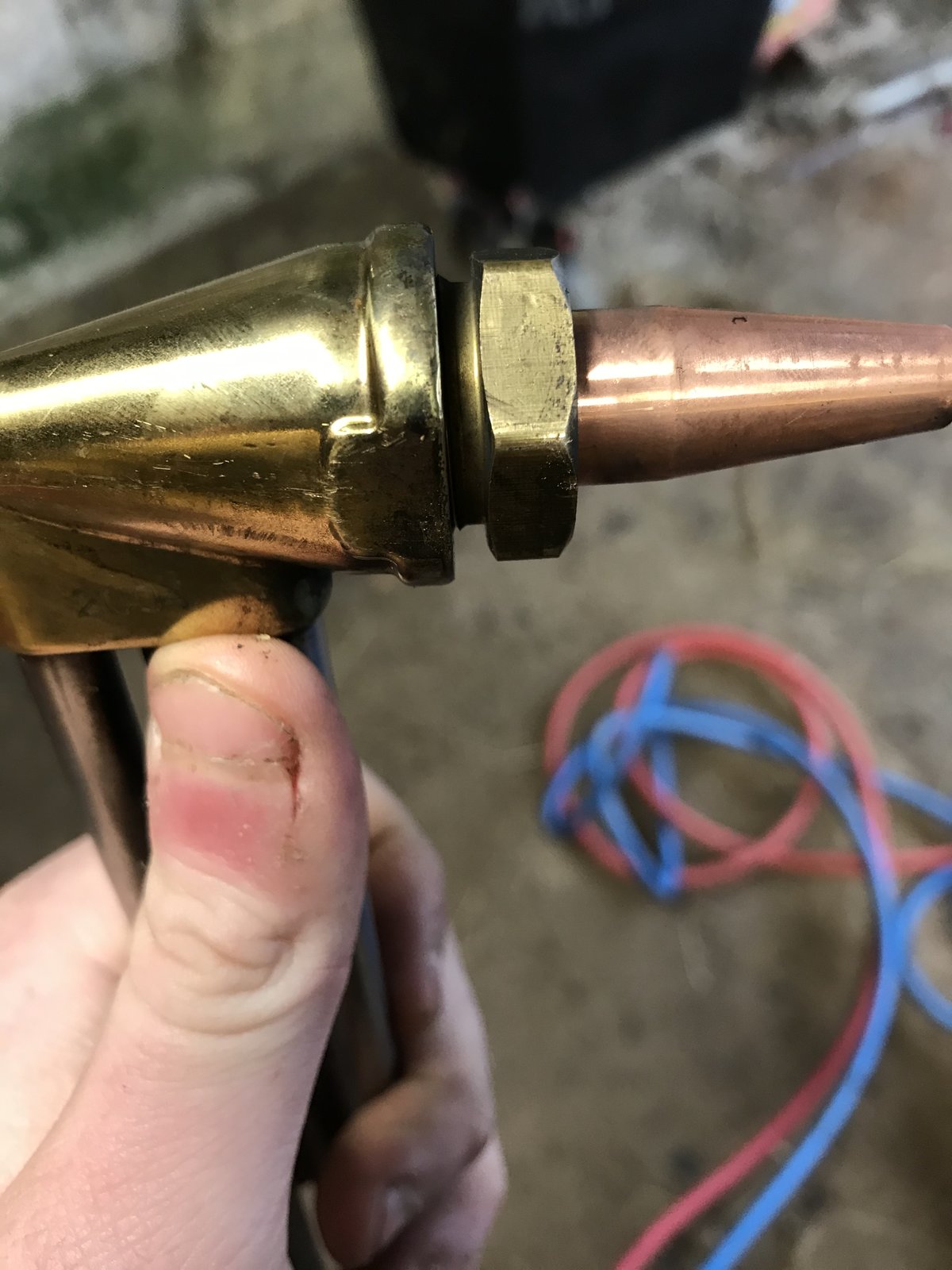

Have you also felt any warmth further down the body of the torch? As @James1979 that flame could be because the nozzle/tip is not seating properly. I'd be inclined to take the nozzle off and check that it and the seat in the torch head are clean. Then refit, make sure the nut is tight (but no too much) and fire the torch up. If the problem recurs, I'd personally get shot of the torch.Having problems with small flame coming up behind the tip where that brass’s nut threads in. Not sure it cause I overheated the tip or not cheers
Or are harris ones better?Are boc sapphires good torches?
there great. I have one for saleAre boc sapphires good torches?
I have a butbro set as well il never use
