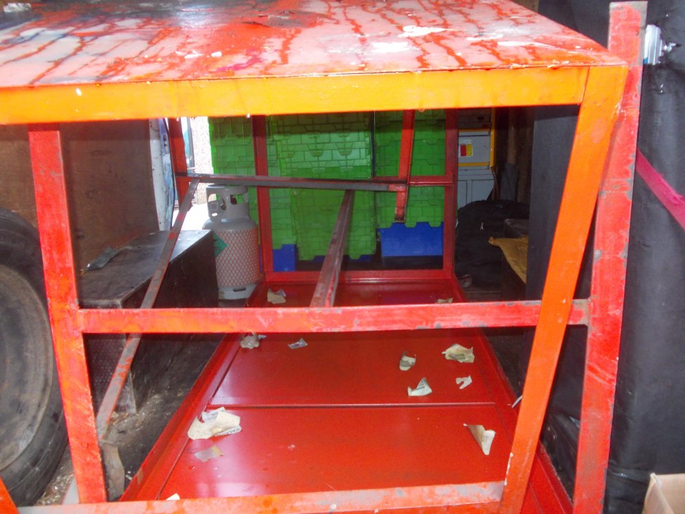

Digit extracted I have started work on a new welding bench, nothing special just a 50mm x 50mm x 3mm frame with a 3mm top, open fronted so I can sit and Tig weld with the Mig, Tig and plasma cutter stored under the bench..

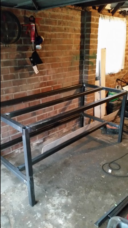

Gents, I am about to embark on a making a bench as my 1st welding project ….. (I thought making gates would be my 1st project BUT now I realise a bench must be !) I'm planning to use 50x50 box section & have managed to get some 10mm plate (6ft x 18" - 2 sheets) from my local metal scrap dealer. I was interested in the adjustable feet that appear in two of the benches in this thread …… do you have any more details of these please ?
They're just a stainless steel inverted shallow cup, filled with a rubber foot glued in. The extension is just a threaded rod of ~12mm. At the base of the leg is a nut welded on, and there's a locknut just below that. You just run the threaded rod up or down and lock it to suit. Maximum extension on these is about 100mm or so. I've run the extensions right back up into the legs on the small bench to create headroom for a pair of boxes under a shelf that's not present in these pics.Gents, I am about to embark on a making a bench as my 1st welding project ….. (I thought making gates would be my 1st project BUT now I realise a bench must be !) I'm planning to use 50x50 box section & have managed to get some 10mm plate (6ft x 18" - 2 sheets) from my local metal scrap dealer. I was interested in the adjustable feet that appear in two of the benches in this thread …… do you have any more details of these please ?

so guys and gals, I was thinking of doing the adjustable foot thing on the benches I made buttttt is it not a hell of a lot of weight to put on such a small surface area!? Obviously you have gone from say a 50mm box section on the floor to a nut welded on. Has anyone found them "give" under heavy weight?
