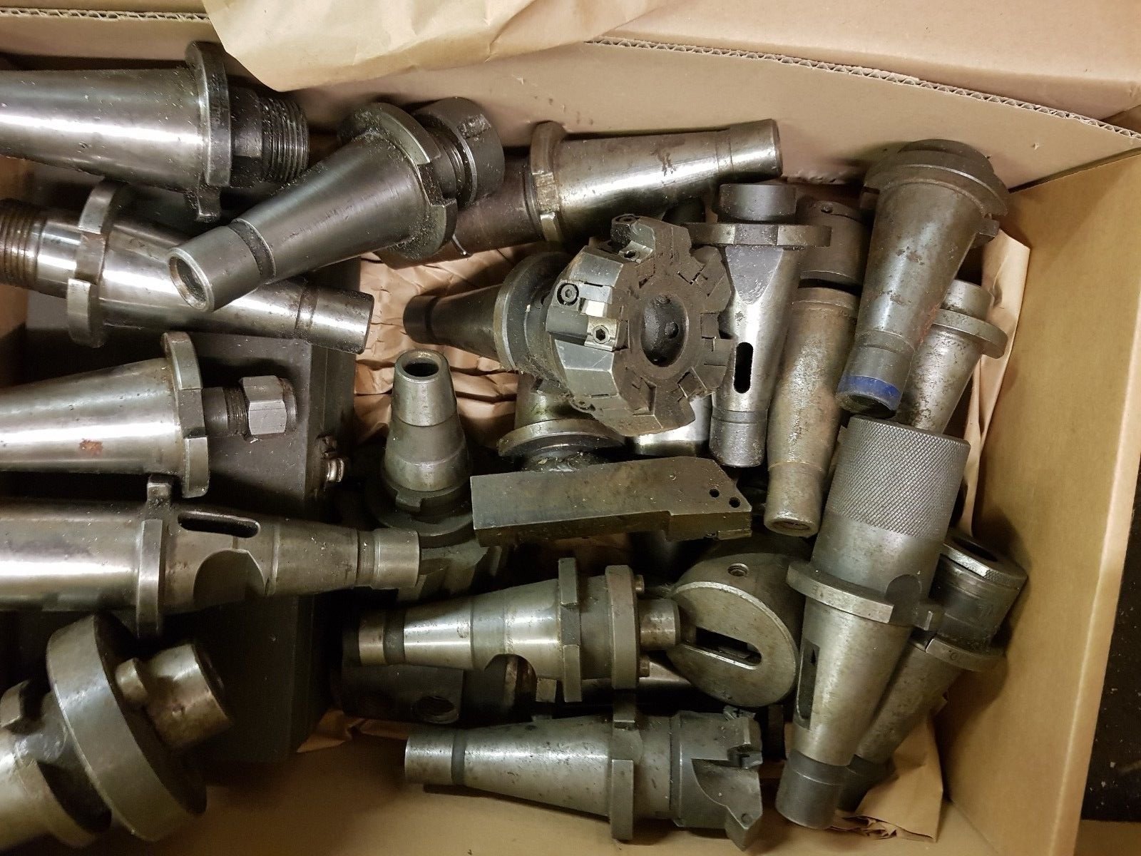

What I did for a mates mill was make up short sections with male and female threads so that once screwed into a BT holder it mimicked an INT one. That way the same drawbar could be used on all tooling.The difference is in the spindle drive tenon depth and no drawbar thread part so you make up a longer drawbar to utilise the pullstud thread
