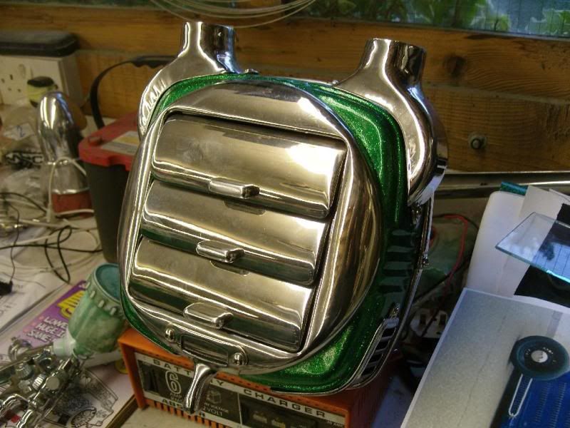

In an odd sort of way I suppose all this custom fabrication without any plans to work from is a bit like snooker where you have to be thinking three or four steps ahead all the time to ensure everything works out (most of the time)Belts are the easy partas you can buy any width/length you like off the shelf, as this is a twin vee belt setup I will buy a matched pair. If you look at the part number on a belt its the length in mm's
!!! Why on earth they never made the housing a bit beefier is beyond me !!!
. This was parted off to give 4 rings 3/8" wide by 1/4" wall thickness, these were then bored out to fit snugly and pressed into place. Only the front bearings really need doing but I did them all anyway.
heater box I ever seen .
