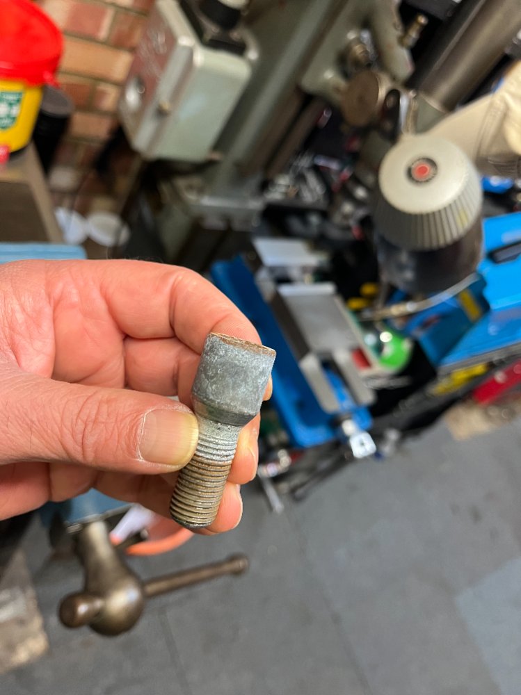

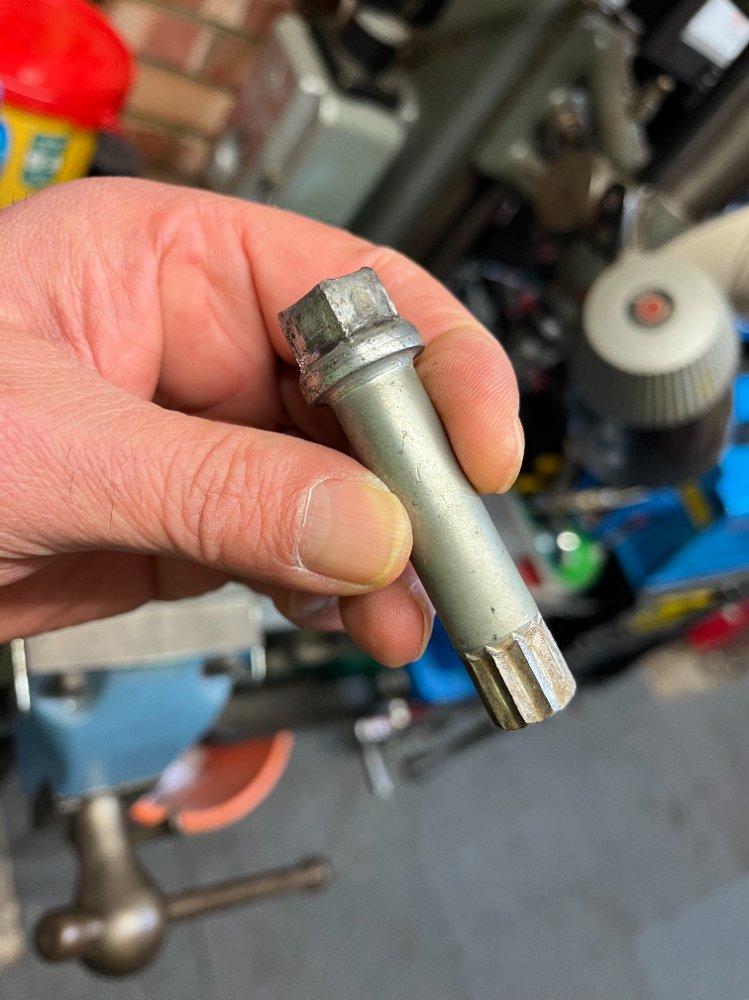

Son has a 2010 Sirocco and it's lost a wheel bolt - MOT failure....

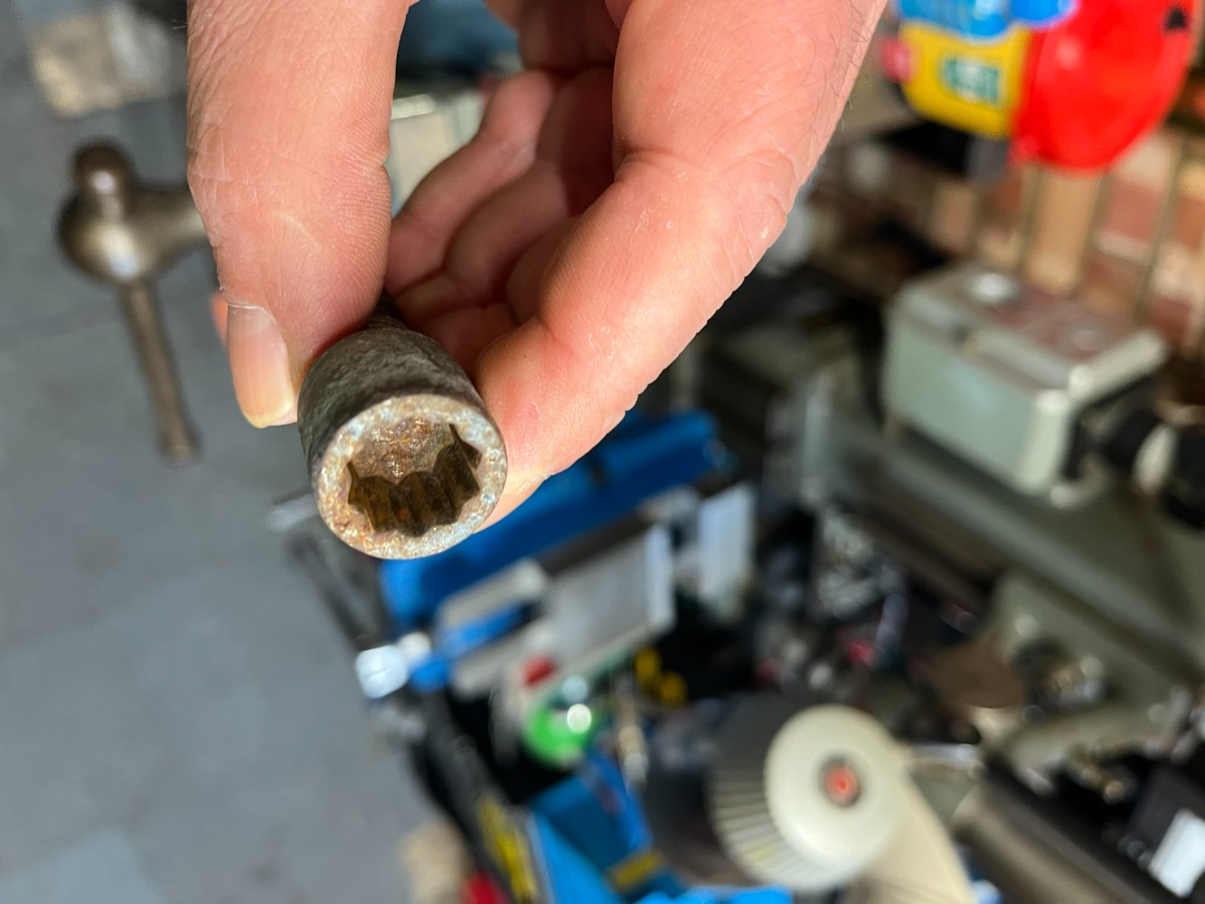

It's got chav Bola wheels with the pictured 10 point internal bolt head, its a pretty standard m14, 1.5 pitch, 26mm length with R13 cup. Apart from the bolt head!
I've emailed Bola to ask if they have replacements, they are not really locking wheel nuts as such, as all 5 bolts per wheel are the same odd head, but of course you need the special tool to get them out, and I reckon the special tool/bolt head setup is a liability, the adapter appearing to be rounding off...
Expect to get a stiff ignoring from Bola, has anyone seen a source for this type of wheel bolt as I can't find them.
Plan B would be to replace all 4 corners with standard bolts and locking wheel nut each.

I've followed on on email so wait to hear back in a while....
