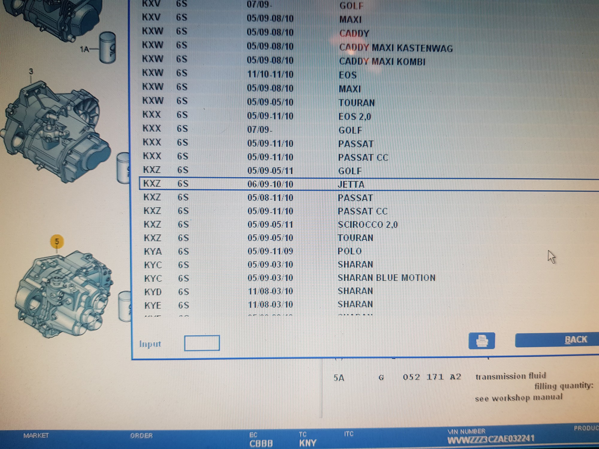

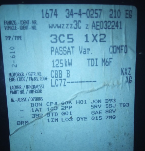

If you look in your service book or at the sticker in the boot you'll find the transmission code. They did give issues with diff bearings, if you want to be sure before dropping the cash on a box just run it through the gears with the 2 driveshafts removed.
Somewhere (probably around the spare wheel well under the carpet) will be a sticker; it lists the VIN, all the accessories and the engine & gearbox codes. I can't remember for sure but I think the gearbox codes are 3 letters like the engine, your engine is probably a BMN if it's a 170 (have the same in my Golf).

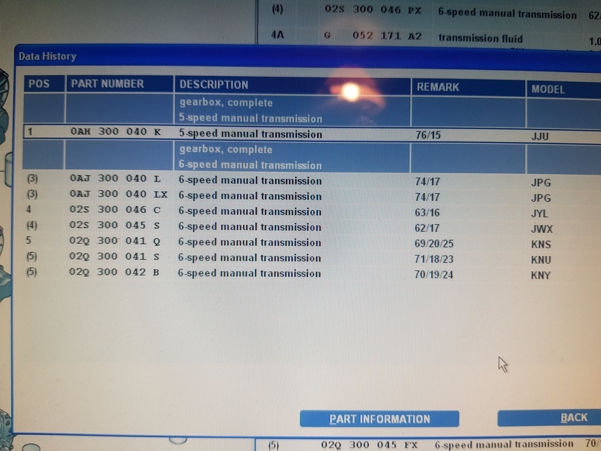

Once you know your gearbox code you can try and find a replacement, as long as the code is the same it will work. Petrol and diesel are definitely different ratios and will confuse the ABS (and cruise control if you have it) as already said.
