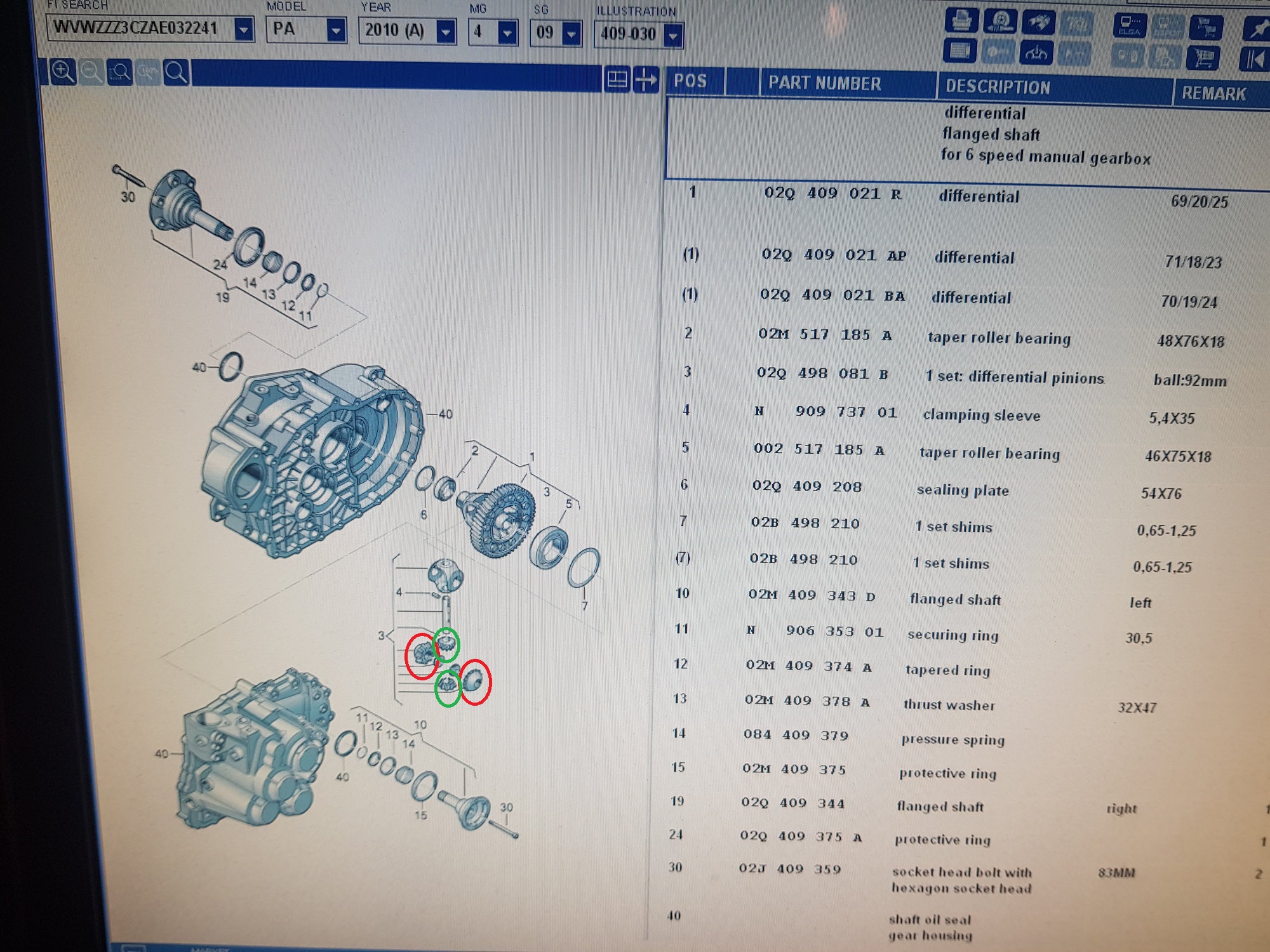

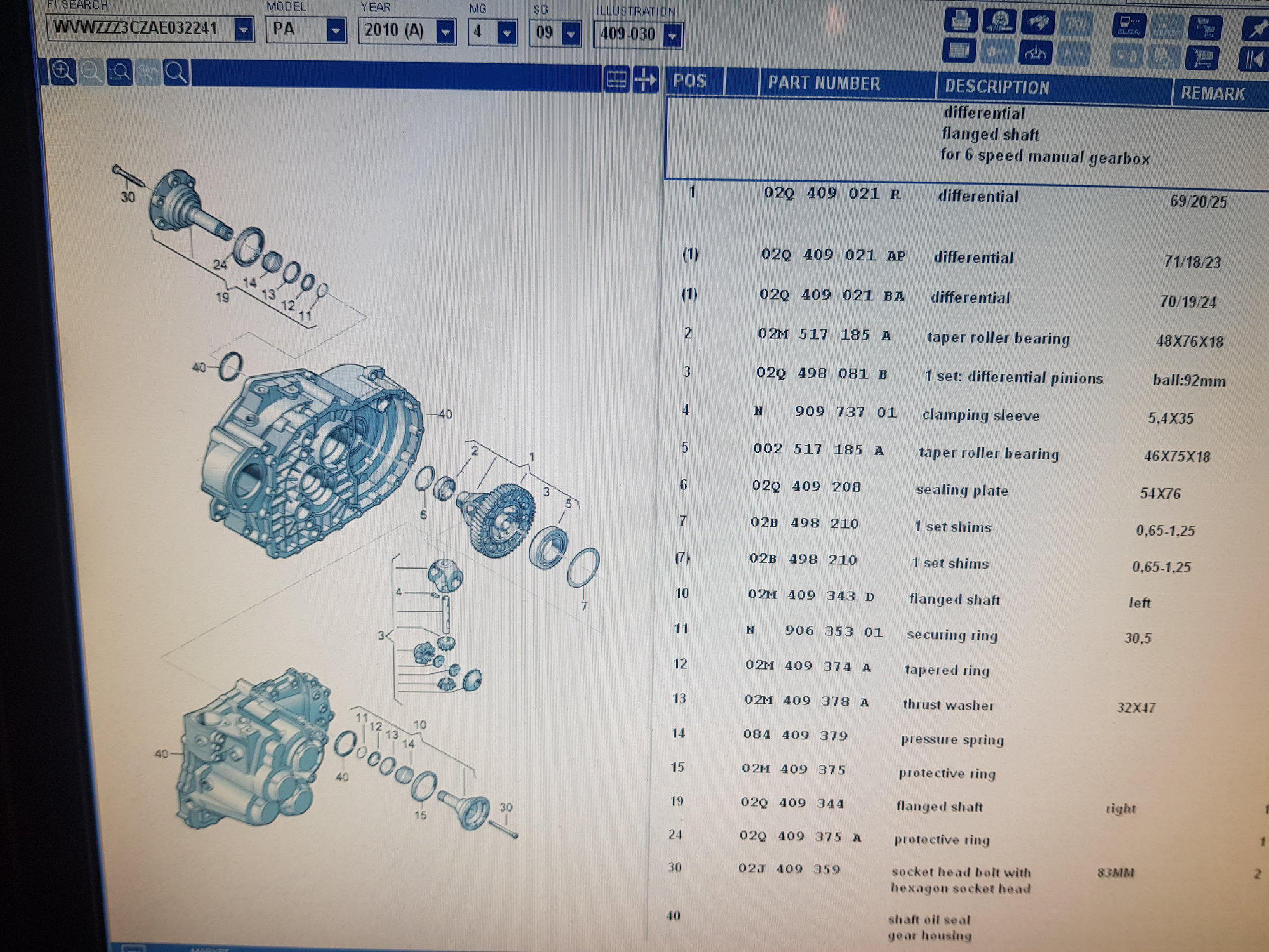

Thanks for all that. There is one from a Scirocco on eBay and your pic confirms it is correct, quite expensive though if I recall.
Looks like I am going to have to get another car for the time being, just back from working on the Cheetah Cat and the closer I got to home the noisier it got and going round corners it was really grinding sound and I could feel a wee bit of snatching.
