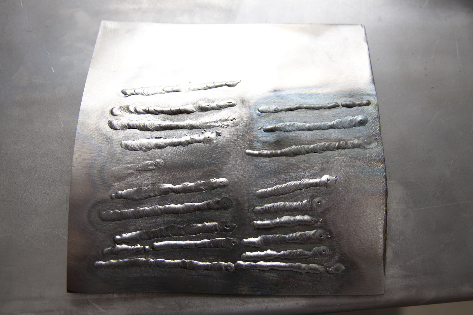

I'd like a pedal but would probably cost as much as the welder.So are those worm holes at the start of the runs the reason why a pedal is a good idea or can the trigger on the wand eliminate them ( I don't have a pedal YET ! )
The craters are at the finish of the bead, they can easily be eliminated by using a bit of slope down and / or backstepping a little at the end of the run as per this video from the tutorial,

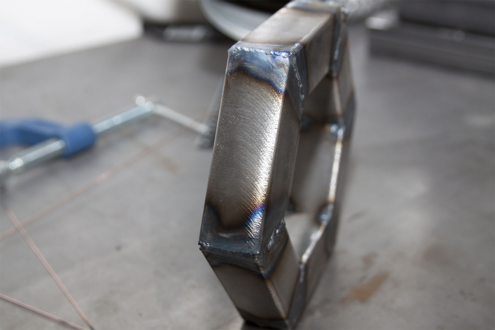

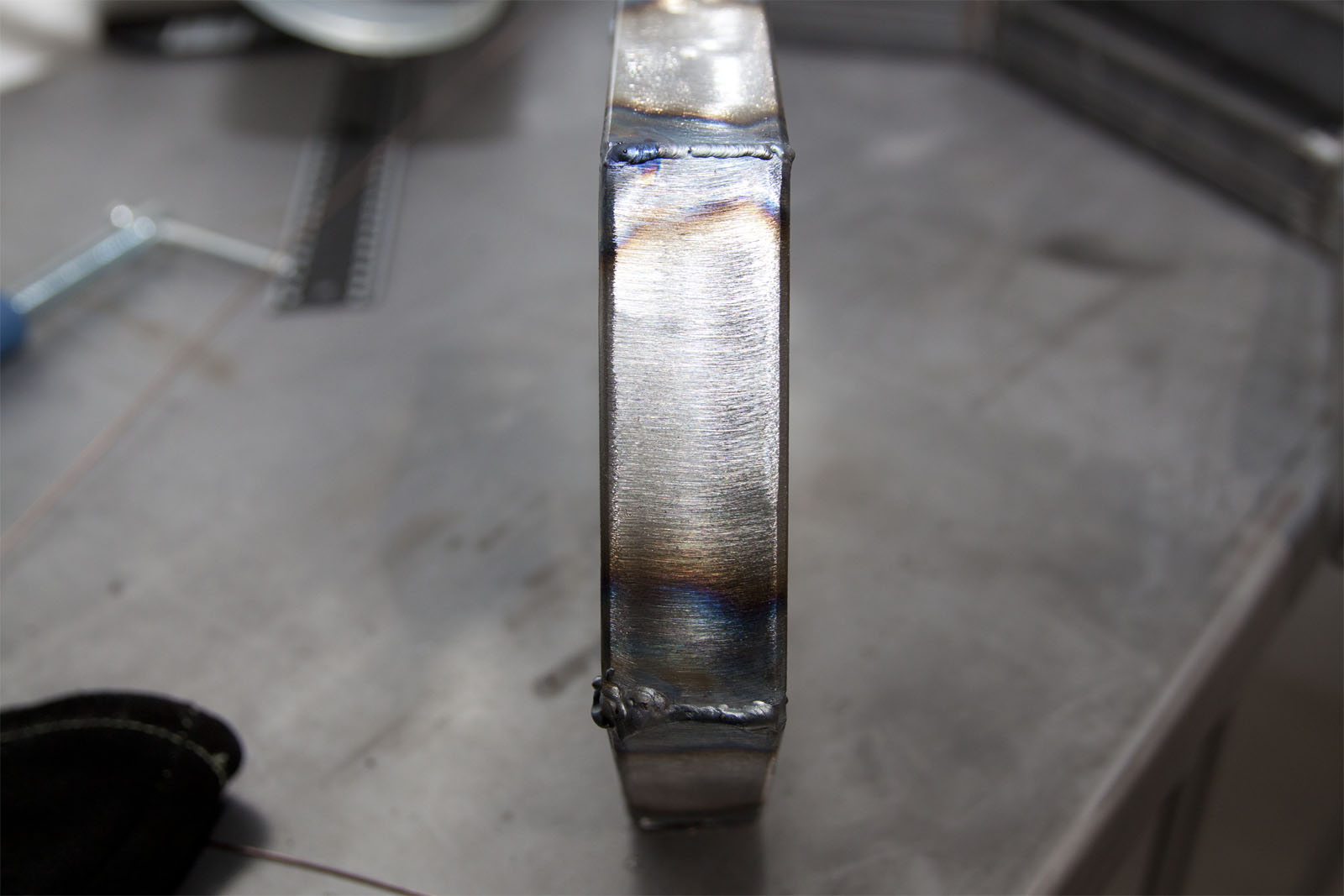

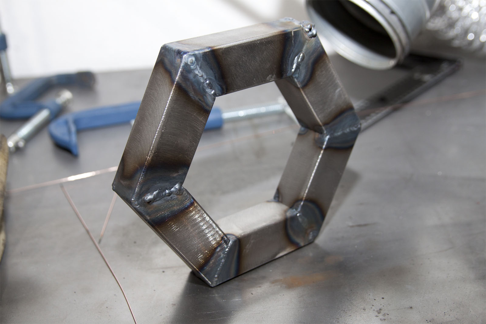

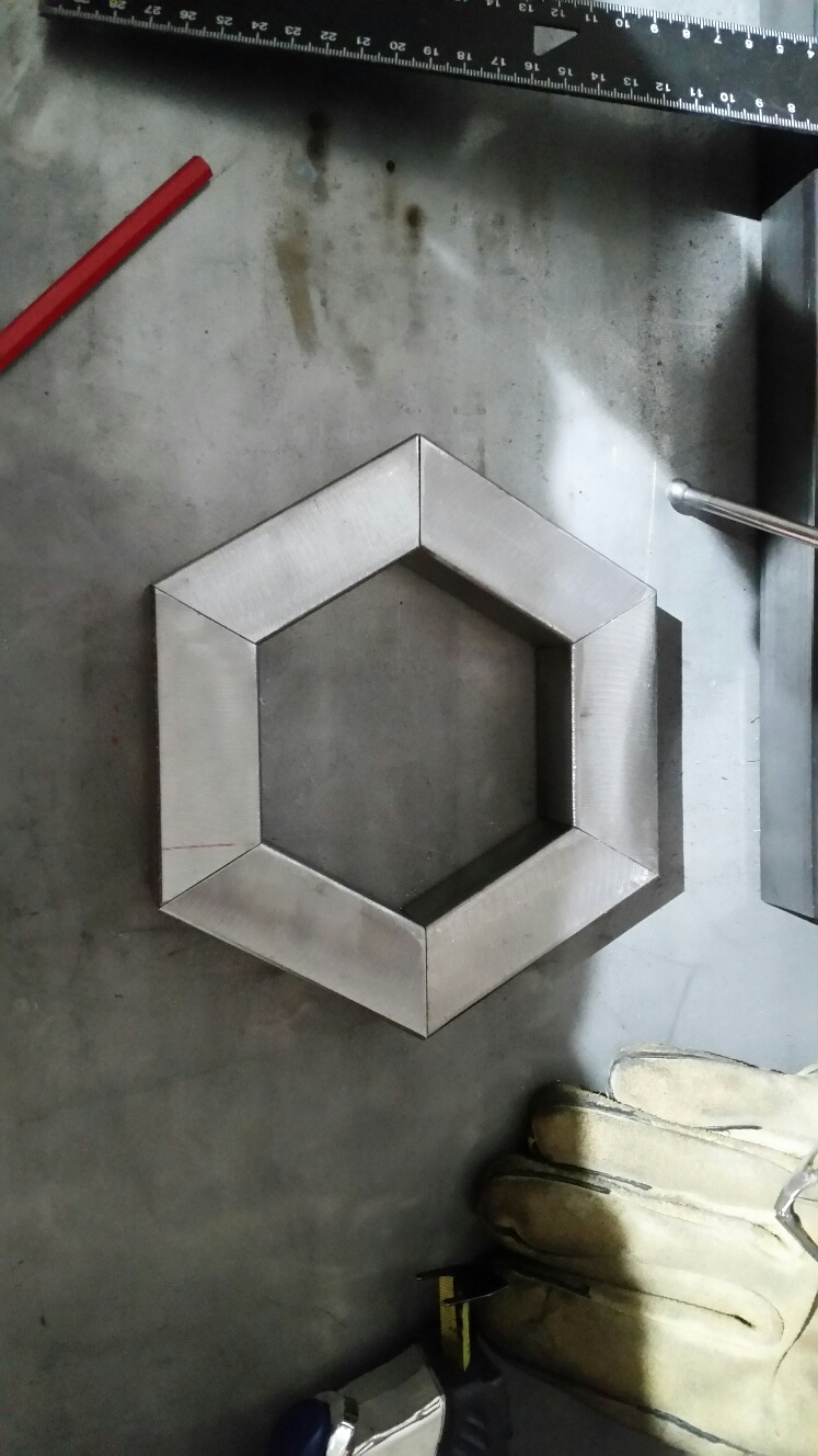

Your plate runs should be to an excellent standard before attempting joints on thin walled box on the plus side if you do get the holes filled you can linish those welds back and the actual item could still look nice.
Tacking is a skill in itself and one that can be more challenging than the actual welding when dealing with thin wall.
This is a case (should of mentioned earlier) when all slopes settings are better off tuned off.
Good fit up is key and hit it fast with a high current, get fill in immediately and come straight off.
Practice that till you have perfect tacks every time.
When you come to do your run turn your current back down to a level that's suitable.
