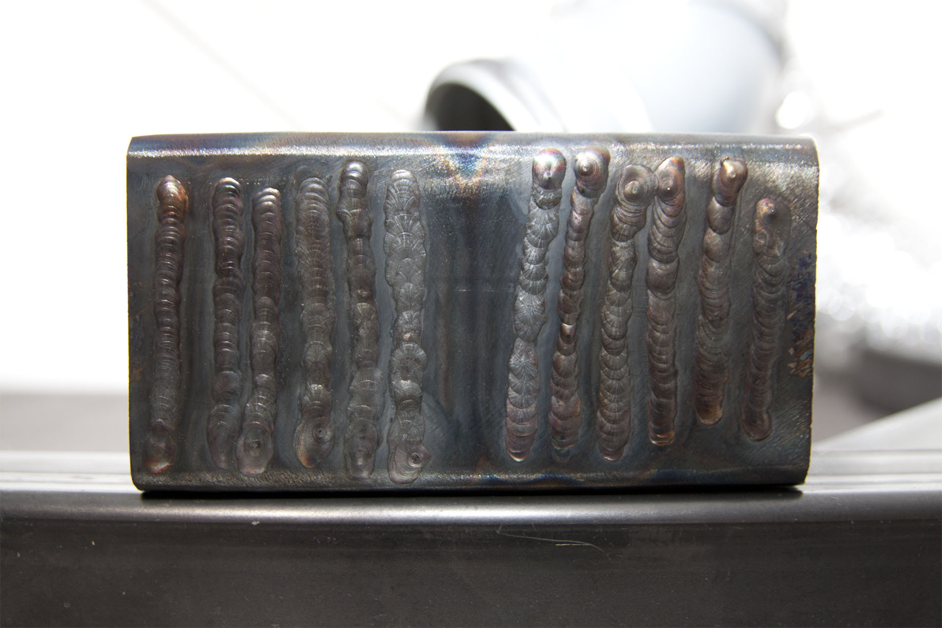

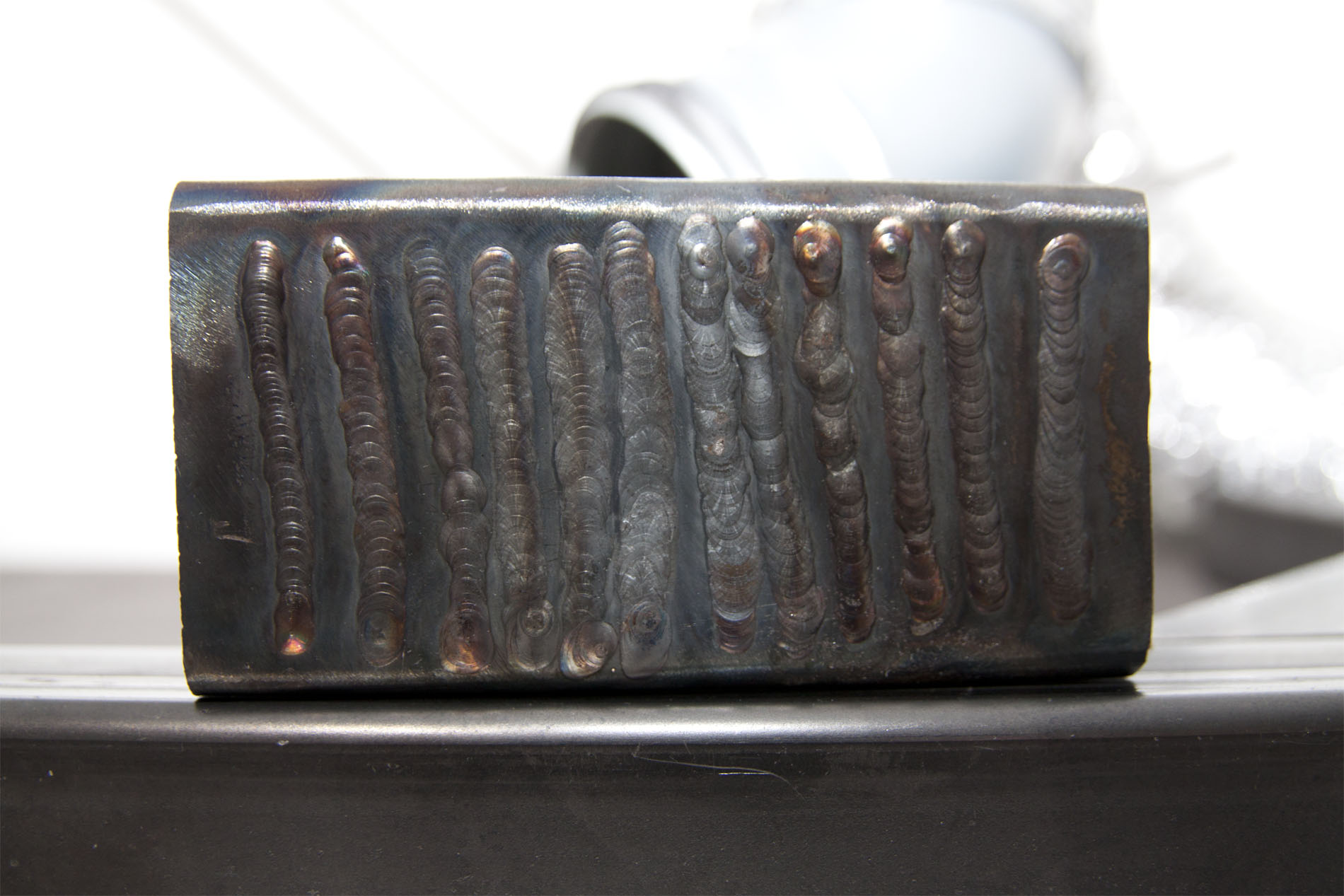

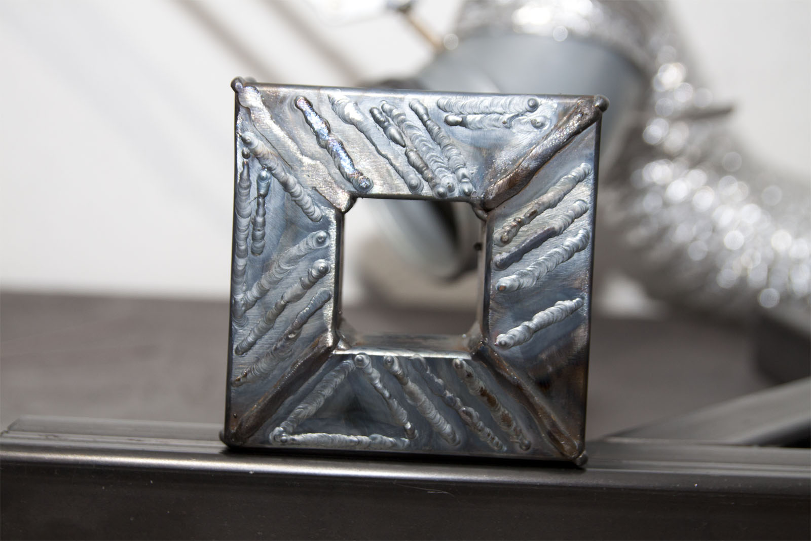

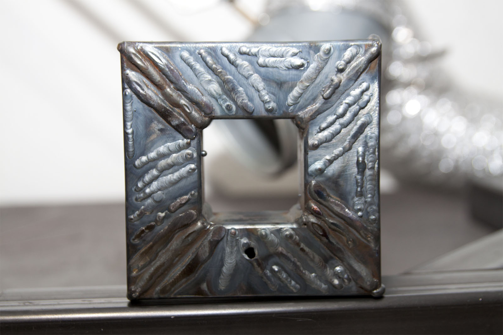

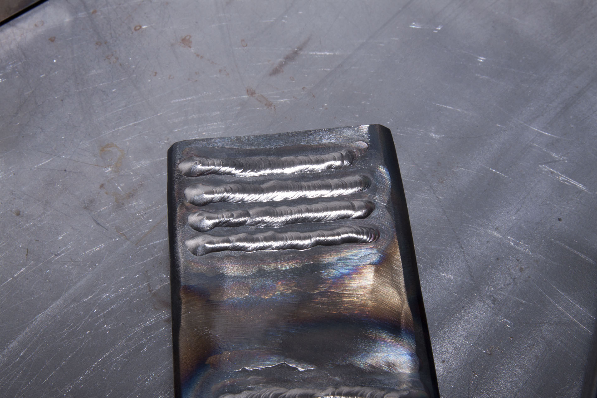

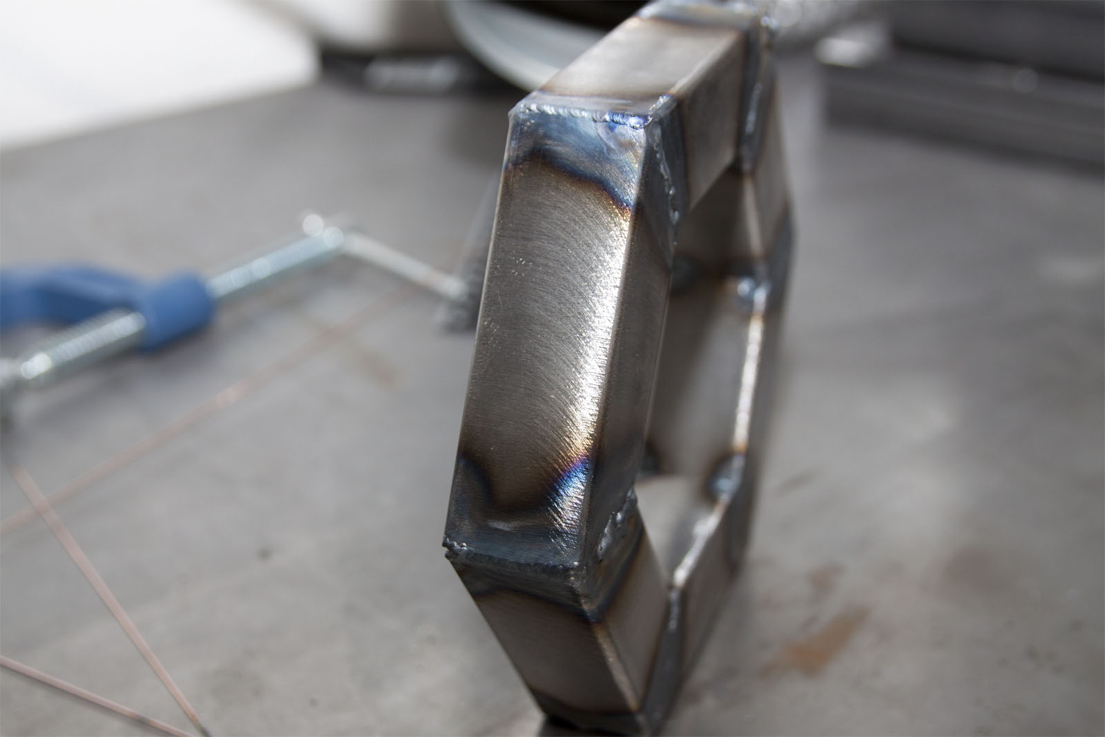

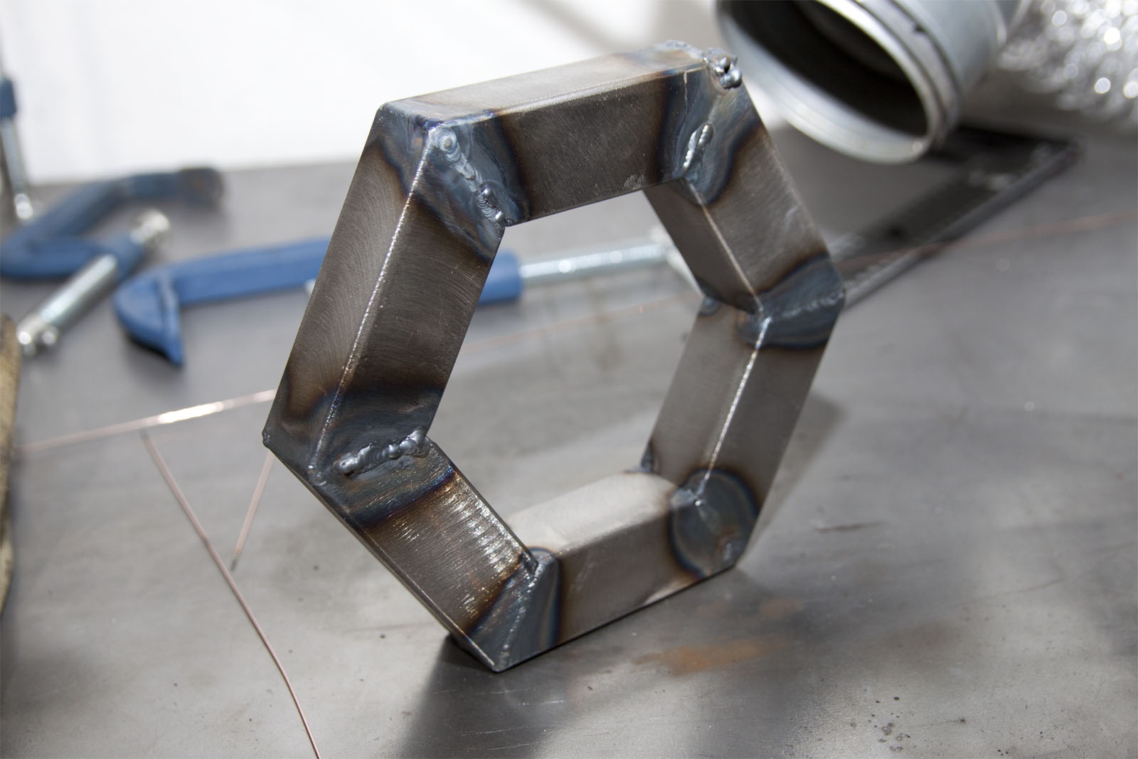

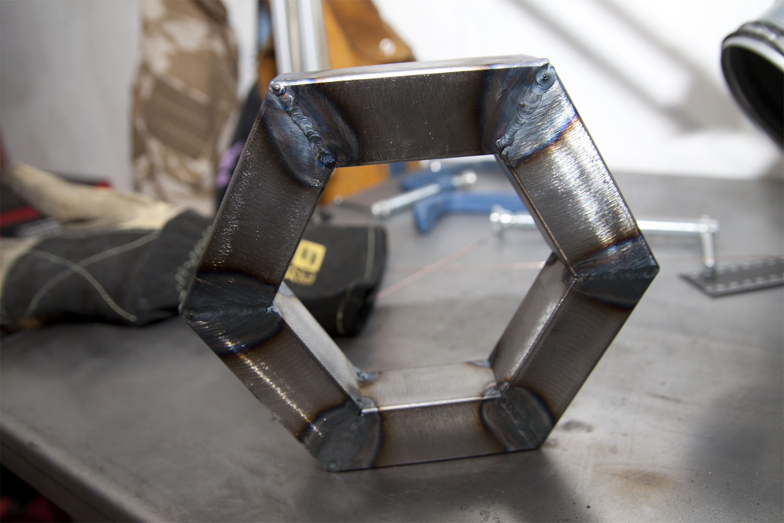

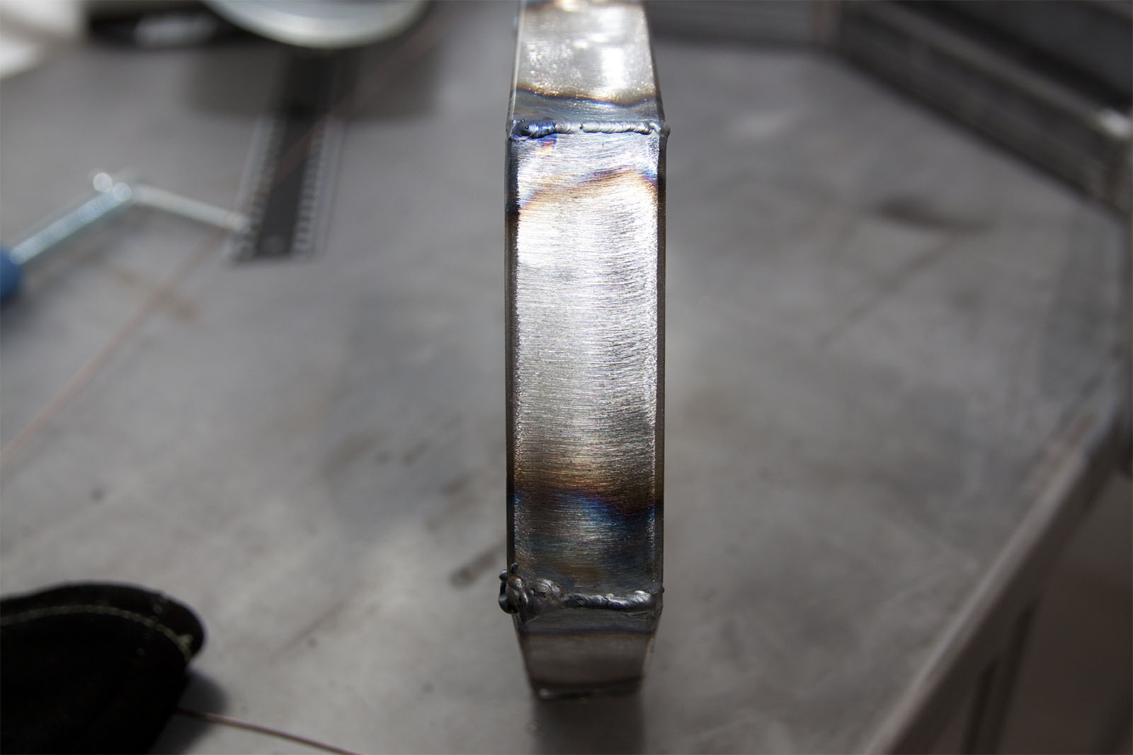

I made a right mess of that.
I struggled with the tacking up the tungsten would ball up straight away i don't get it was not touching the metal.
Made a few holes when tacking up tried to fill them later and made them worse. I thought about getting the MIG out as i'm ok at filling holes with that
I found the outside corner joints the easiest.
Gone though 40 bar of 200 is that normal?
View attachment 93941 View attachment 93942 View attachment 93943 View attachment 93944
Sorry it didn't ball just rounded off after one tack. When welding a bead it would stay sharp.Your tungsten shouldn't be balling up on dc ???

.They are coming on well Daz. Some of those look very uniform.

.Any suggestions of where I've gone wrong on the DC TIG ?
. Start off with some thicker practice material Dapph.I do have a snapped blade somewhere, will have to dig it outChicken !![]()
