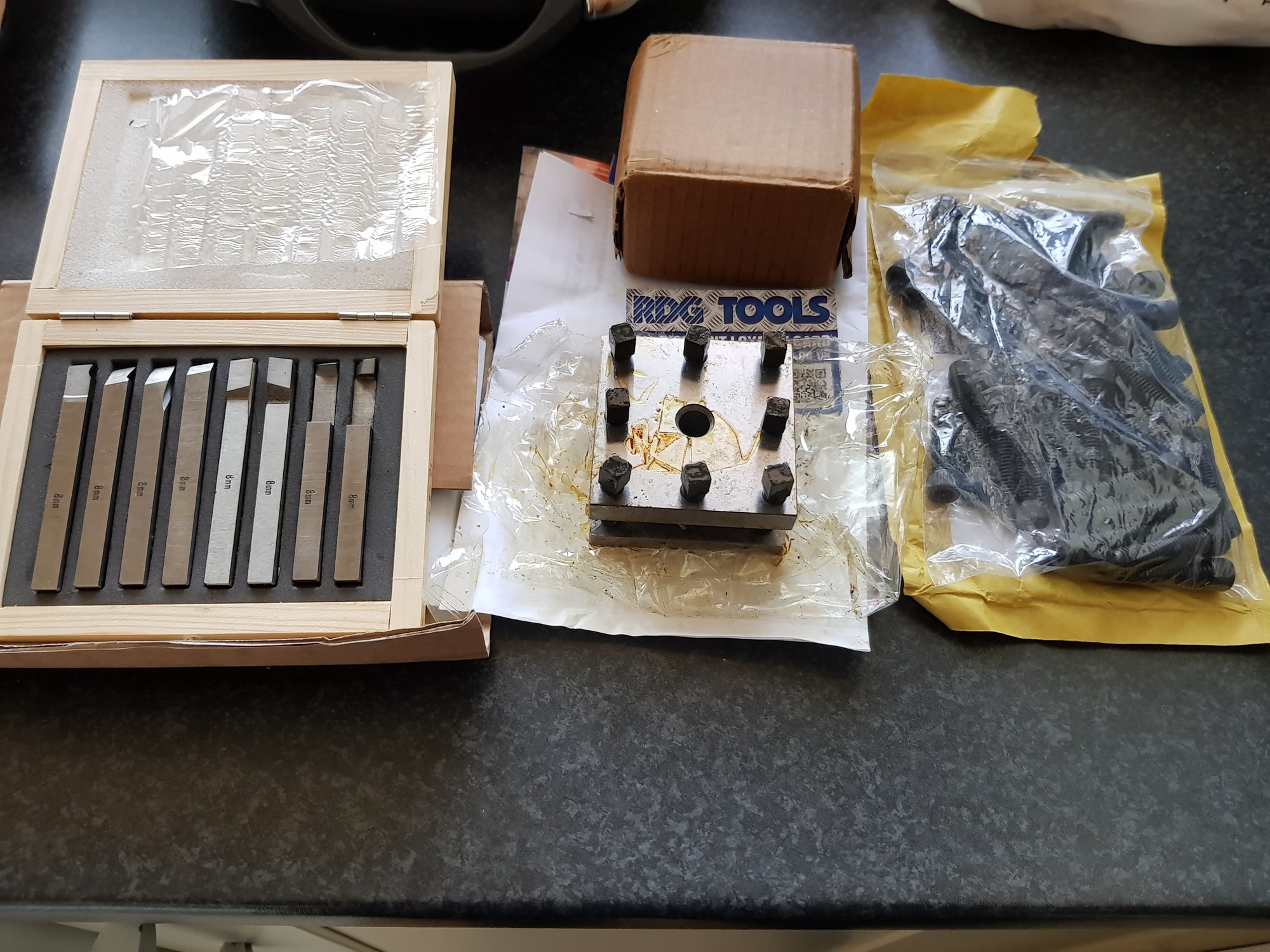

Sorry. Got confused. Picture is tool post. It's only a fraction bigger but will work with a little fetling.New tool post, I missed that, which one?
My plan is to drill the centre hole out to 13mm. This will match my new post stud. The stud will have a 5mm thick washer machined in to it. One end will screw in to the top slide and the washer will be drilled and pinned . This will stop the stud from turning when undoing the the top nut. If that makes senseSorry. Got confused. Picture is tool post. It's only a fraction bigger but will work with a little fetling. View attachment 122820
