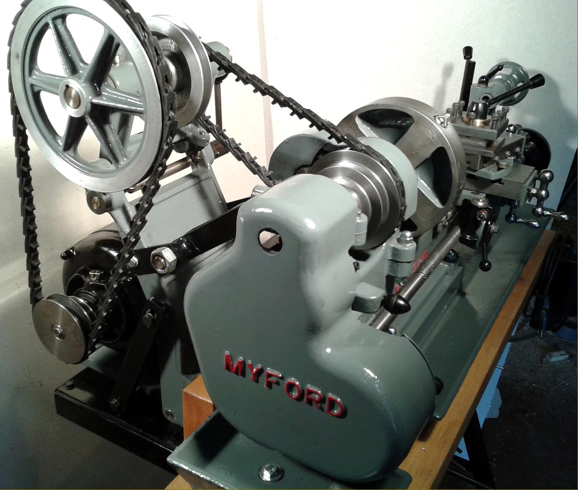

My plan is chaps. To use the complete motor bracket ECT from the ml4/7 This will bring the motor closer but allow the use of the other pulley system. This will gear it down.

It's 1930s. Just takes a bit of setting up. But no graduations makes things a tad awkwardI really like the ml1. It’s a cracking looking old schooler.
What do you mean no graduations? Do you mean no scale to tell you how far you are moving a slide.It's 1930s. Just takes a bit of setting up. But no graduations makes things a tad awkward

That was my method too. Simple but effective.No graduations isn't a big problem, just touch off and put a clock on the slide you want to use. Lots of older machines had no scales/graduations on the slides, you just have to work with what you've got
My biggest niggle was apron controls were direct. Turn clockwise to move saddle left. Drove me nuts.

Yes mate sorry. Scales.What do you mean no graduations? Do you mean no scale to tell you how far you are moving a slide.

It might bother you if you use different machines...
I've experienced machines where every control is 'backwards' - certainly gets the brain working
