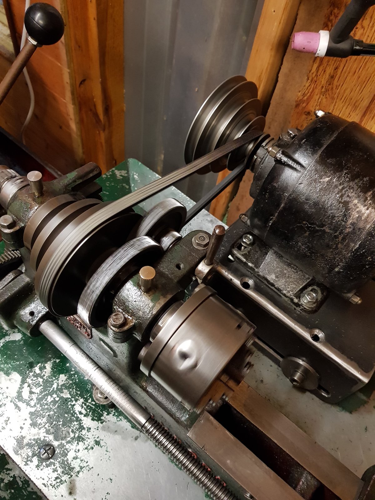

Today.. I stripped the headstock for a clean up and make some adjustments. Also got the back gears sorted and working.
It's only in a temporary position. Will get moved when I get a different bracket.Is it possible to swap the motor to the other side? I'm just thinking it will get covered where it is.
