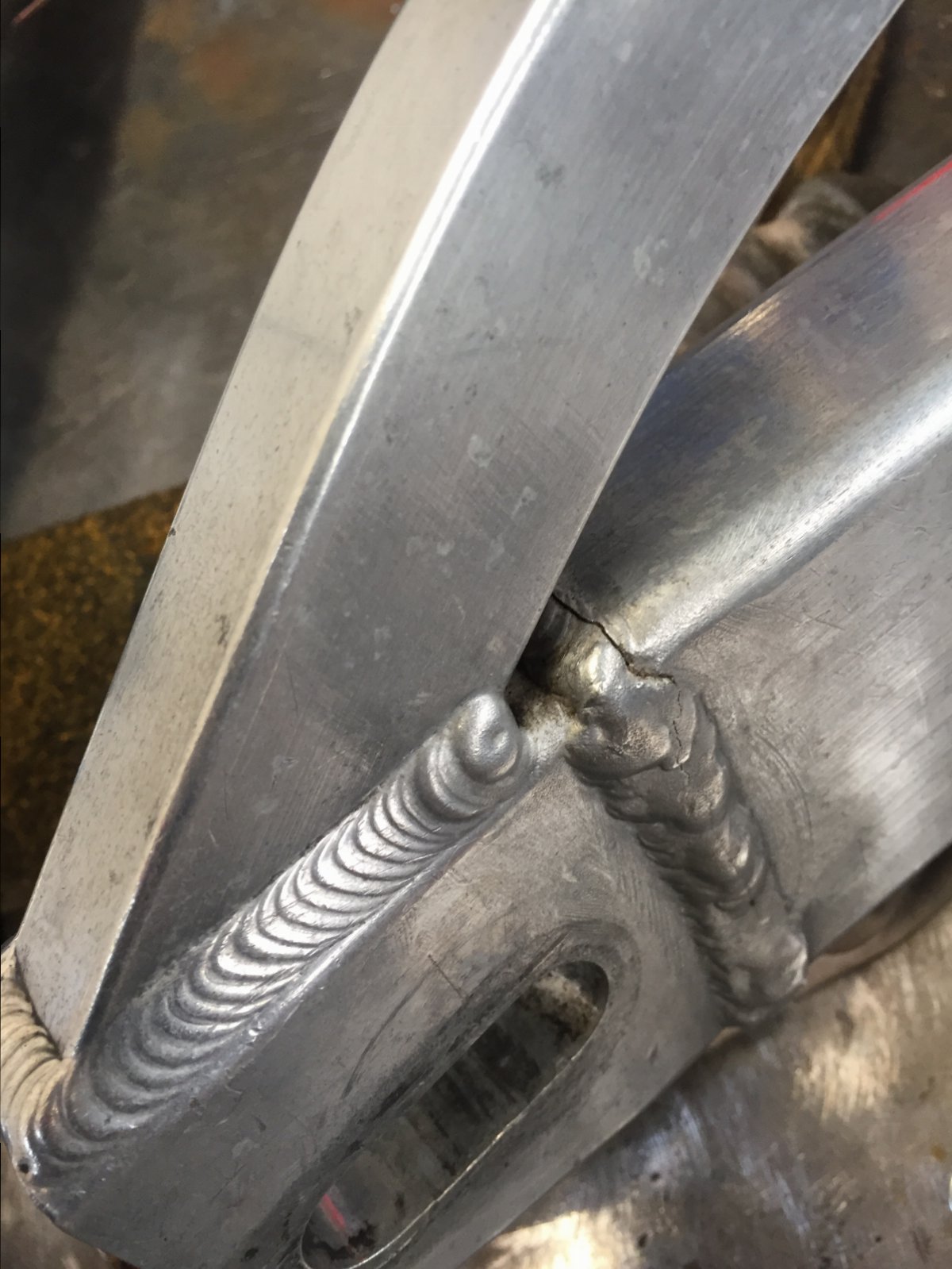

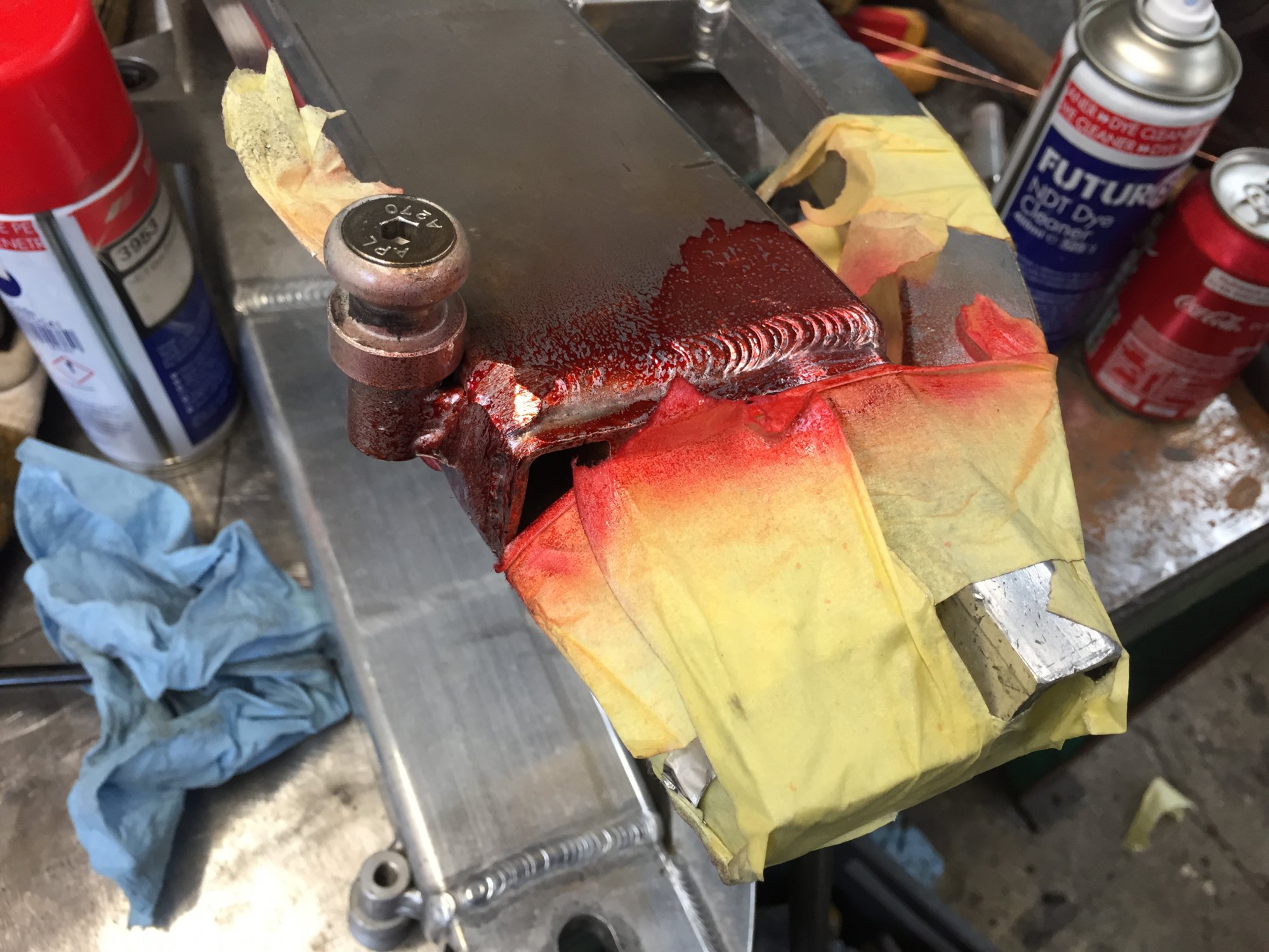

Honda RS Two Stoke Swingarm Repair
7020 Alloy. Constructors manual recommends 5356.
First photo shows the damage previously repaired. Not sure what happened but bike has taken a proper knock at some point. Done with a MIG.

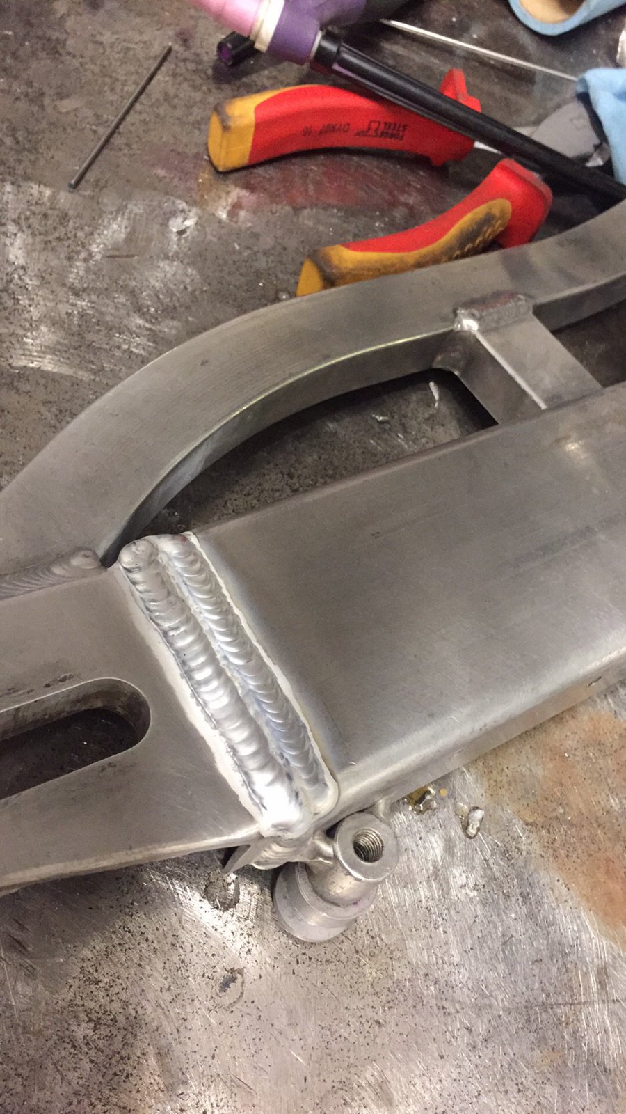

Second photo I ground the mig weld off and dye penetrant tested.
Front weld was fine and found how far the cracks went so got the carbide burr out and got to work.
Last photo is end result in the back.
