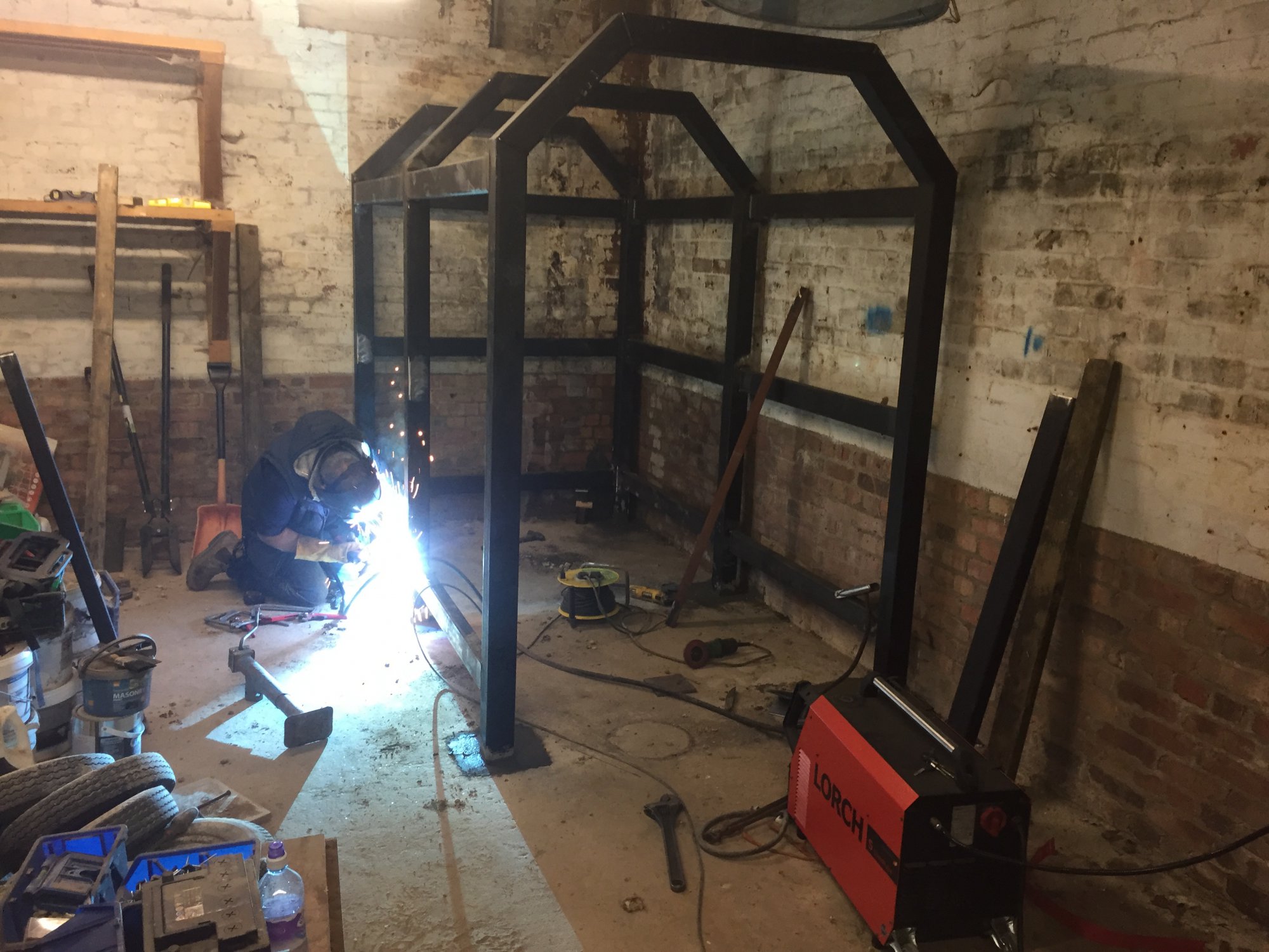

Did you TIG'ed that frame too or did you switch to the MMA side of the force?
SARTo
