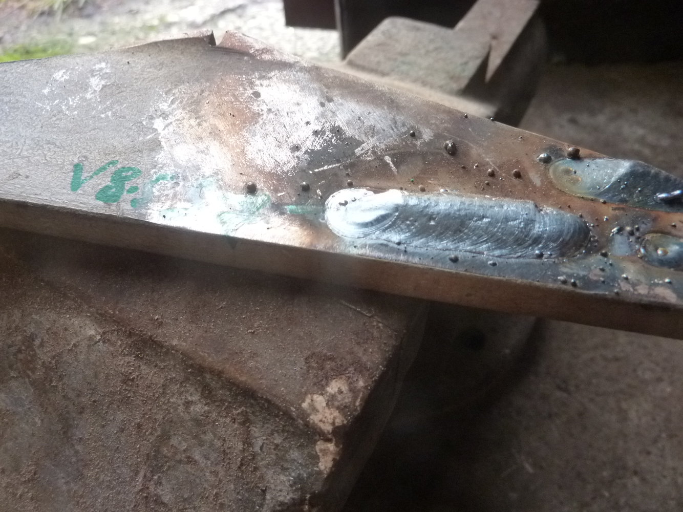

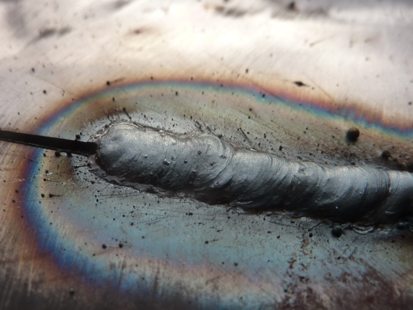

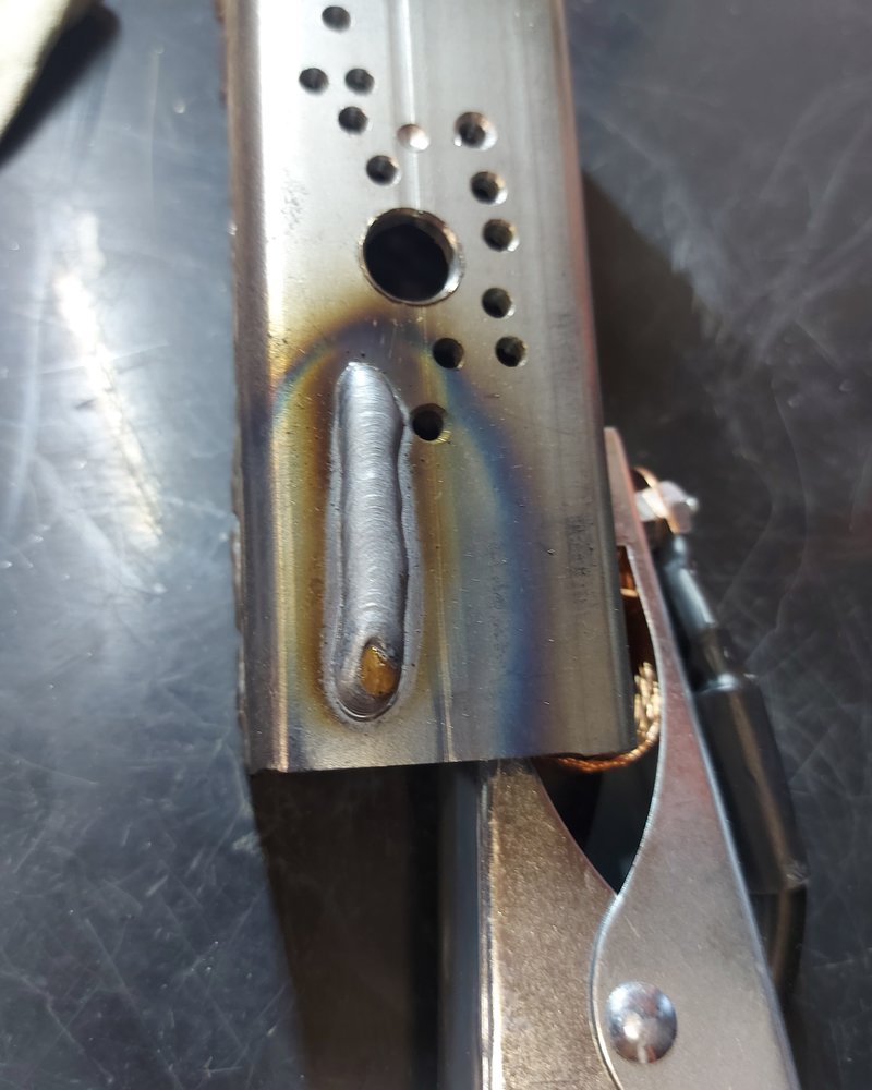

Thought I'd try my new Rohr 200mi on some heavy metal to see what it would do. Its with 0.8 wire, pure CO2. Voltage dial set to 8.5 (goes up to 10), wire speed at 7 - steel is 9mm thick The other photo is 1mm steel. Am quite impressed.View attachment 430184View attachment 430183

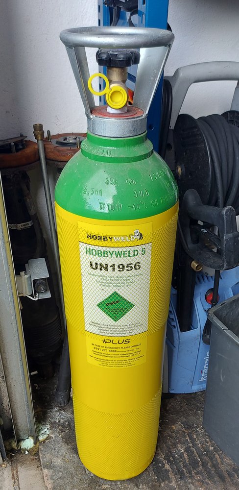

Not sure the size, its a standard beer keg bottle. Surprising amount of gas in them.What size of a C02 bottle do you have?
It's interesting to me as I am sure I had pure C02 before also and I had sold that SIP welder with bottle. Then I got my R Tech and Hobbyweld MIG bottle with Argon + 5% Co2 + 2% Oxygen mix.
However, it leaves a brownish tinge on welds, probably the oxygen content. And that was not an issue with C02 that I recall.
I need to buy a second MIG bottle now so would consider C02 unless someone here advises otherwise!
Most likely the choice of shielding gas, straight CO2 tends to create more spatter than ar/co2 mix.Those welds look a bit spattery. I think your wire speed was too slow.
