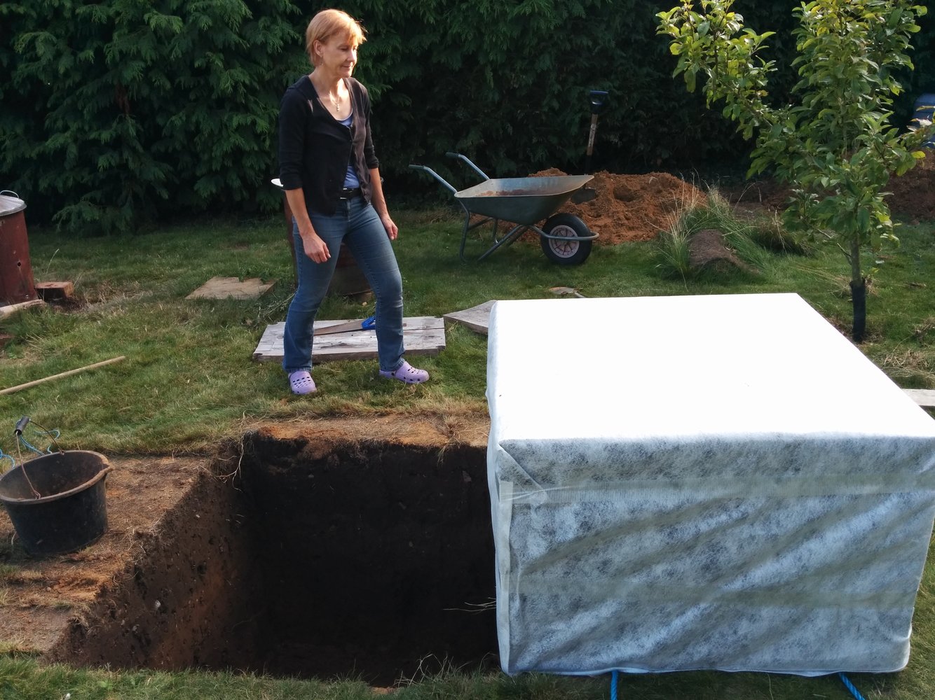

i have a pit in my garage and it fills with water about a foot from the top it only ever drops another 6 inch in dry weather thats where the water table is so if it was filled with gravel it would still be the same heightWorks when done correctly with the right conditions.makes me laugh having a soakaway .dig a 6 foot hole and fill with gravel and wot happens .
which is very rare. they put land drains in the playing fields at back of my house witch is the same height as my garden it always flooded . i told them its a joke but who am i to tell the expertsWorks when done correctly with the right conditions.
it still floods and will carry on doing so
my land drain goes in to the man hole drain leading to the septic tank i was going to put the pipe over to there field
till i put my water levels on and theres no fall its the same height

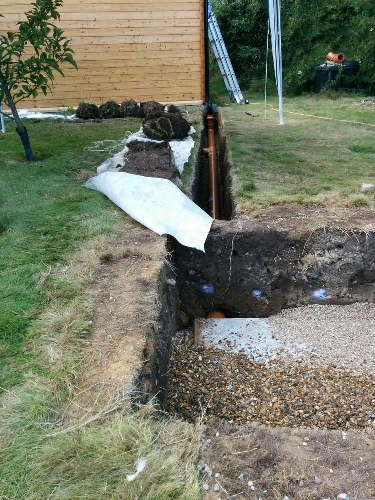

Next question: What do I do with rain water?
There's no convenient drain, and we have previously tried to dig a soakaway in this general vicinity, but ended up with a big clay pit with no bottom in sight. Can I just let it run off into the stoned area next to the base? (I'd probably fit gutters to stop water staining, etc.)

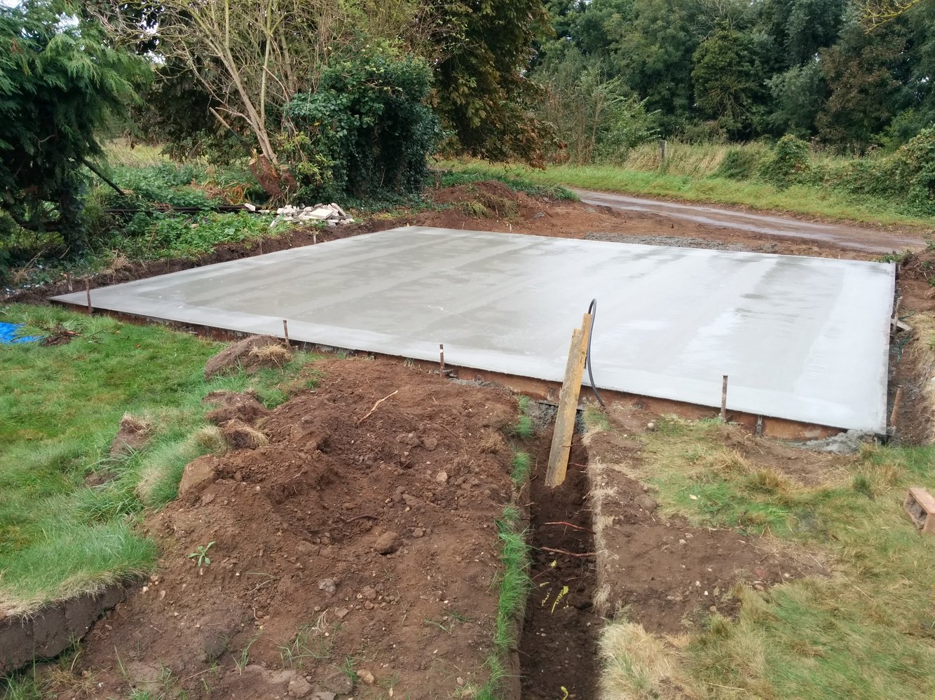

.. what a shame.....Id be inclined to do more than 4” too. But it depends on your ground conditions. Mines about 6 inches at one end bit more at the other. Then a 6 inch slab with fibres too.4 inches of mot under the slab is that ok?
I did my own groundwork for my slab and had 8 inches under the slab as that was what was recommended by the concrete company, though my slab was 6 inches with C40 with fibres as I didn’t want re-bar to cause problems for the mounting of my 2 post lift.
Fibres in the concrete should be fine, I’ve had no issues with cracking on mine 5 years on, but I’m not a builder!

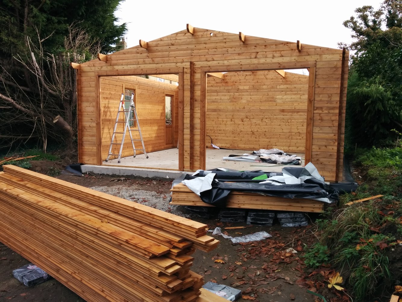

I have, but I'd like to build close to my boundary (<1m) so needs to be 'non-combustible'.Have you considered timber?
Thank you again - still working through all the previous threads / videos!put ibcs down the sides to collect water and slowly drain them into the ground is what id do
I have a Compton's concrete prefab. It was put up in 2 days...very impressive....it's also around 30sqm.Have pretty much decided that I'll get a pre-fab.
