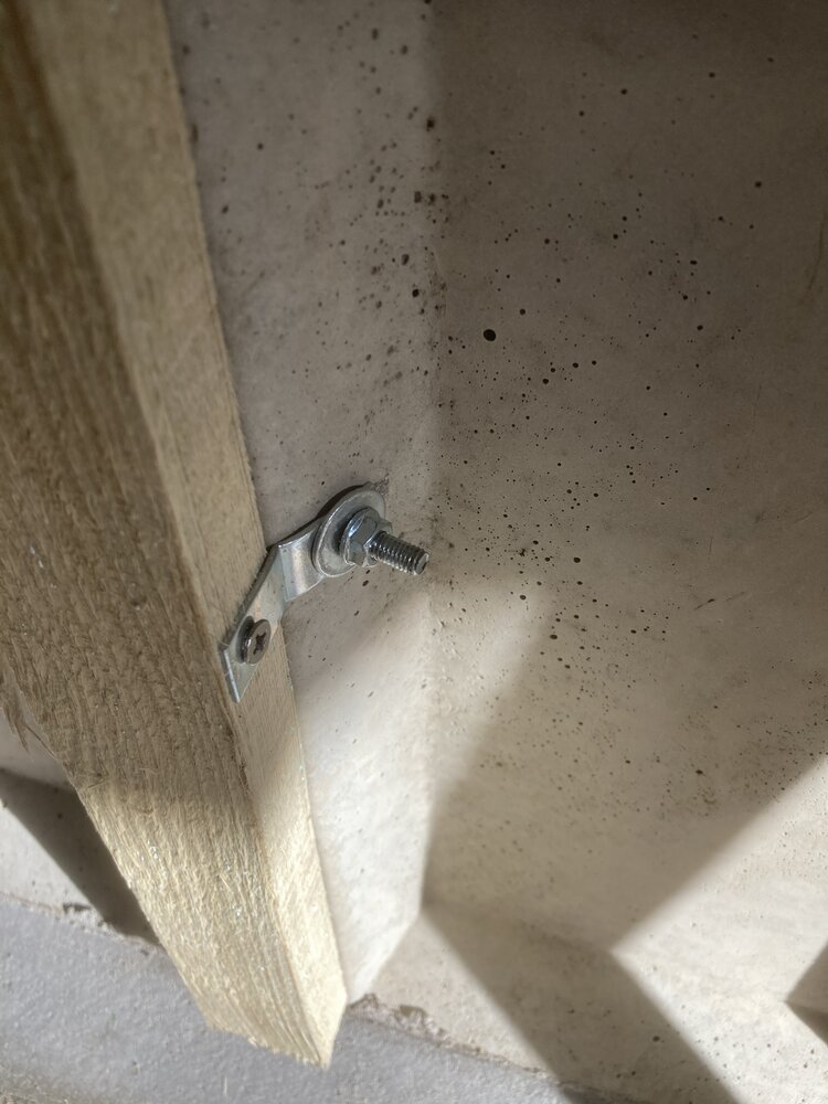

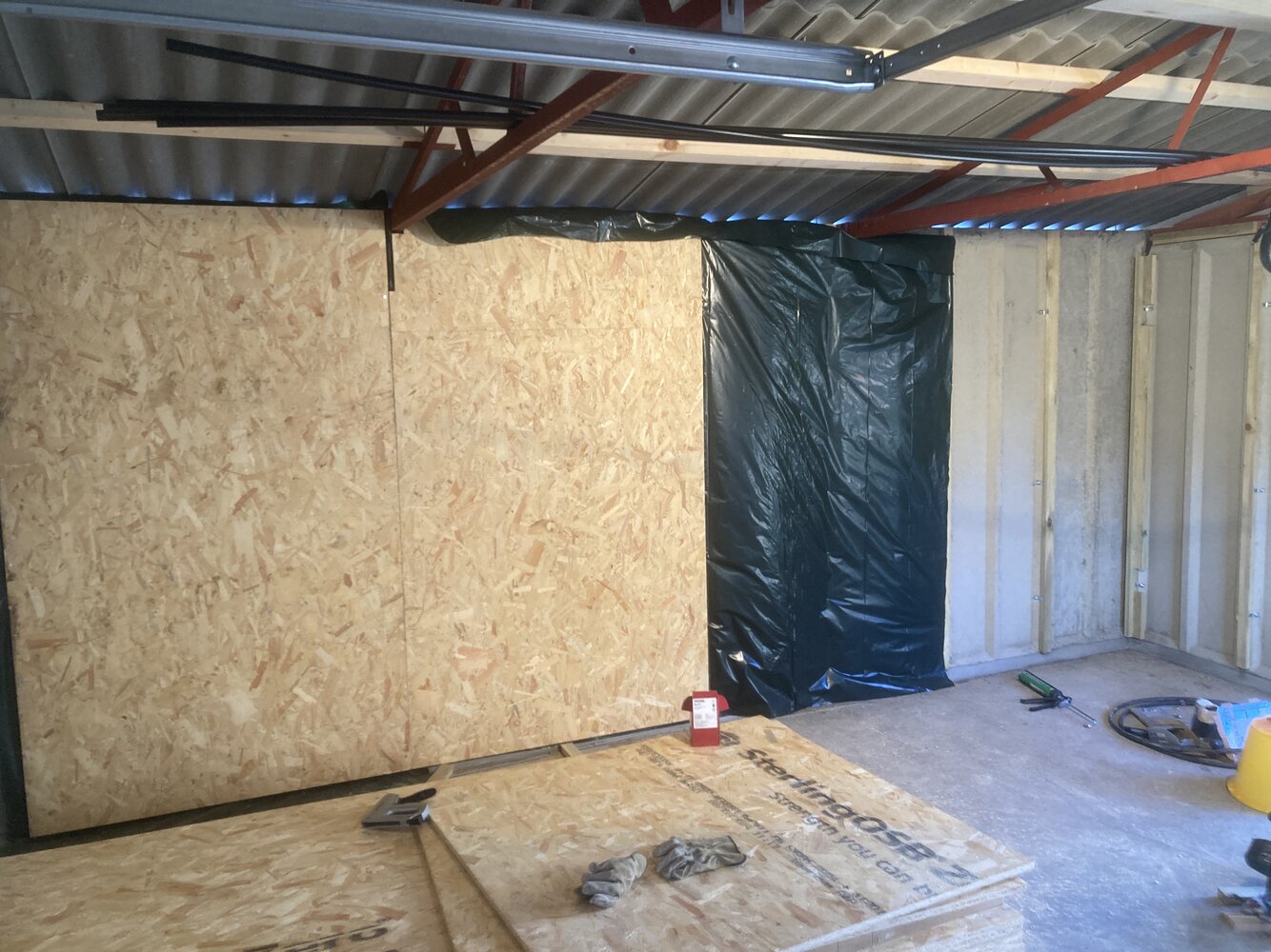

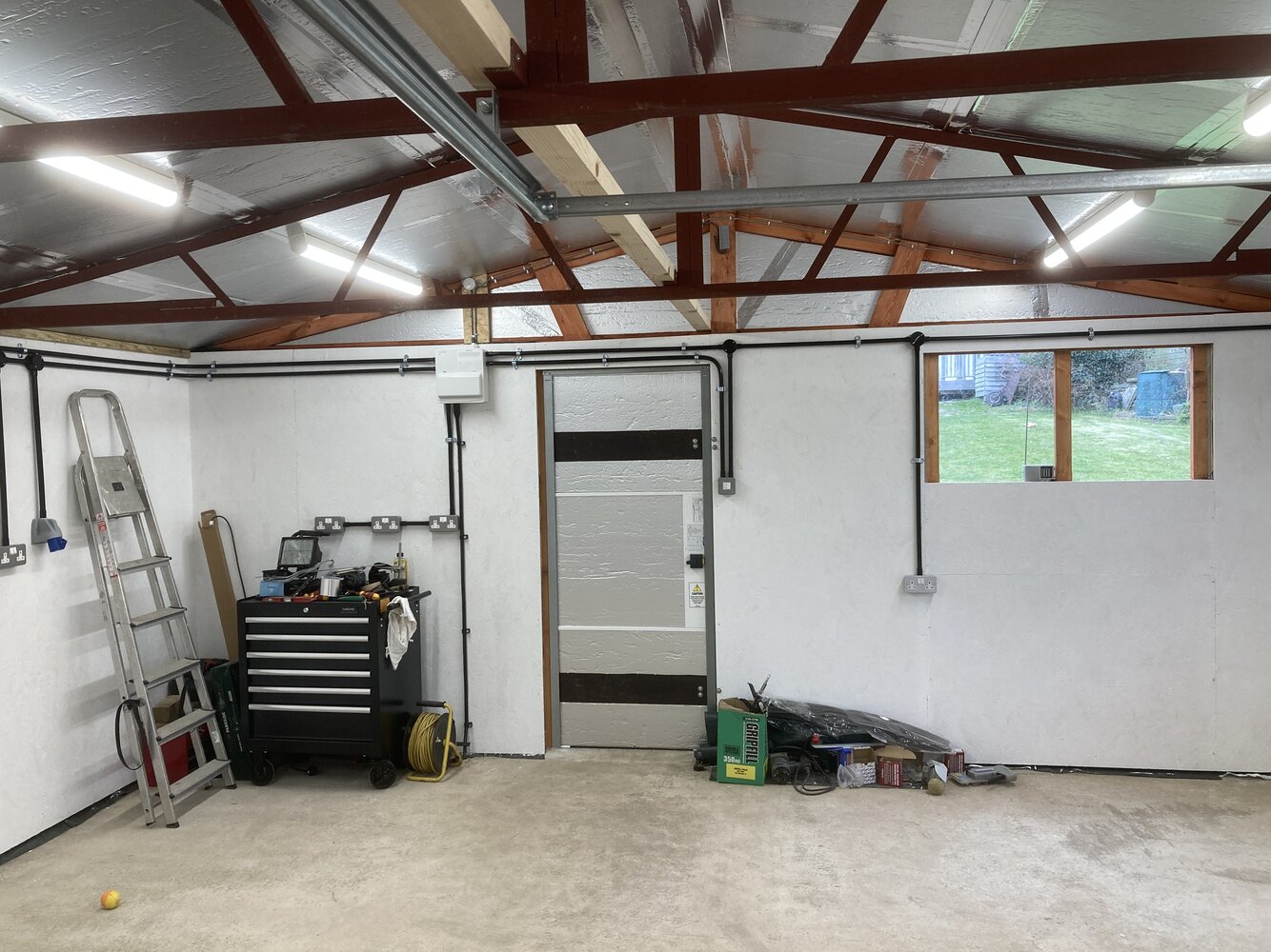

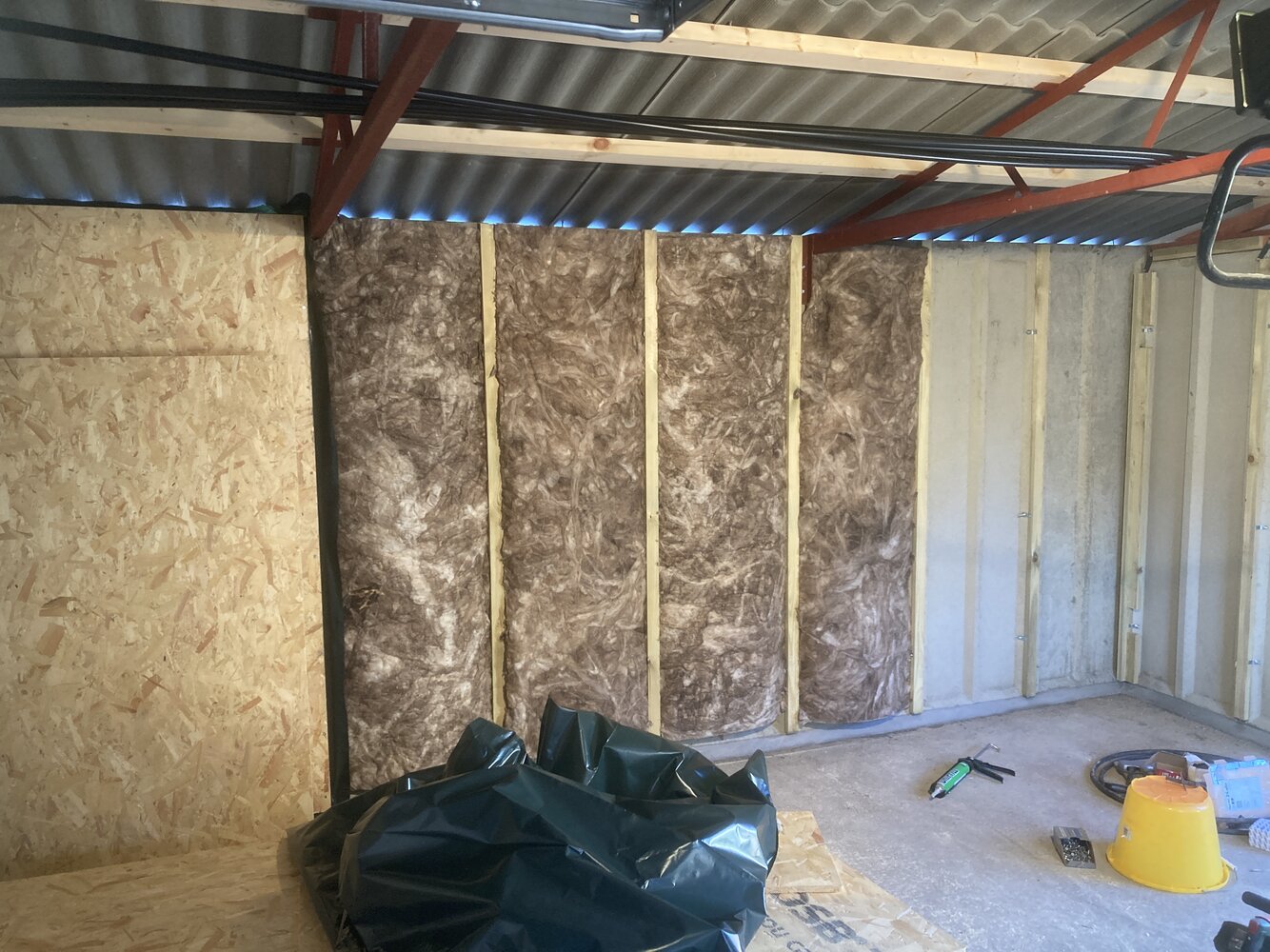

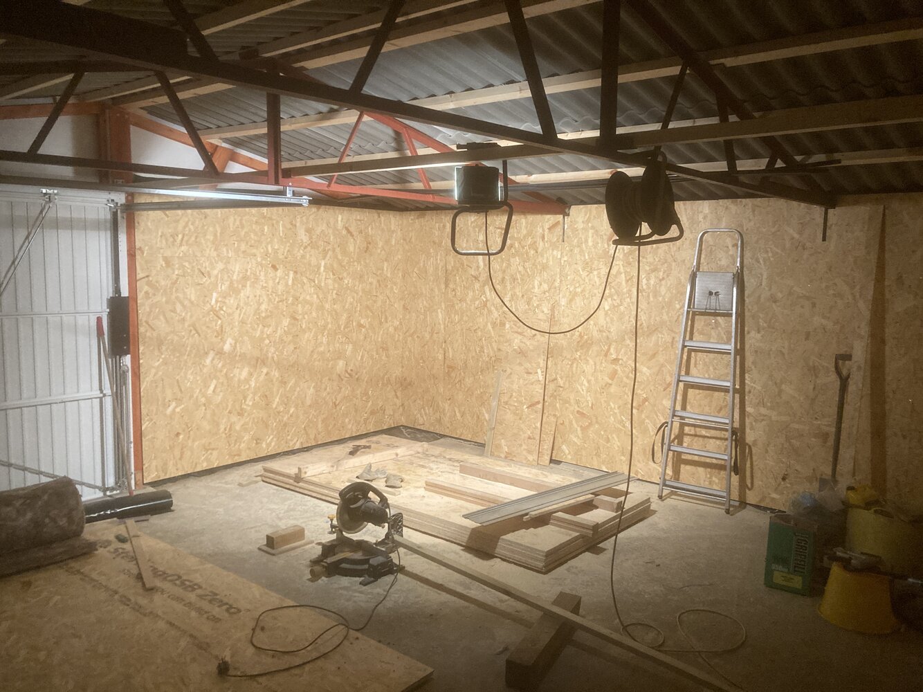

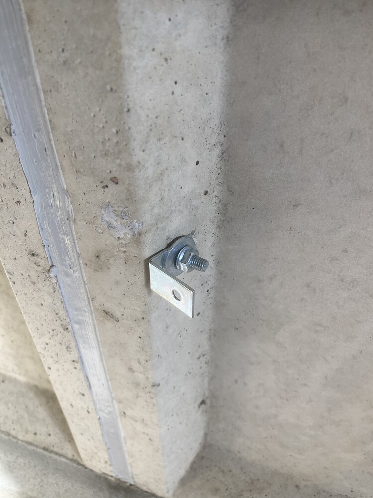

I ply lined and insulated mine...very easy to do off the bolts which hold the panels together.
Was contemplating doing the same.

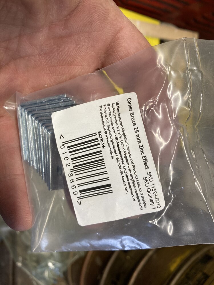

The panel connecting bolts run parallel to the walls so it's very easy to remove a nut and add a bracket. At the time Compton's supplied brackets so I just used theirs. I added studs (50mm) and insulation...then a membrane followed by the ply.Was contemplating doing the same.

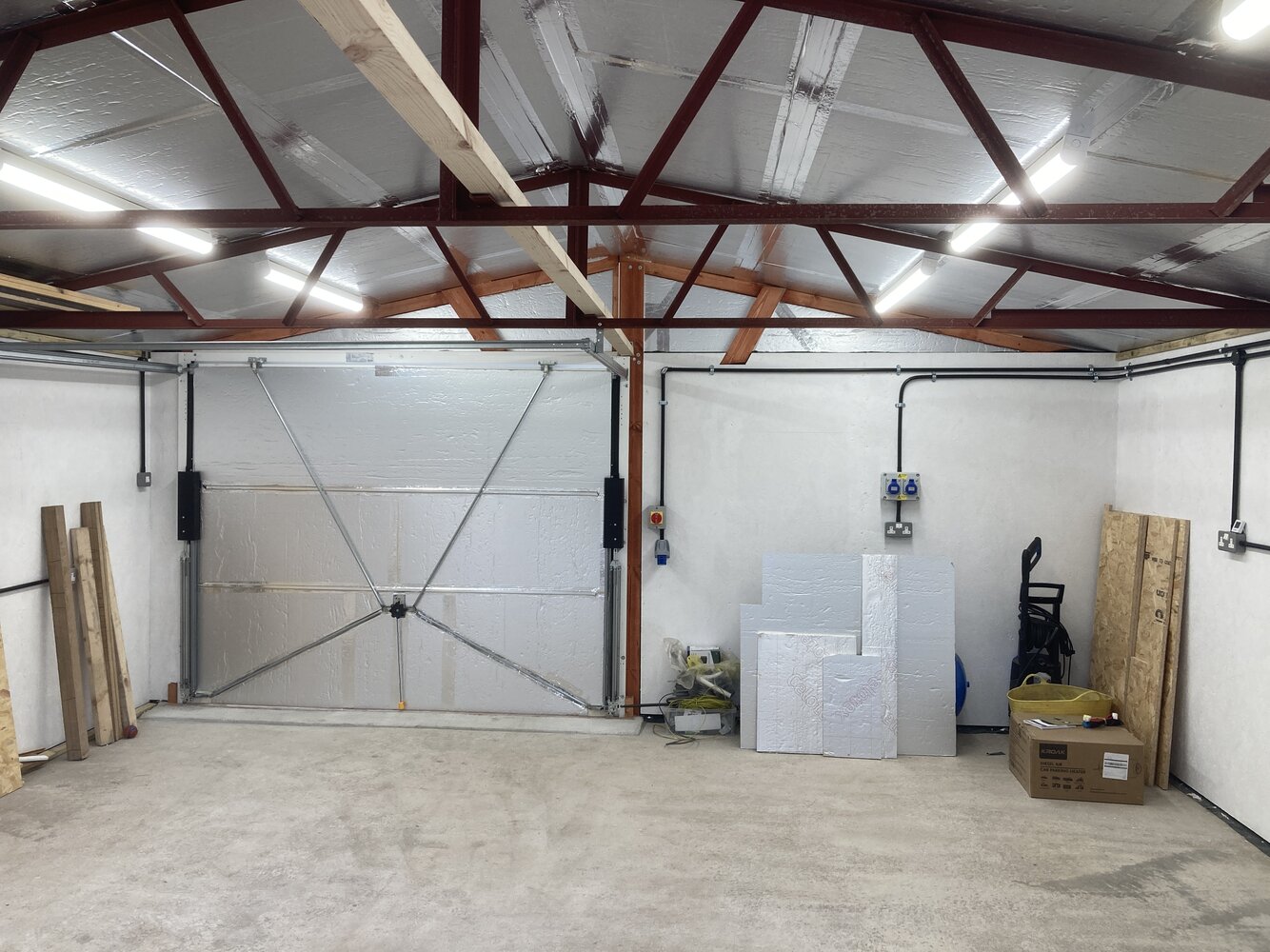

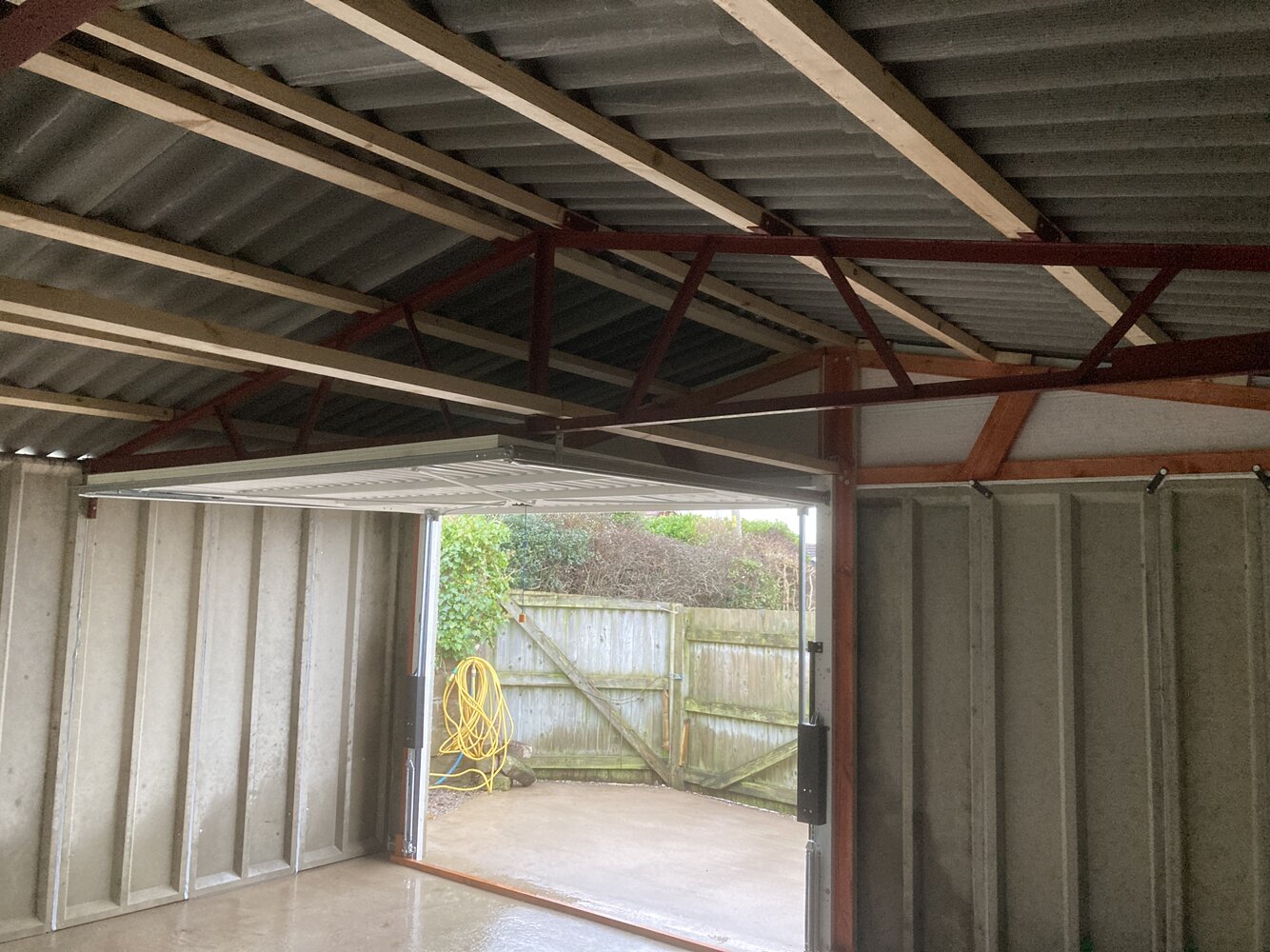

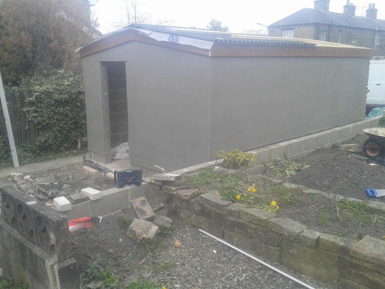

I tend to agree... Mine has been felt and battened...but I went for the metal roof that looks like ceramic tiles so bit different.why dont they put slaters felt on first before the roof goes on

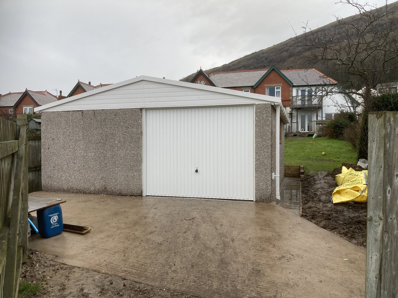

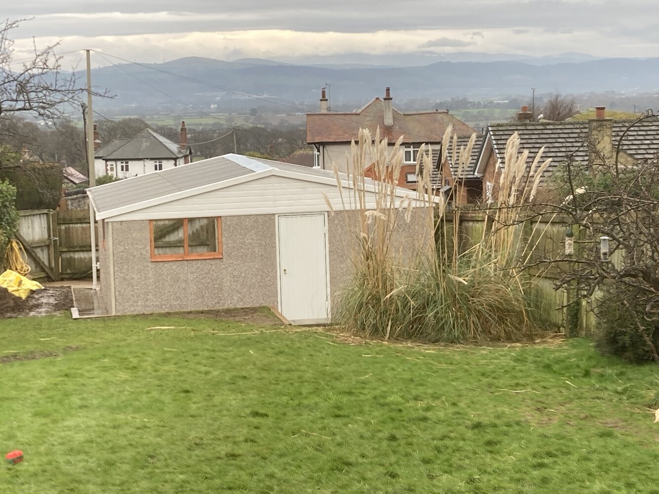

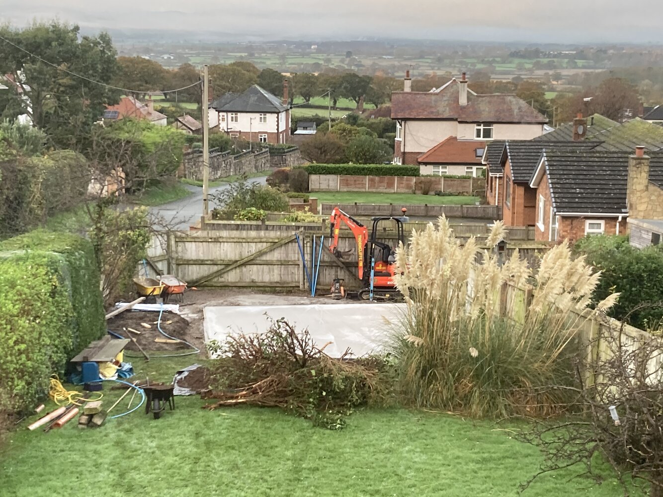

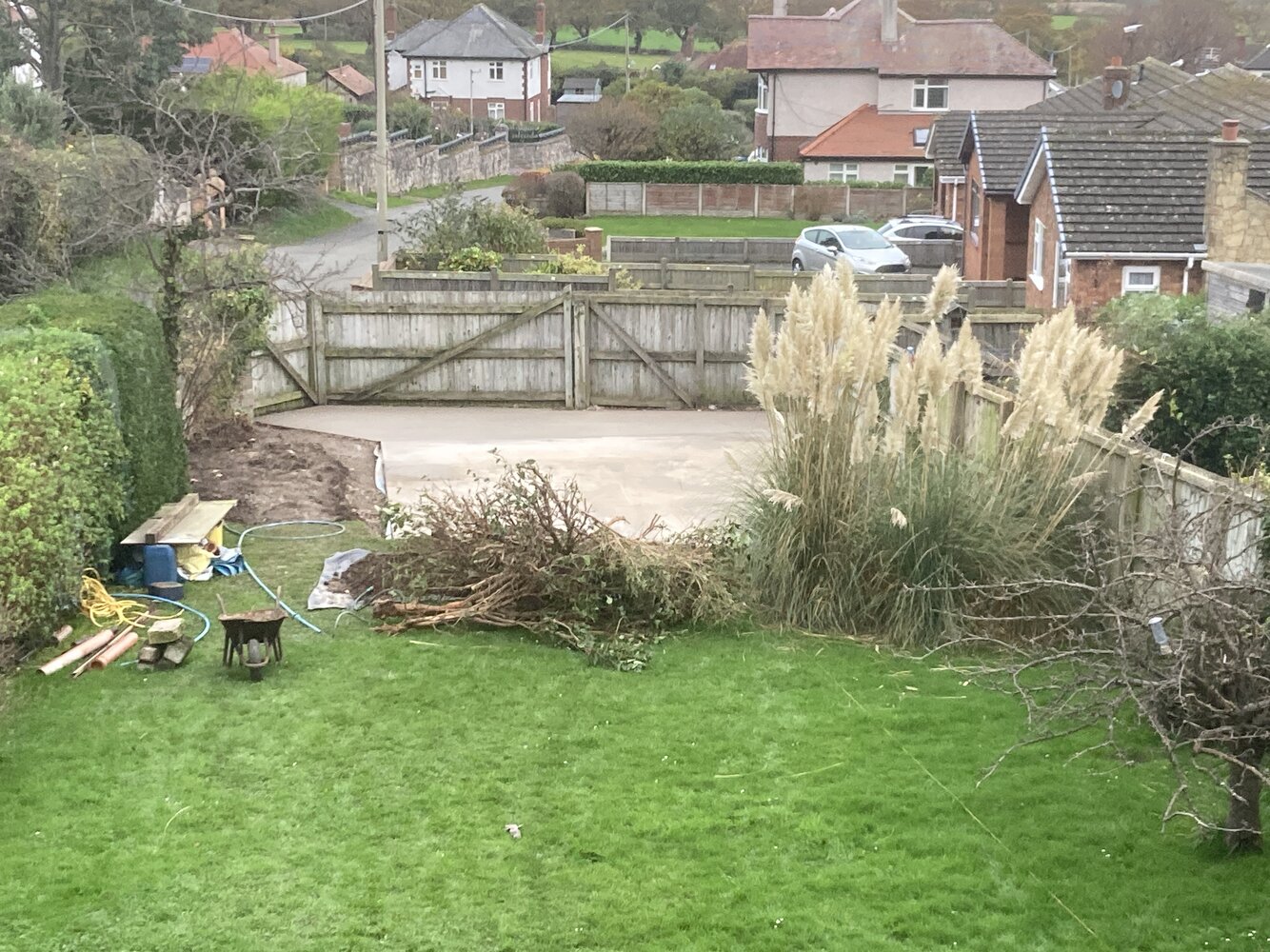

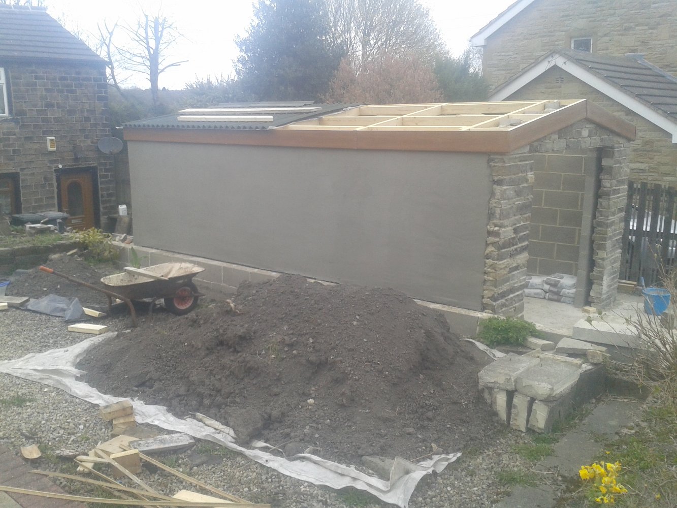

Looks grand, how is it sealed to the concrete base to stop rainwater making its way in?
In hindsight, I would have tried to change it to a steel roof, both for durability and security.your roof is fine but with wear and tear it will crack and leak as it normally does at the bolt points
I hunted around for the cheapest supplier, and I suspect that little things like supplying the clips or fitting underfelt to the roof are what gets dropped to get the price down.My garage supplier threw in the clips for free I think...

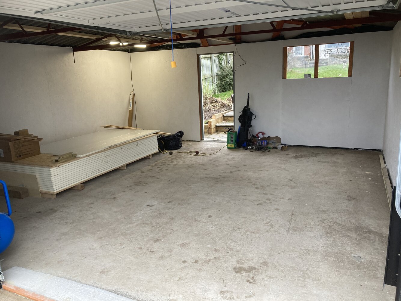

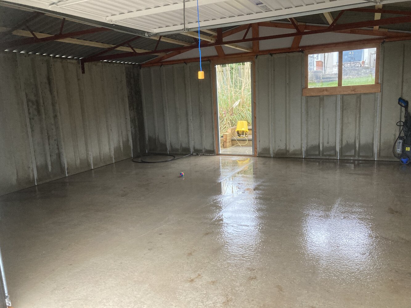

Thanks - it's for me to expand my empire of stuff to tinker with. I think you might be getting me confused with @MysterG though!A nice spaceis this for you to do your arty sculptures?
The smaller corrugated roof sheets don't seem to spilt as bad as the big 6 style, In my old place I used to splosh some thompsons water seal over the roof once a year which seemed to help
