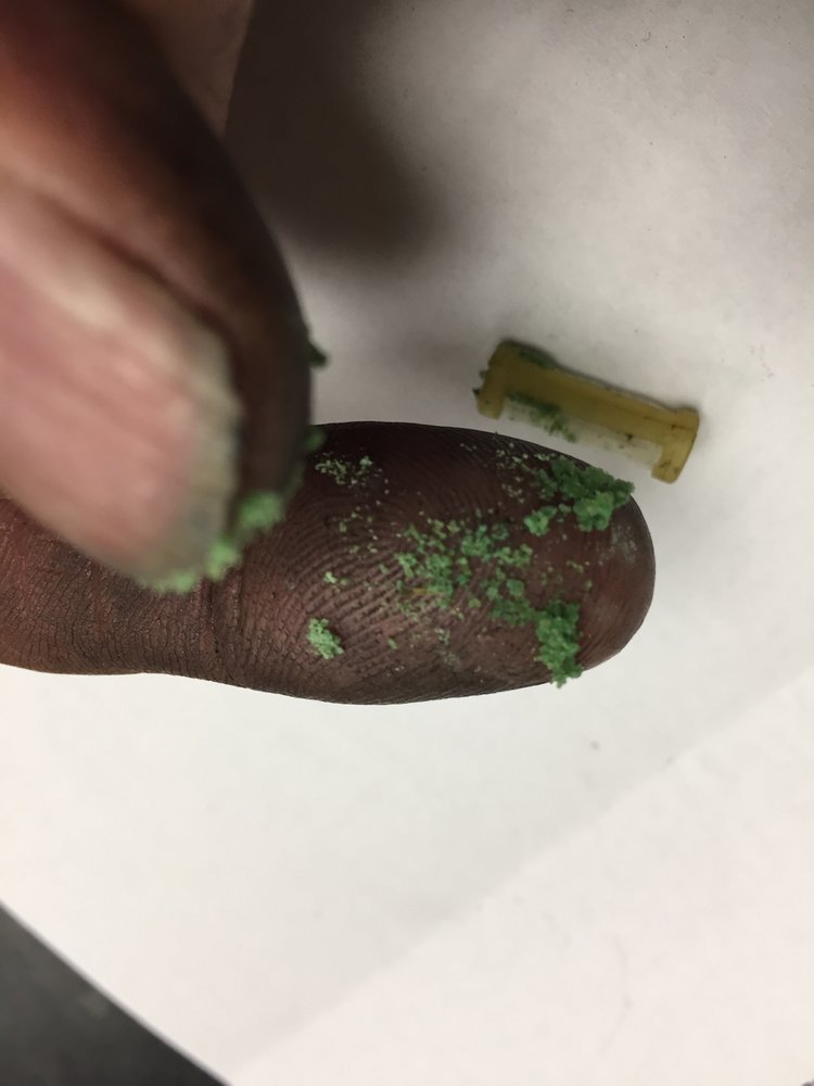

I work on small engines, I never used to have to replace carburetors.
The E15 makes the aluminum get white and dusty with pockmark holes, and the brass parts turn green.

Exactly my findings with small race engines and lawnmowers. It's worse now with lawnmower engines where the jets are ECO-fixed at the factory and you can't get them out to clean the thing properly. I've seen jets so blocked solid that I actually thought they didn't have a hole in them. I have to make up micro drills from throttle cable to start breaking through.I work on small engines, I never used to have to replace carburetors.

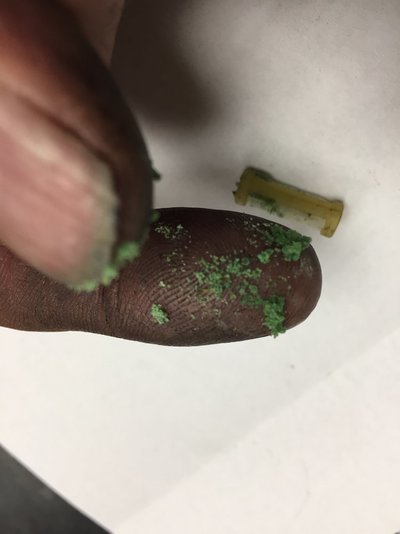

I'm finding it's causing havoc with two stroke engines.. The brassware quickly becomes dull and covered with a green tinged deposit that accumulates when left for a very short period. The ethanol seems to react with the oil mix and becomes a solid. The picture is from a 125cc catburetor that had a mix of e5 and She'll M. This was the state of the filter after less than an hour of running. E10 or 15 will render these high revving engines useless. I'm thinking of making a rig up to separate it out and sell it.
