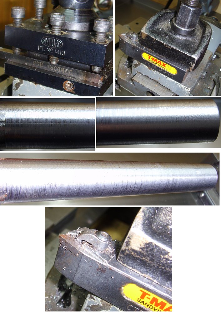

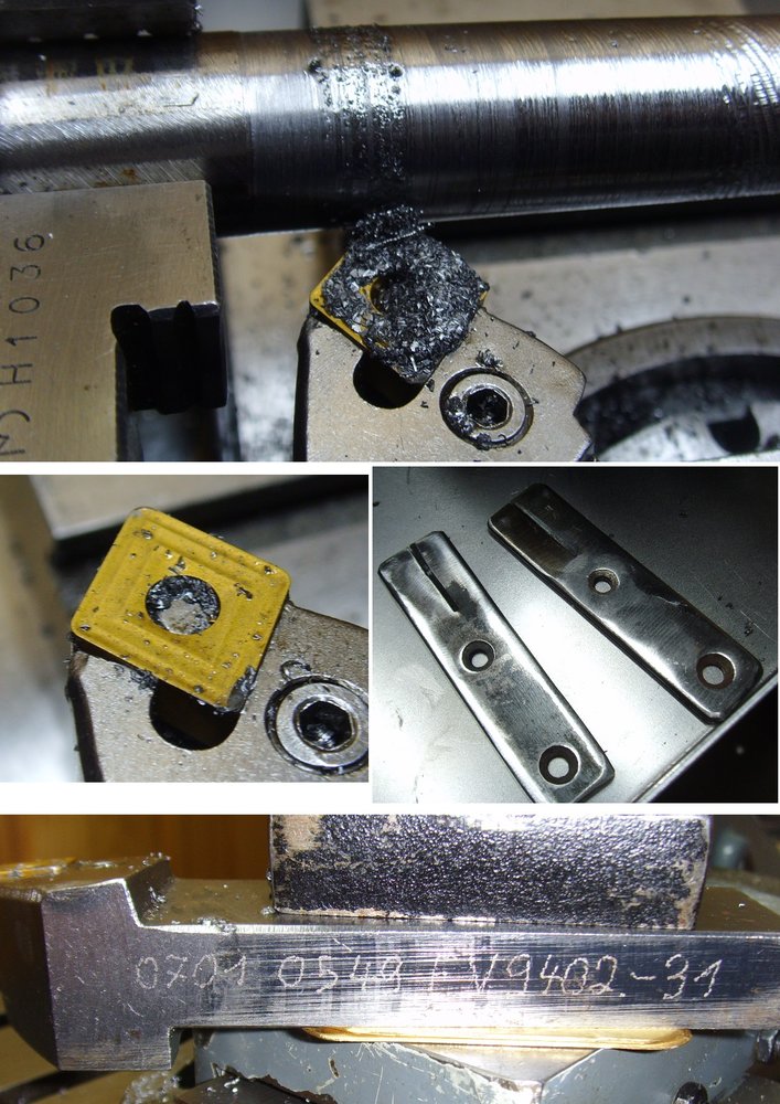

This is test bar I assume? Are you setting it up properly? Initially machine it with the tailstock. Turn down the centre section leaving a larger diameter both ends. Then without the tailstock take very very fine cuts until there is no spring cutting (bending of bar). Go back over the bar without feeding in. Then measure diameters.In fact, I have both.

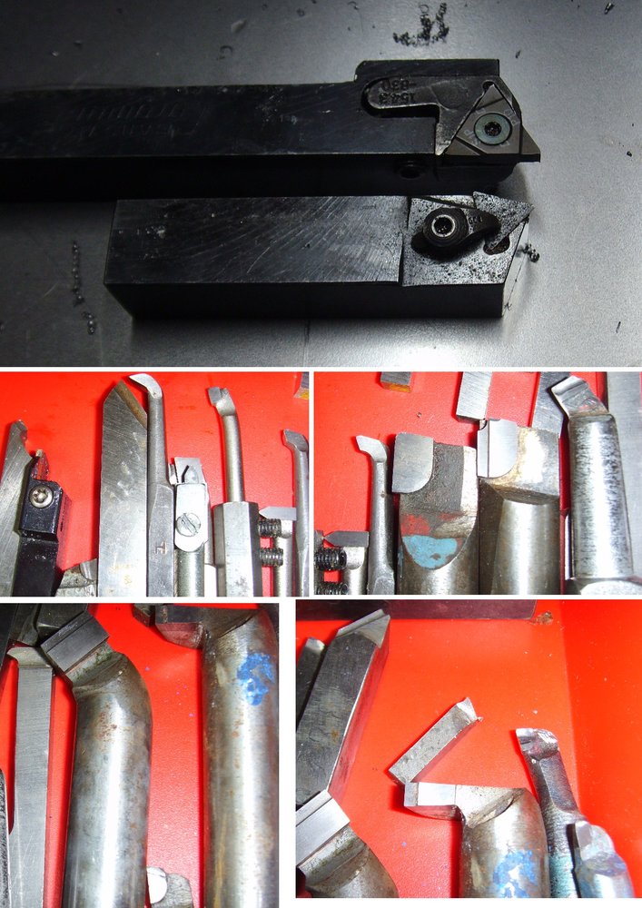

I can only use the four-tool holder since I made myself a 3/16" Allen key.

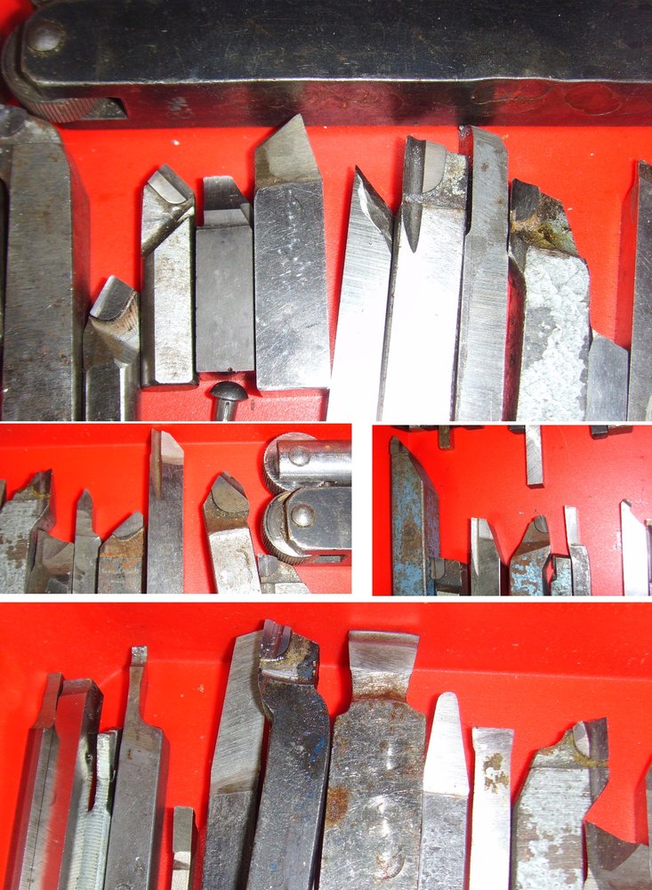

I have found that in my pile shockingly few tools that fit in there actually work, mostly I am over centre line.

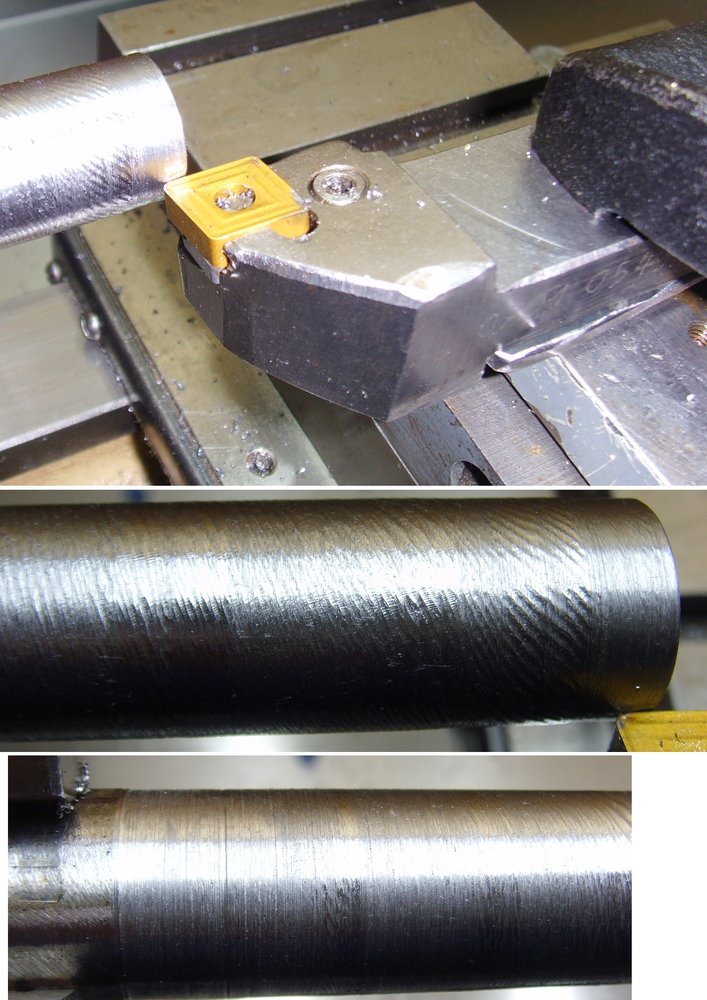

That's why I'm trying the universal holder again today:
About 0.1mm tapered over a length of about 140mm.
Different tool, wrong direction angle, but rounded insert:
In the beginning, a few times I didn't notice right away when the micrometer screw drifted when I let go to oil the cutter.
Over a length of about 140mm approx. 0.15mm tapered.
I'm not very happy
Carsten
turn your cutting tool round a bit so its cutting on the corner of the tip

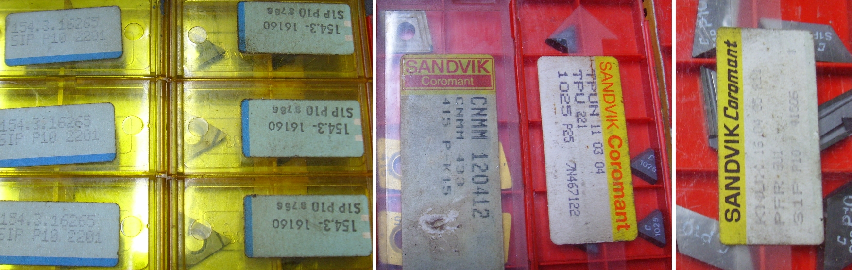

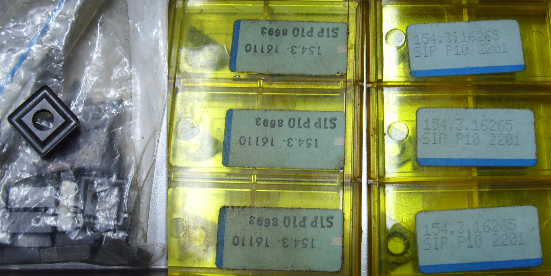

] ad hoc cutters.Have to look into it. Do they give precise measurments in the description?I use 12mm toolholders + carbide cutting tips from Banggood
Just started to realize that, made some first, need lots more of those.get yourself a load of strips of shims diffrent thicknesses.
Next thing .... on my way ...use the center in the tailstock to find the proper center height for the tool
That's assuming that's the tailstock is adjusted correctly, which it may not be.
put a center in the headstock and tailstock and run them up together and you will soon see as a basic checkthere is no height adjustment on the myford tailstock
dont buy these but make your own / it will give you the idea what you need
Wilco, thanks!
Closed the three-jaw chuck all the way, put a co-rotating tip in the tailstock and pushed it into the chuck. Couldn't find any deviation.
Then drilled the 20mm test rod you saw (what I just had laying around) with centre drill.
Then I drove the rotating tip into the end (a bit late I noticed that the rotating tip doesn't really want to rotate anymore, now it has a ring groove).
That's enough for me for today, a bit of Banggood searching, then it's over.
Thank you all for your patience
See you then,
Carsten
