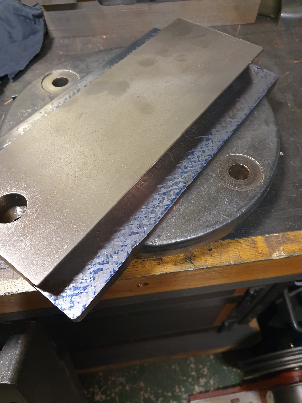

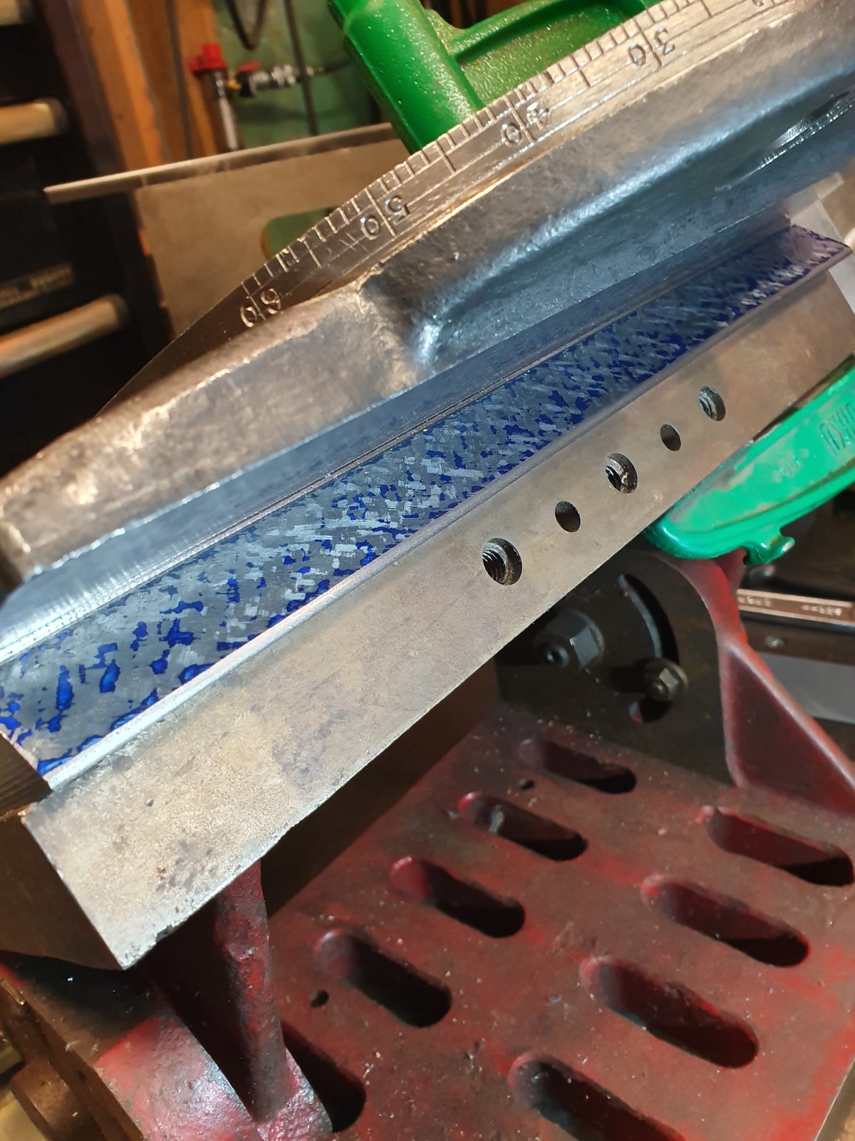

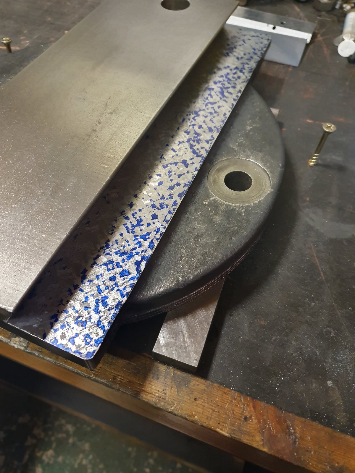

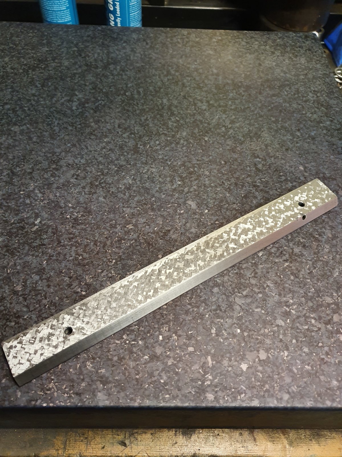

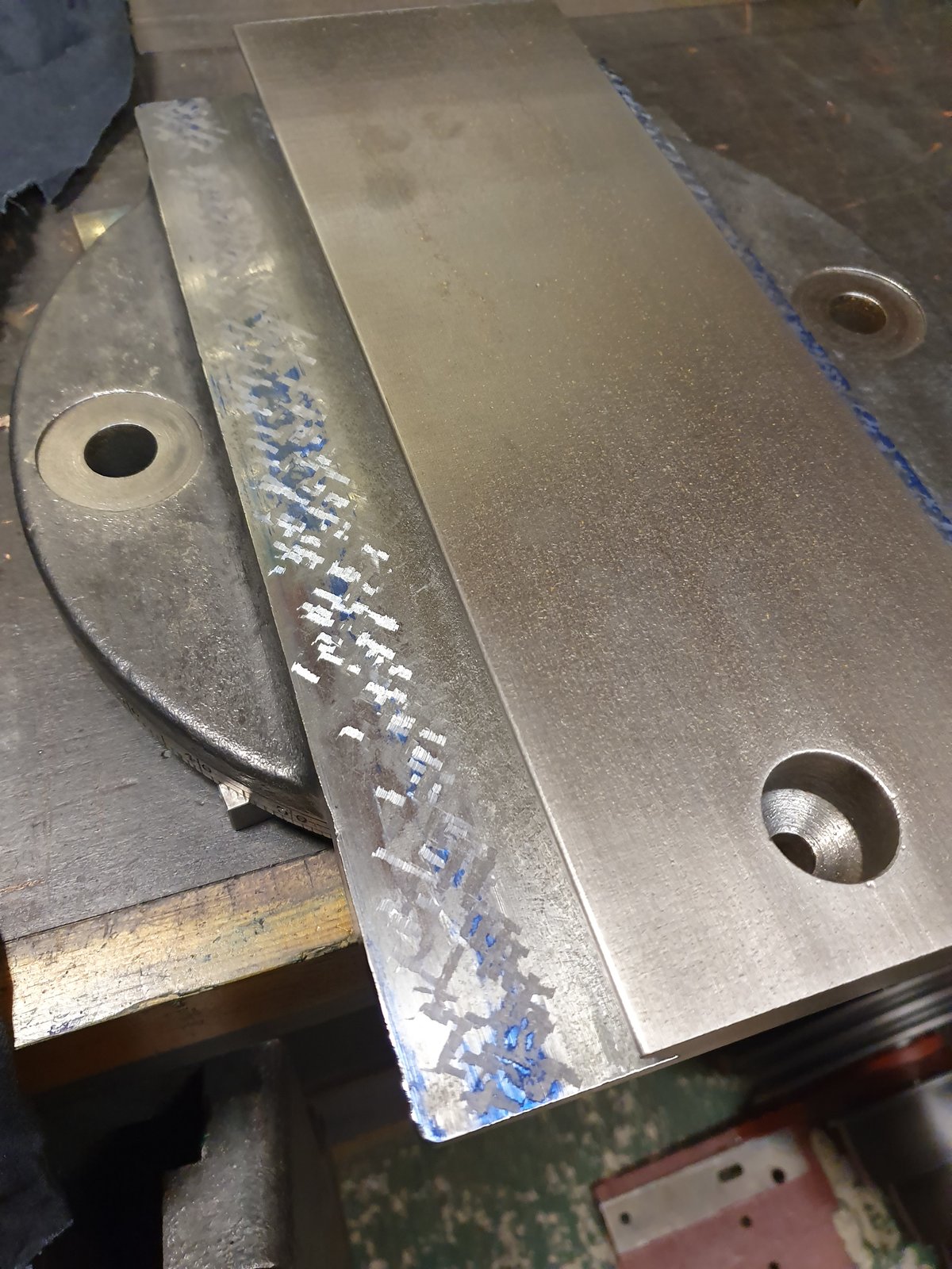

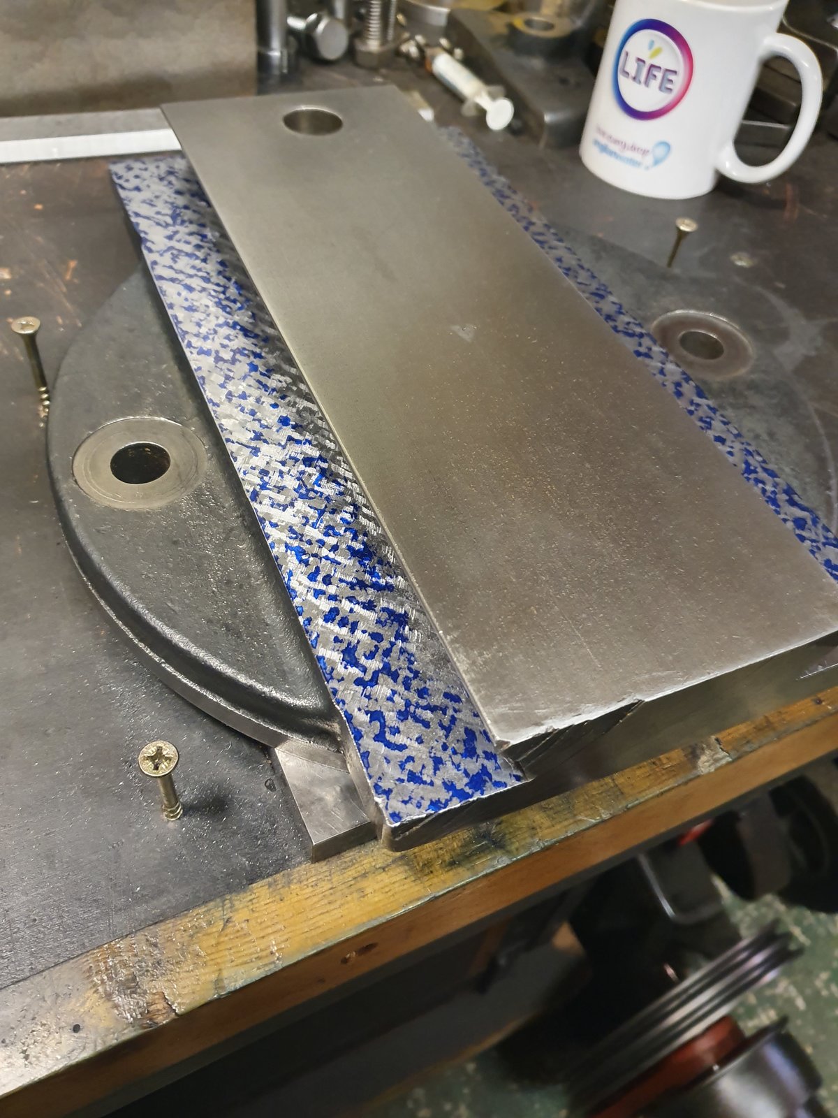

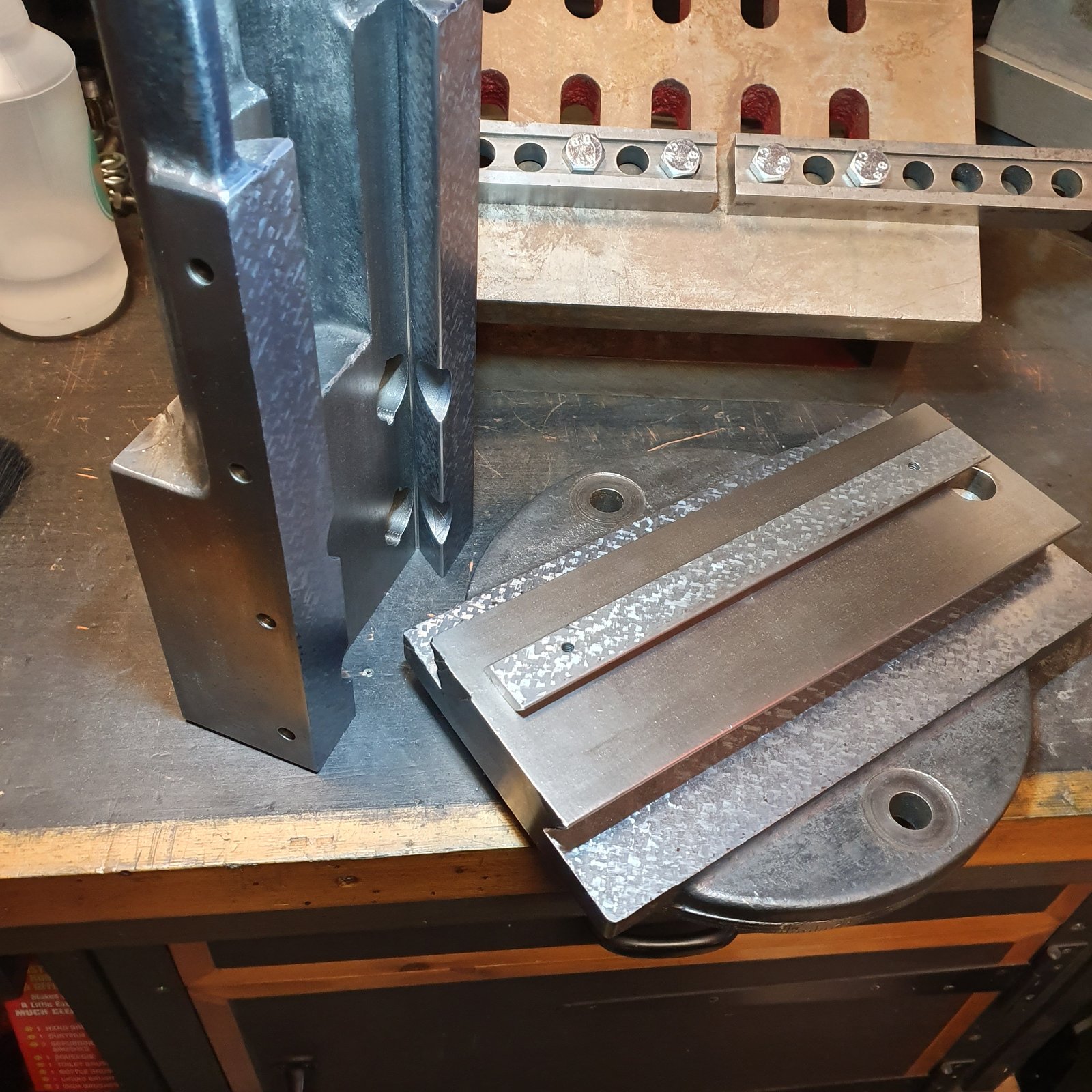

Today I started the lower half of the compound slide. A few high spots to start with that I took out with the straight edge. Now using the freshly scraped top half to see what's what...
