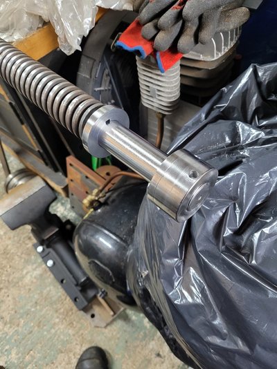

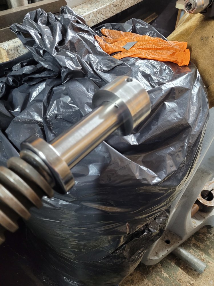

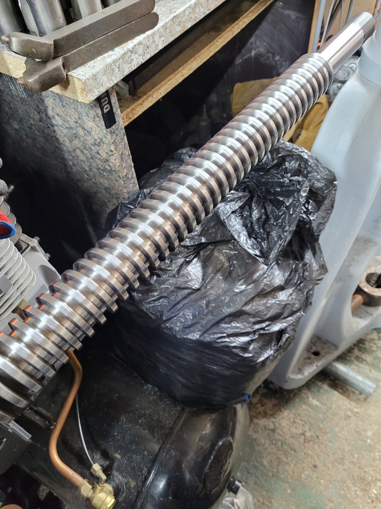

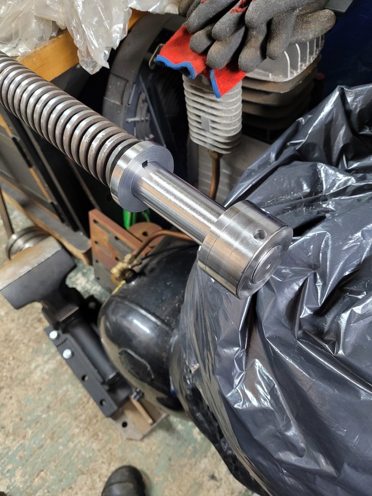

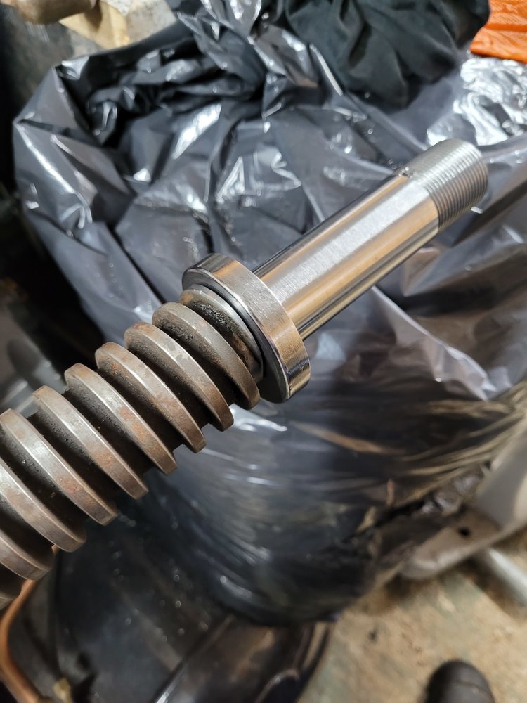

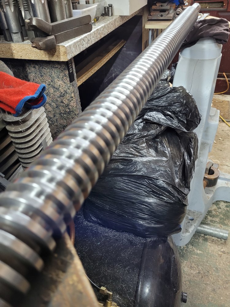

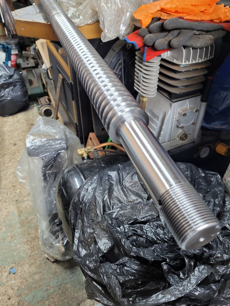

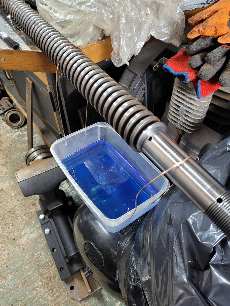

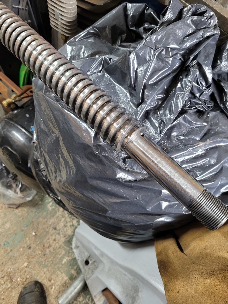

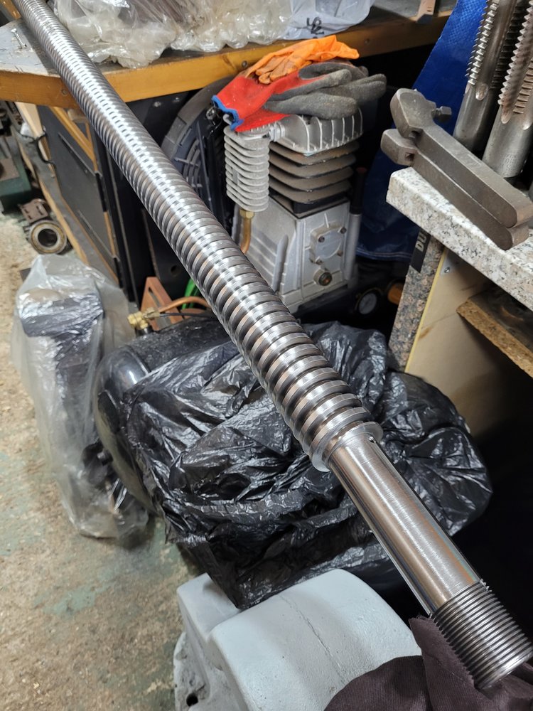

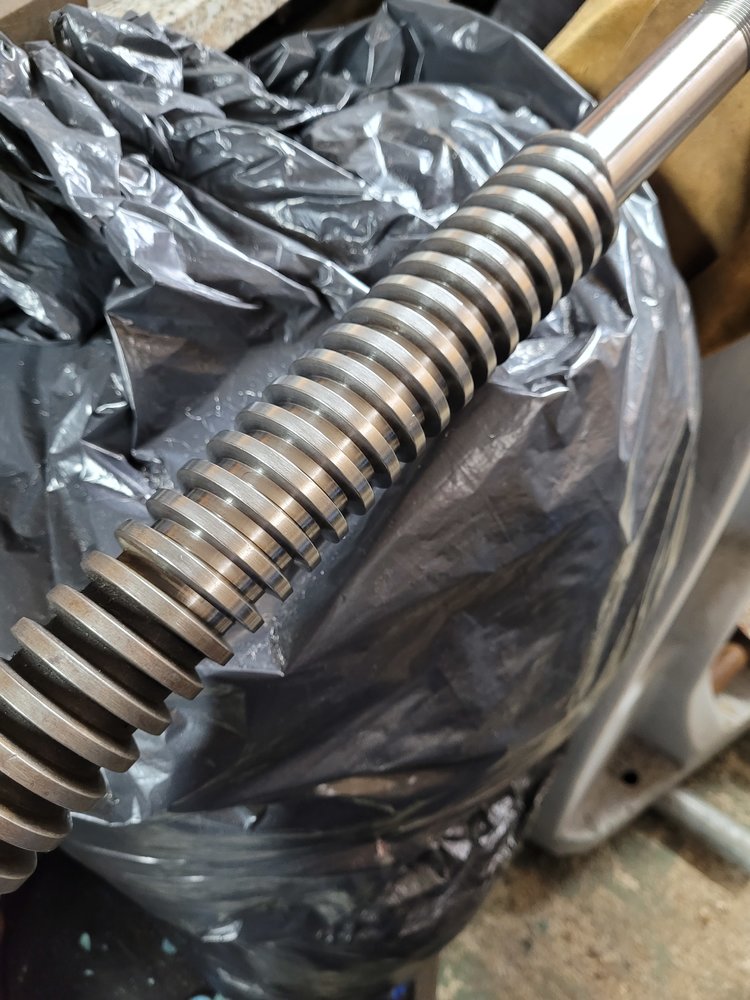

I have a set few methods of doing them. Currently doing gardening so haven't really started yet.Screws are really hard work to clean up. I've found lawnmower chord with a suitable abrasive to work well - fine sand, carborundum etc.

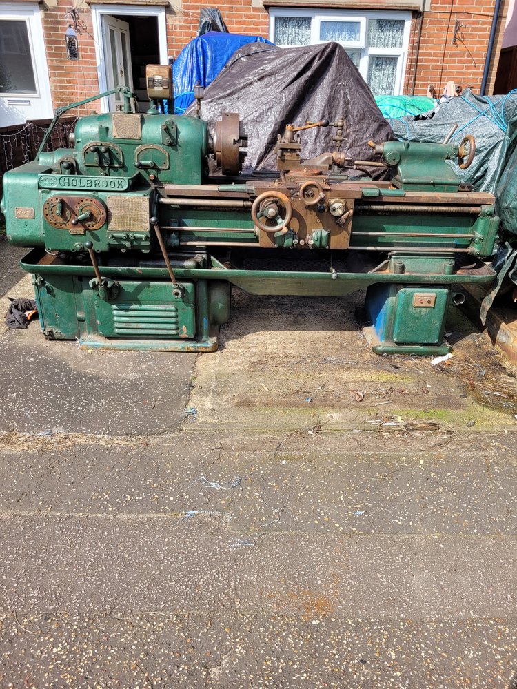

He's refurbishing a Holbrook at the moment.
