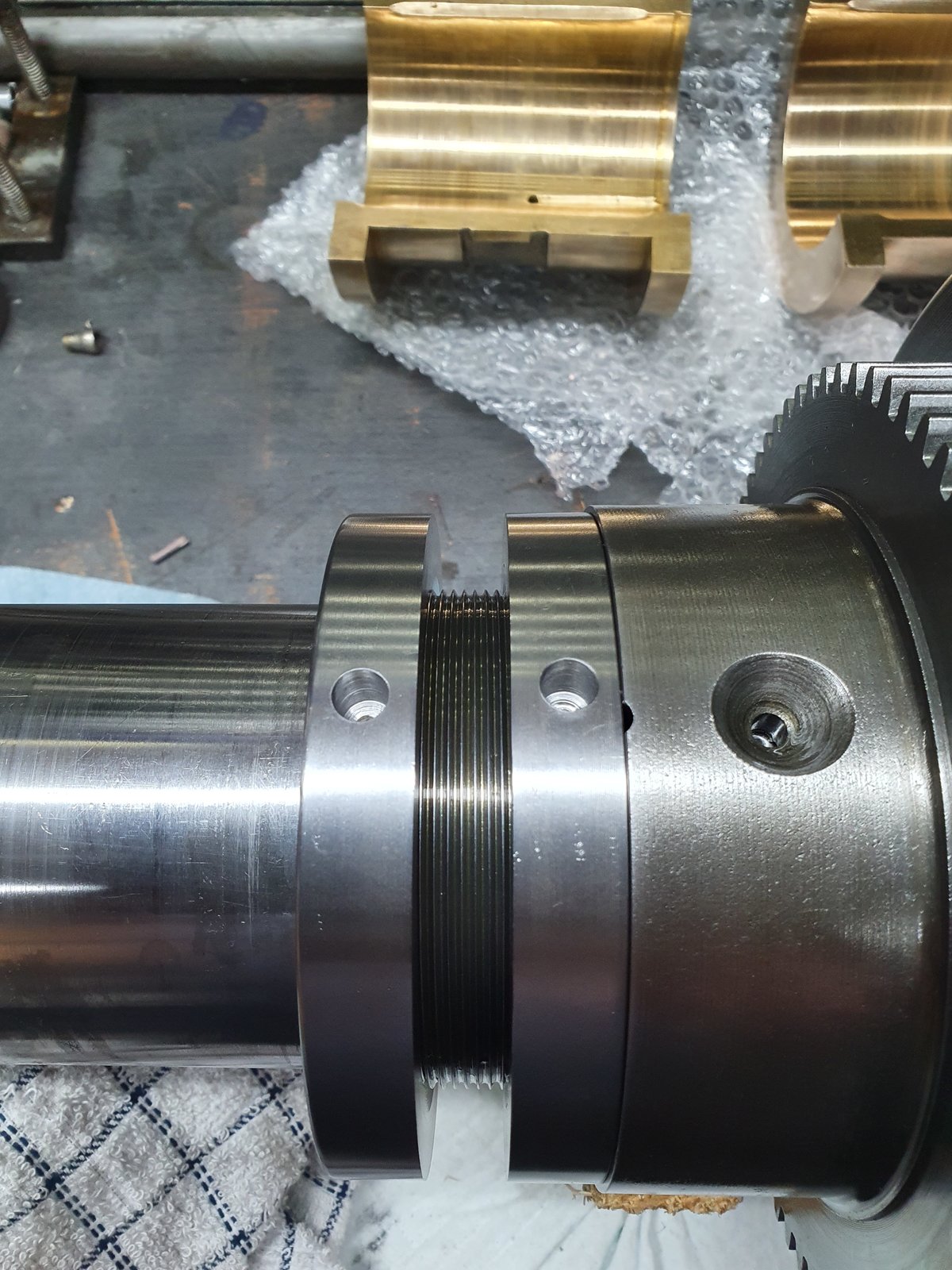

That is what I will do. Need to get a couple made for the spindle locking collars.I was going to suggest that - drill a peg hole in the spindle - it will never notice it - and make a peg spanner. Perhaps you could get a peg spanner laser or plasma-cut locally?

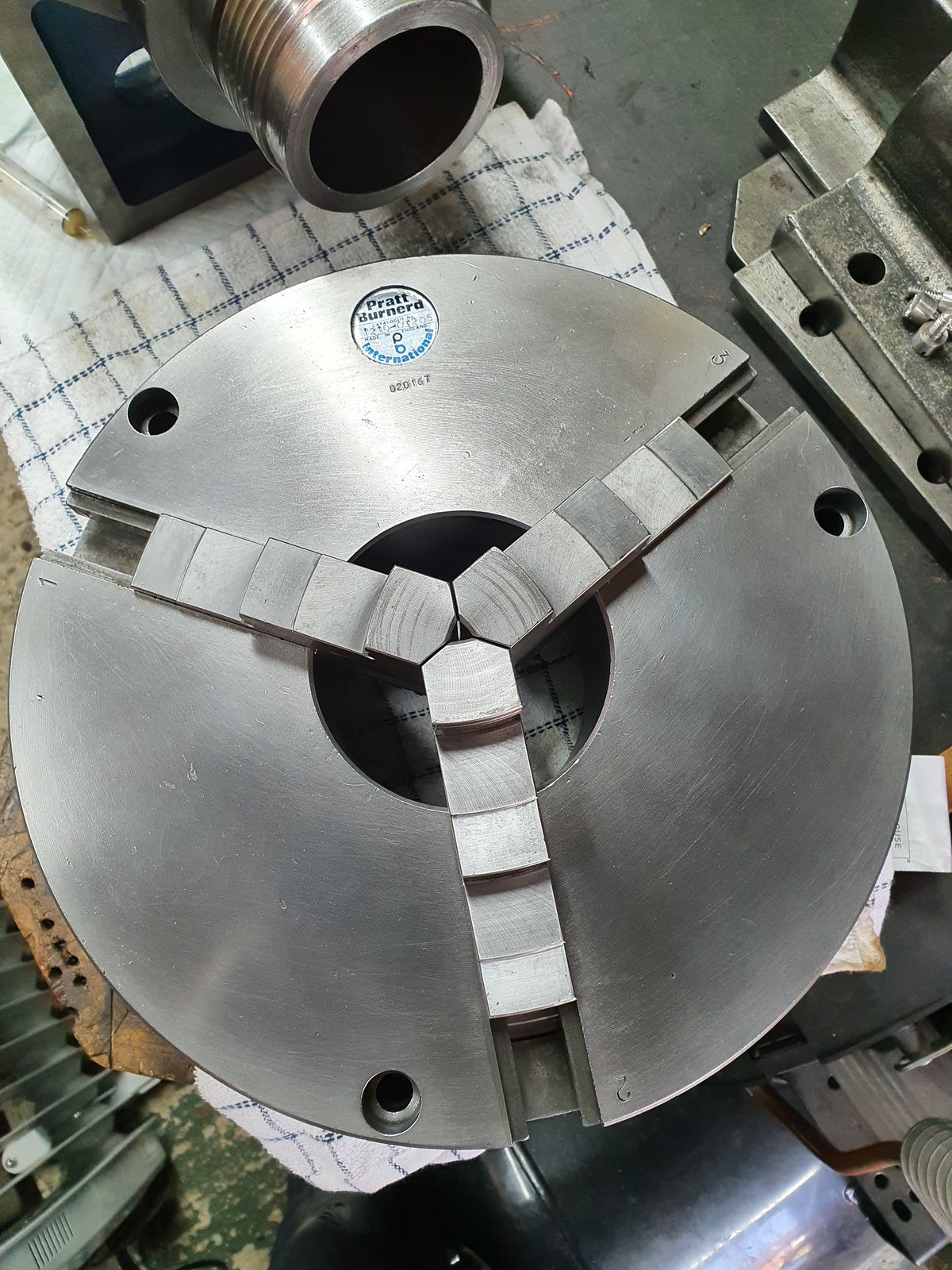

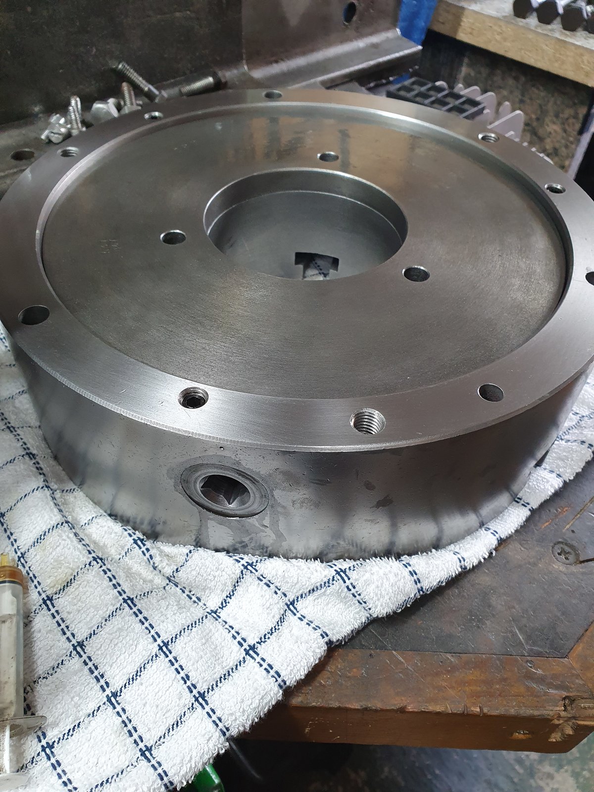

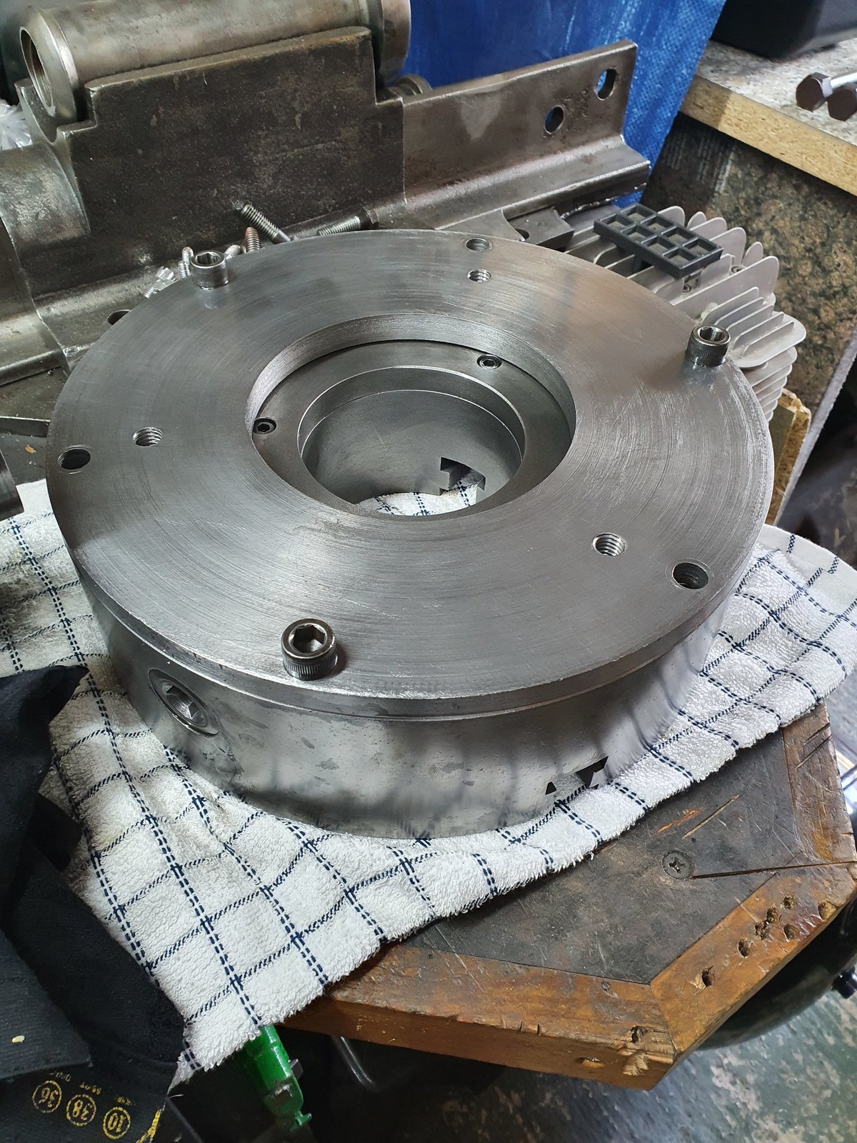

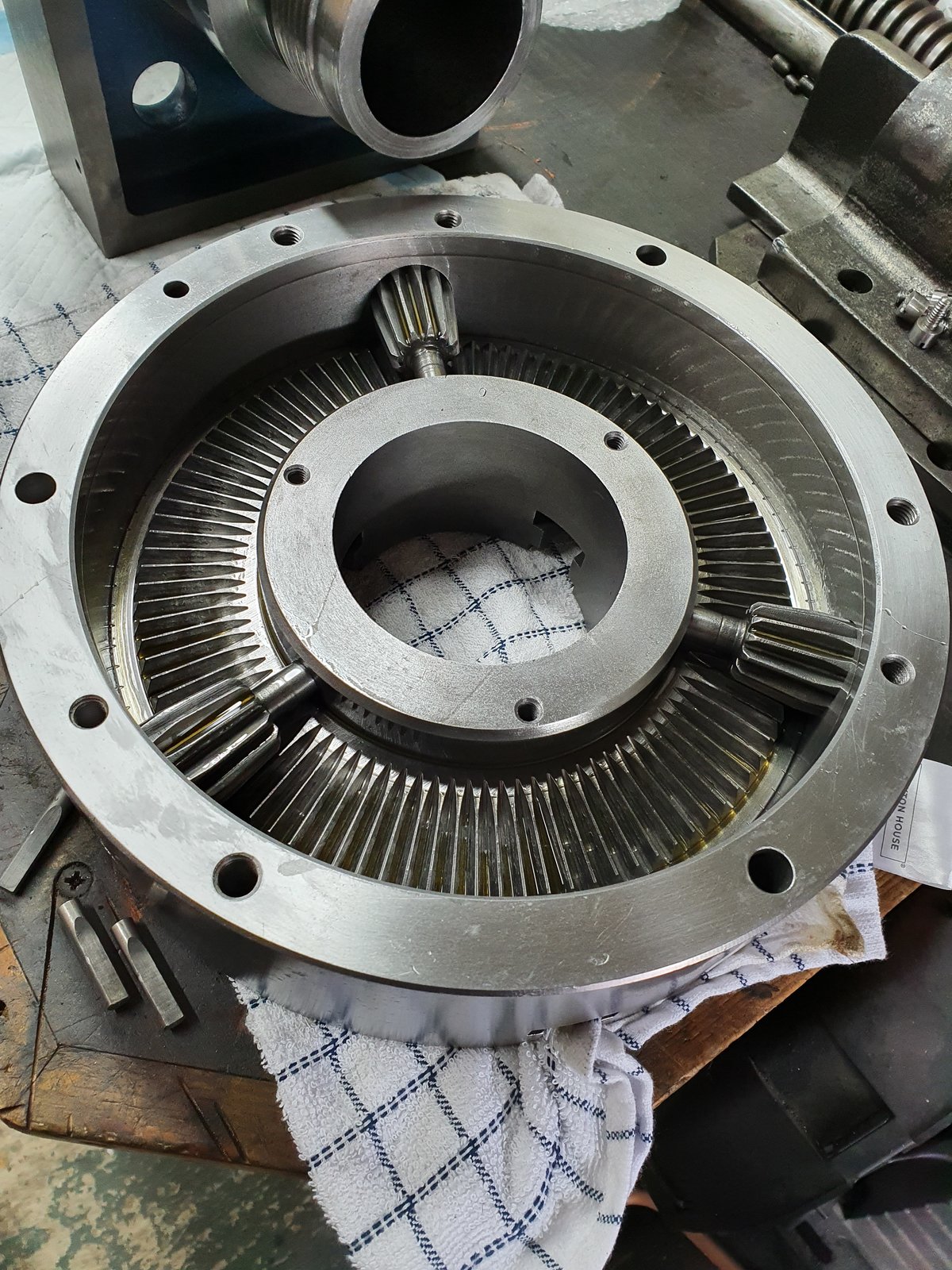

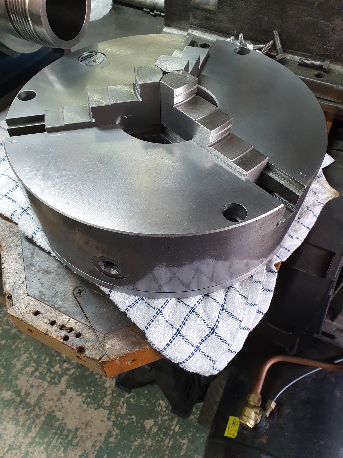

Three jaw complete. All parts spotlessly clean and oiled before assembly. I shant show all the photos as there is a lot of em. Works beautifully as should....time consuming and hard graft....four jaw next....but not just yet....do I want to do more chucks or for others....not partially.....unless ya got a pocket full of wedge ...View attachment 222637 View attachment 222638 View attachment 222639 View attachment 222640 View attachment 222641 View attachment 222642

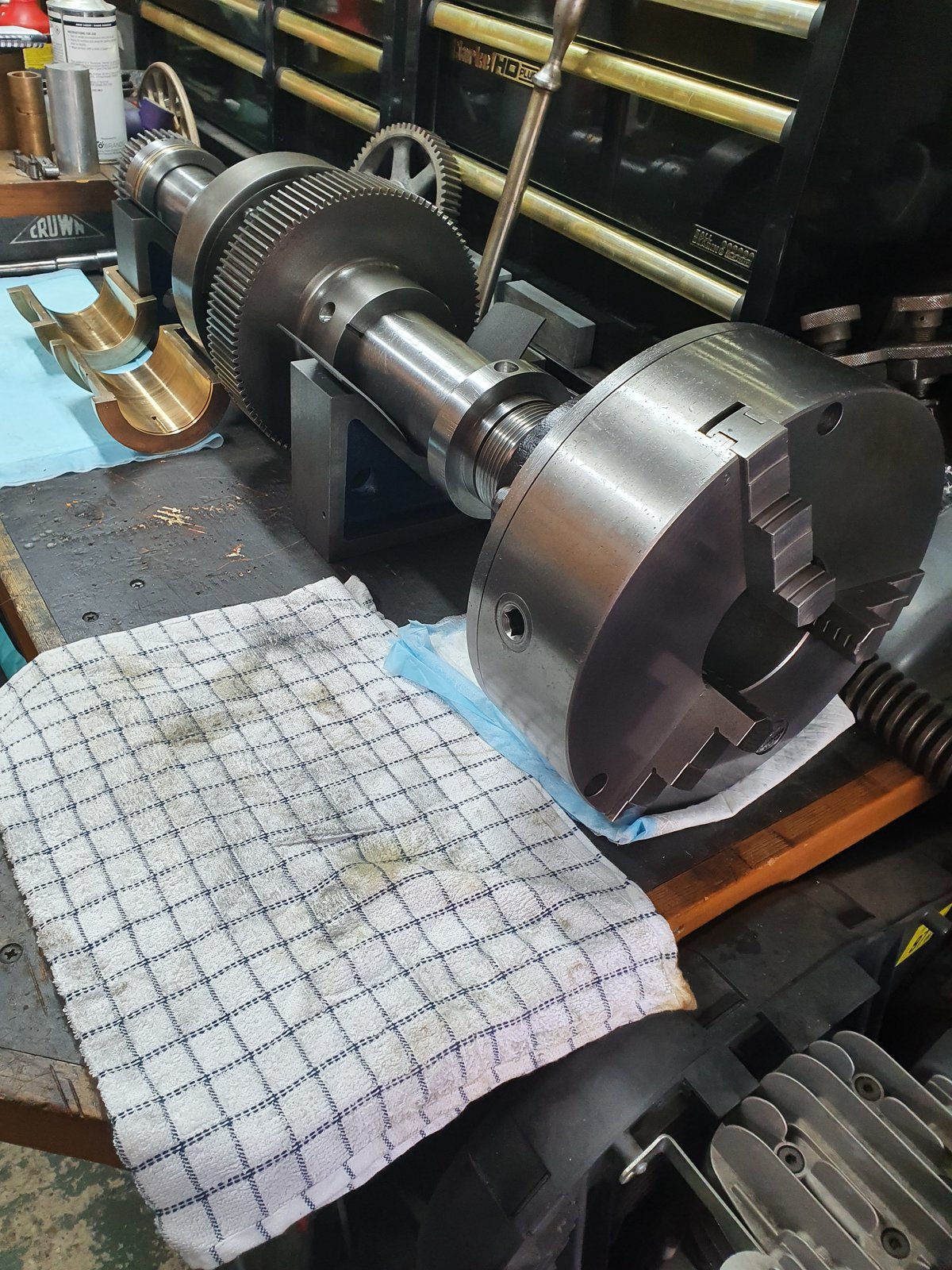

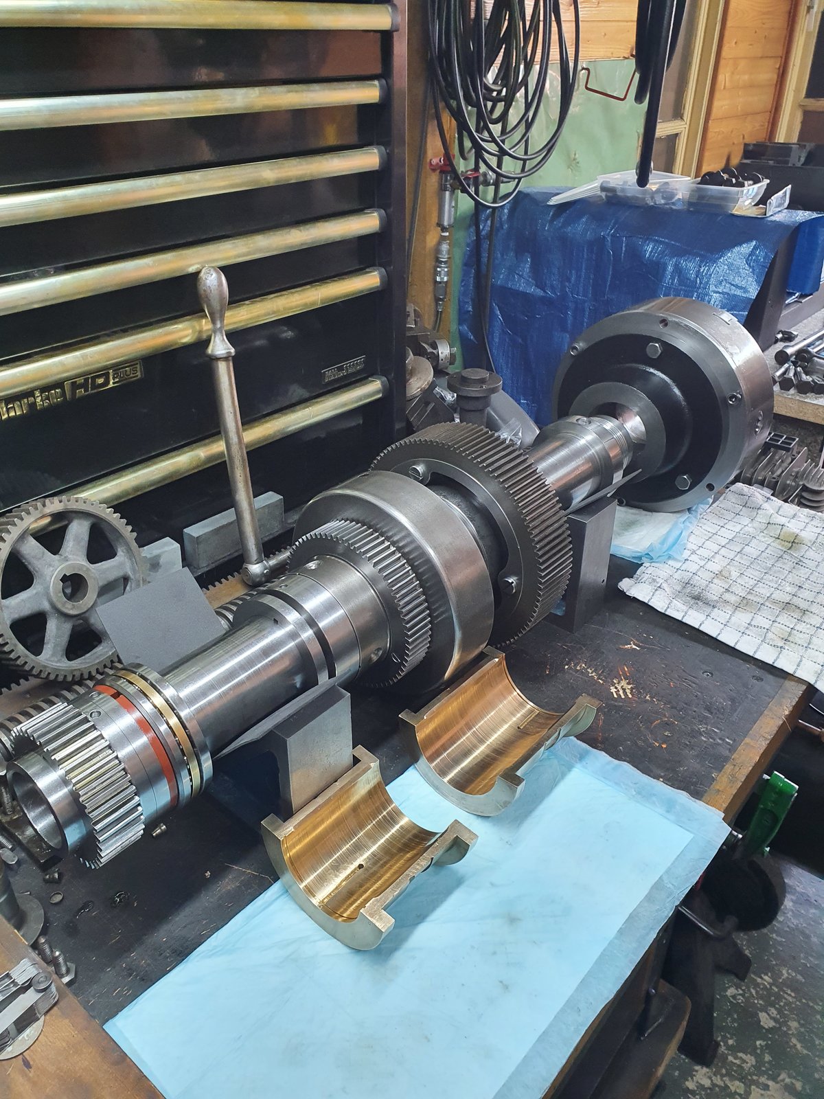

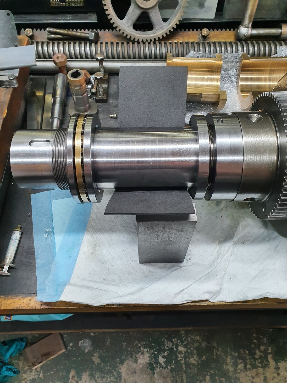

I will find out when I put the lot back together...I sure there will be fettling to doIt would have been interesting to know the runout before and after but I don’t suppose you could have measured this with the spindle on the bench.

Three jaw complete

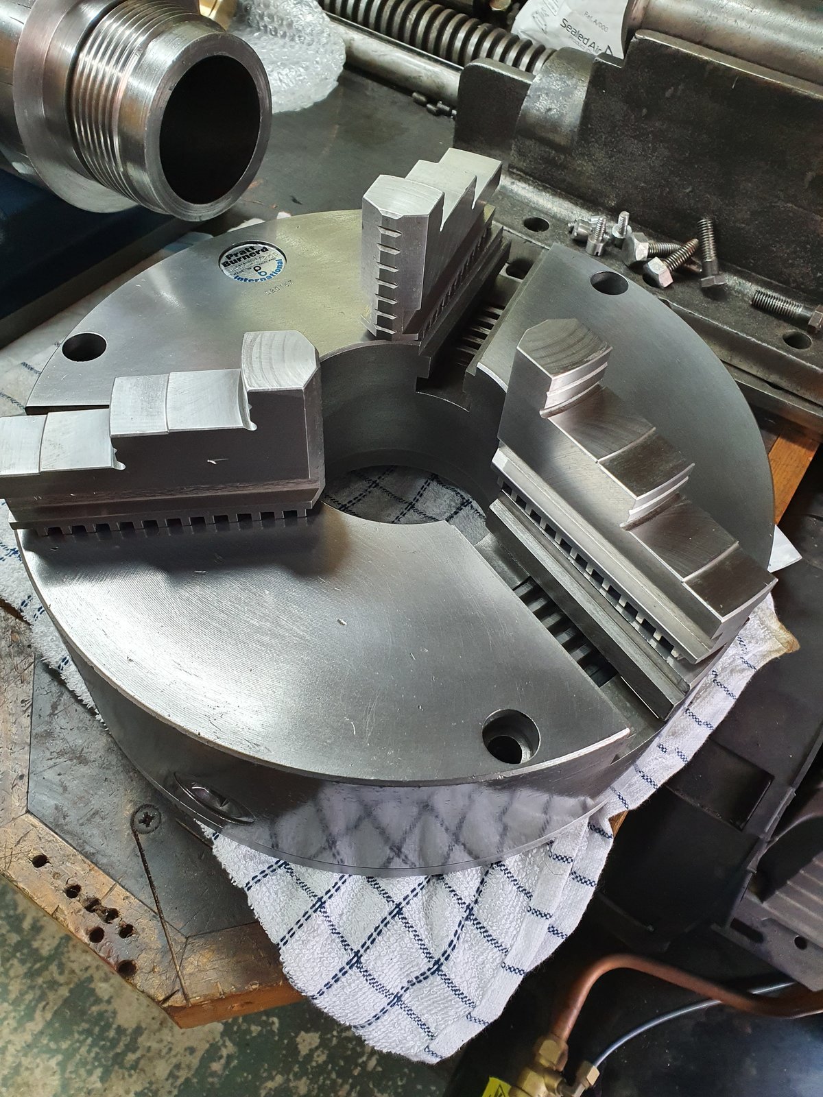

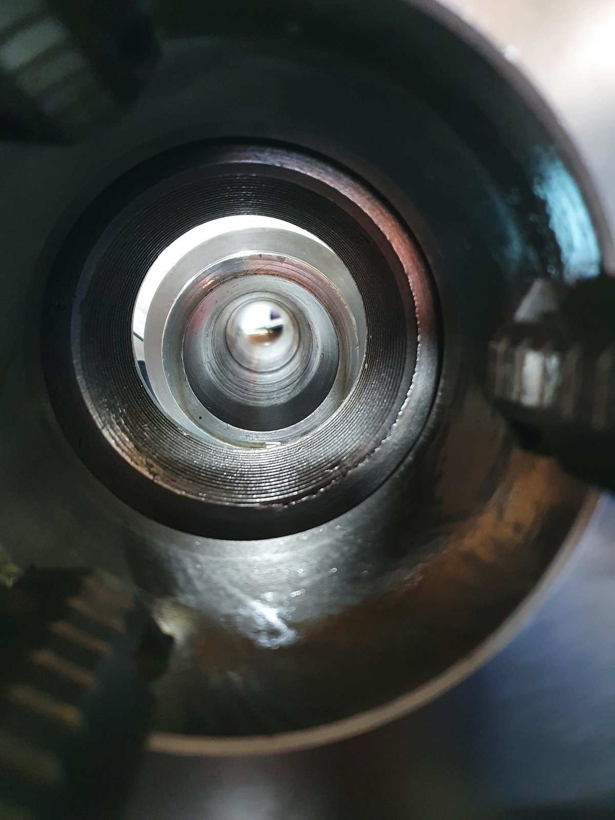

Its possible yes. Depending on the gap size. I have got to take a couple of bolts out for thread measuring so I will give it a look .Would it pay to put a gasket between the first backplate and the chuck body to fill the gap? Look at the swarf that was there when you dismantled it. Lightly glue it in place with RTV silicone.
Cheers brad. I am in the process of knocking up a drawing so will definitely give you a shout when I sort it.Can plasma cut you a pin or hook wrench if you need one

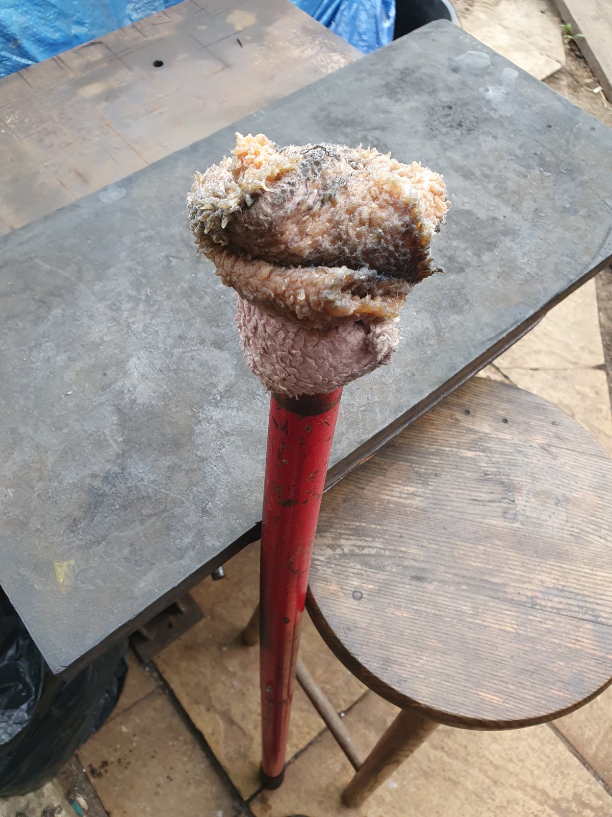

Tell me about it....I will do me best with itIt looks like it's been attacked by a Gorilla.
I'd turn some wood blocks
