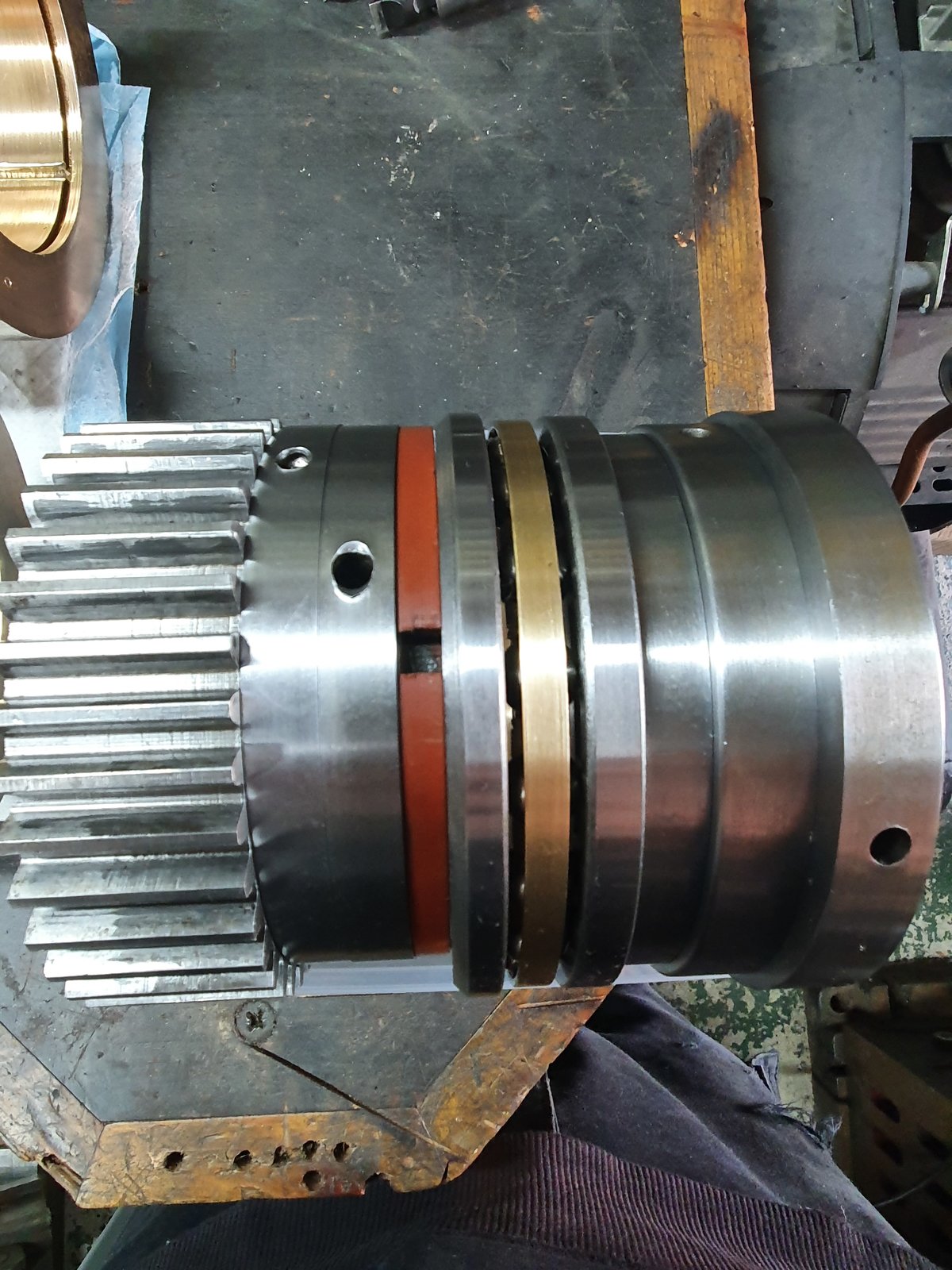

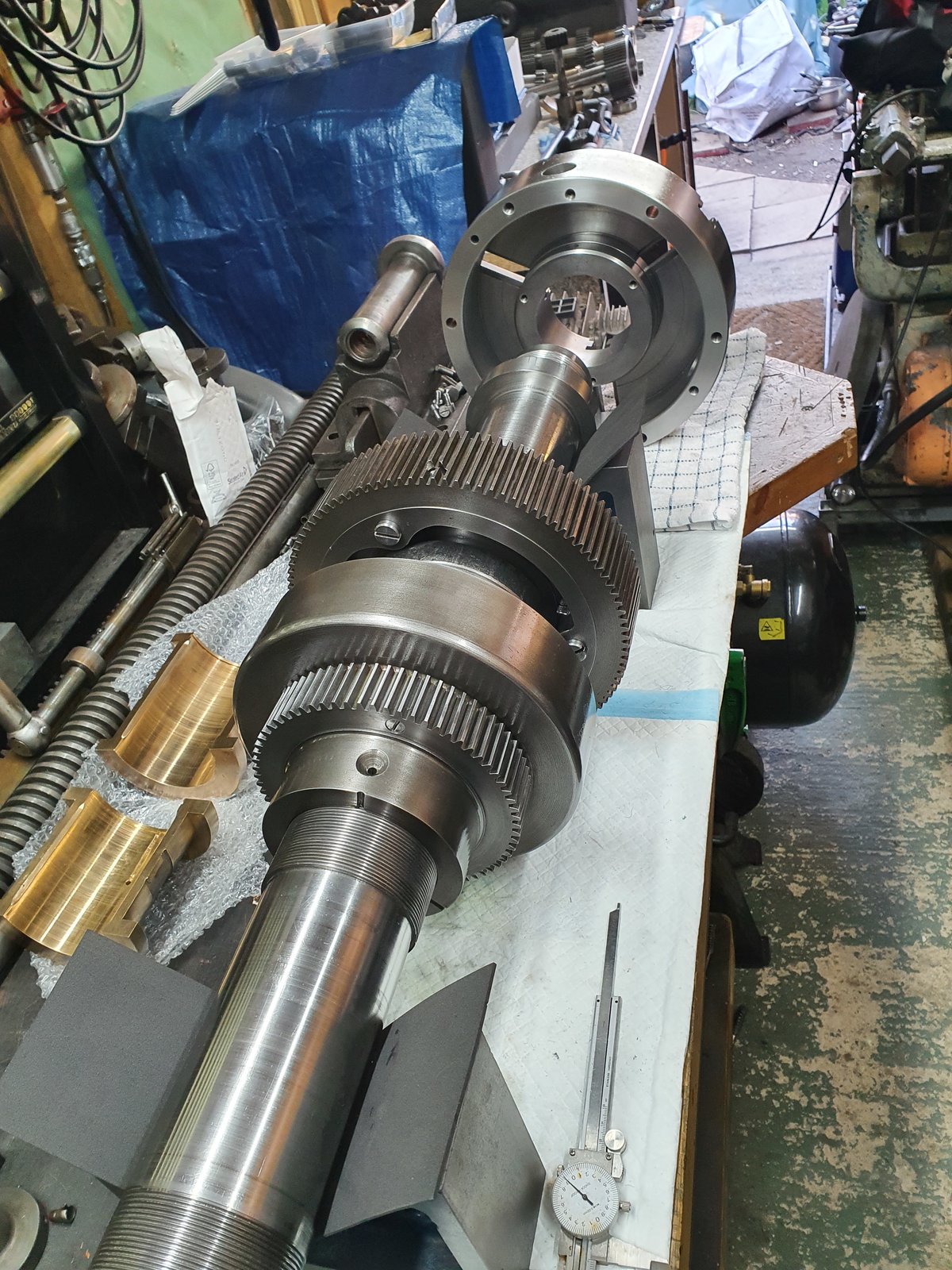

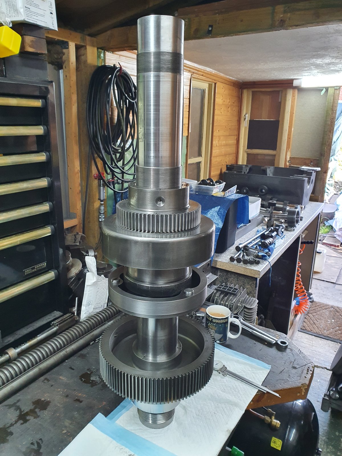

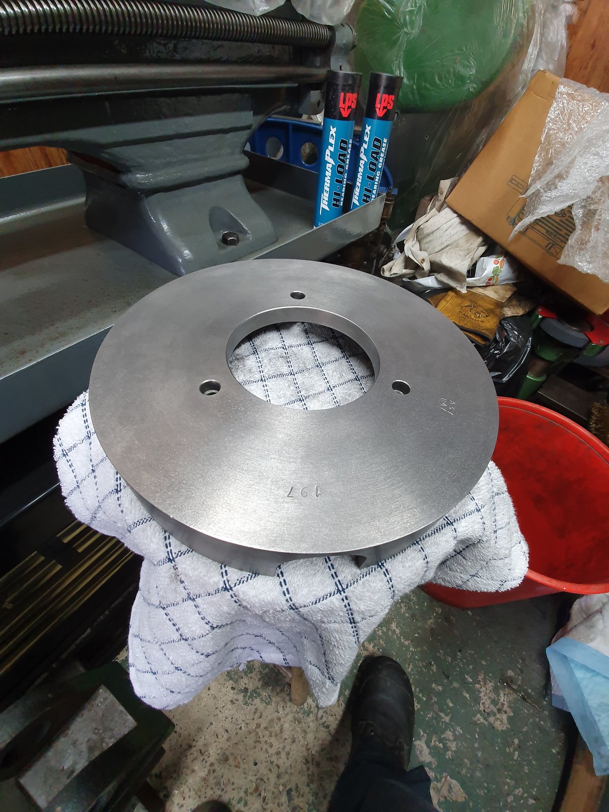

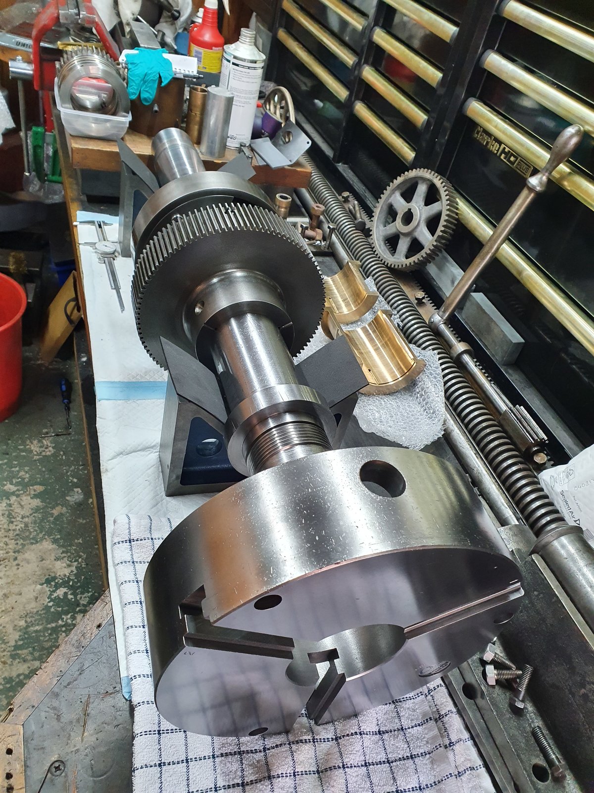

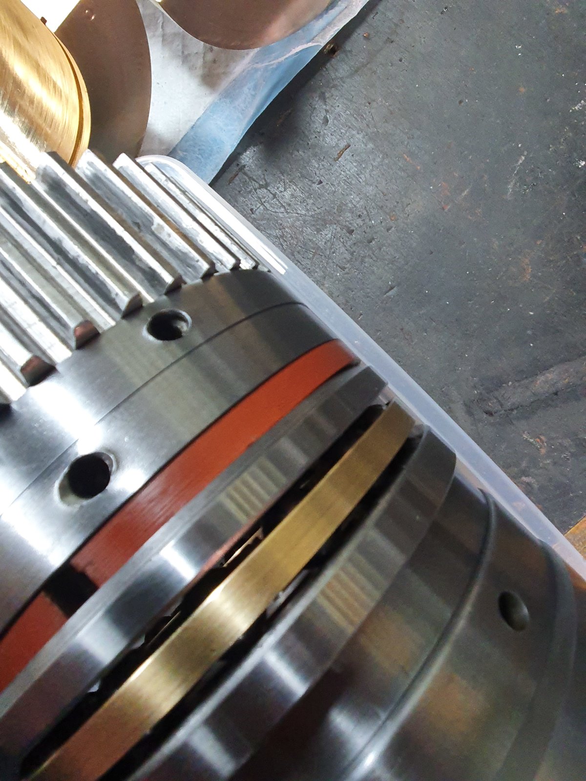

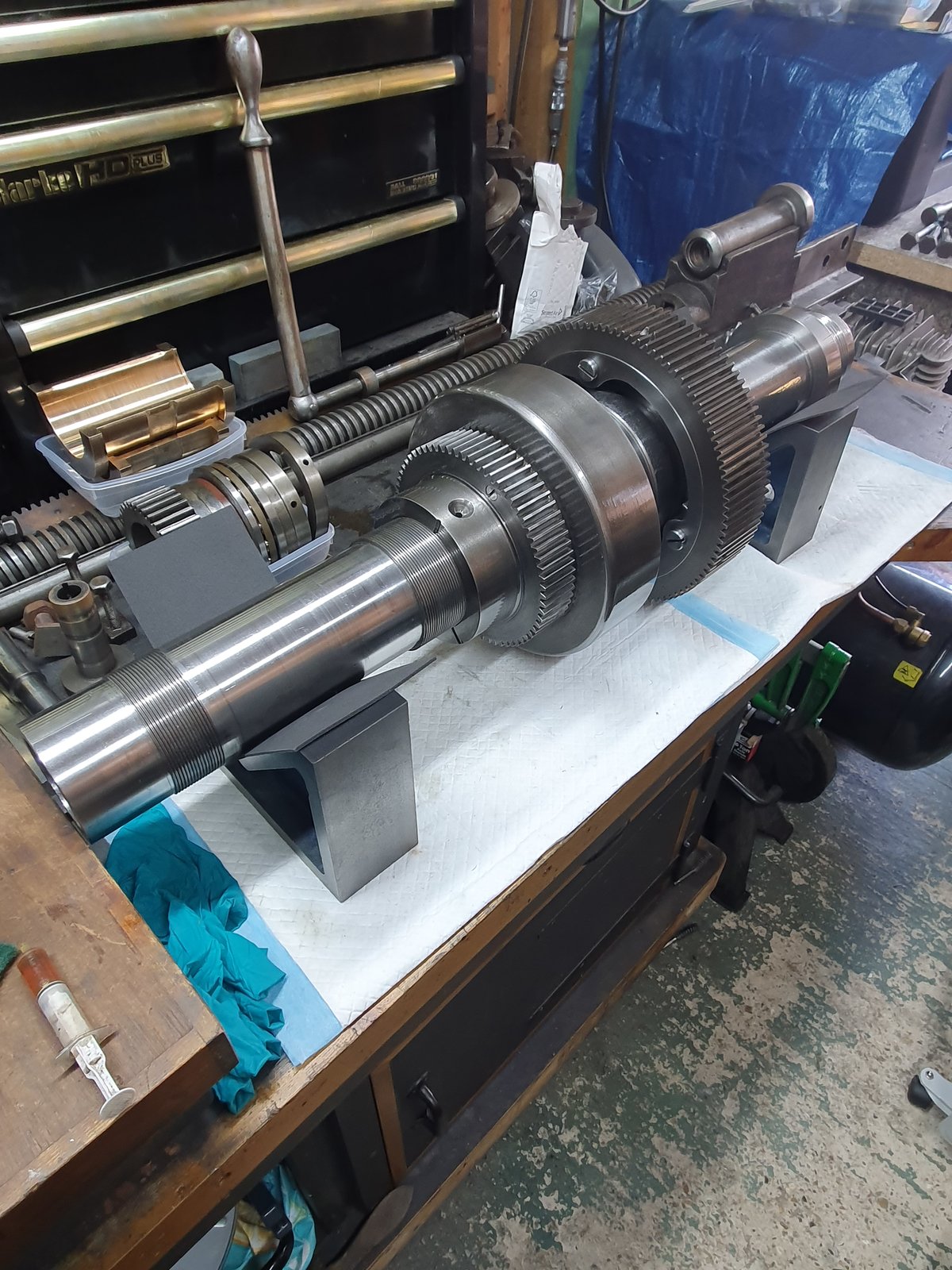

The last hub/bull gear is on. Clutches have been adjusted to the settings I had before removal. Final adjustment will be made when its complete and running.

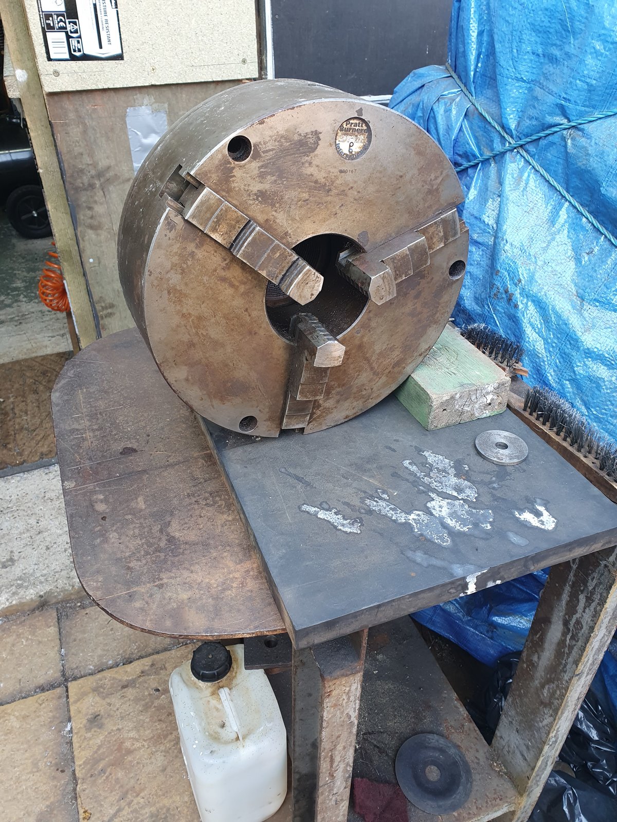

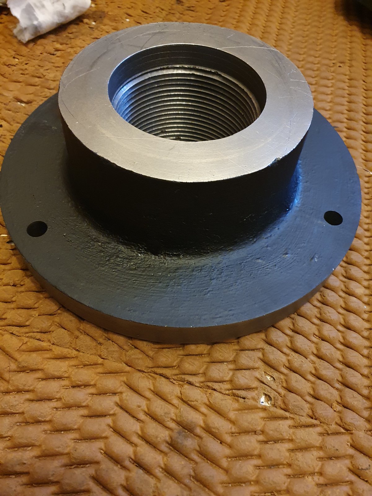

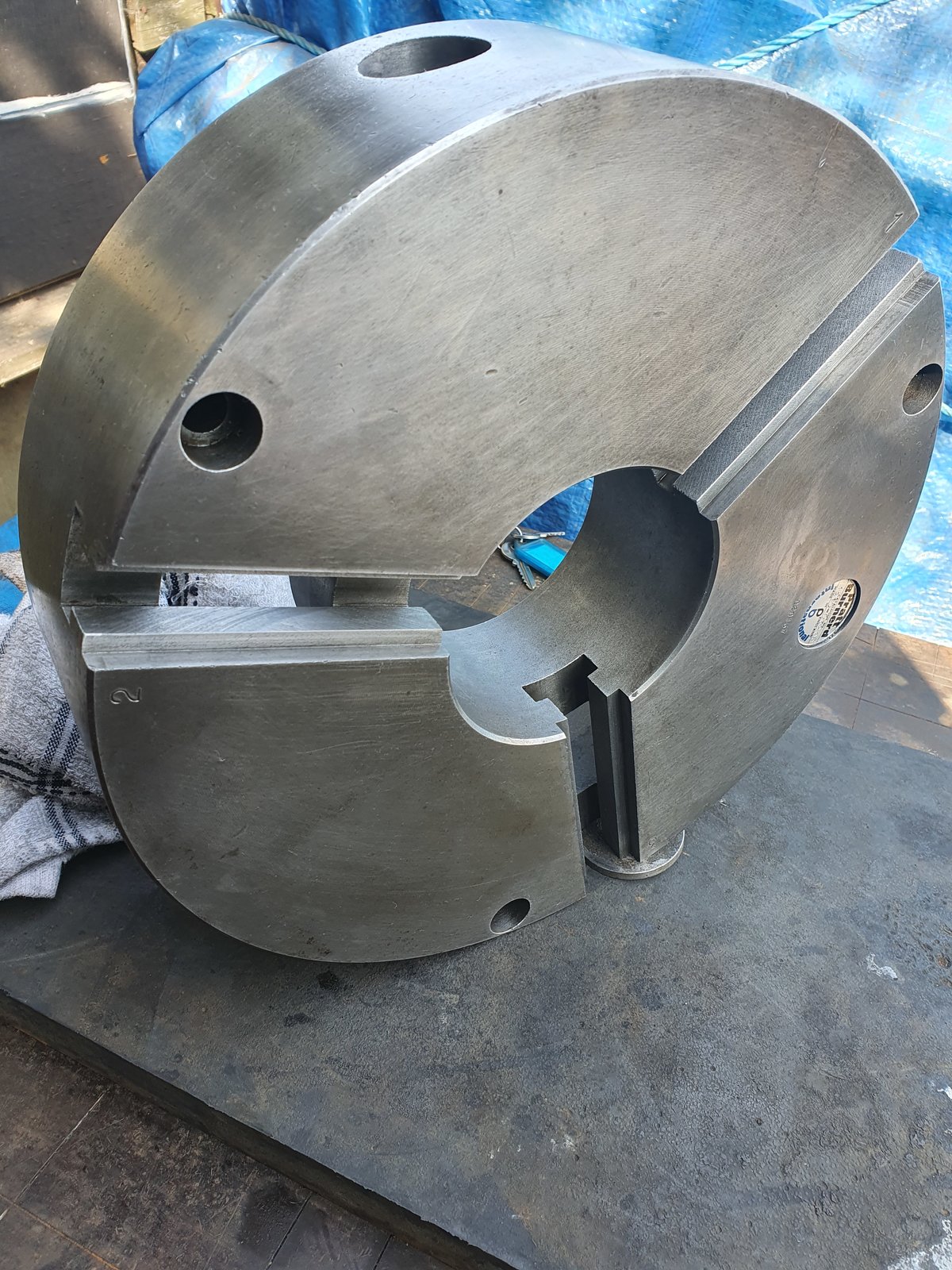

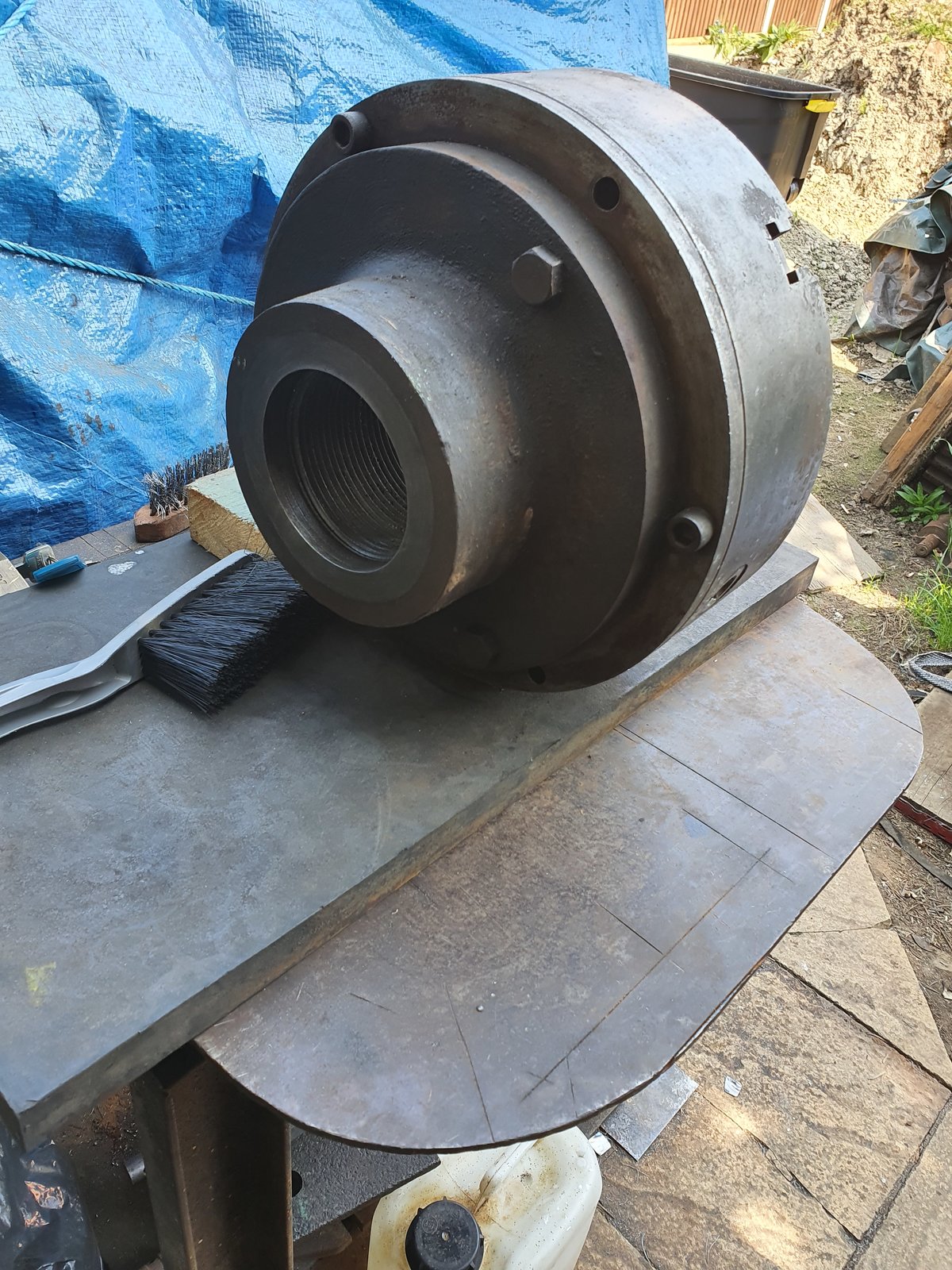

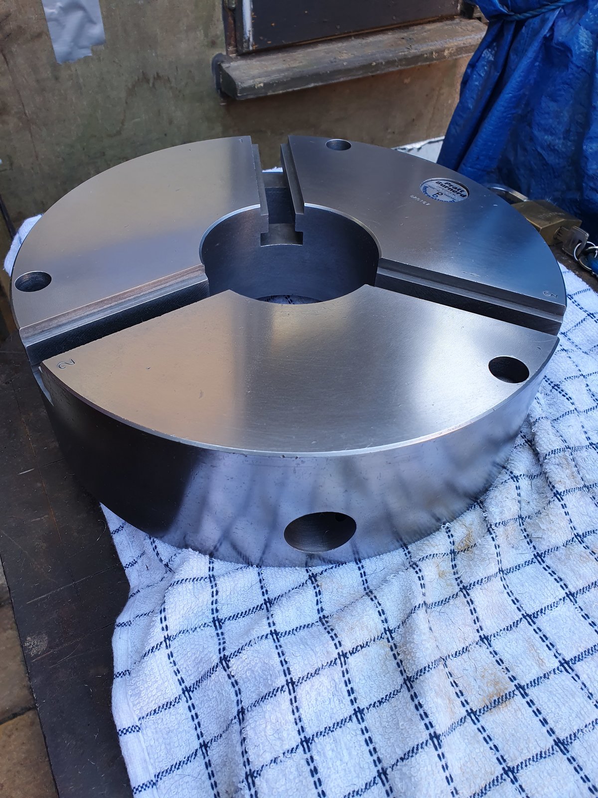

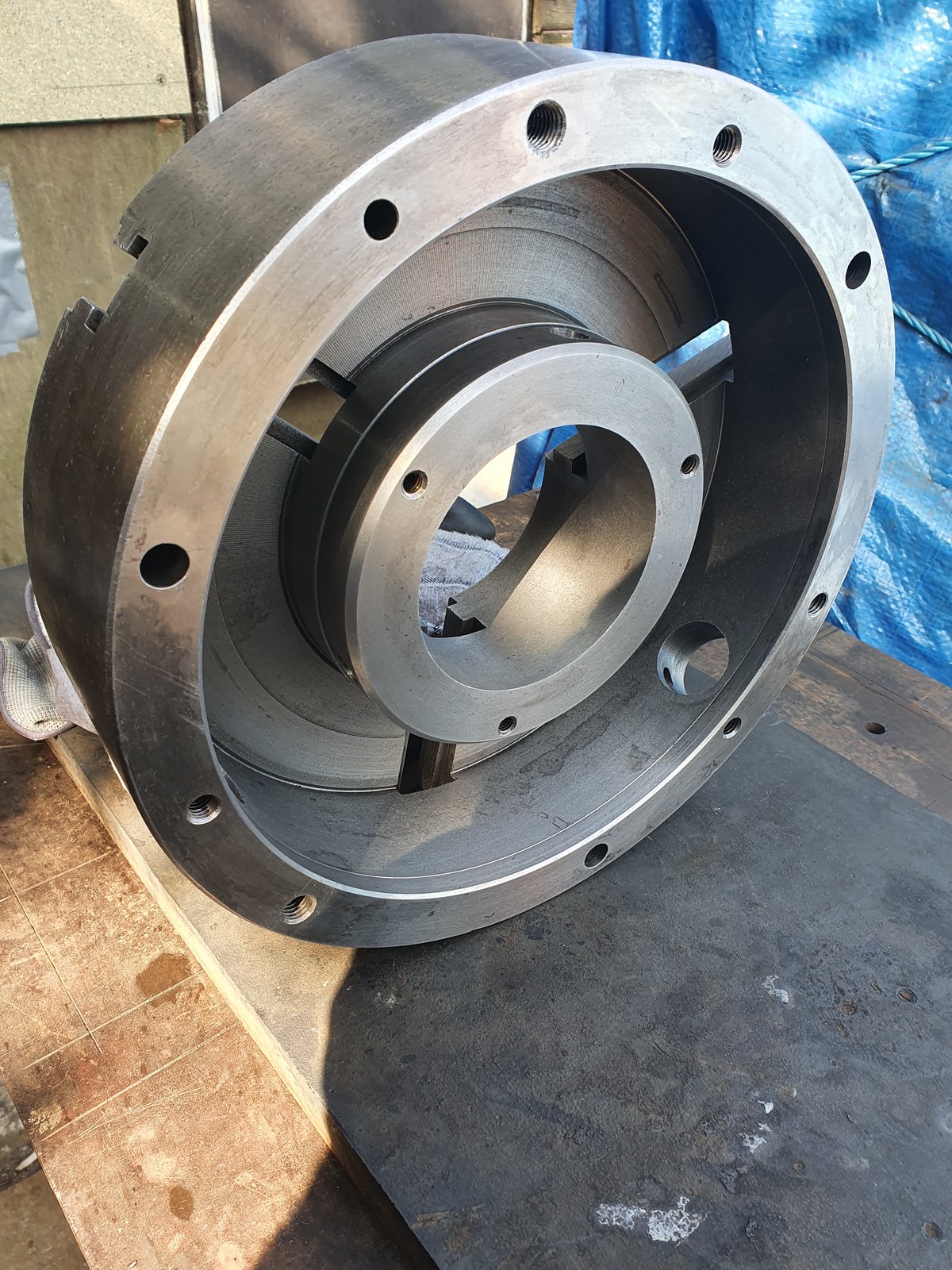

12 inch. You mean backplate fitting ? L taper wasn't invented when this machine was in designWhat diameter is that? And what is the chuck fitting? Surprised they don't use L taper.
Yer you no know that. Can only just about lift it. I definitely wouldn't be able to thread it on the spindle.Ahh modern technology!
Chuck looks bigger in tbe pics. Mine is 12" I think and I have a 14" 4 jaw along with a 24" faceplate.
Bloody heavy things to play with.
Maybe we should have started collecting stamps instead![]()
I will weight it later. Without the backplate. But complete I can just about lift it on to the bench.How much does a 12" chuck weigh?
Ain't got a clue........Spencer - how on Earth do you get everything looking like new? Those parts look like they have just been manufactured!

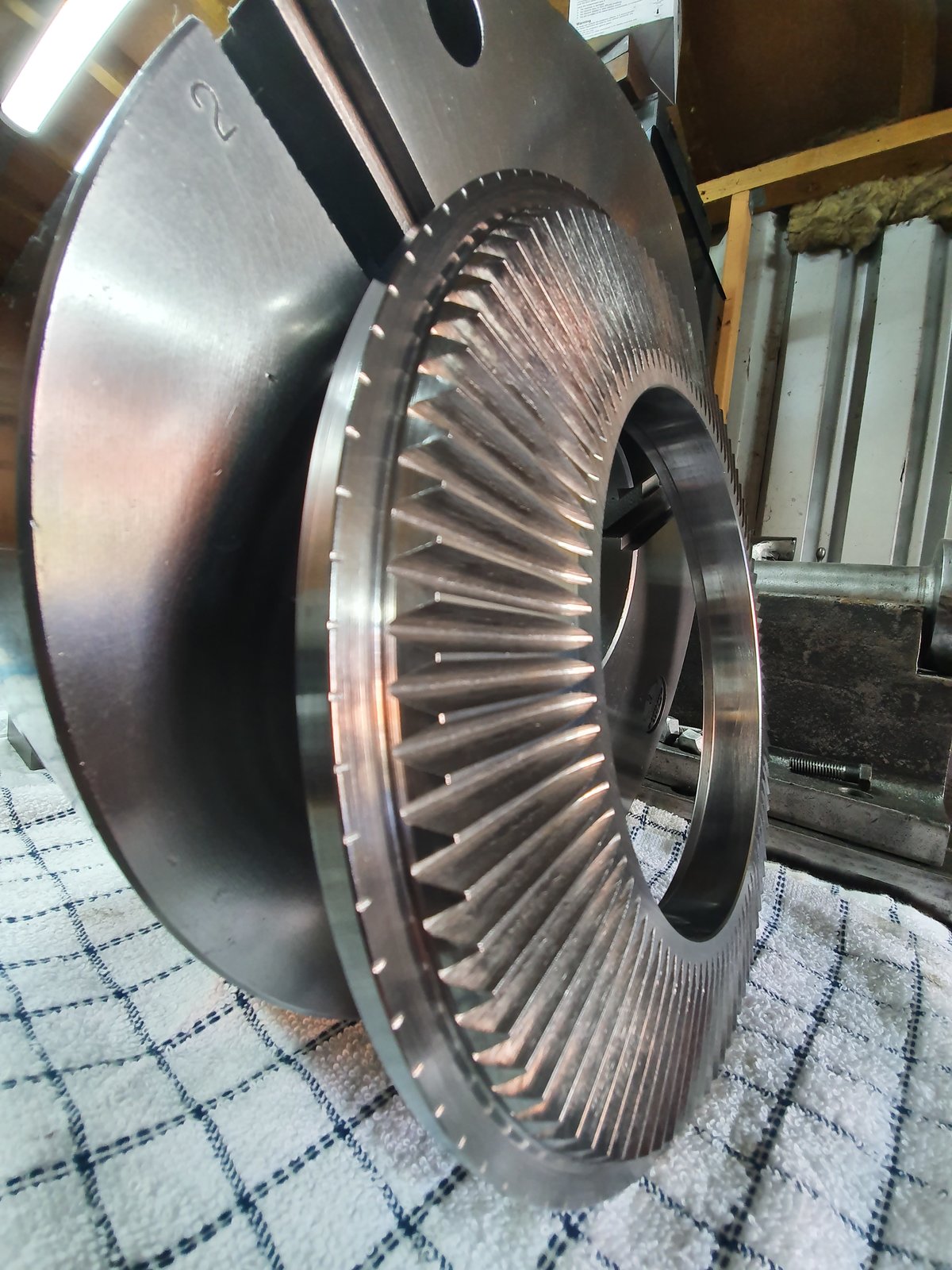

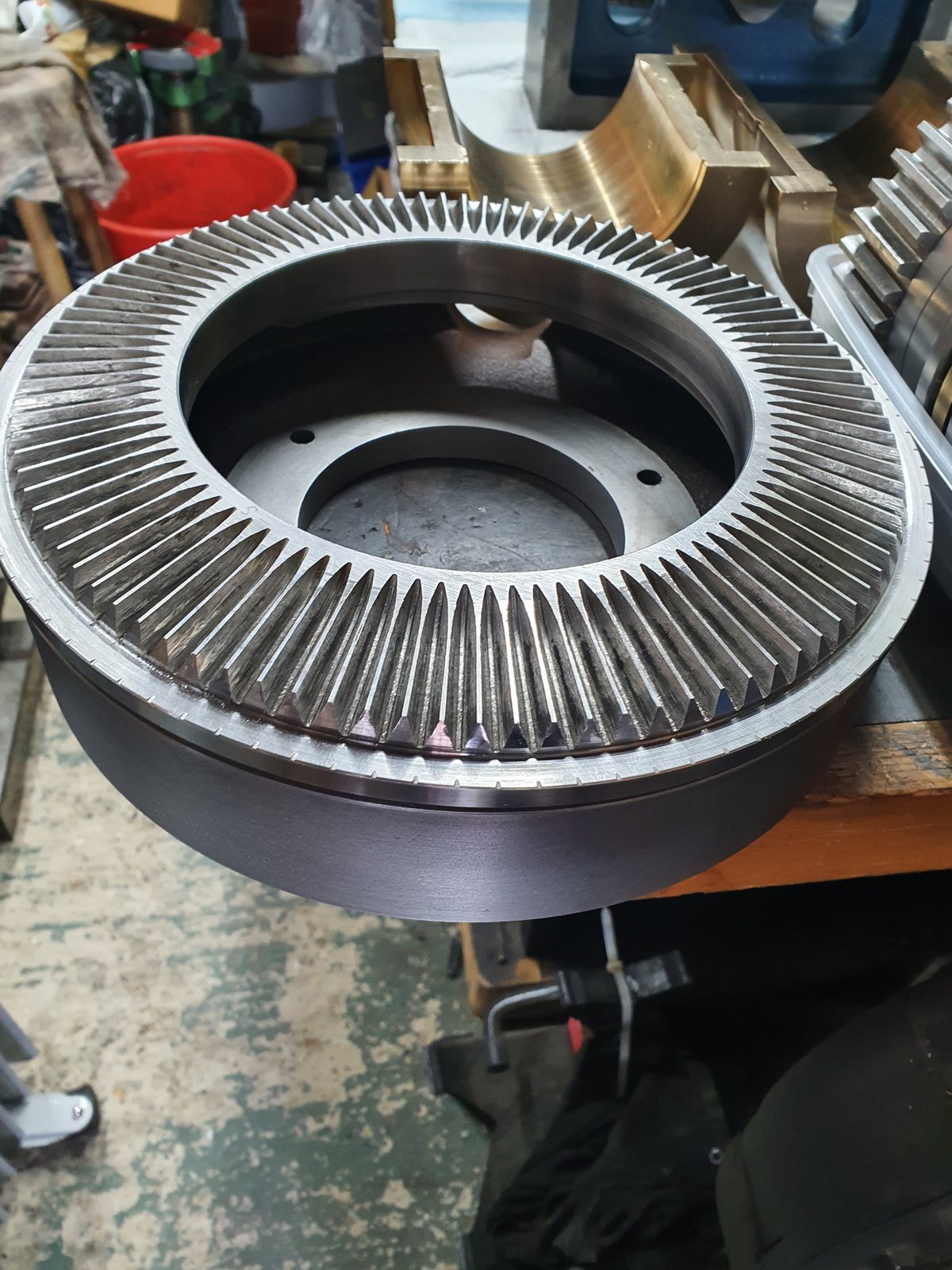

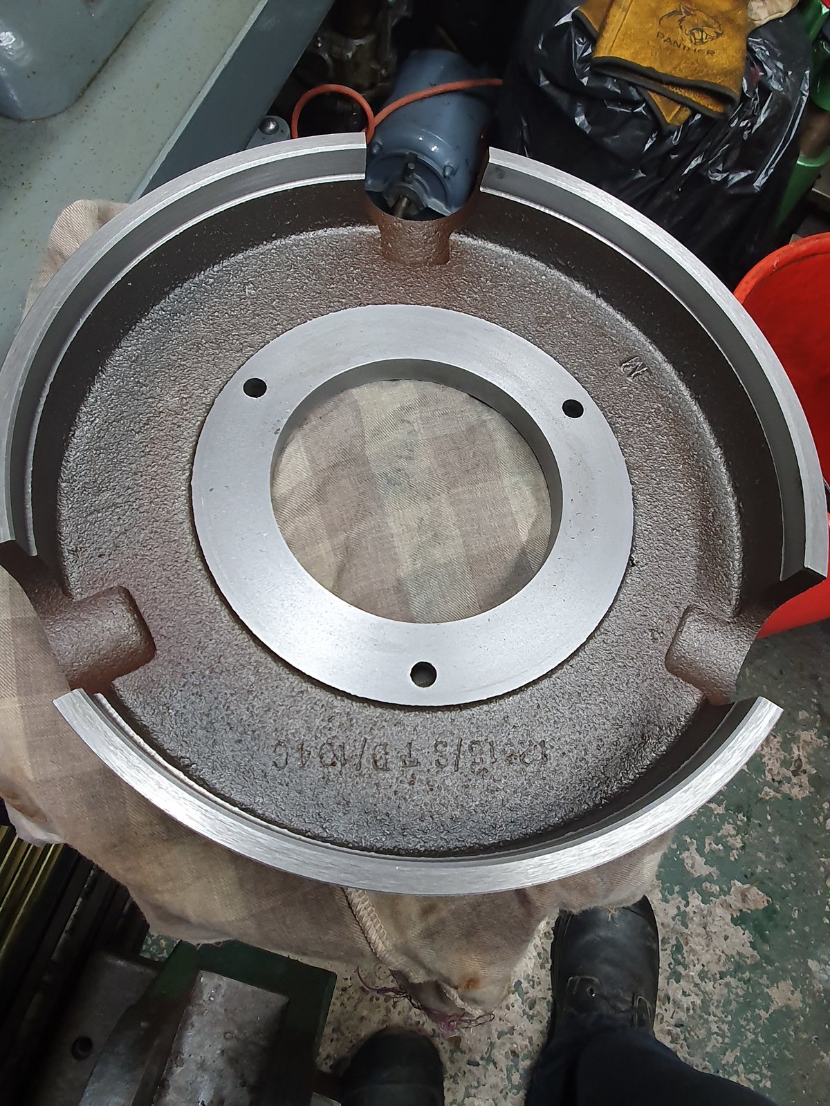

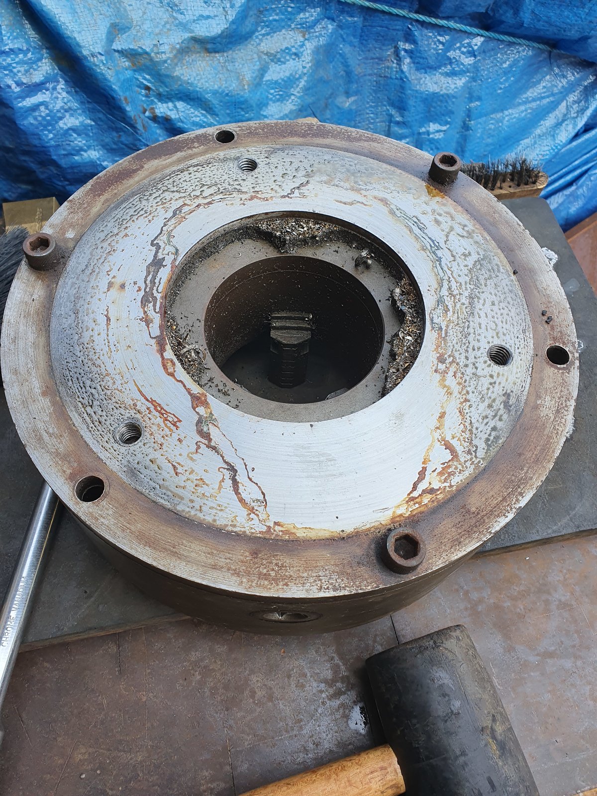

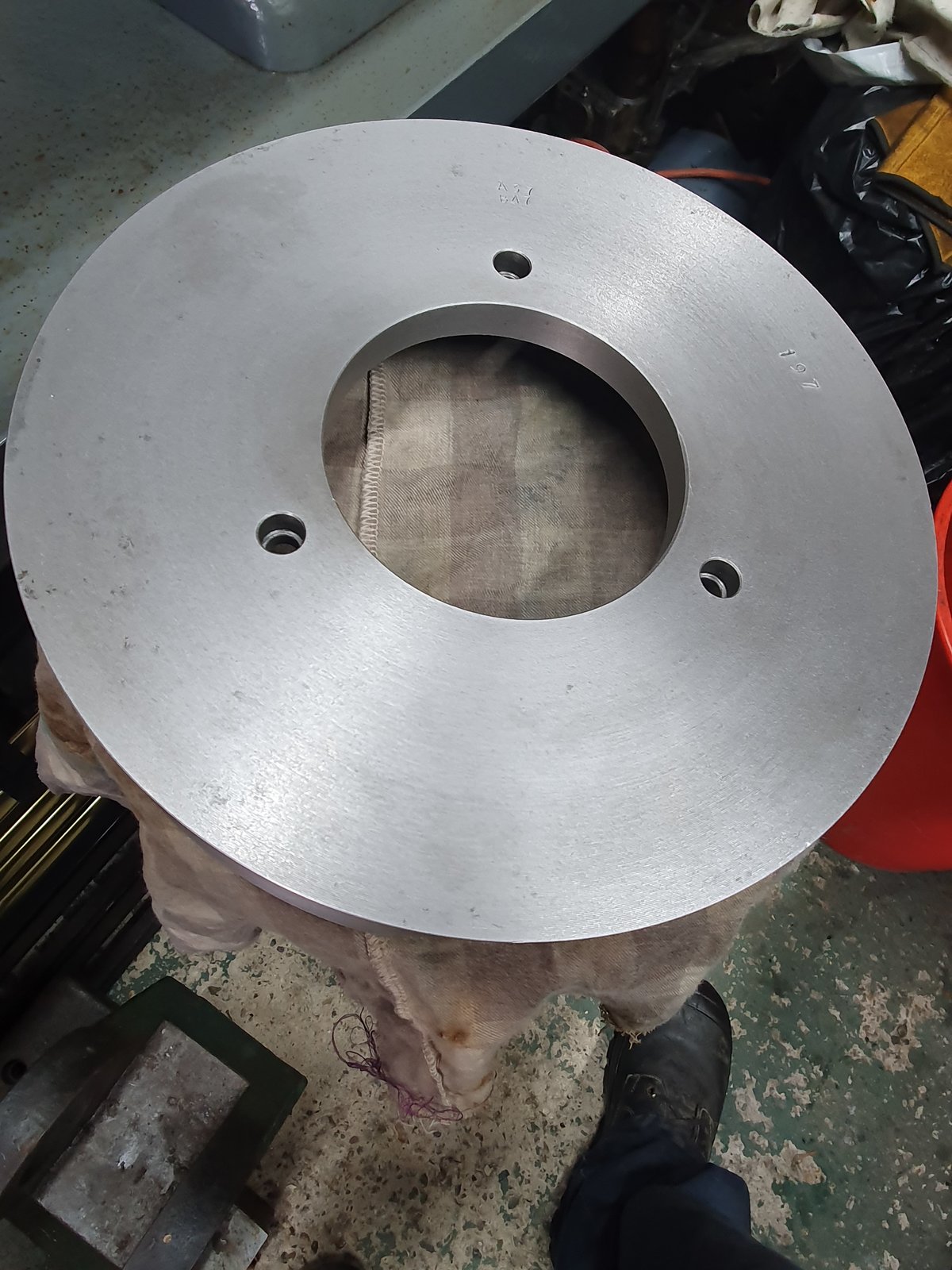

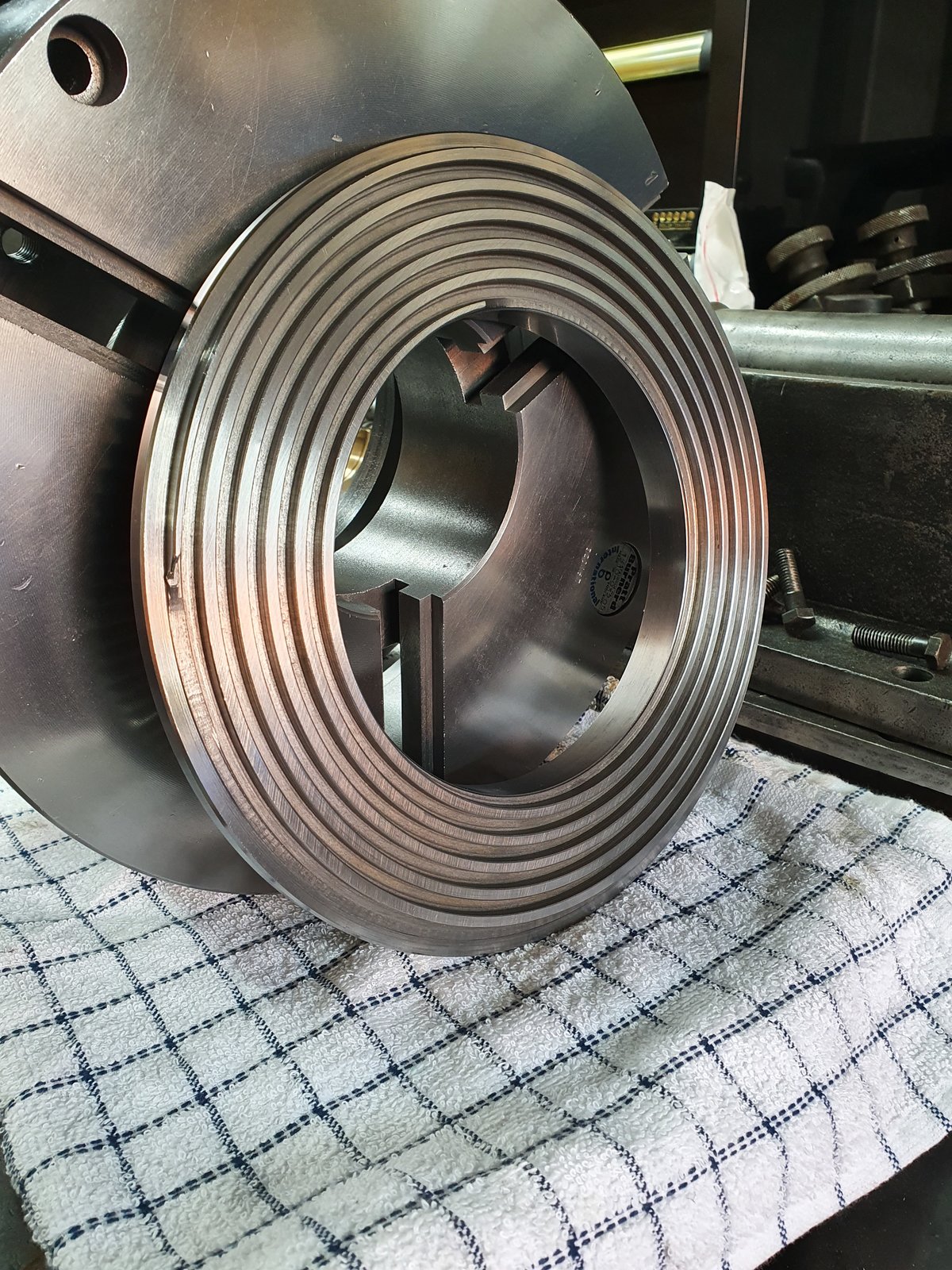

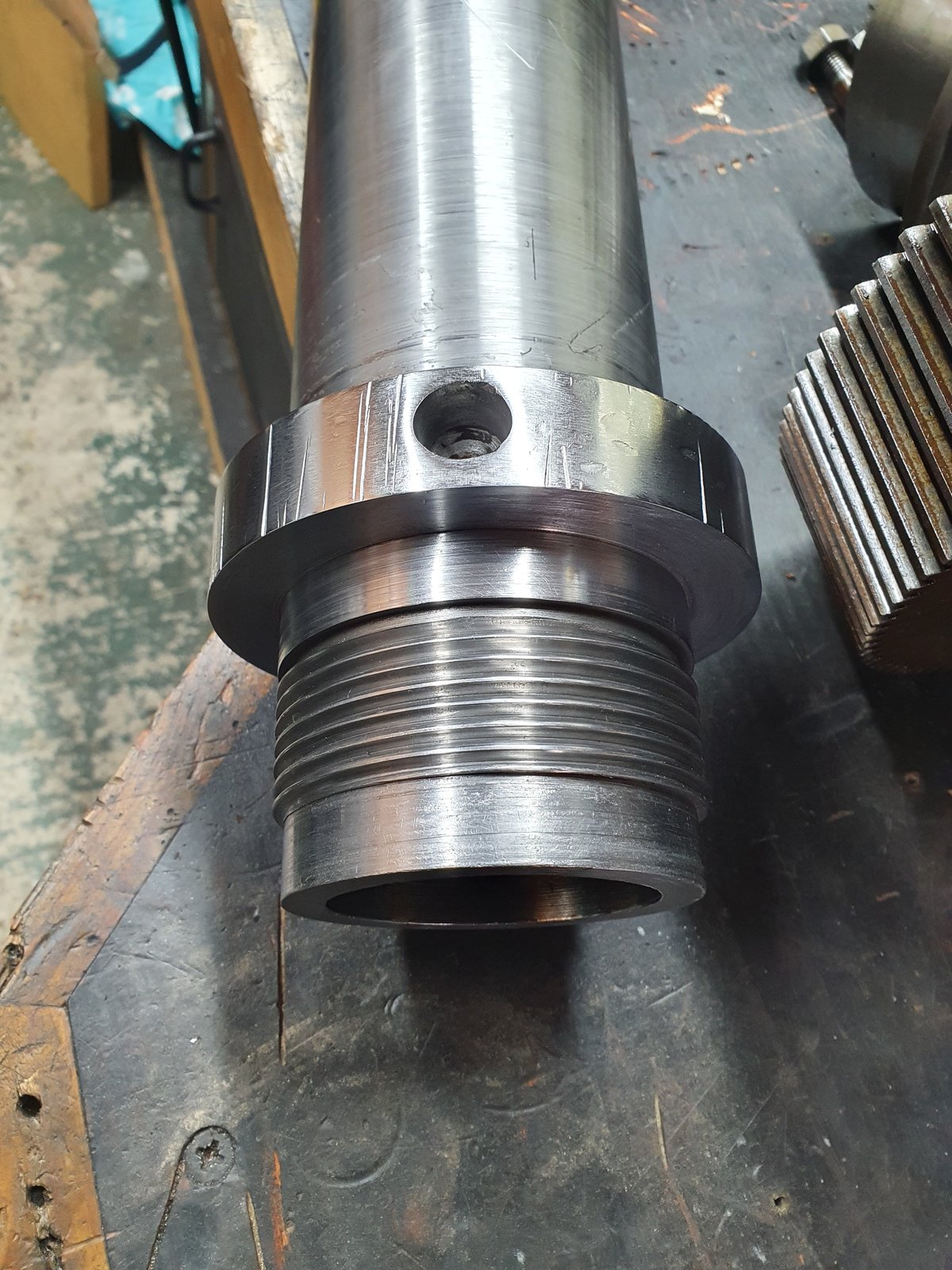

I cant get rid of the awful teeth Mark's left behind by some toss job. But have made a start taking the worst down a fraction. Just got to re drill the hole and a good polishing View attachment 220704

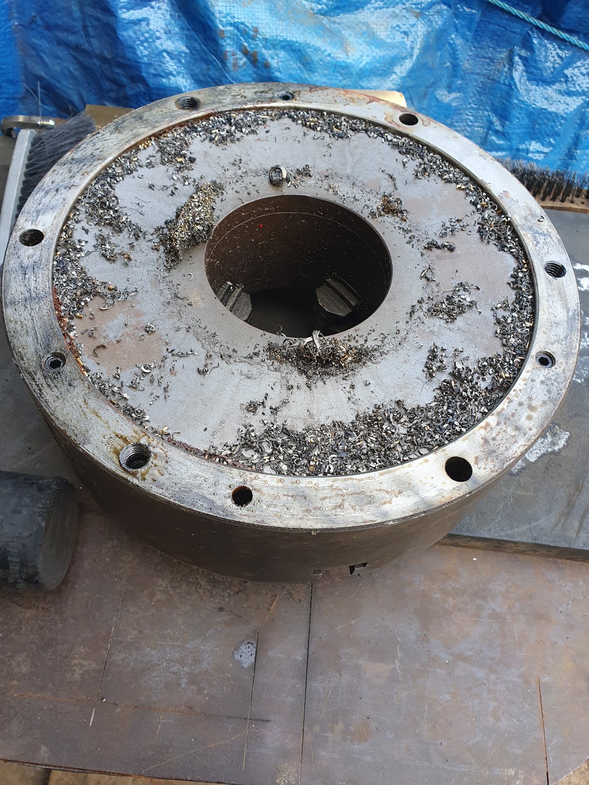

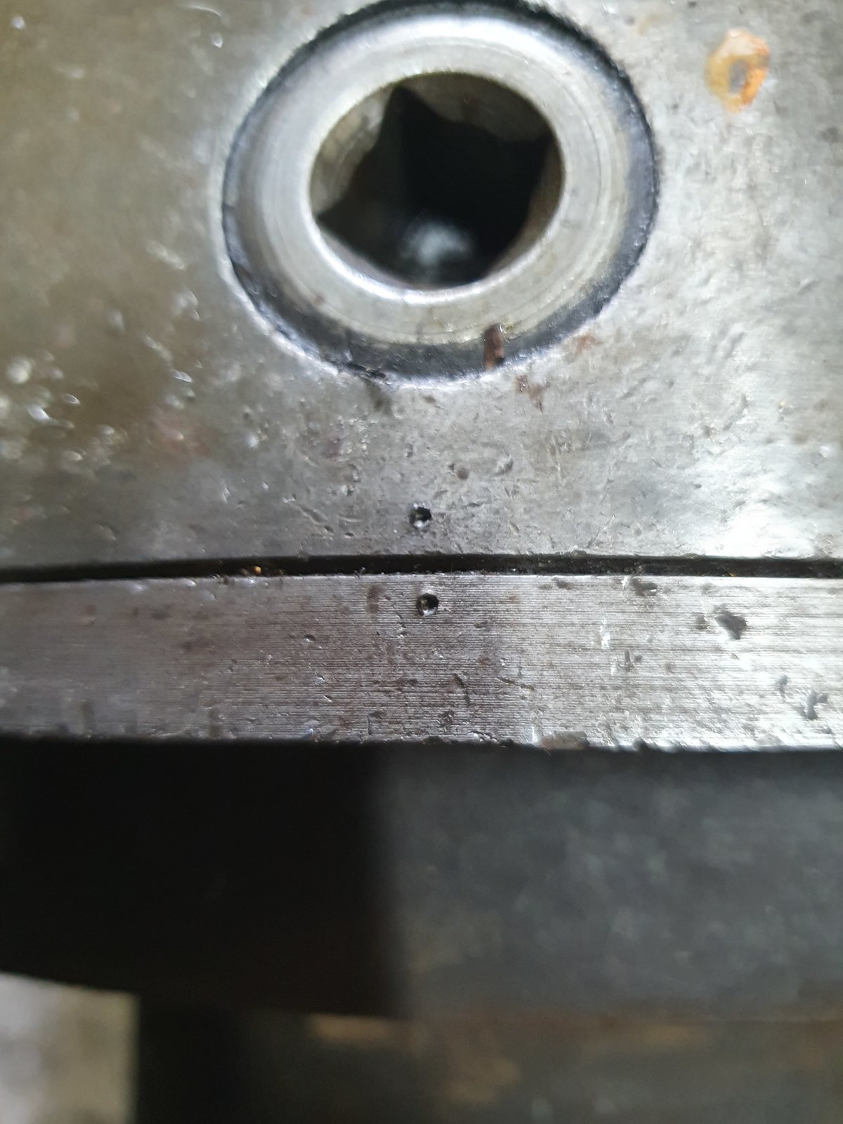

Yes. Its had some abuse but mild compared to some... if they had used the correct method in the first place it would of been ok. That's what the hole is there for. But I will make s big c spanner to do this....Thet suggests they've in the past had to chuck stuck.
Better that than mash the back gears
