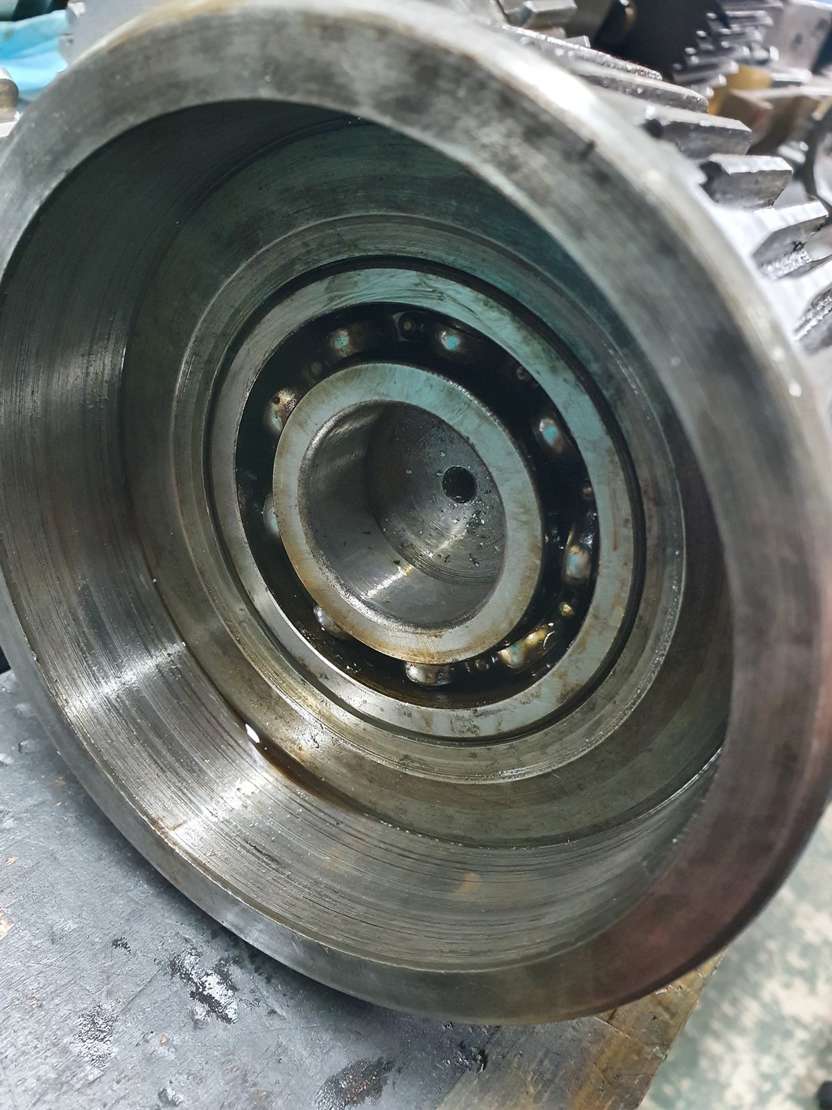

You would expect it to be pete .I'd say that is all one piece.

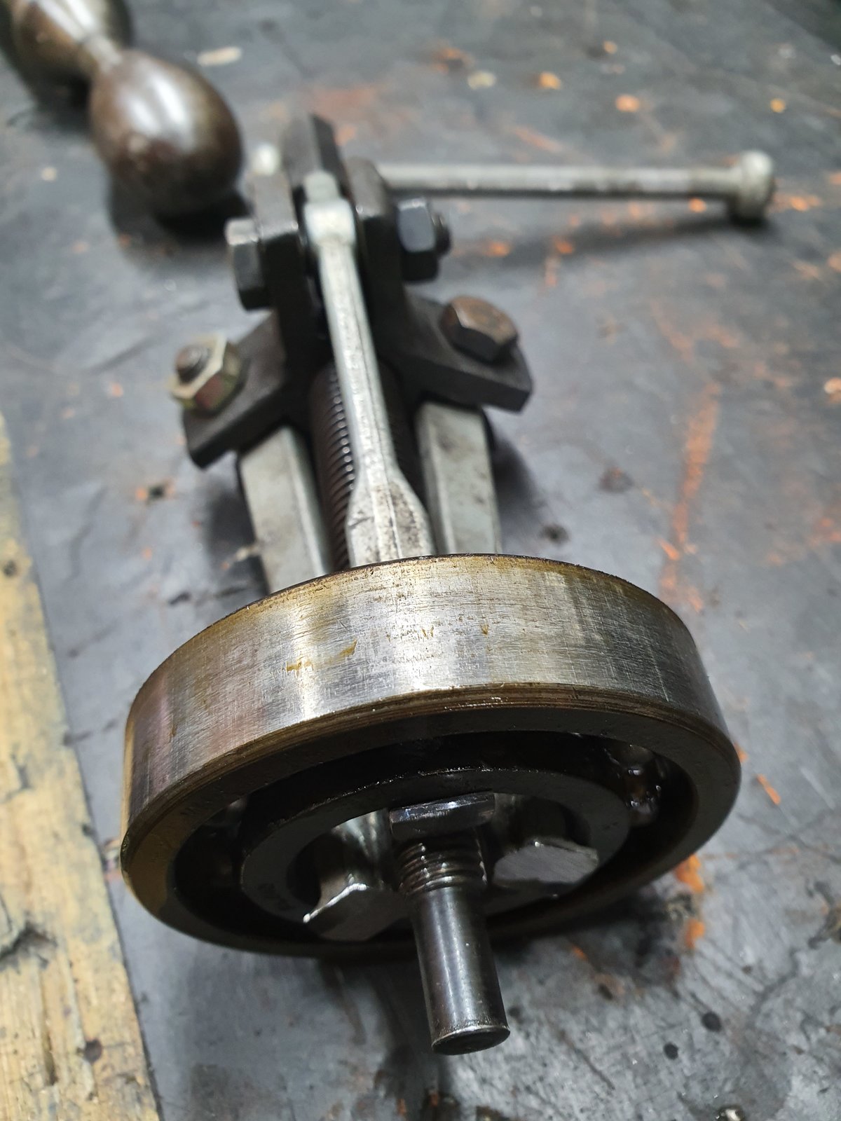

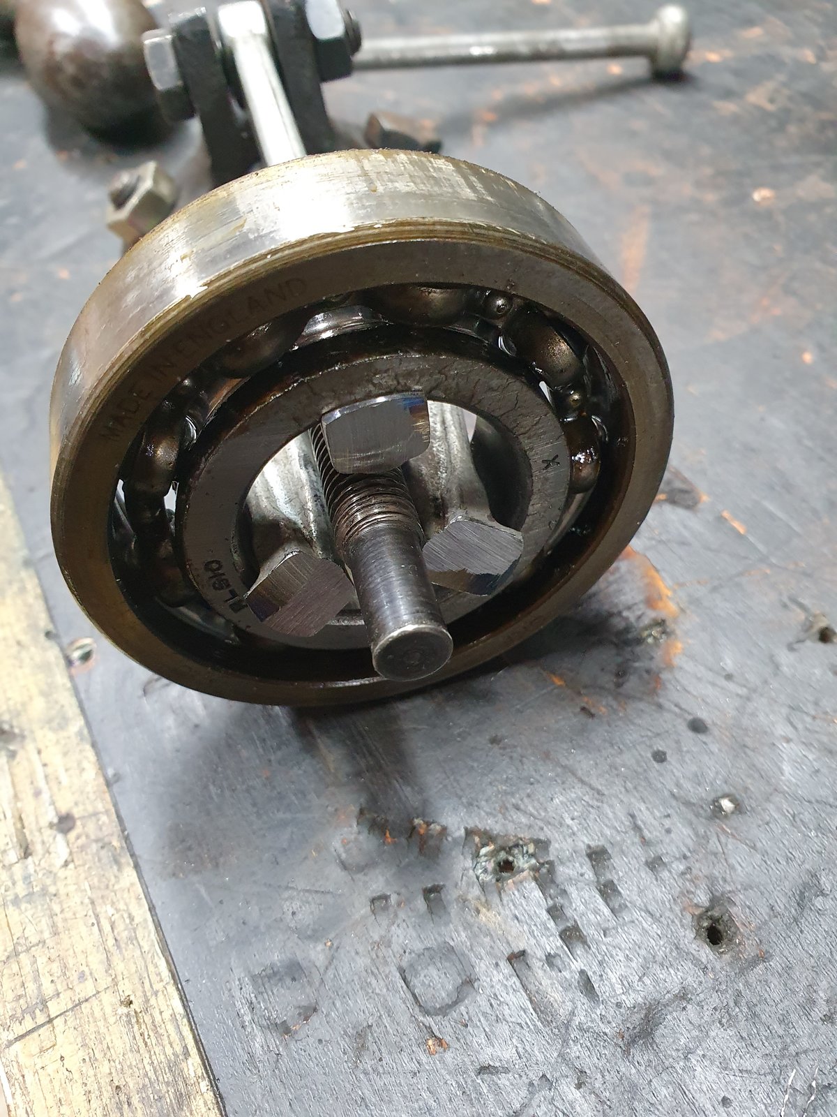

I will use a blind bearing pullerCan you not make some "flatted round" ended legs for a puller to get in between the inner and outer of the bearing and just pull it out, maybe with some heat?

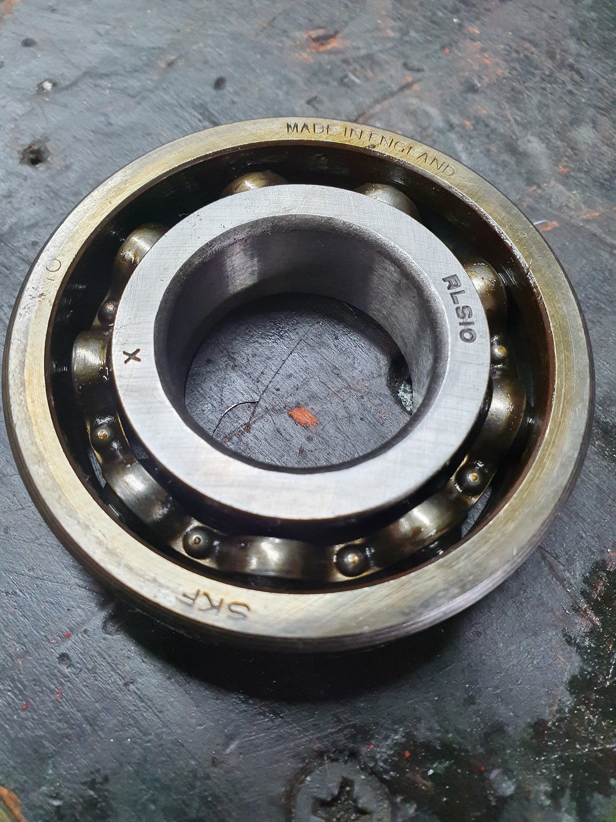

70mm outside D. 32mm inside D. That's as close as I can get so probably imperial. My plan is to upgrade to a sealed type. I know some bearings are designed to have oil pass through them but have studied the layout and csnt see it causing any issuesWhat are the dimensions of the bearing? It's difficult to get a scale from the photo.
Cheers mateOh, tiny then
LJ1-3/4 is the equivalent.
