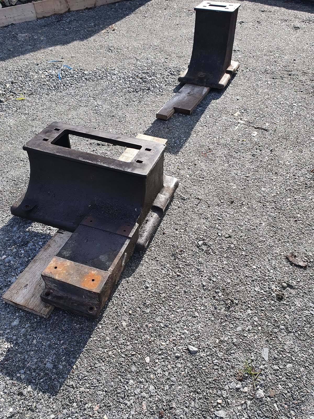

Today's joyful exercise. Separate the lathe bed from the stands.
Yer. That's going soon. The ol bmw has had its day now. I can squeeze a few more with it out the way...How did that e39 manage to squeeze itself in there? That means you have at least room for another BIG machine.....![]()

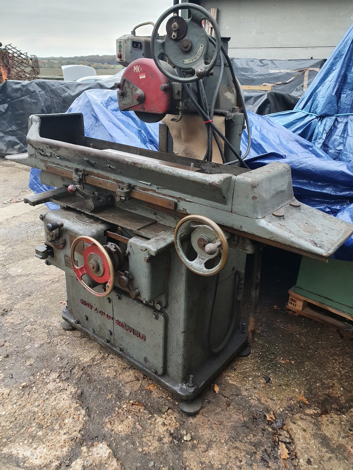

This my oneColchester Lathes used Snow grinders. Could well be from their factory...
Snow are my favourite grindersColchester Lathes used Snow grinders. Could well be from their factory...

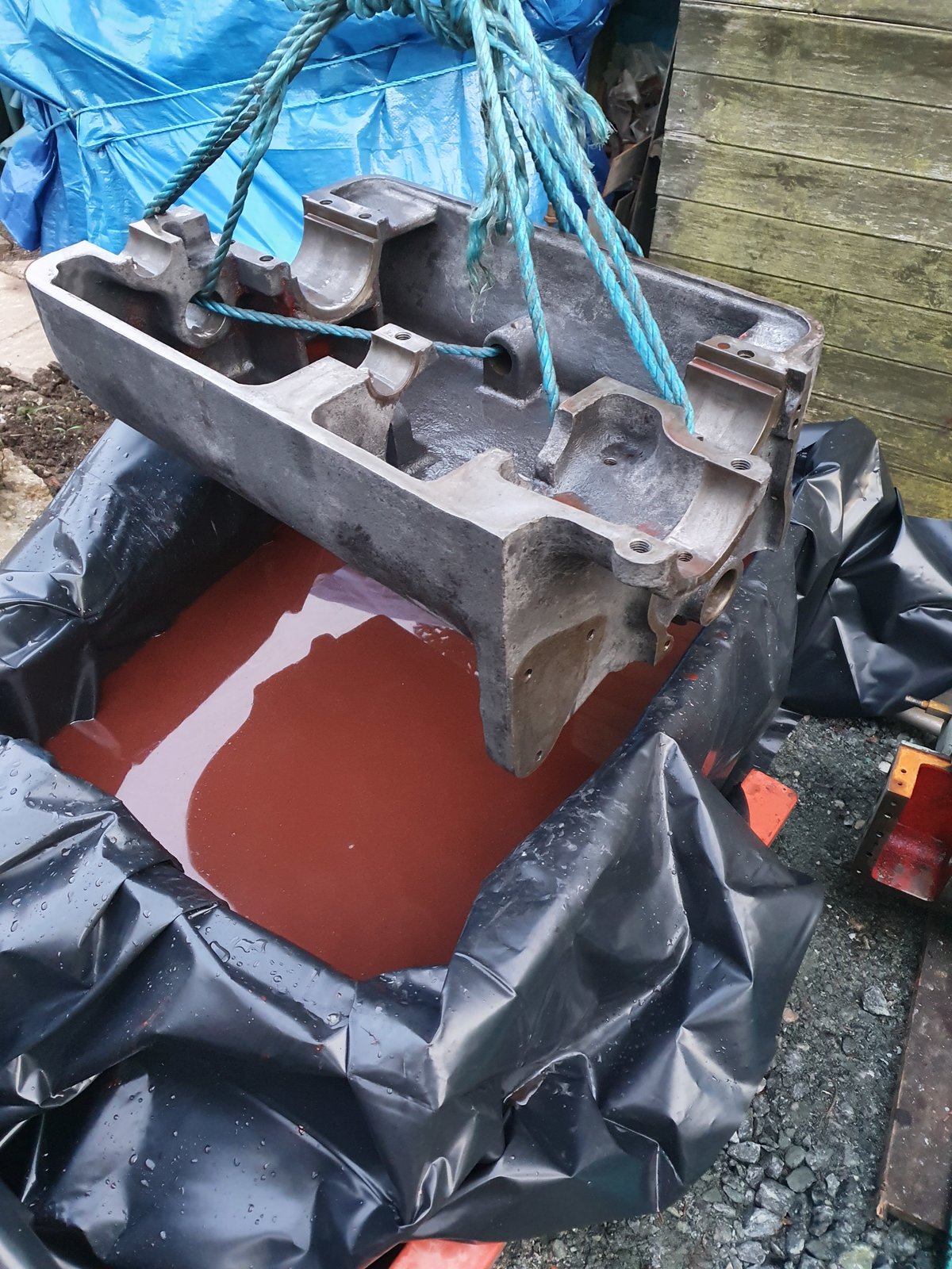

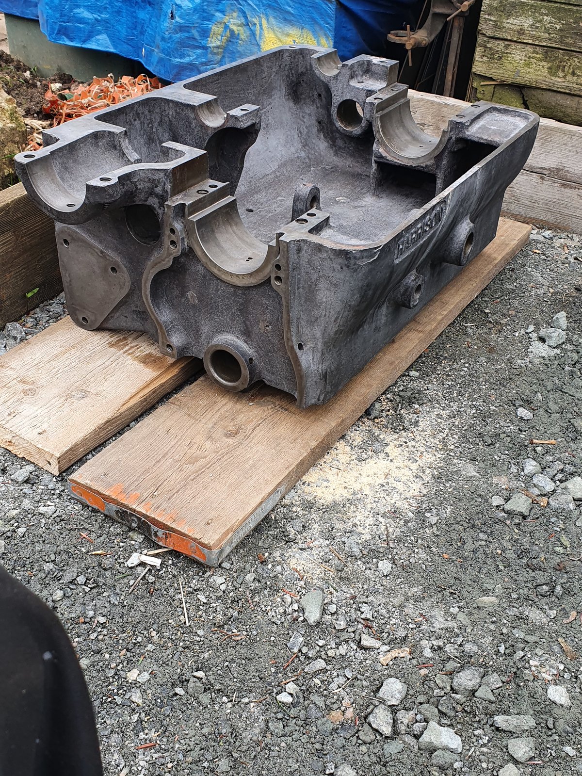

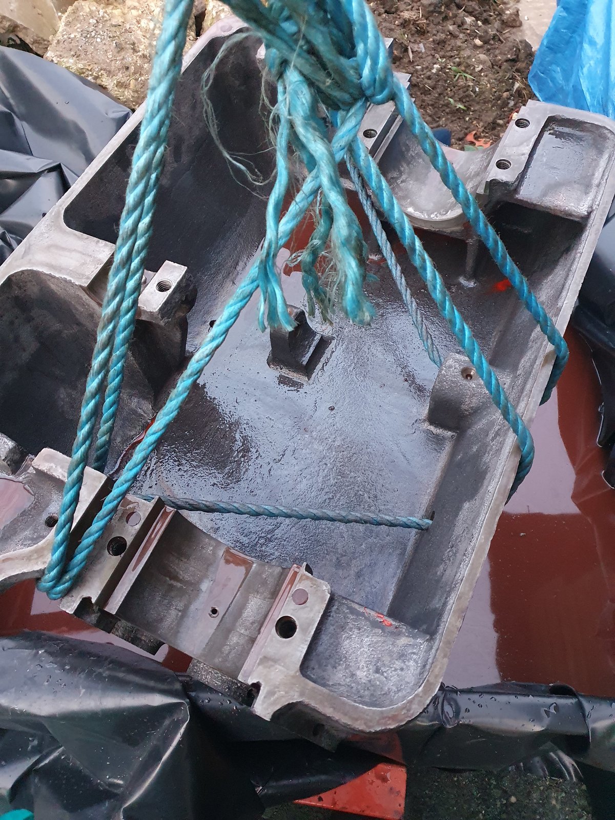

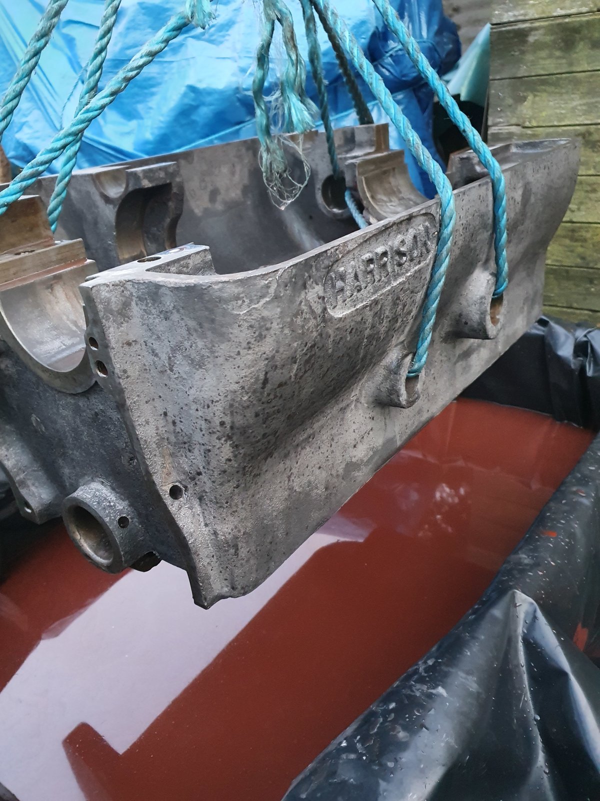

My supply came today. At least 4 months worthYou're going to need more caustic soda![]()

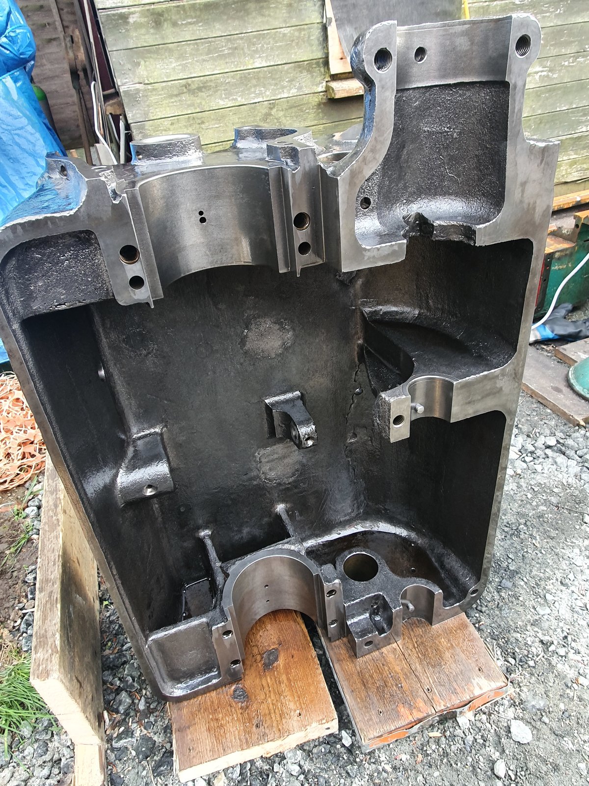

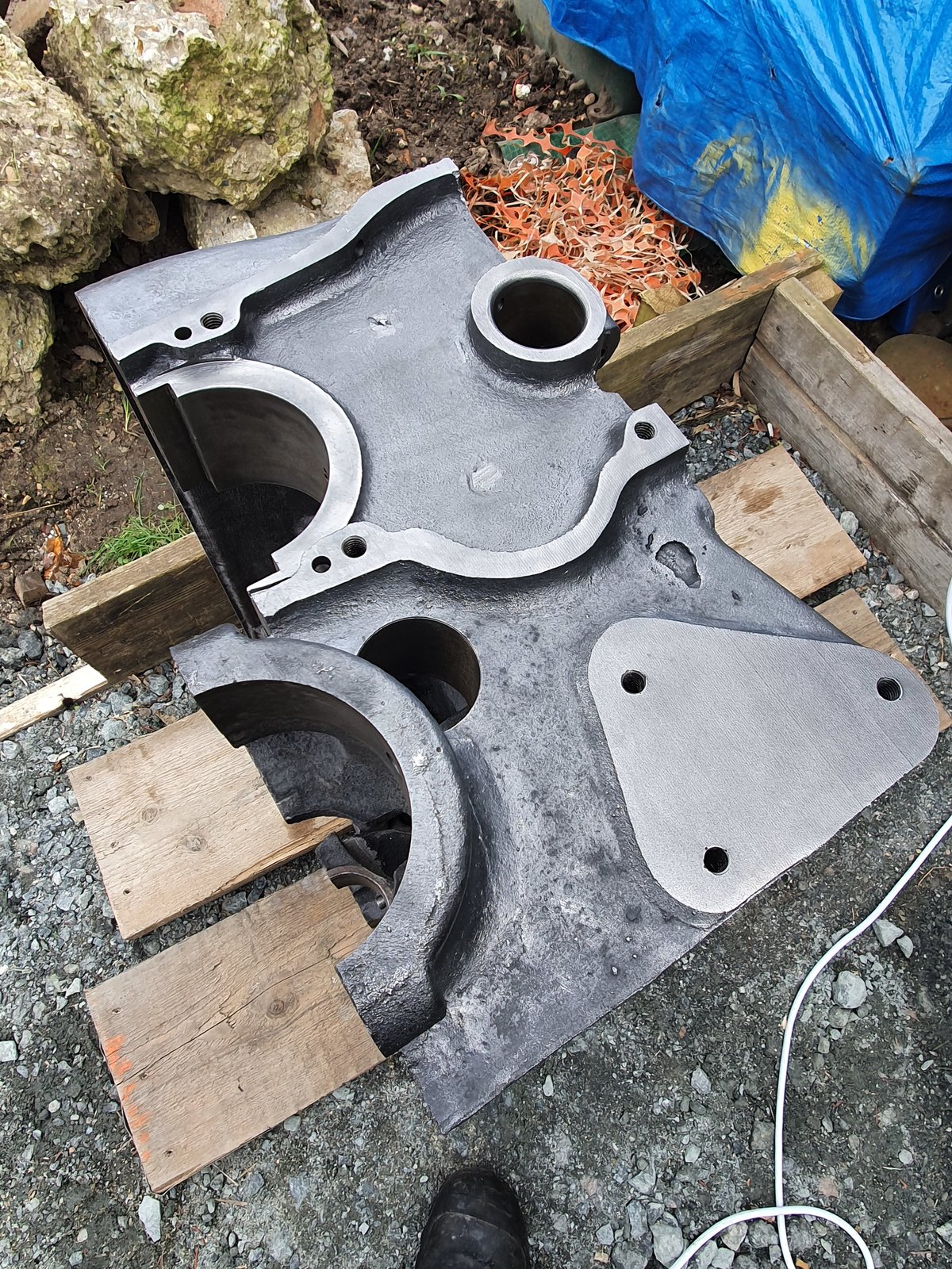

Indeed. Only downside is the weight....Opening up a big old casting full of quality shafts gears and bearings, and finding everything in good order, is one of the great pleasures in life.
Keep it coming we need our fix!

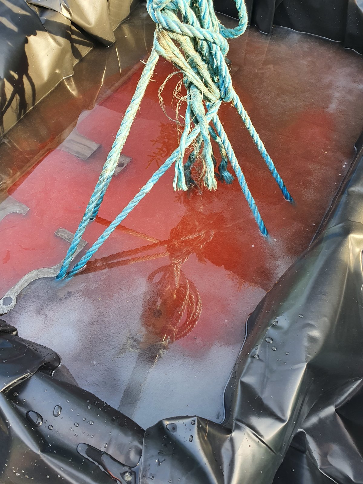

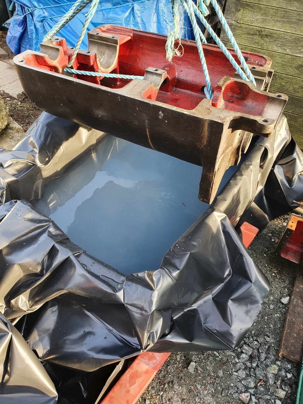

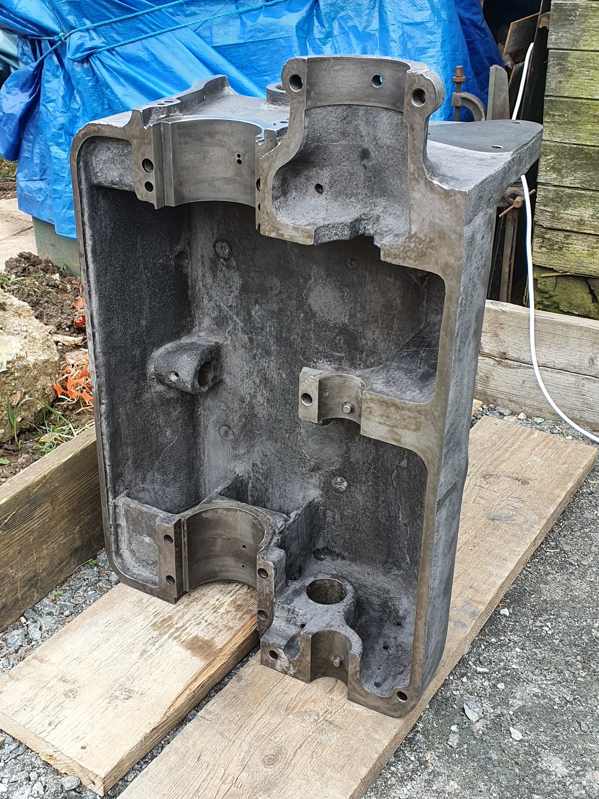

Caustic yes. In and out was the easy bit...shaking it about was the difficult bit...getting it in the workshop on the bench will be a total missionCaustic soda bath.
In, out, did you shake it all about?
Sorry, I'll sit at the back and be quiet.
