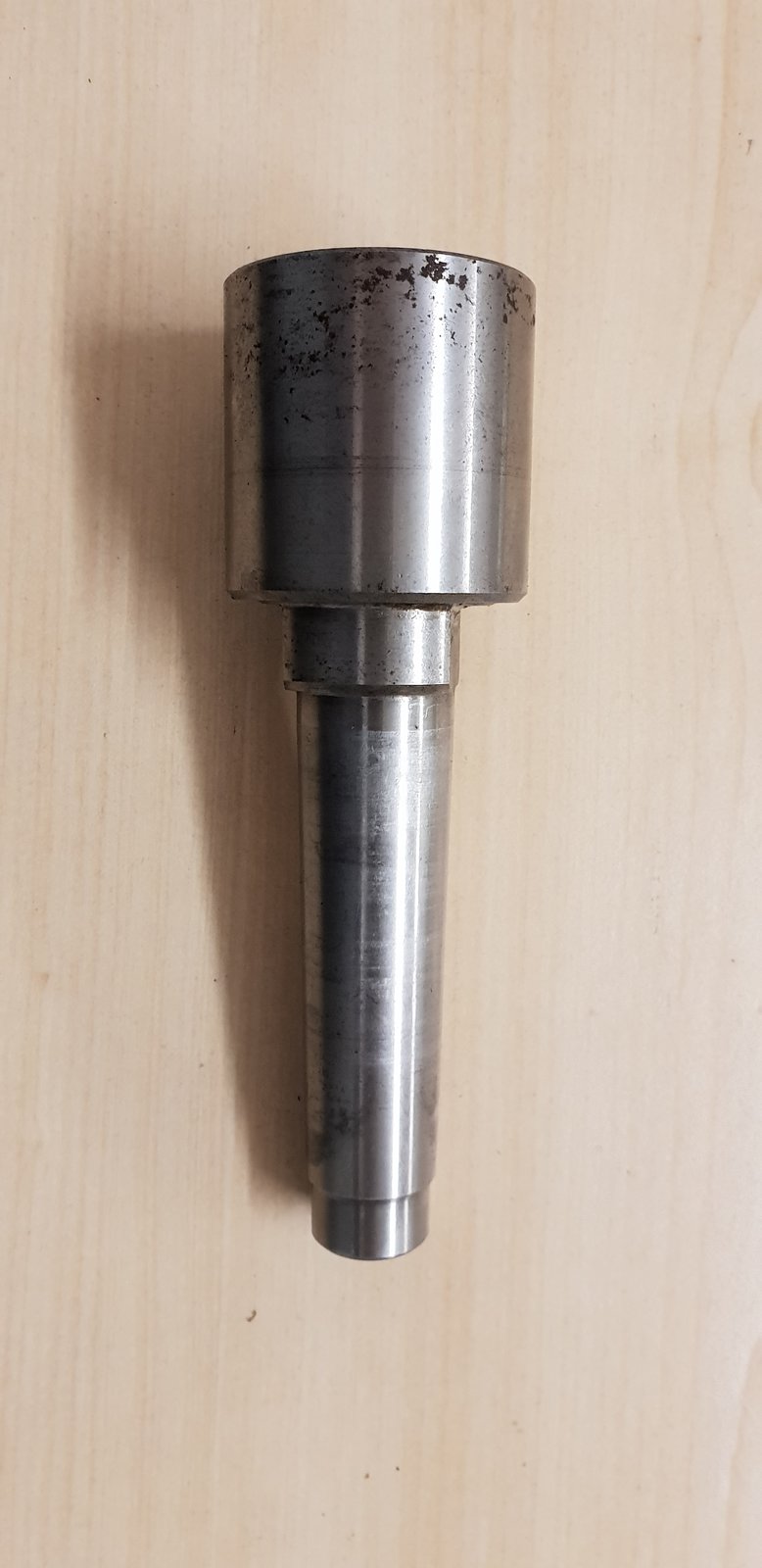

    Make 2 x longer wedges to get clear of the casting.

    That would have been the best solution but they are not coming out - very firmly wedged - literally!
    Going to try the Record after work.

    Fingers crossed for you with this one!
    Have you got a towel under the chuck so if and when it pops out it won't damage anything ?

    Cheers. No but drawbar in place slackened off so won't drop far.

    Took some force but well within the vice's capability.
    Just a little pop and off it came - damn thing!
    Thanks to everyone for their suggestions and especially Dave for the idea of these taper wedges. Why they sell them for Jacobs chucks and not More taper is beyond me.

    Glad it worked, I think they assume that Morse tapers are in a quill with a slot for a taper drift... ain't necessarily so!
