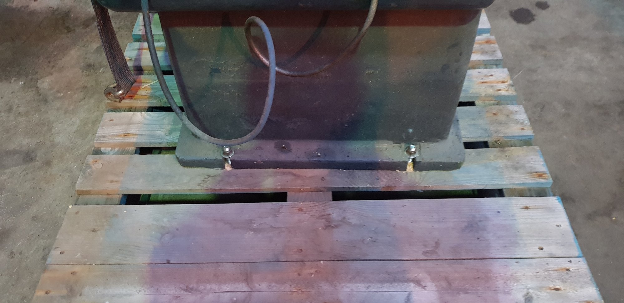

what Town woodhouse mill do you have? Any pics?I am so happy with my milling machine. In perfect condition. Hardly used. Ok it is only a basic one but it will do until I get my Elliot Sturdimill and Town woodhouse up and running.
Same one as on lathes uk. The 369 but they have numbers wrong way around and call it the 396!what Town woodhouse mill do you have? Any pics?
