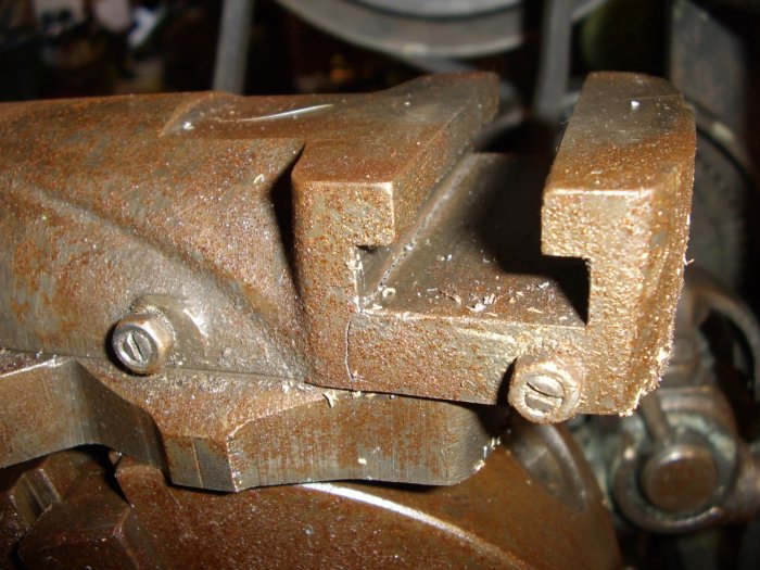

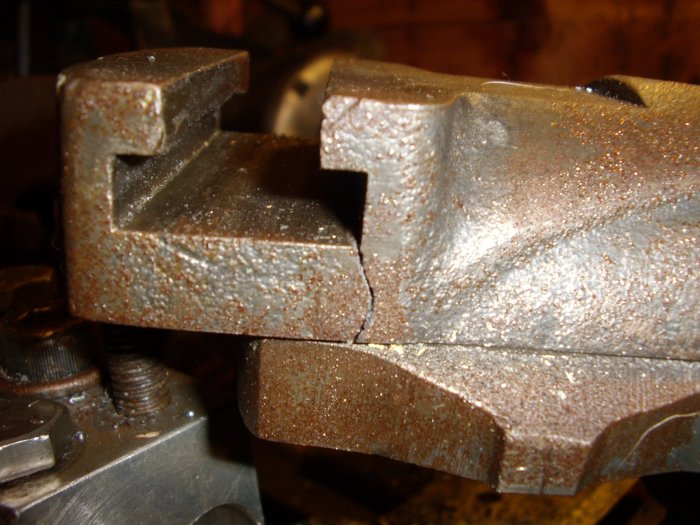

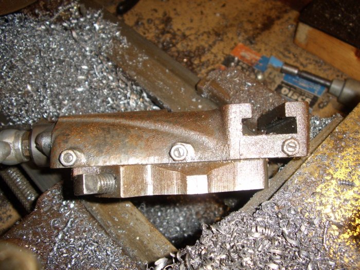

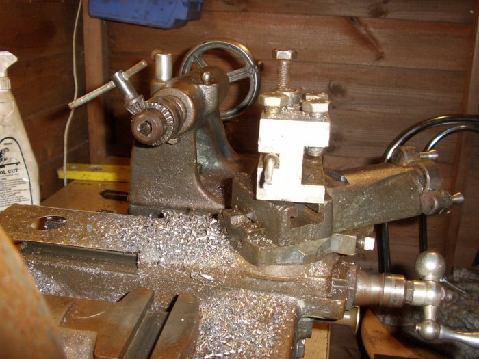

anyhow your thoughts please?Did the bolt on the T-nut bottom out against the bottom of the slot? That will break it as you have.

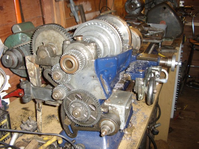

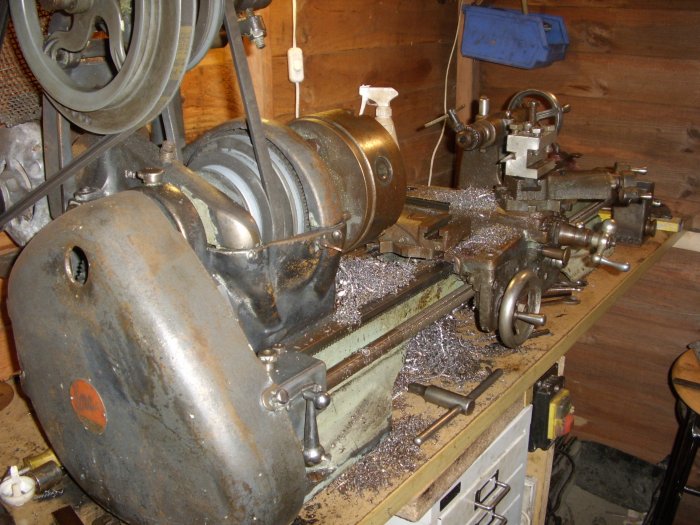

You paid quite a lot for that machine
but the saving grace is the two Pratt Burnerd chucks which are good quality
