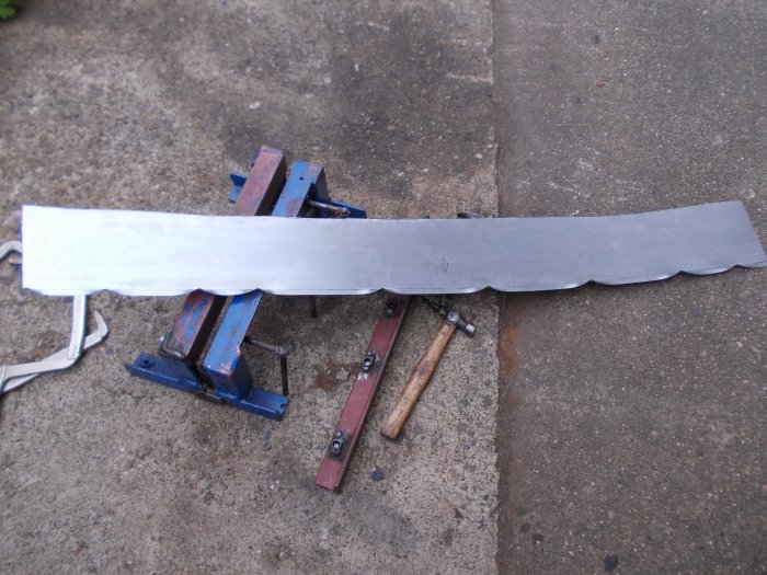

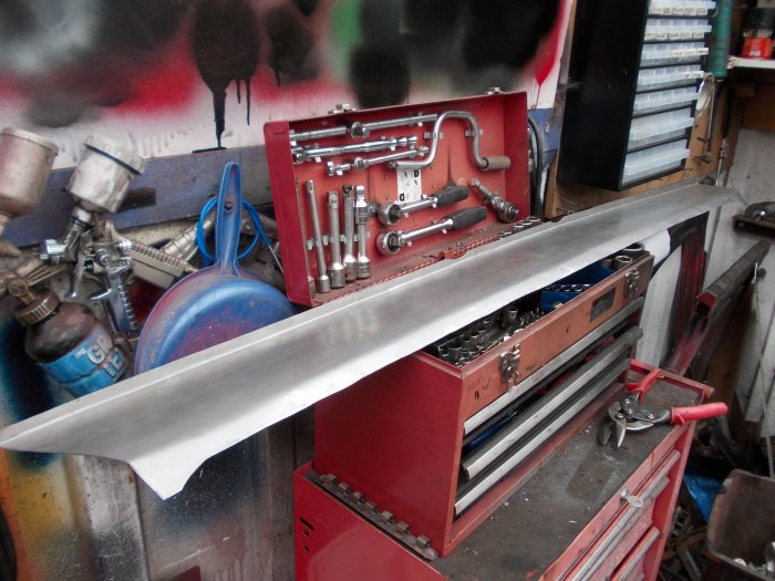

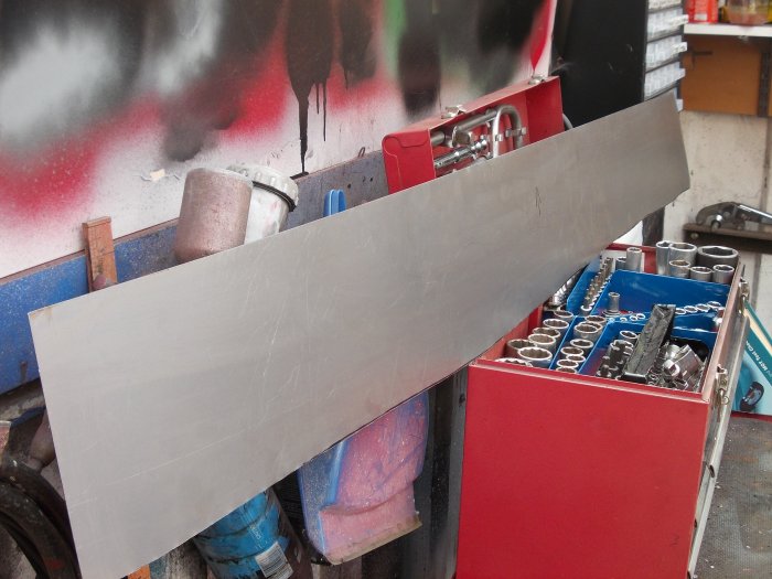

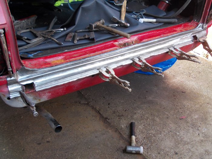

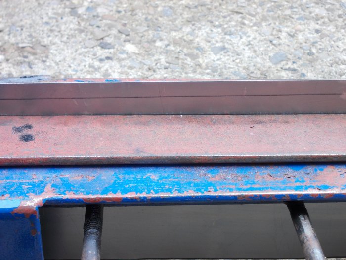

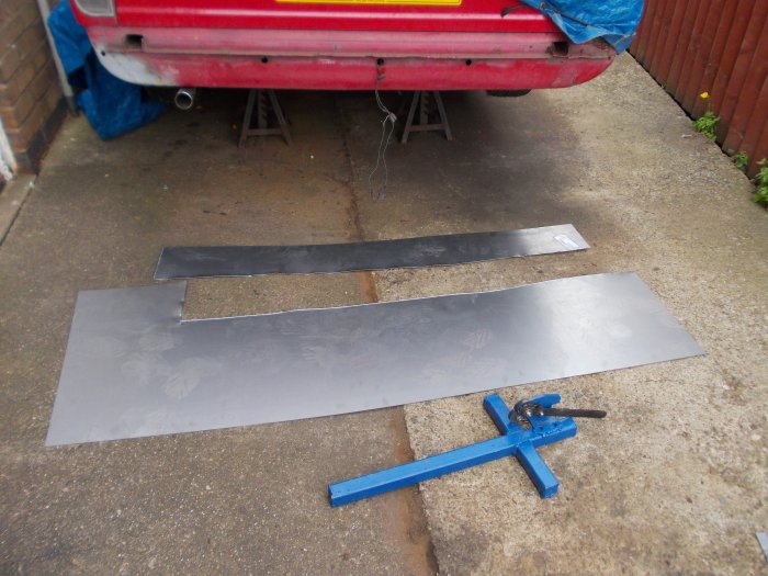

what a bitch! folder not deep enough

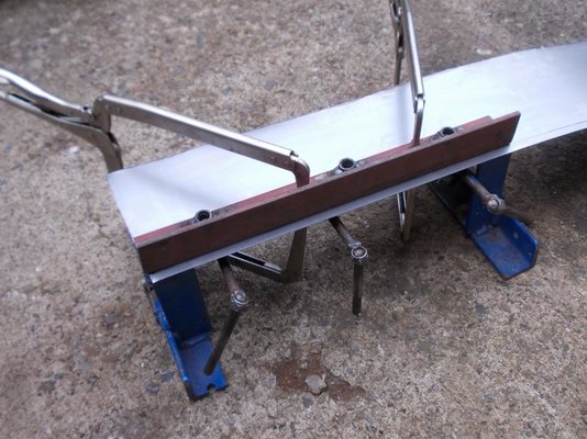

have to do it this way

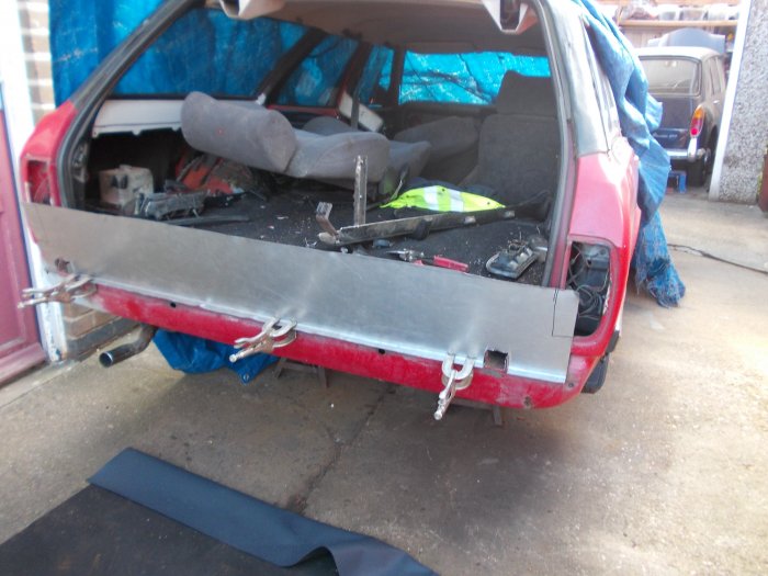

clamed up for hammering in some "kinks" to rest the angle against

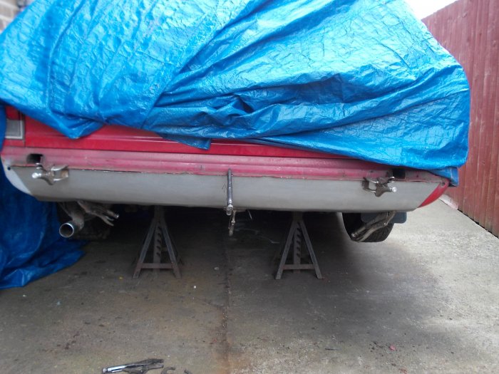

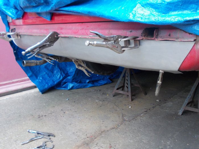

then clamped up and knocked over with a flipper
and test fit

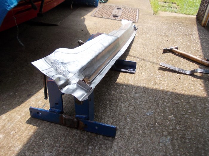

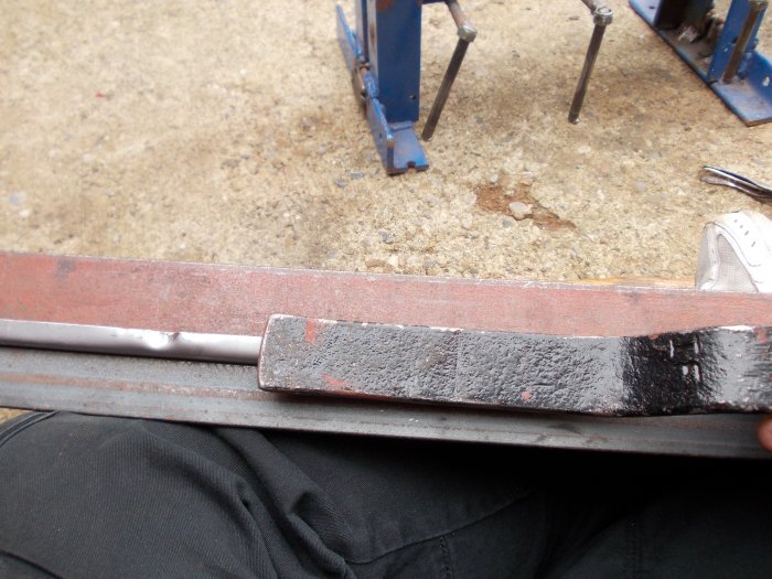

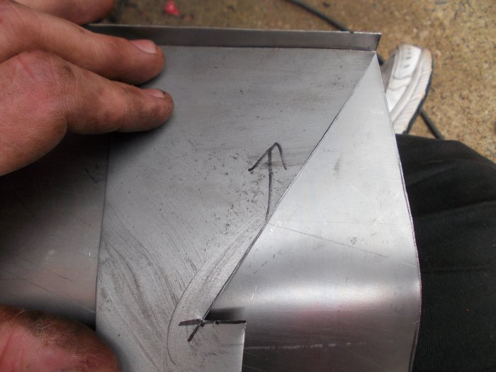

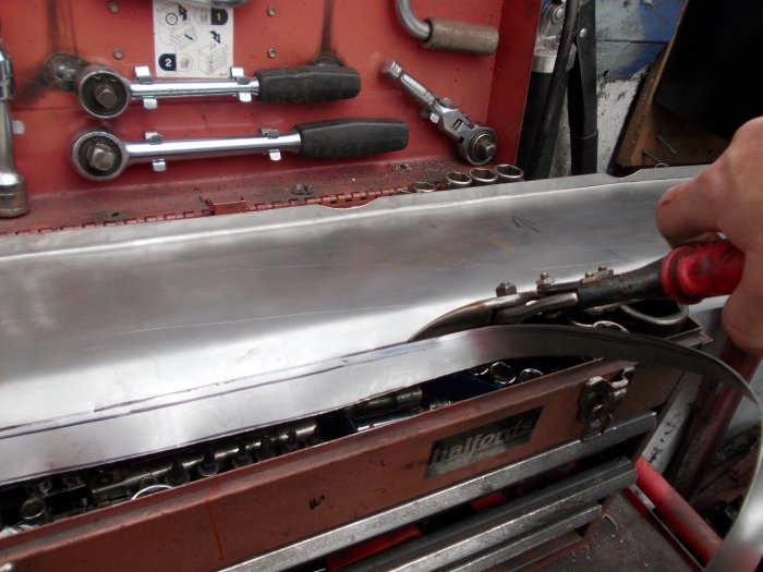

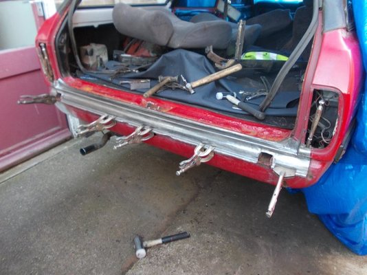

bent by hand then started tapping lower edge into shape
made a template for shaping the ends as original
like so!
and that'll do for today still needs more work on the lower edge and holes drilling for wiring but that can wait for another day

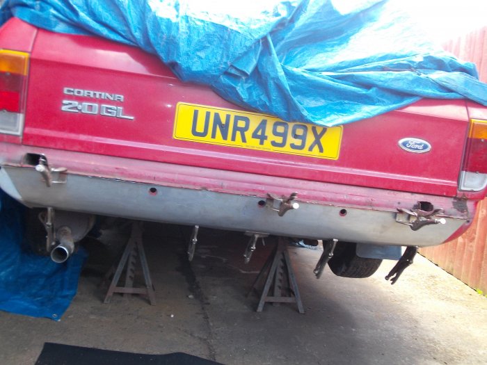

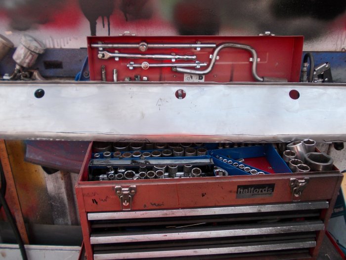

good design aint it? although the next one i build will be longer and a bit deeper

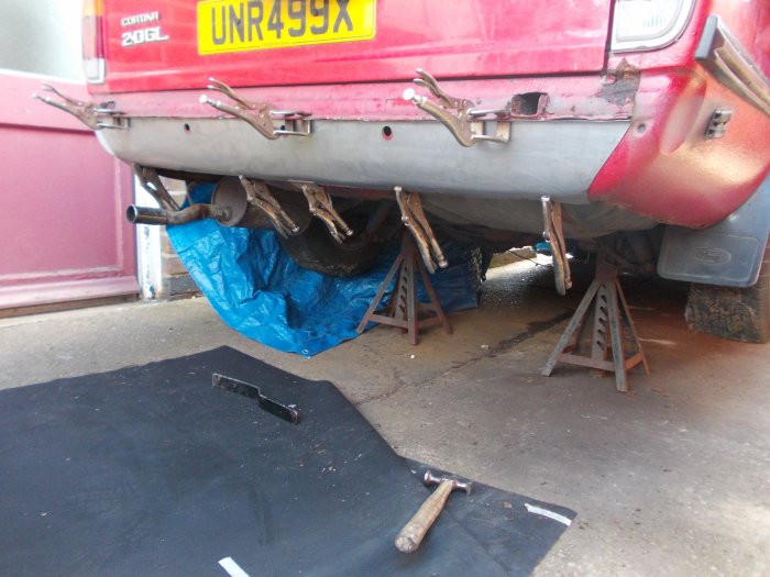

looks a bit more even

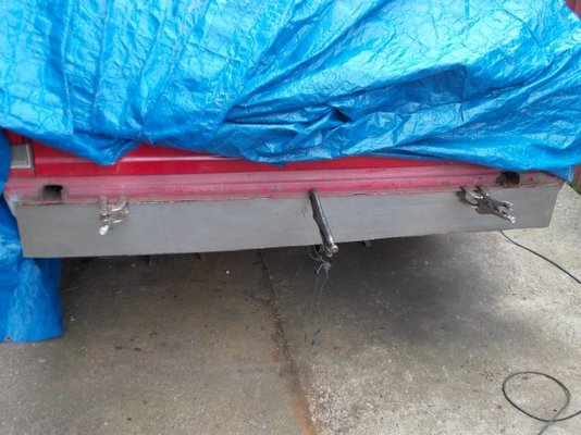

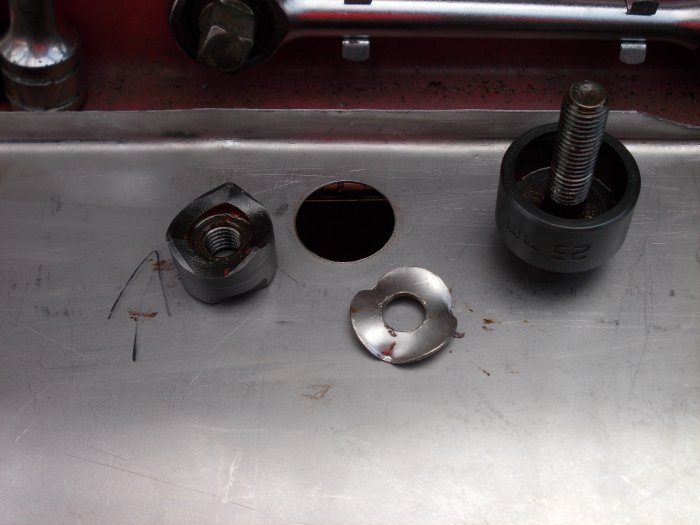

and got the holes cut for the wiring
clamped up and a bit of minor tweaking done

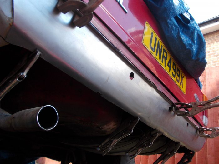

now concerned that the neighbours might think they'd gone deaf and supposing that the panel above the valance might be worse than it looks......

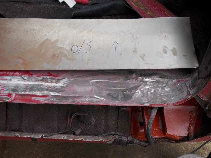

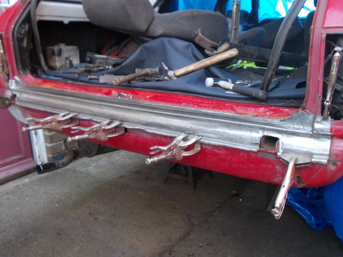

i thought i'd have a go at making one of these as well! if i dont need it i'll put it in the loft 'til i do!

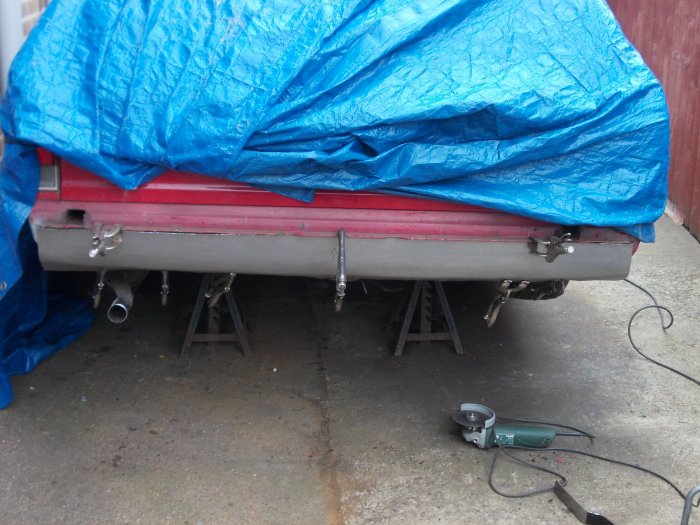

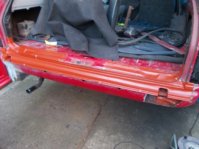

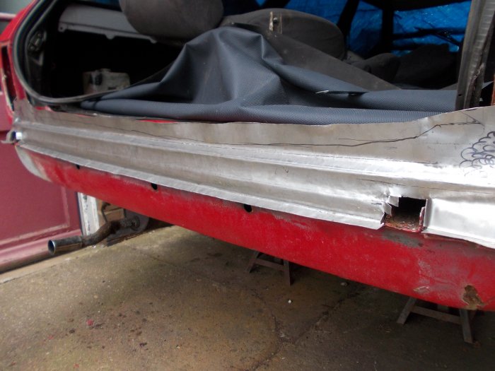

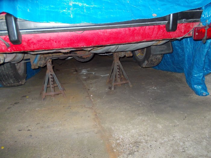

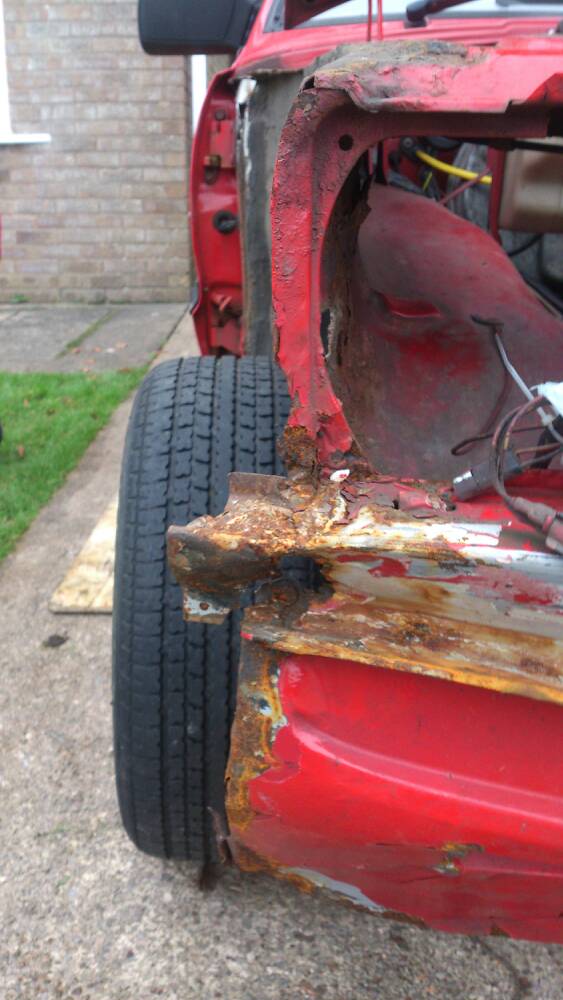

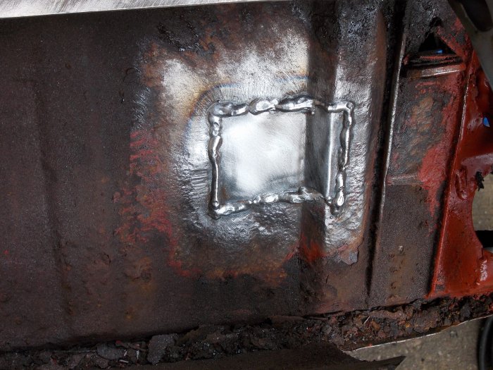

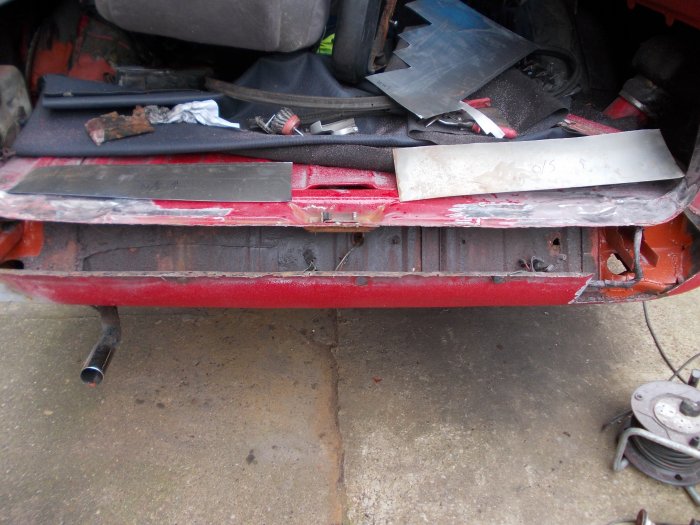

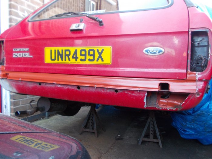

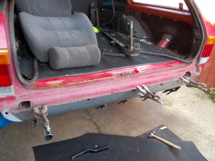

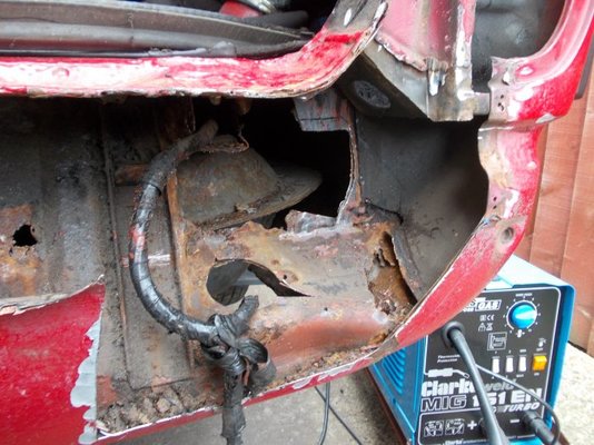

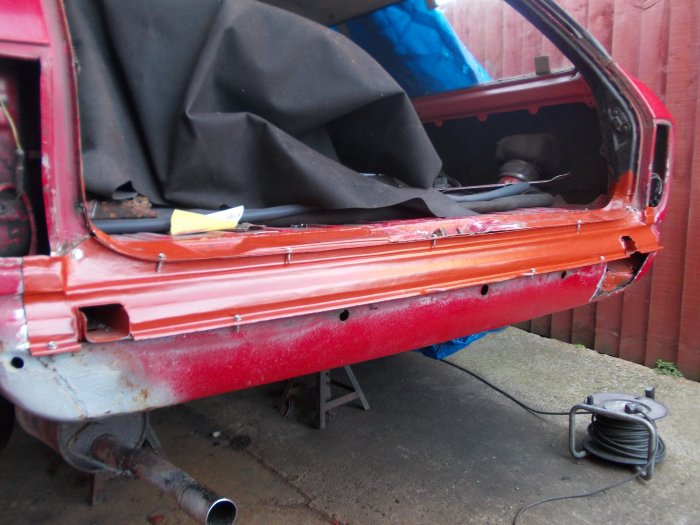

so back onto the car ,got the upper valance removed and as suspected it was quite heavily rusted on the inside and had taken most of the bumper mounts with it!

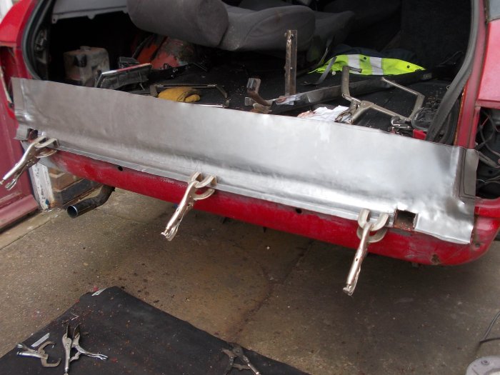

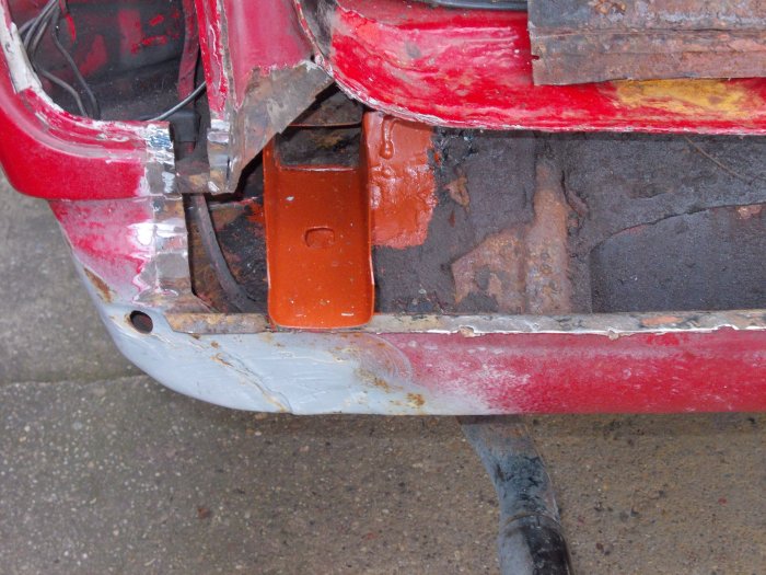

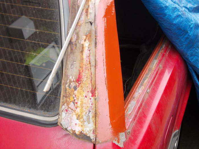

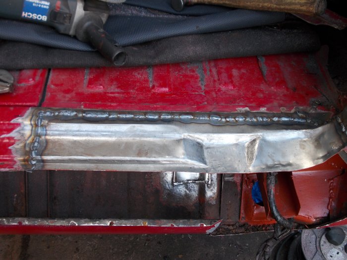

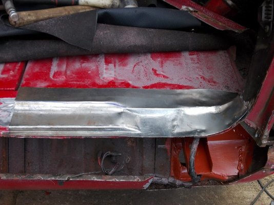

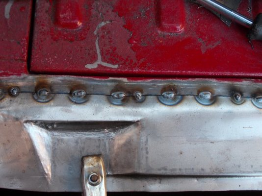

[/ATTACH] just needed to make repair sections for the boot slam panel.

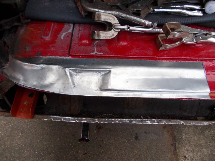

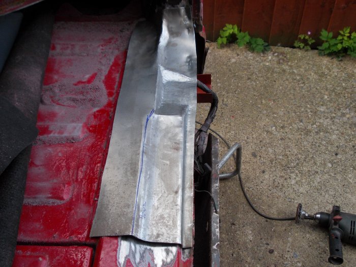

so tap tap tap...
[/ATTACH]
will need some tweaking but hoping to get them welded in this week sometime
great progress on this one!.....
looks like you have worked your way around the whole car?...whats left?

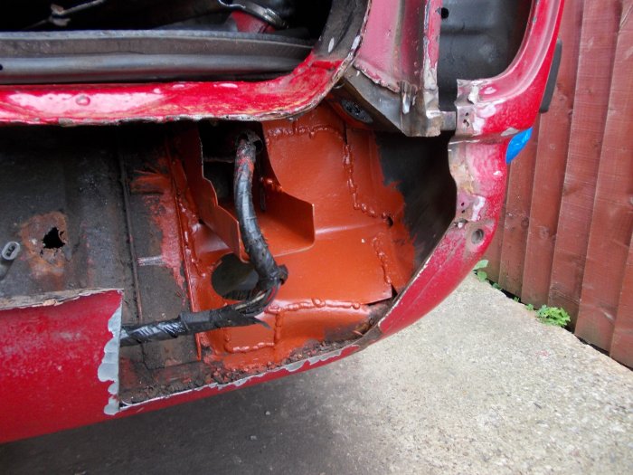

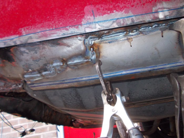

i need to get these parts welded in then it's a little work on the doors nothing major, check in case i've missed anything then prep for the respray

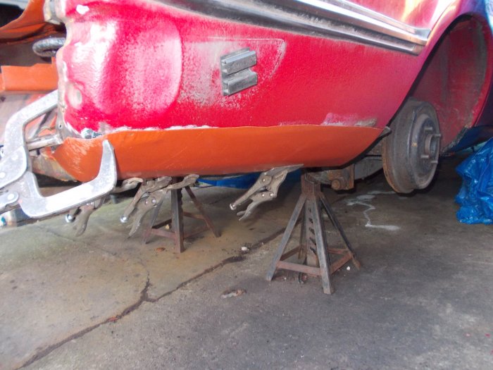

and passenger side

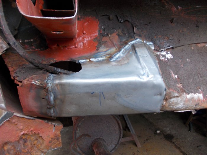

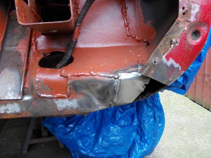

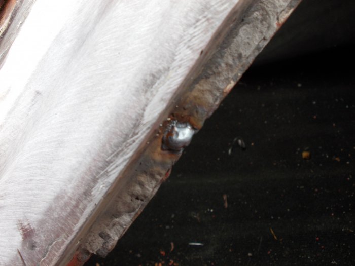

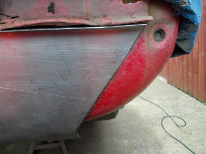

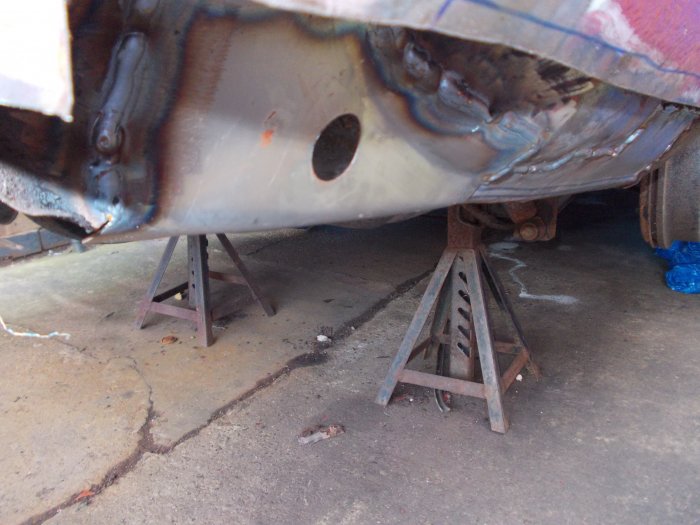

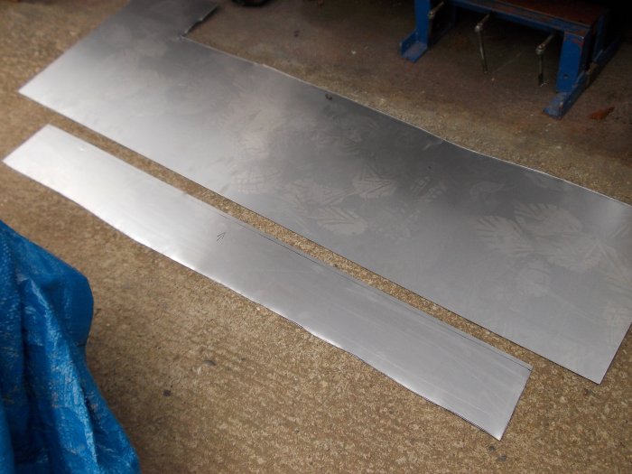

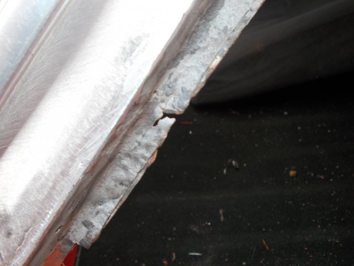

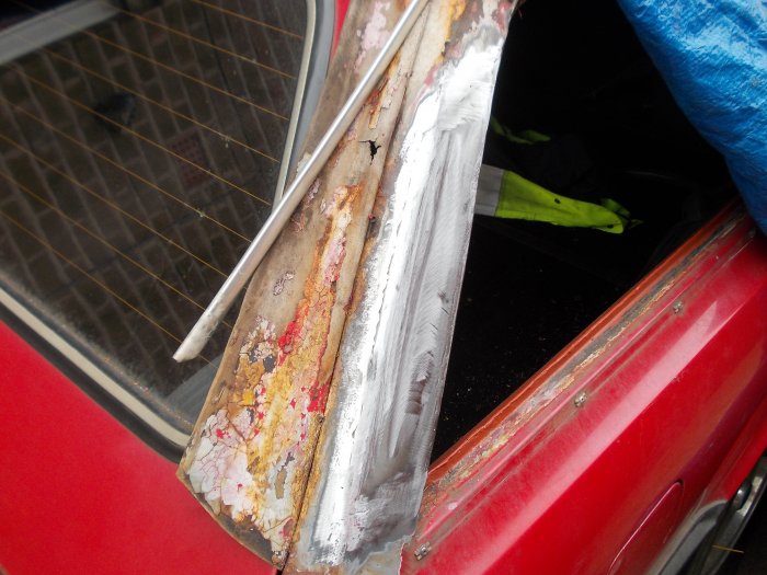

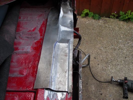

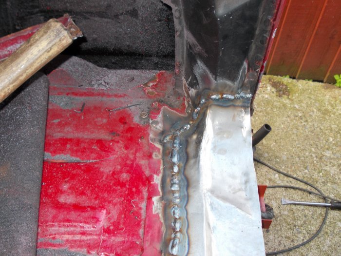

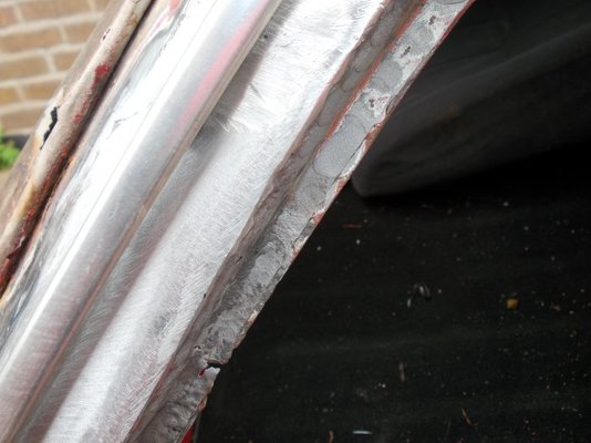

just need to make a piece about five feet long to join the two! so in the mean time i got on with the drivers lower rear wing which needs to be done before the the valances go on as they go over it if you see what i mean, so onto the inner repair good job i REALLY like welding upside down

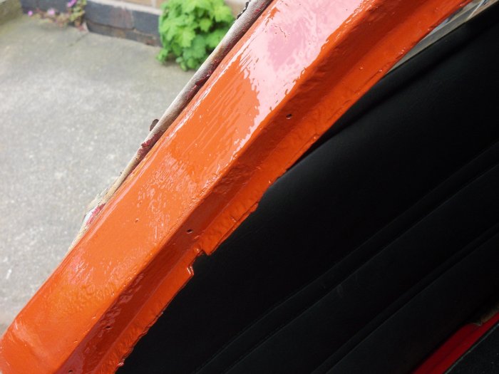

then today the second half going in
just needs painting inside then i can fit fit the outer repair panel i made seen here being test fitted
