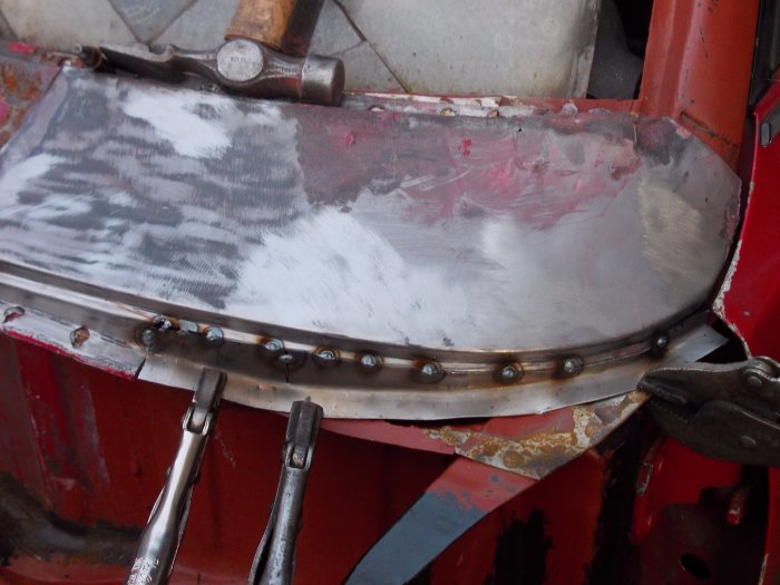

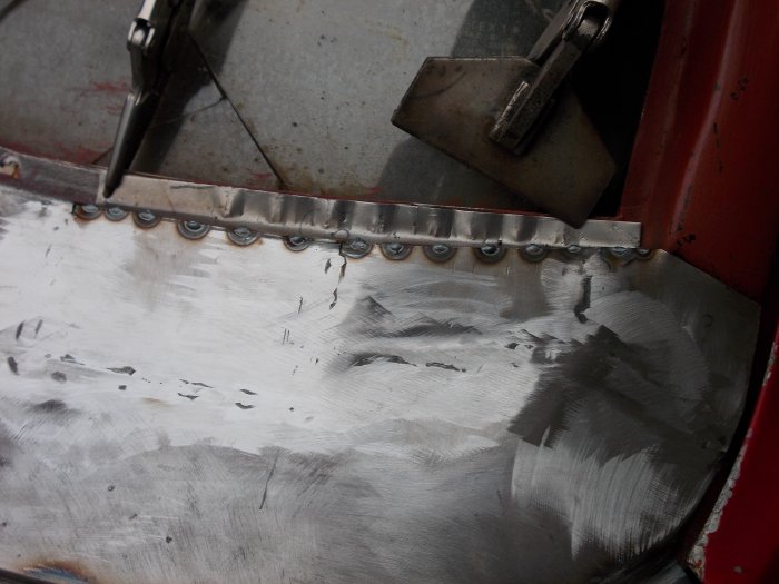

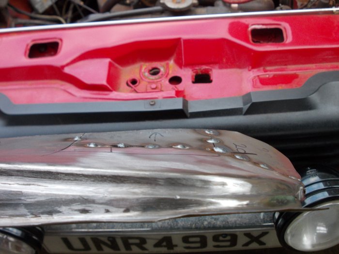

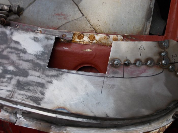

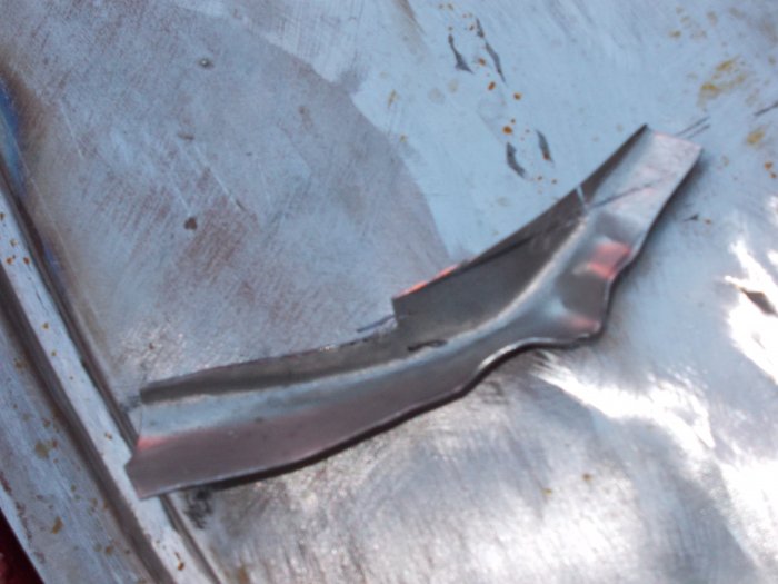

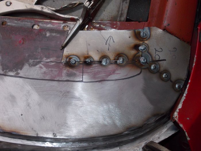

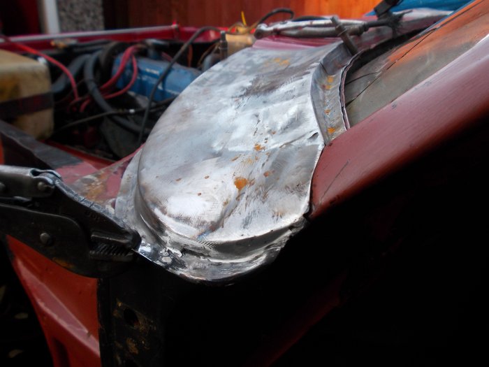

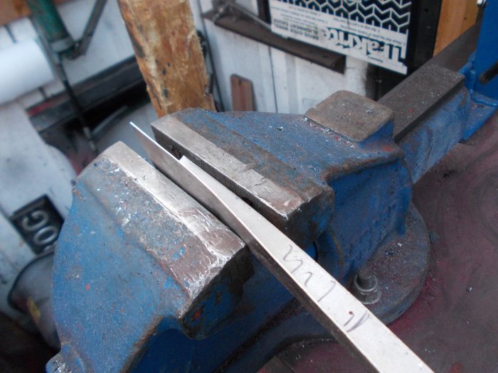

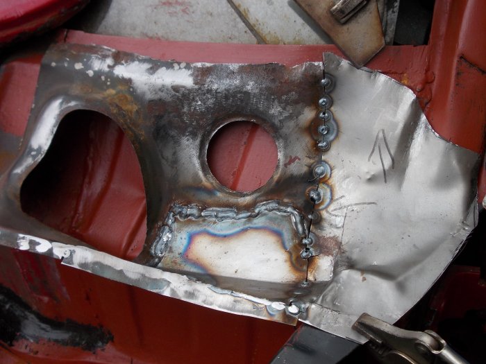

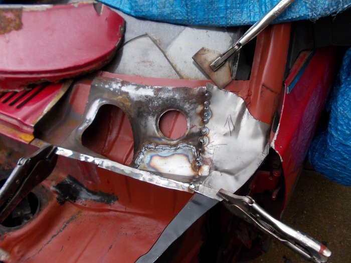

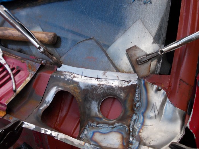

folded a repair piece and started pulling it in the vice to get it to curve

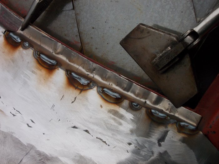

couple more rounds of gradually pulling it round and it's about there just needs the top edge trimming and welding in

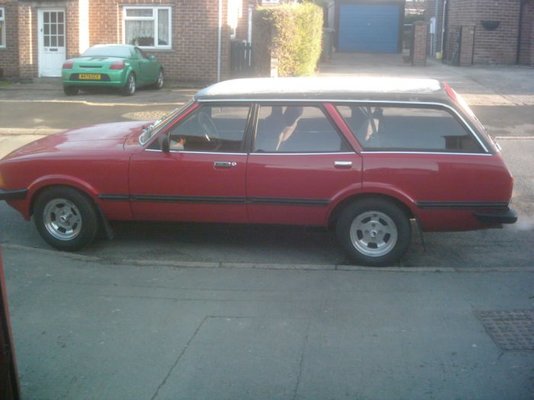

PS can you show an overall pic of how it looks now?

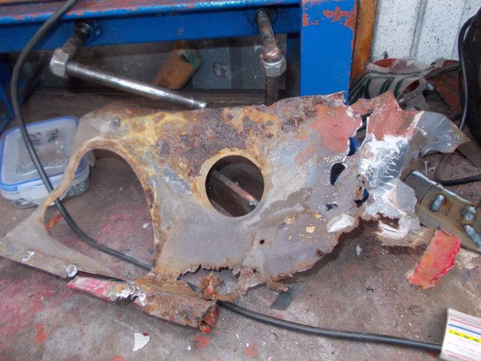

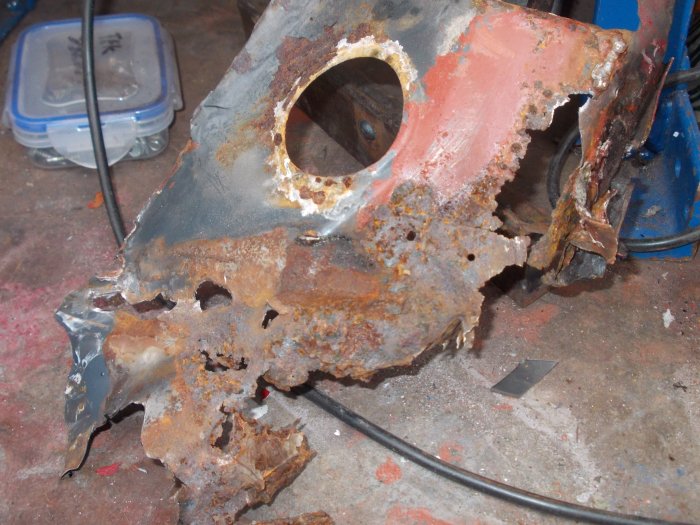

but these pics were taken a few years ago and should give you a rough idea of what i'm aiming for

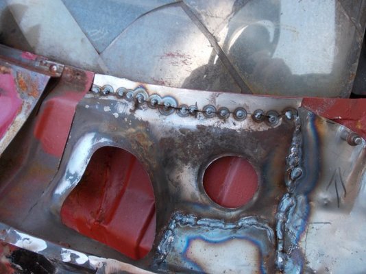

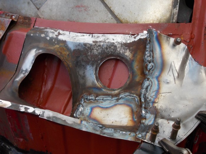

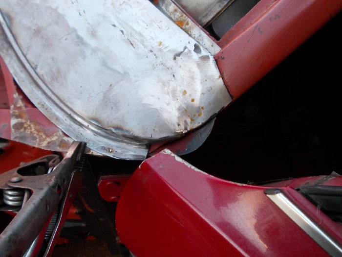

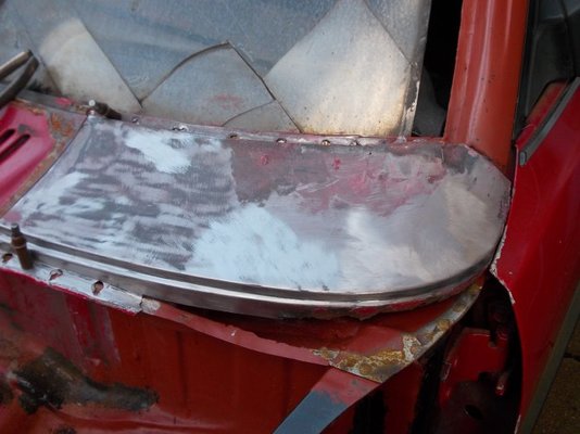

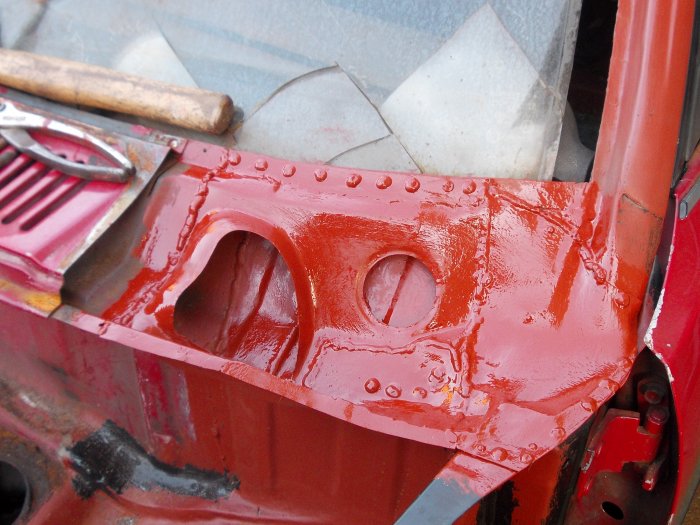

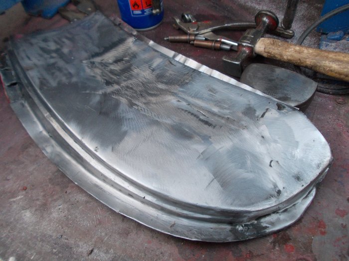

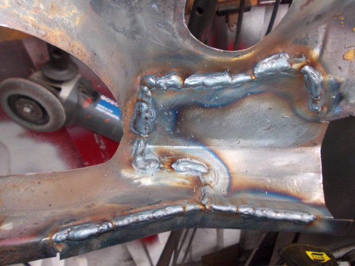

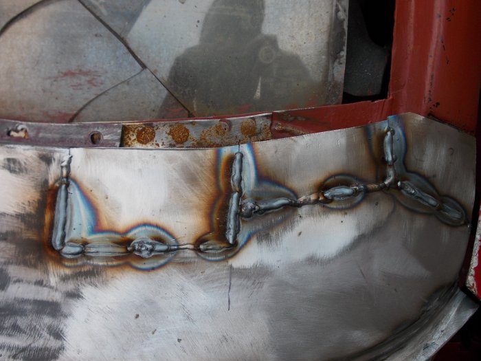

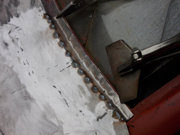

so made this piece

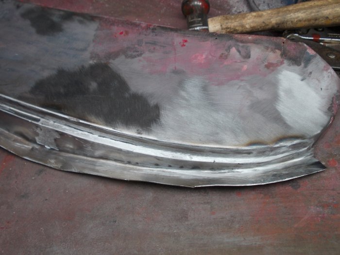

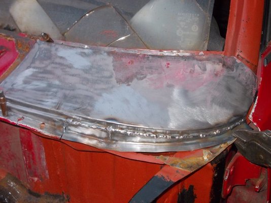

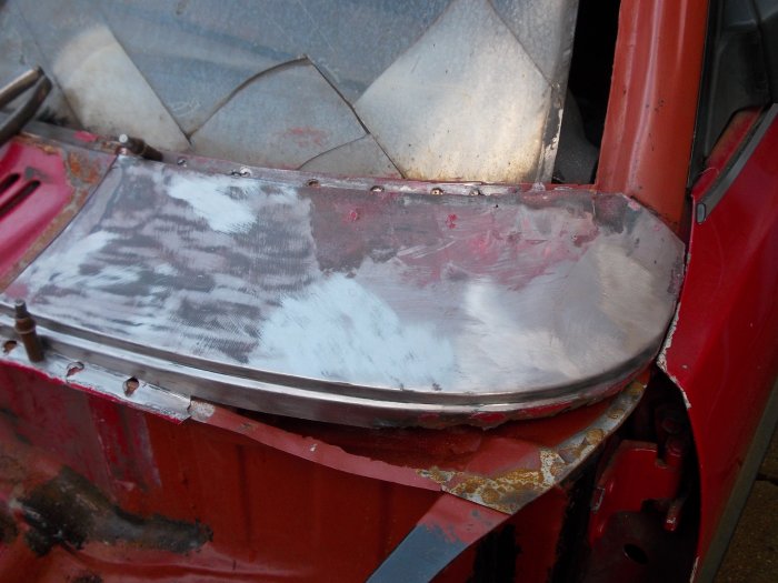

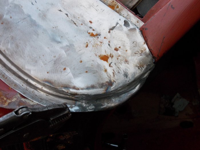

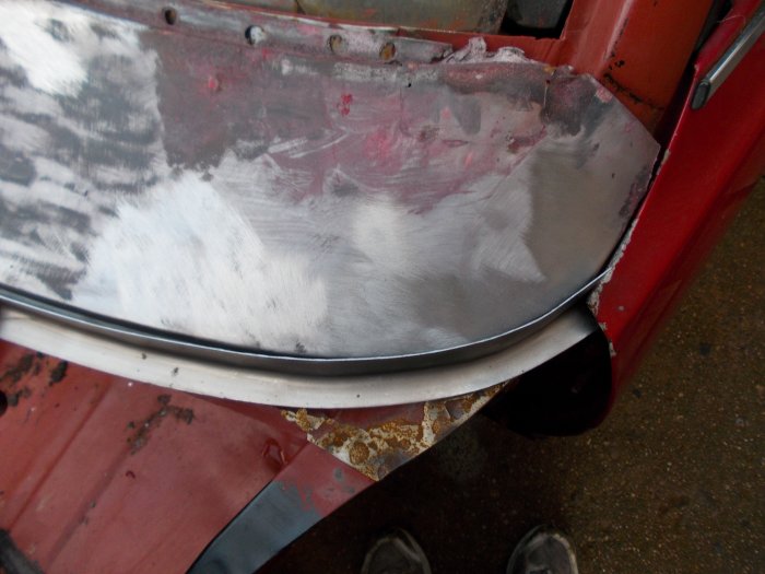

after welding i sanded the welds

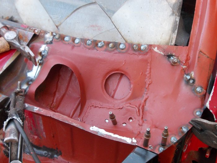

side view just needs some filler at paint stage, and wiped over with jenolite to remove the surface rust. just need to weld it back on now
