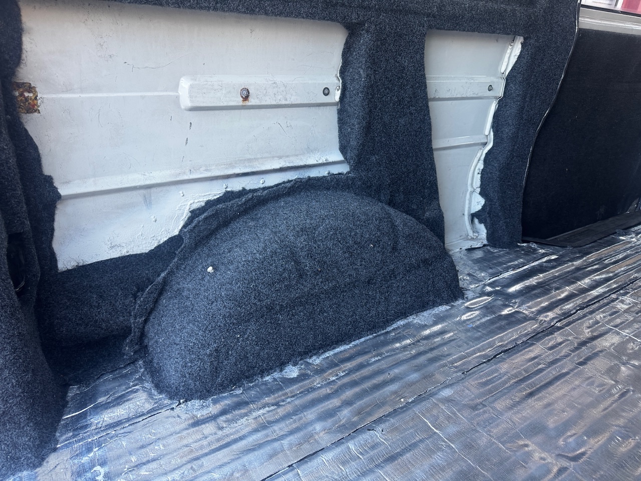

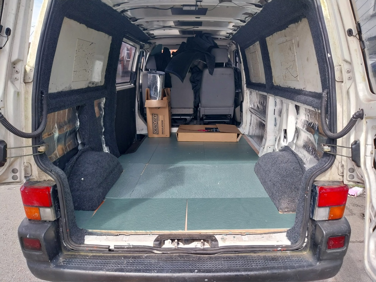

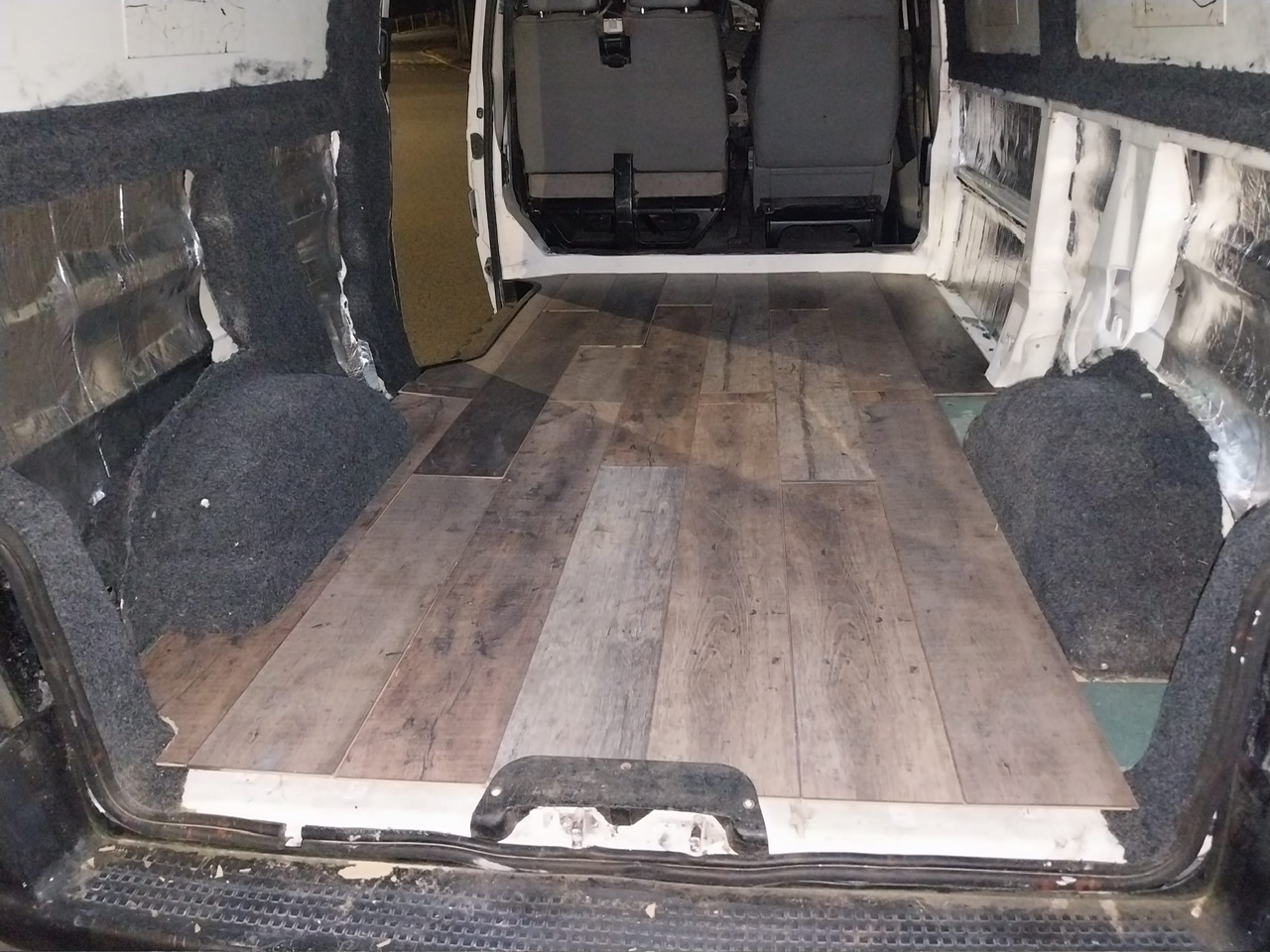

I hope he used high temp spray glue!Today’s work. He’s getting on with it.
its supprising how easy that stuff is to work with it streches molds quite easy and looks impessive like a proper made panelsToday’s work. He’s getting on with it.
He did indeed. Trimfix supplied with the carpet is high temp. It was bought for my T5 but this has taken priority as mine won’t be ready for a bit. I just want to see him on the road with the bit between his teeth. That’s a good motivator.I hope he used high temp spray glue!

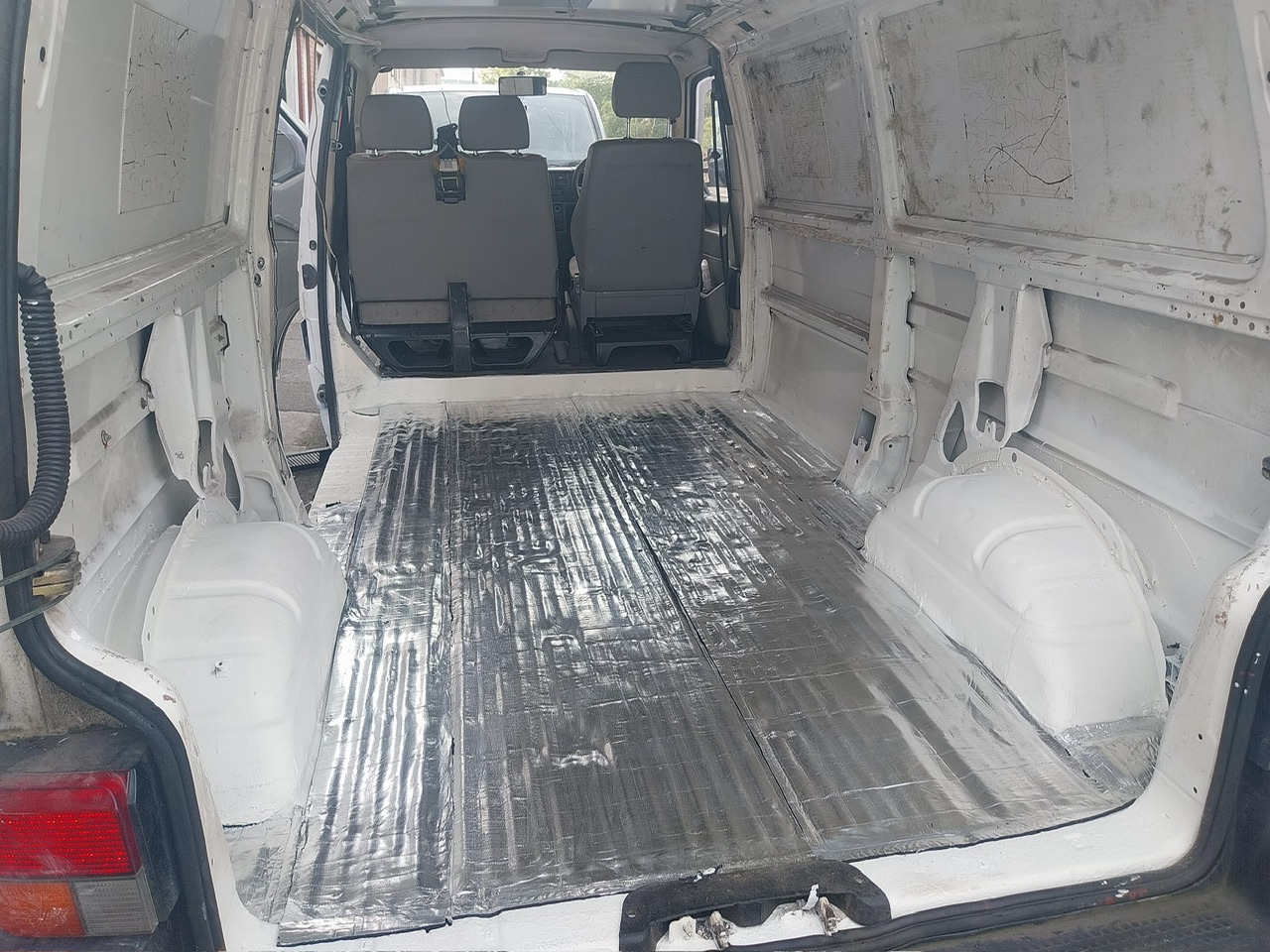

Also advise adding extra butyl pads on all panels to stop vibrations and the noise when it rains heavy.
