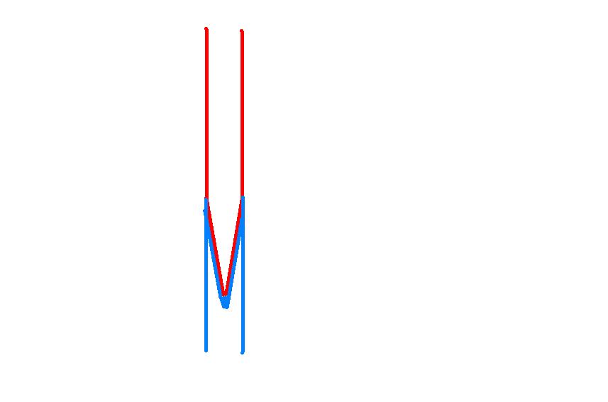

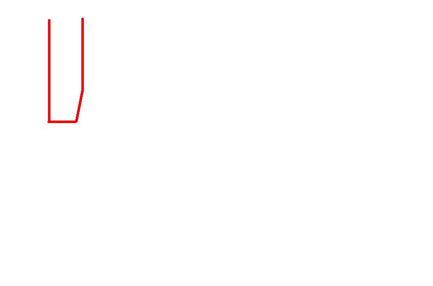

not wanting to upset you but on the holes you should have feathered the edges right back so that the new fibreglass built up the thickness again which also gives a lot more area for the repair to adhear to
the 2 in the bow like my bad drawing View attachment 92652
it just looked like a sort of but joint for want of a better description from the front which upon any impact i could see pushing through which would be a disaster, the front should have been feathered aswellI did, a good 2 inch, not he 20 times the thickness folk suggest but enough. The bow point is 8-12mm thick. the repair is around 10mm thick along the taper..
My thought as well, it would punch the repair straight out, or in, in this case.
