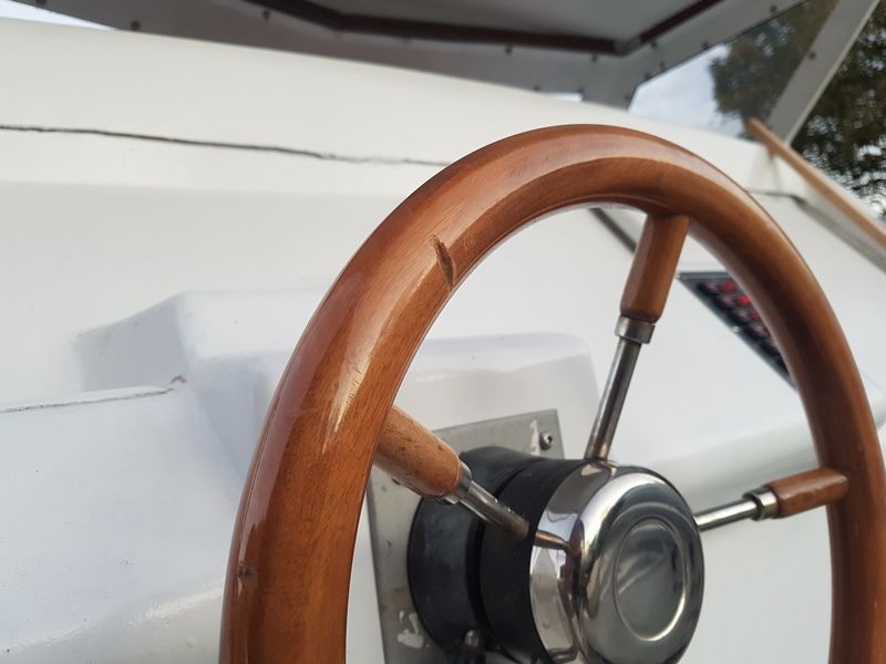

Oh yes, a few things i got arrived the other day aswell. Love the helm wheel and the horns are full SS, most are plastic and SS and as i am picky i got these second hand for a good price.

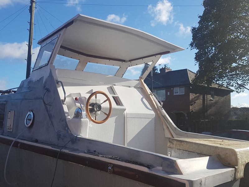

Thats about it for now. Think i will have a go and see how the helm wheel fits this week, ah its dark after work, mite have to fettle a light on the deck now lol.
