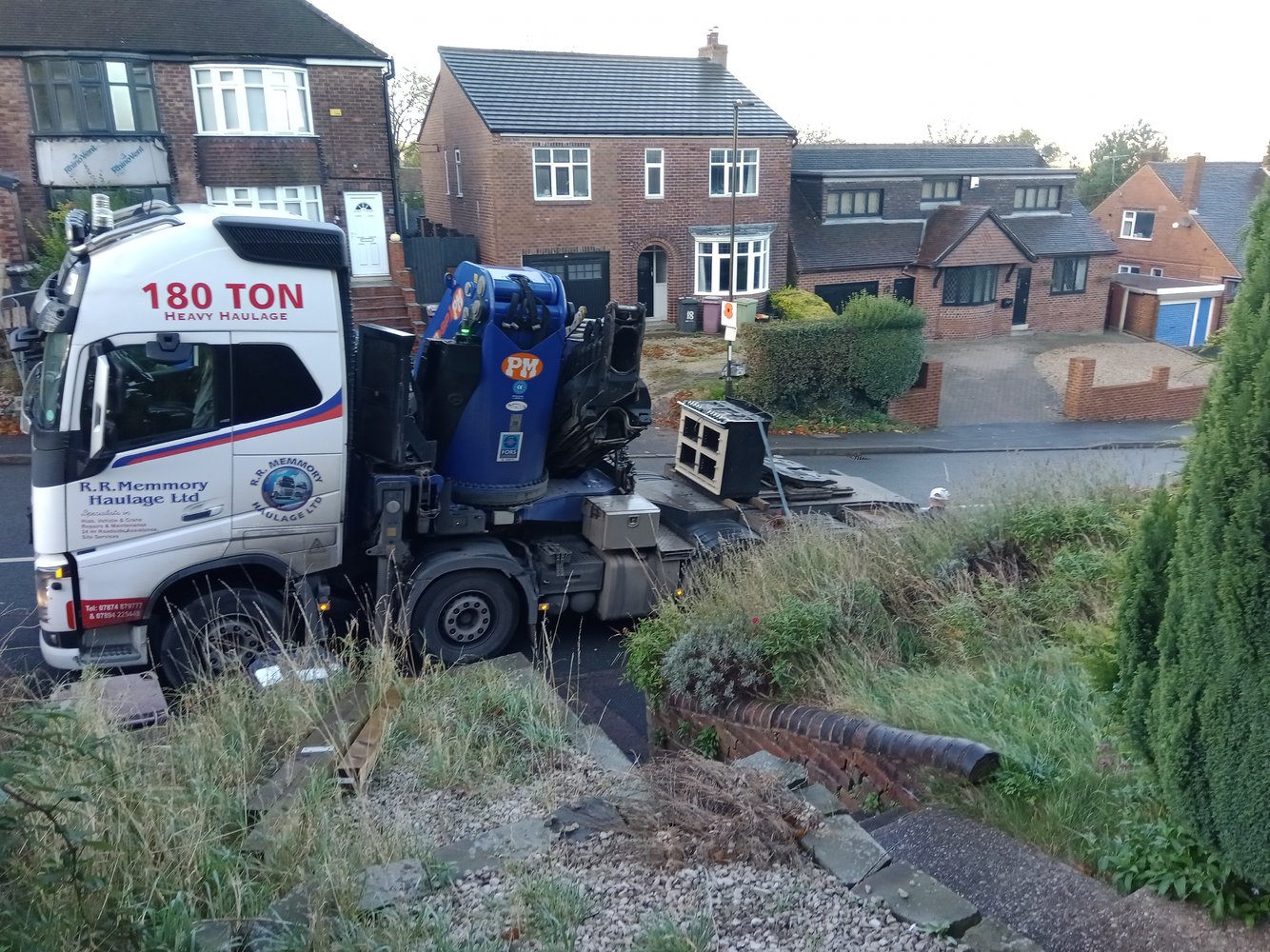

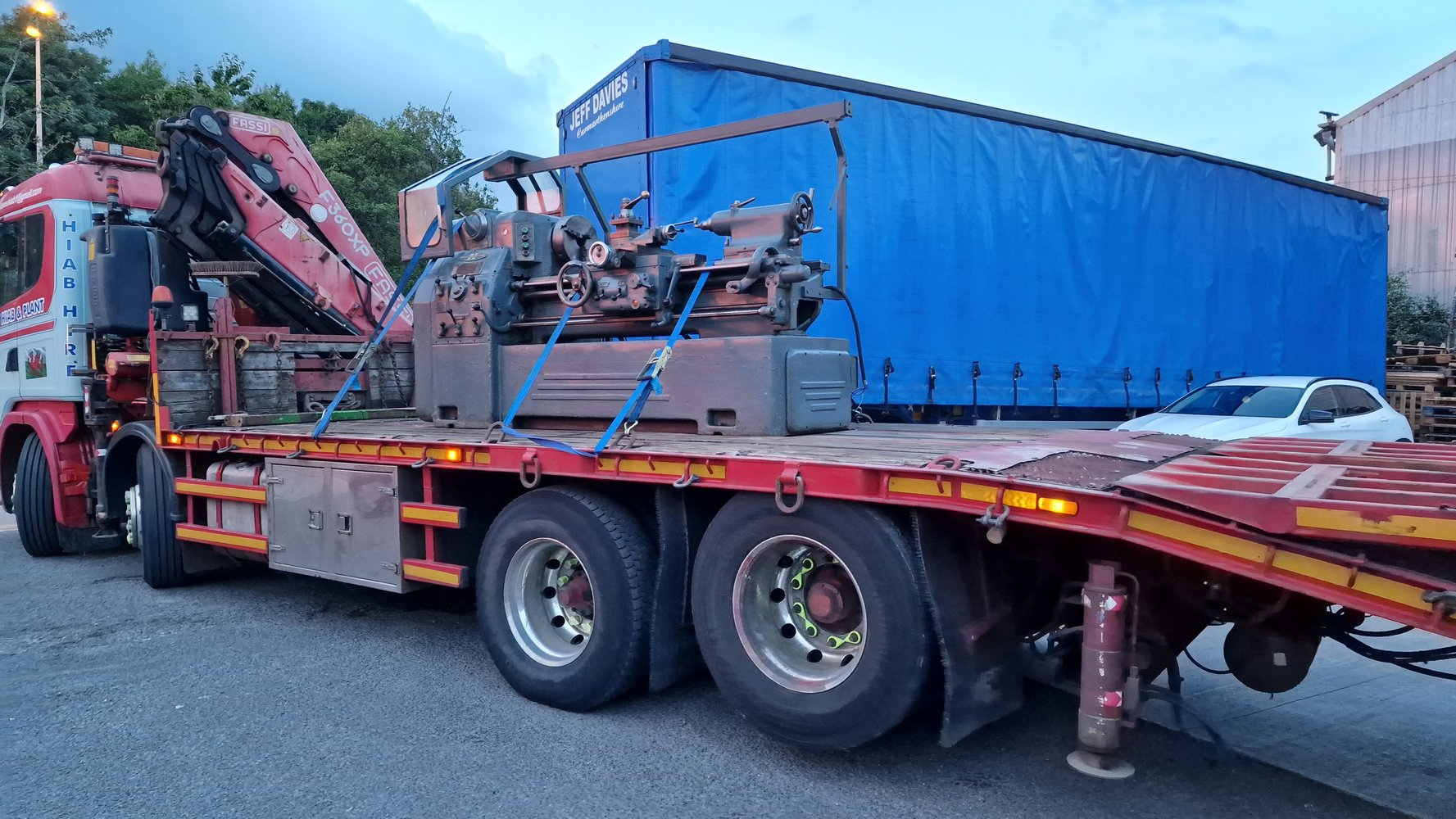

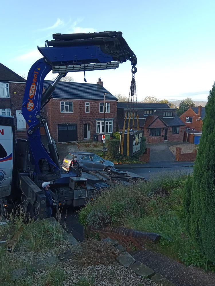

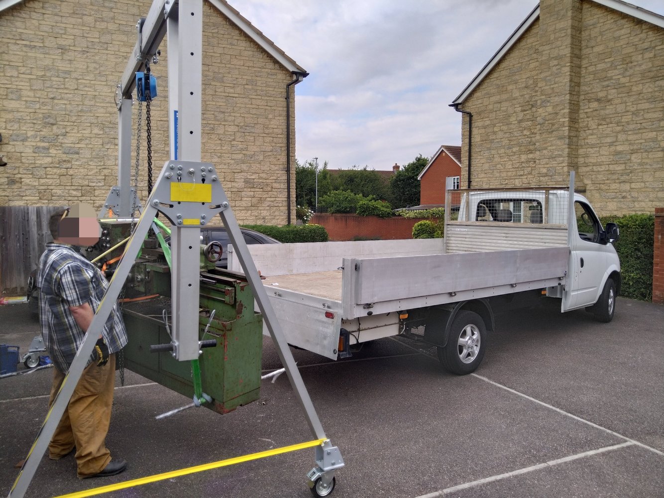

Hiab on its own you are looking at £400 plus just to a local depot.Didn't notice that...
But it doesn't actually change my answer all that much.

If access isn't an issue, it would probably be possible to get the shipping agent to arrange Hiab collection too, which would massively reduce the hassle involved.

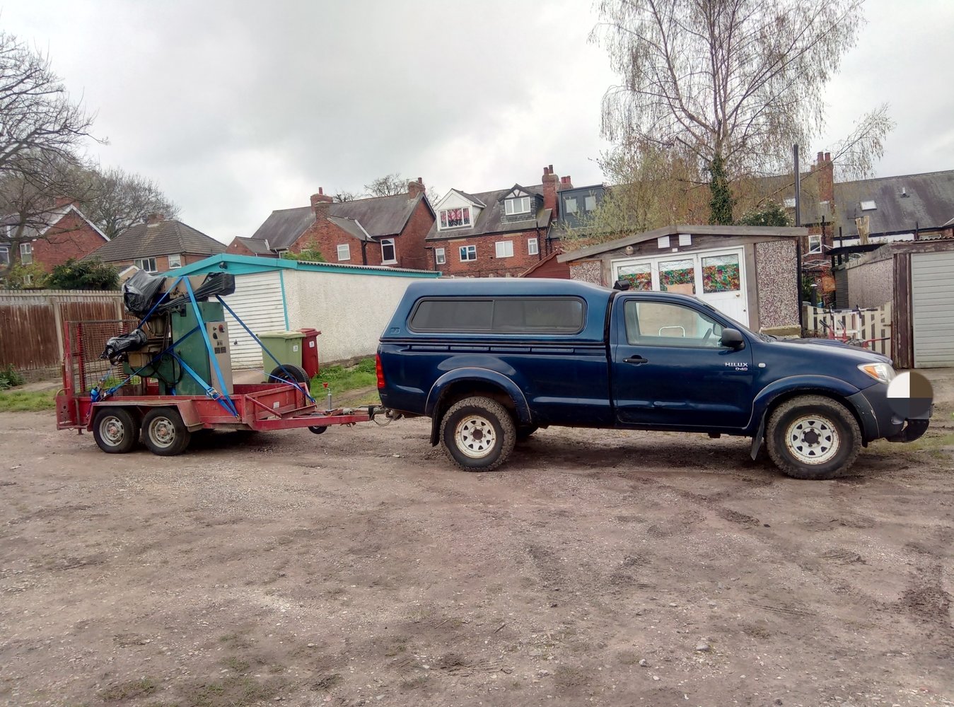

Pallet shipping far cheaper. Max weight we can move on a pallet through networks is 2000kg. More by dedicated of course.

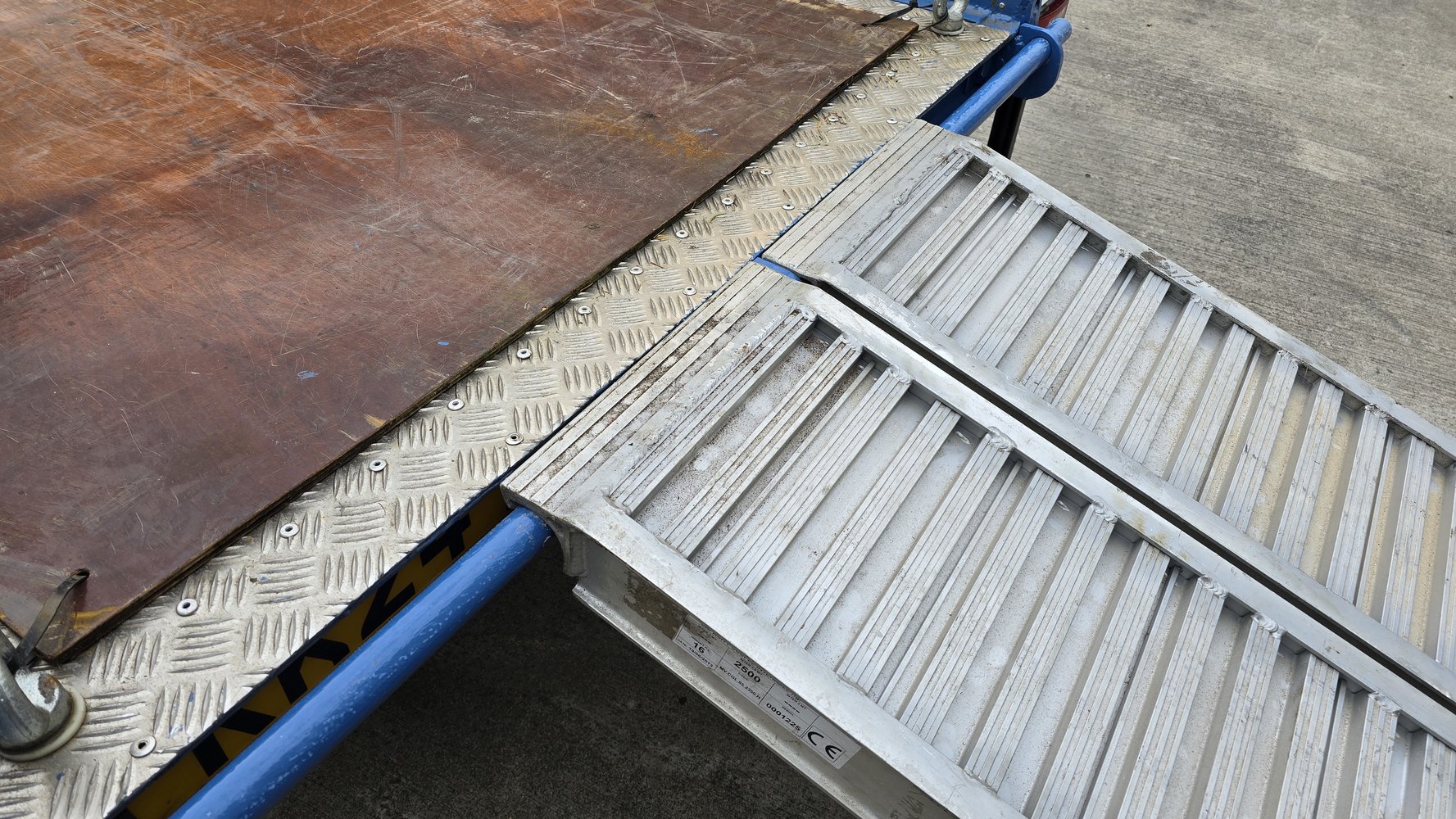

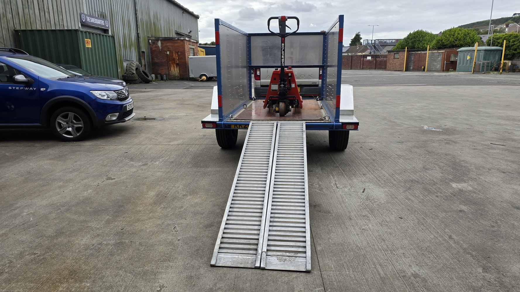

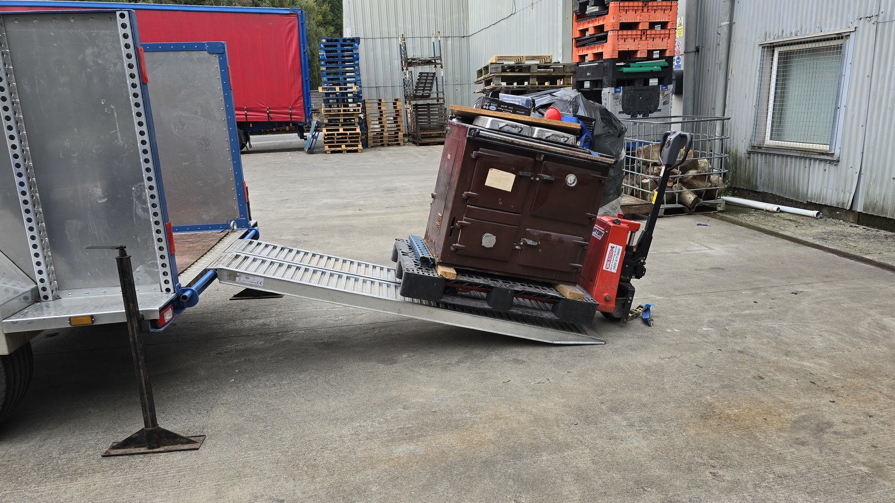

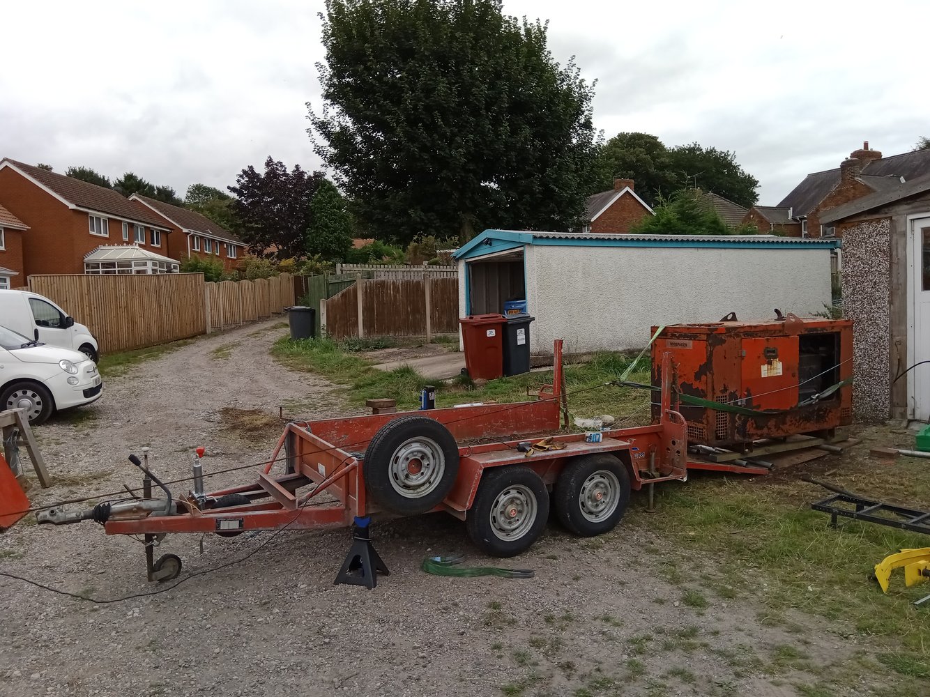

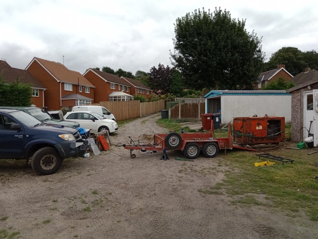

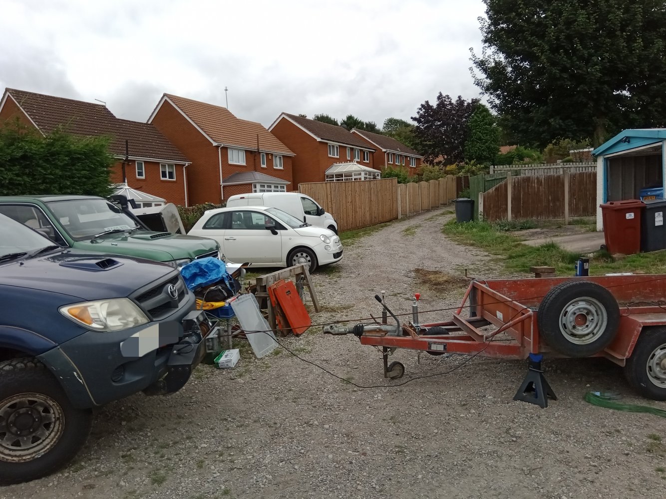

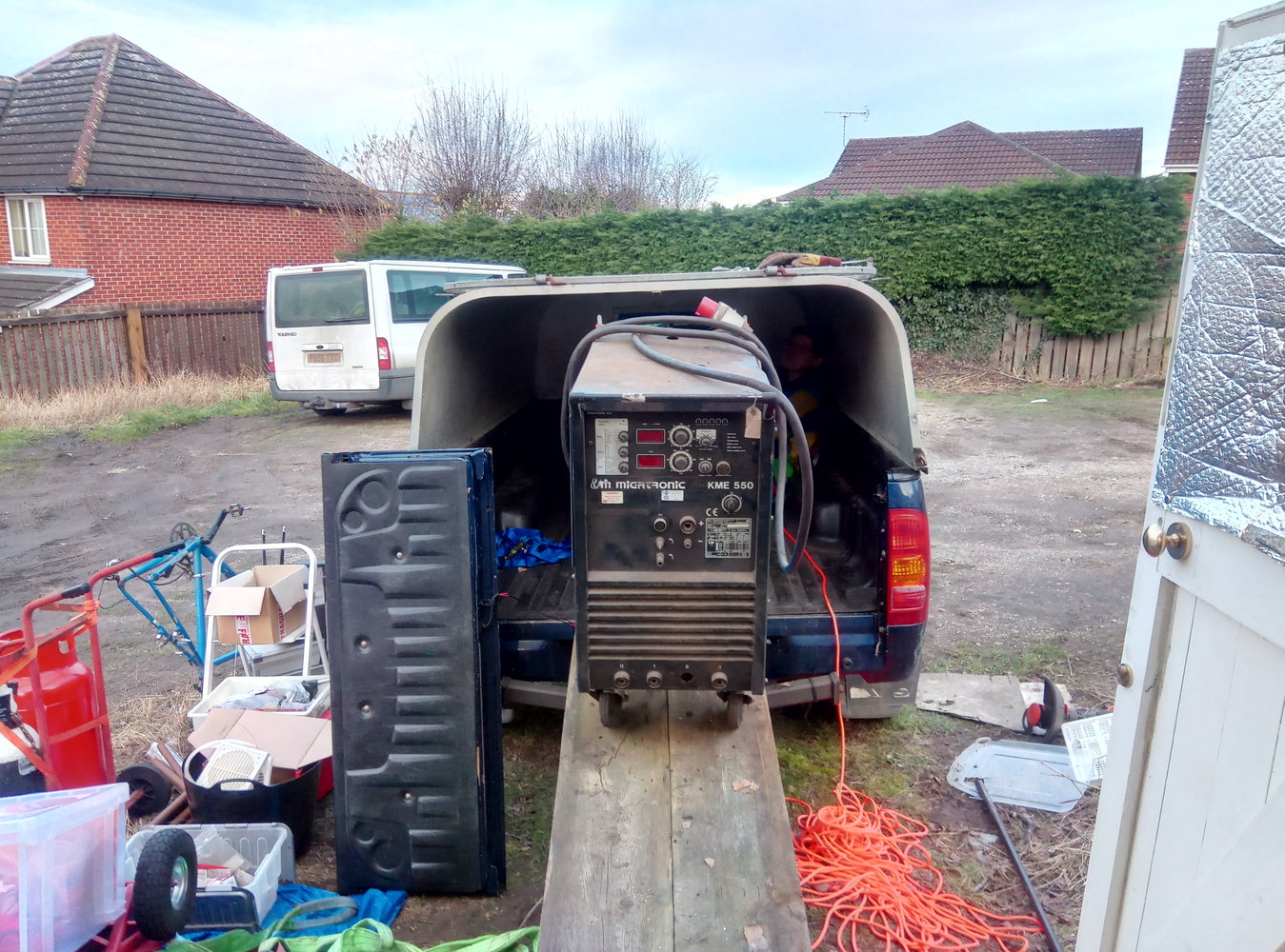

. Ramps and trailer rated to 2500kg. Winch to assist if needed. Modifying ramps soon to work like a 4 post lift.
