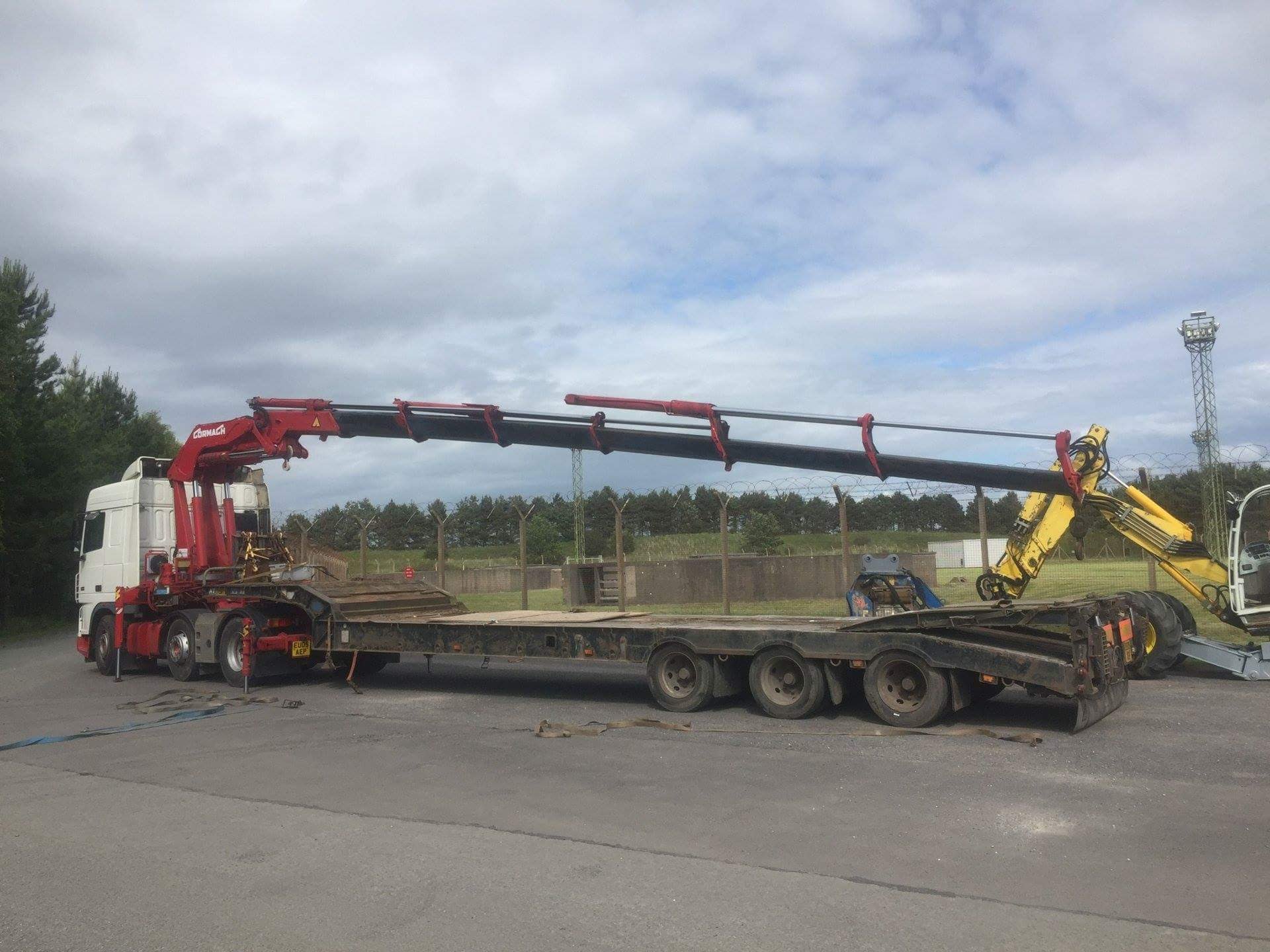

Found a local lad with a three tonne HIAB who offered to do it, but a three tonne HIAB will only lift that close up.
3 ton HIAB has no chance with that mill - 12 tonner minimum.

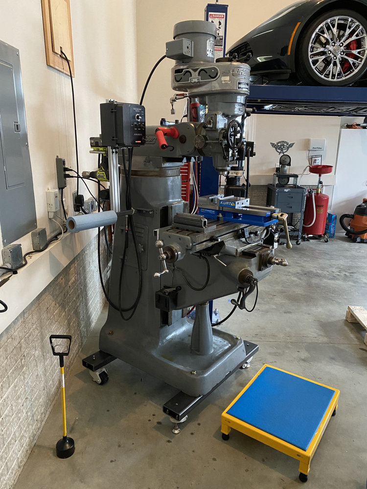

Here is mine
Well it just fitted through my double doors on a pallet and pump truck - doors are 78" high.Can you remember the height of the machine when like that
