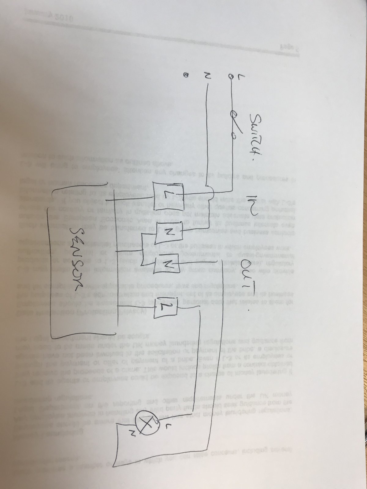

I think part of my problem is not understanding what the experts are saying..lolthere normally ceiling mounted and require a permanent live and a neutral .the outgoing switchwire to light is conection a on the conection plate if you want override you would use 2 core and earth through a 1way light switch wired across live and conection a on pir
now that makes sense....I just need to ignore the original switch and hope I dont need the light permanently on. Perhaps I should have aimed lower in the first place.

Yeah, I wouldn’t expect the neutral to be switched at all, just a small relay contact in the pir to switch the live and the neutral being a permanent connection on the light fitting. The live and neutral to the other side powers the pir electronics.they are marked in and out two pairs, how they are switch internally is not known, i have assumed they are a linked pair.
normally there is no need to switch the Neutral. if it is required then it would be done at the switch.
