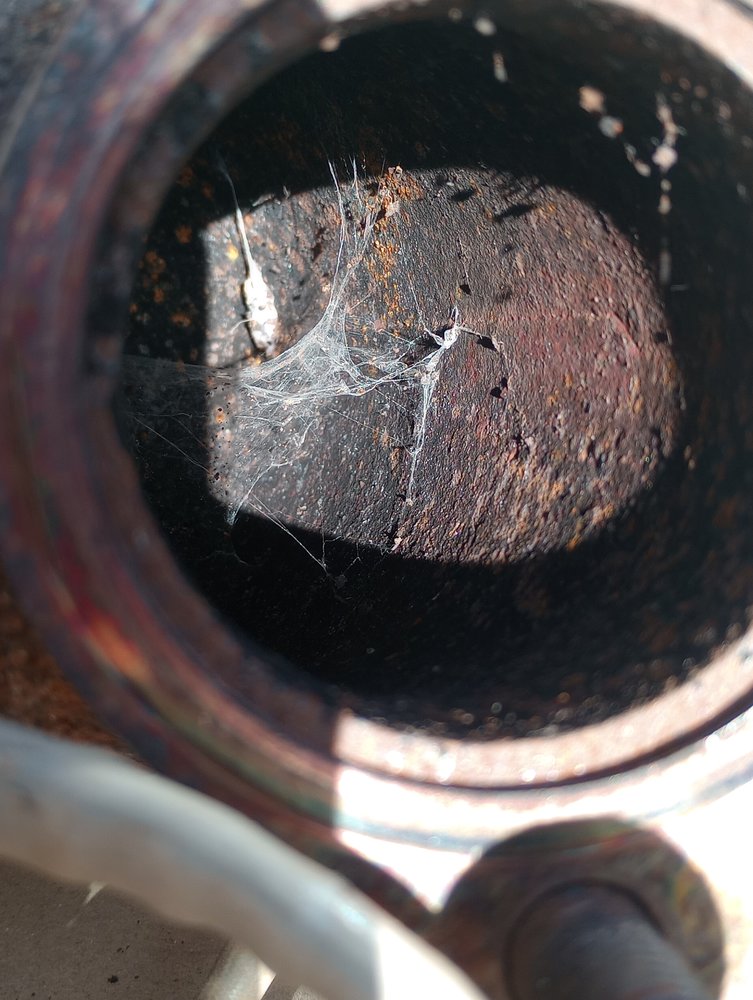

It's a 2002 4.2 XK8.Not exactly good for the environment scrapping a perfectly good car just because there are no replacement catalytic convertors available. Yet another example of ill thought out legislation. What difference does it make if the CAT does what it's meant to?
What model and year do you have?

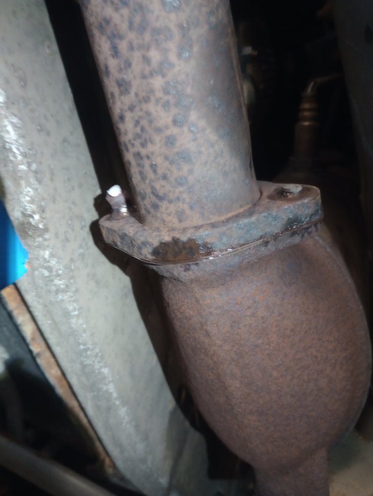

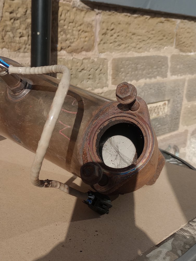

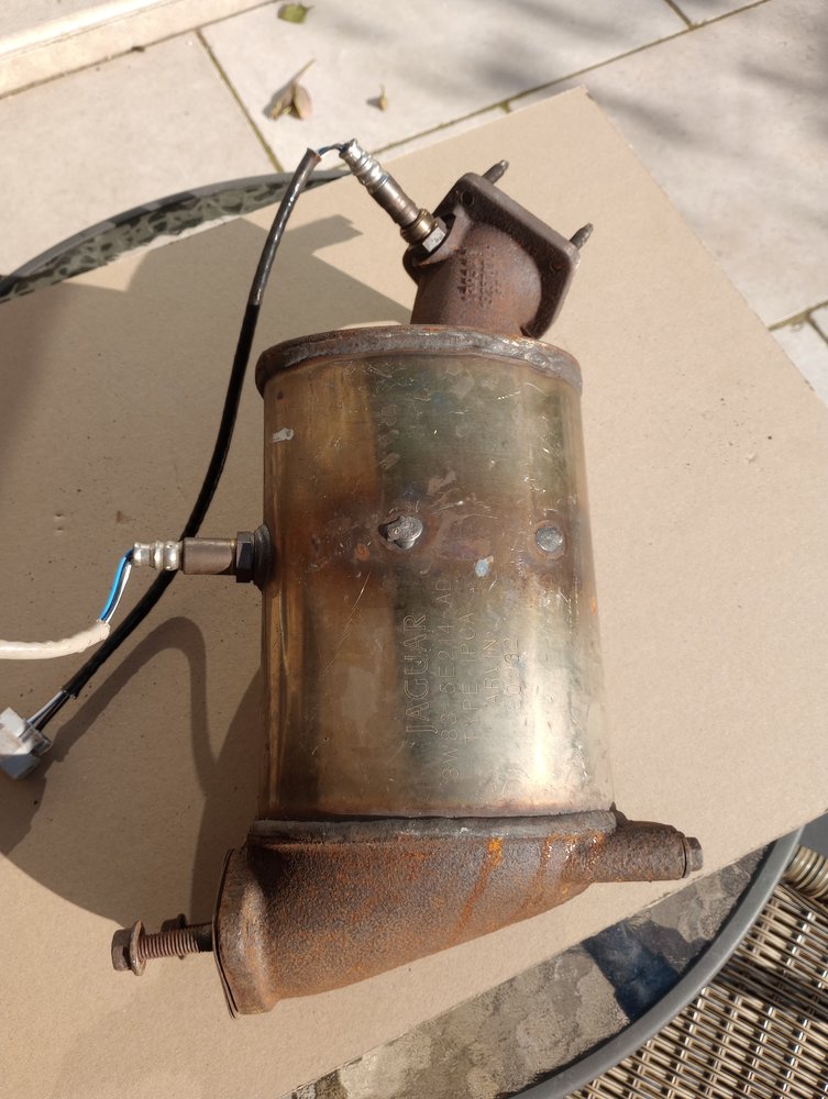

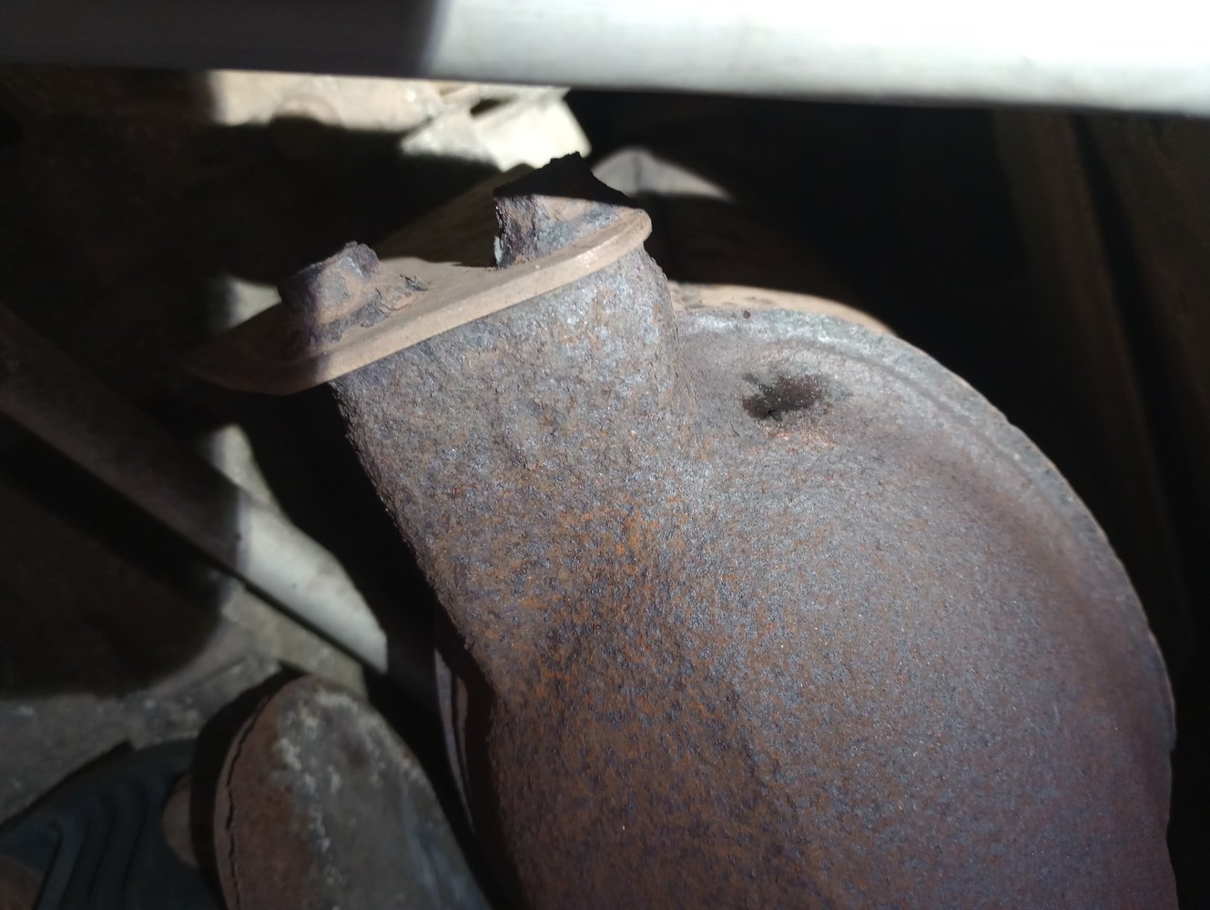

There is a pin hole on the other side too.

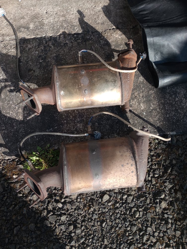

However I bought a pair of second hand cats 7 years ago and only fitted the other one (that I just repaired above), this one has been on the shelf since.
No easy way of telling how much life is left in the cast bottom part.
The matrix still looks good though.
When they were still available from Jag, they were about £1500 each. The earlier 4.0 cars have aftermarket cats available but the later 4.2l cats have nothing.
I think that the MOT rules state that from a certain date ~2002 all cars have to be fitted with OEM cats. I think that's why there are no aftermarket parts available.
Does anyone know the truth of this?

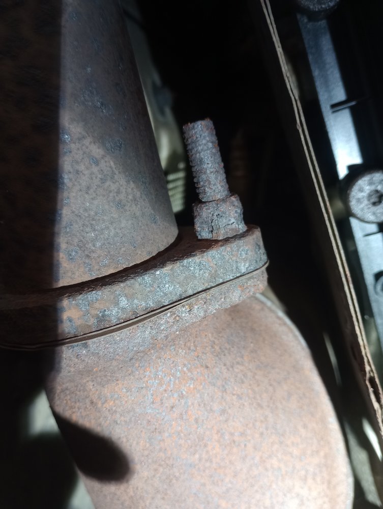

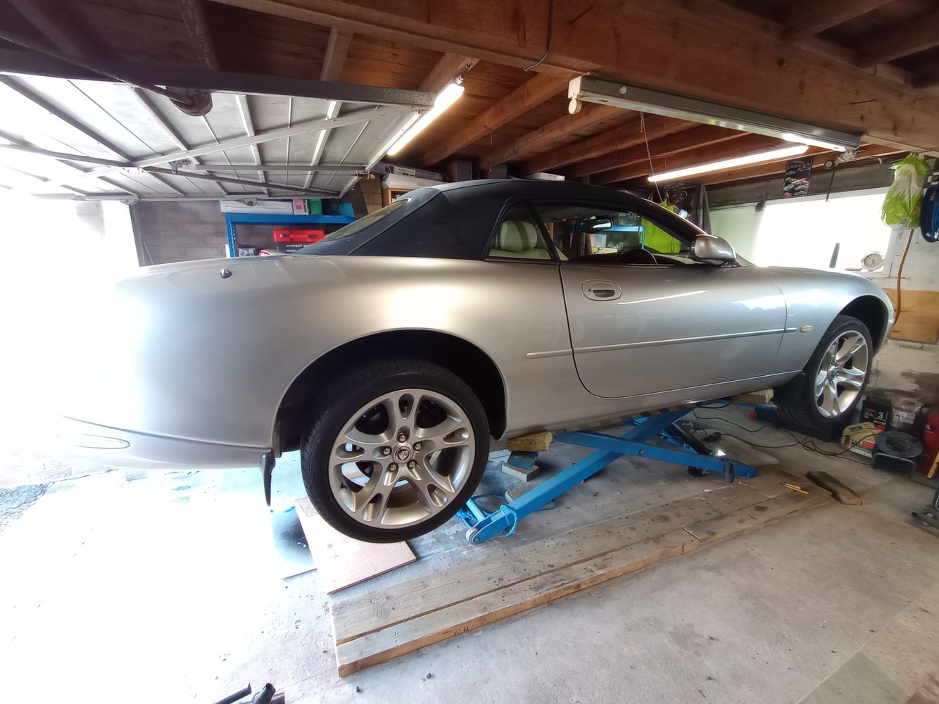

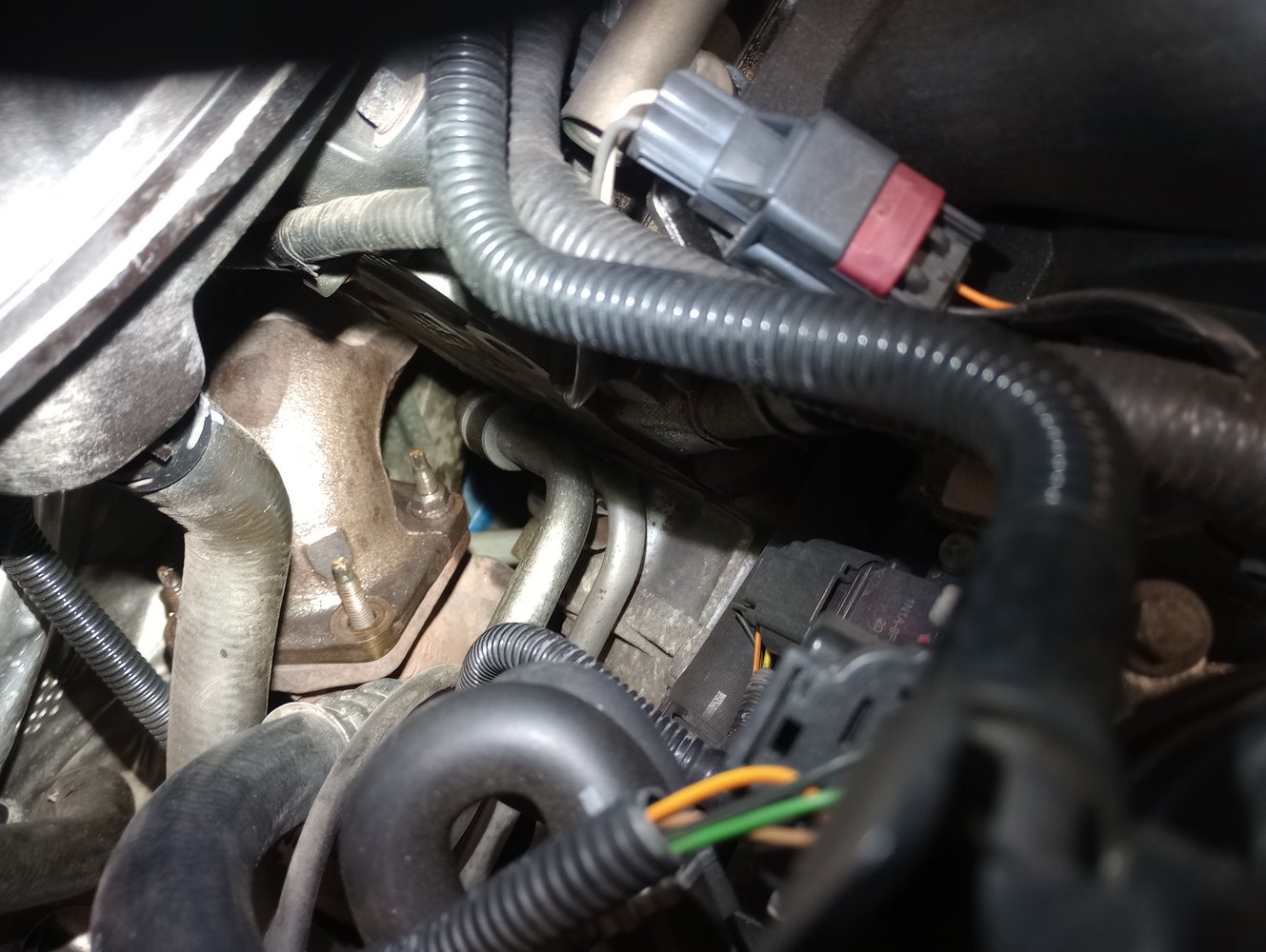

Anyway the car will be SORNed at the end of the month and I'll do the swap after that and a bit of work on the near side sill.

A smear of exhaust paste would do the job .I would personally have thought a teaspoon of reinforced body filler smudged would have solved the issue personally to get through the MOT.
Mig brazed itTell me what I should do not what I can't do.
